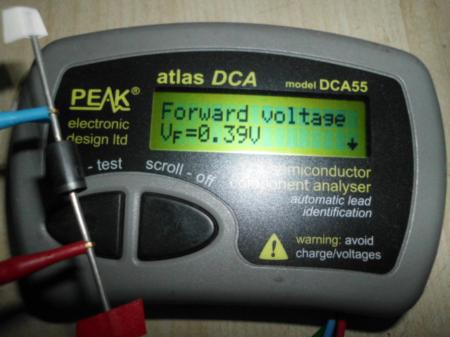

                            #93
                            Re: BUSH LED2497ODVDFHD, 17PW80 V2, Dead!
                            Originally posted by gabiz_ro
                            Forward current 3A vs 5A
                            Forward voltage 1V vs 0.85V
                            It should work fine,with UF5402
                            SR5100 Forward voltage drop as measured on my Peak atlas DCA55 which was re calibrated 4 weeks ago.

                                #95
                                At the low current the DCA55 uses most diodes will test with quite low forward voltages, as gabiz says the diode may be rated at full forward current.
