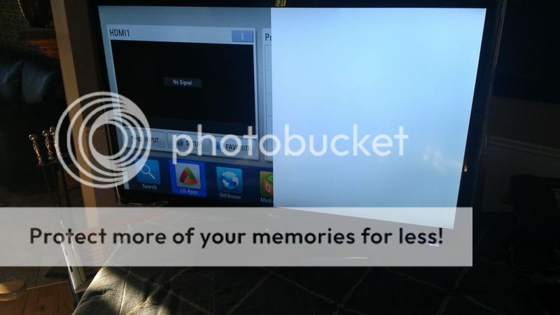

LG 47LV5400 No Image
  • rikrikrik13
    • May 2013
    • 44
    LG 47LV5400 No Image
    I got this LG Tvs not working properly.
    I did many test. When everything is hooked up, I got no image, only some lines on the right side of the tv.
    If I disconnect the right side of the T-CON board, I get half screen working perfectly. With both side connected, only lines on the right side and no image at all (sound ,backlight and everything is working).
    I replaced the T-Con with 2 different one, same problem, I replaced the Main board, same problem. Only thing left is the Power supply (seems ok), panel or??
    Please help!!! Thank you
    Re: LG 47LV5400 No Image
    Bad panel:
    https://www.badcaps.net/forum/showth...ight=LG+47LH55
      Re: LG 47LV5400 No Image
      You may be lucky and it is just a shorted SMD cap on one side but I am willing to bet that there is a fault with one of the tab drivers.
      • rikrikrik13
        • May 2013
        • 44
        Re: LG 47LV5400 No Image
        Can you explain me a little bit more how can I test a SMD cap?
        • cashkennedy
          • Aug 2011
          • 668
          Re: LG 47LV5400 No Image
          Along the side of the screen are thin boards where the 2 ribbon cables from the tcon connect (often you have to disassemble a lot to get to these boards). There are not many parts on these boards, many tab bonds, and a driver (IC chip) every few inches. The SMD caps are small beige cubes, you can test them with the ohm (resistance setting) by connecting your leads to each side, and the resistance should increase very quickly from 0 to out of range oL or something like that. You can also test them with the capacitance setting on your multimeter if you have that setting.
          Fixed so far 12 lcd's , 1 plasmas, 5 monitors, 0 dlp's (plan to keep the dlps at 0). and 3 atx power supplies, and 2 motherboards.
          • rikrikrik13
            • May 2013
            • 44
            Re: LG 47LV5400 No Image
            thank you Ill try that!
            • x_orange90_x
              by x_orange90_x
              03-29-2025, 11:02 PM
            • shlomim412
              samsung ua55es6800 - no image
              by shlomim412
              hi
              having problem with samsung ua55es6800
              tv had backlight on, sound working - responds to the remote control but no image.
              check tcon board - had 12v in but no other voltages present.
              when disconnected left ribbon cable - got back voltages and half image with lines and distorsion
              when leaving only left side connected - again no voltages and no image.
              put a tape on all (cd?! lines) on the left ribbon cable and got complete but distorted image (horizontal lines).
              kept trying to block less pins on the left ribbon cable...
              05-15-2024, 05:00 AM
              09-12-2024, 02:20 PM
            • jimmyboy111
              TCL Roku 65S421 - Double Side by Side Image
              by jimmyboy111
              .. swapped mobos and matched them close as possible .. now this .. two images side by side I am guessing wrong resolution .. everything else is working fine
              .. unable to get into service mode with new update any help is appreciated
              https://imgur.com/a/Mzhz0Iw
              https://imgur.com/a/fxB7wV8
              07-11-2023, 10:54 PM
            • Ancient1
              Strange LG TV issue : Image vertical lines in black screen
              by Ancient1
              Hi
              Asking for a friend.
              I'm used to black vertical line in otherwise good image - probable solution is a rubber to push and tighten the COFs bonding.
              but here its the opposite !
              TV has new T-con = same issue
              A missing panel voltage would have global effect
              So , what should one do ? how can I find where the fault is ?
              Thanks !...
              02-05-2025, 03:37 PM
