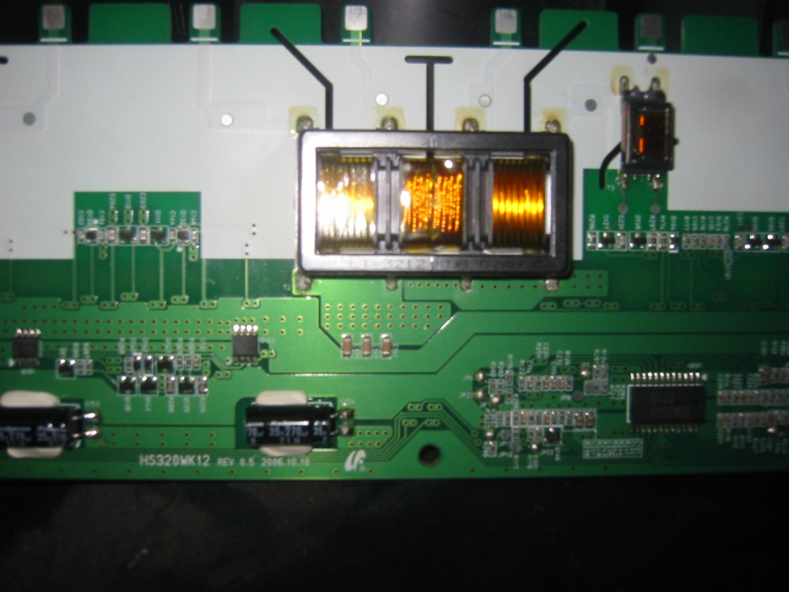

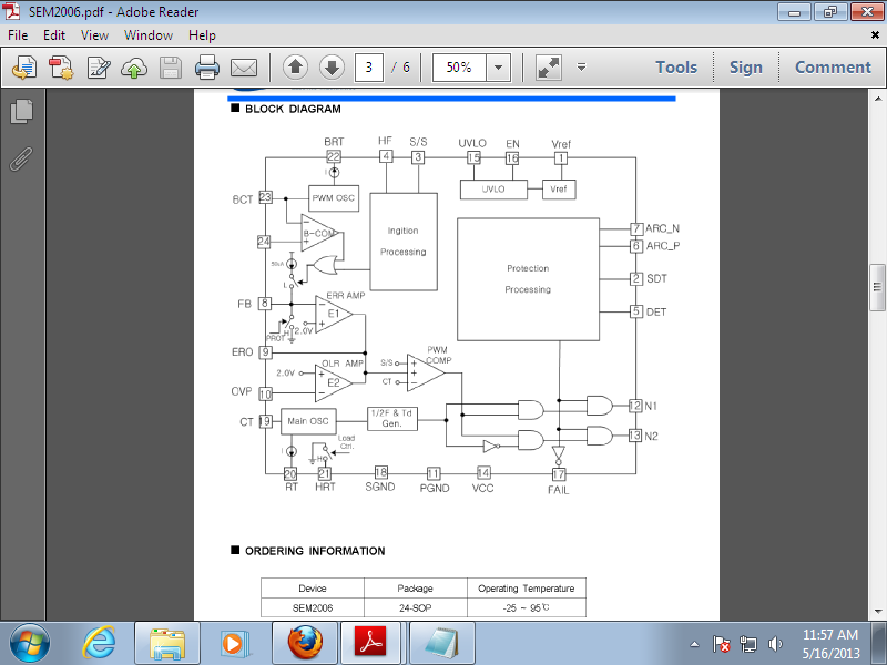

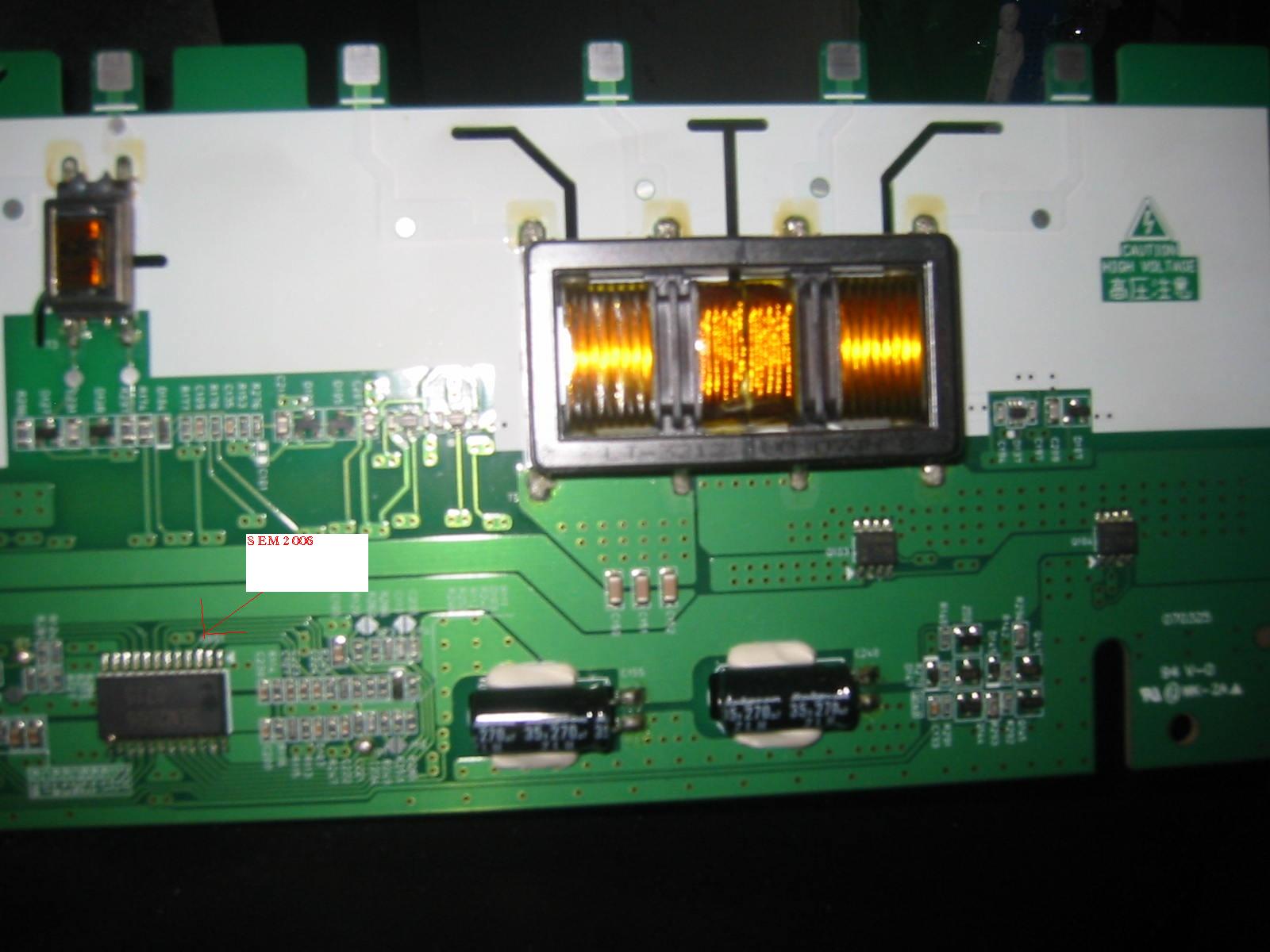

    Hello . I am working with Toshiba 32LV67U. Tv has backlight in 2 second then black out.I tested every lamp
    It shows light. I do not know problem is in lamp or inverter. Inverter has ic SEM2006. I try to defeat protection of this ic but I can not.
    I have schematic of this ic. Pin 5(det) pin 8(feedback) pin 10(ovp).

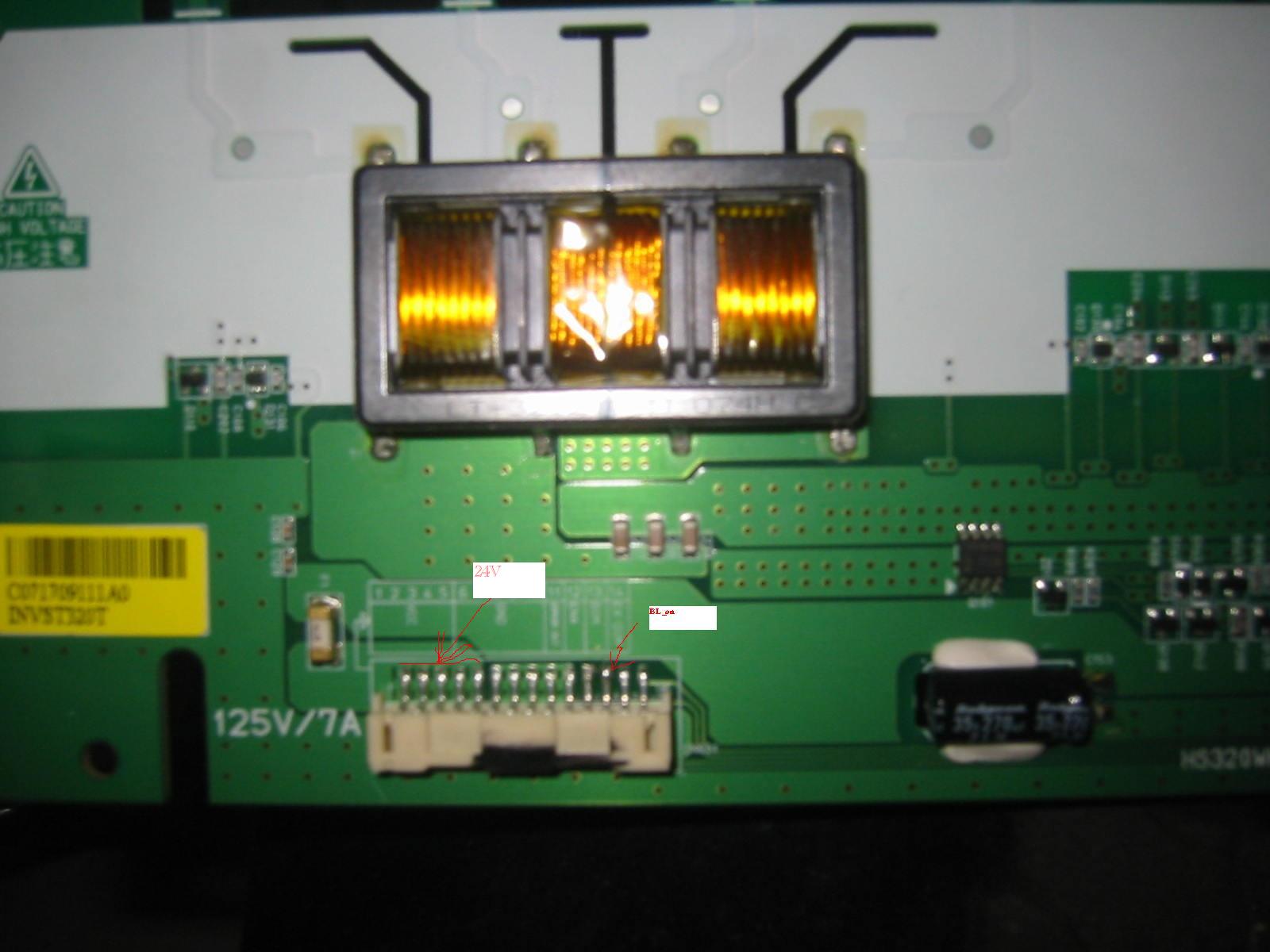

    You have stable 24V going to inverter?
    Is BLON stable?

      Re: Toshiba 32LV67U backlight problem
      Yes It has 23.90v and bl_0n 4.51v Tom
      all stable
        Picture of the inverter?
          Here is the picture.
            Any chance you can upload a JPEG? I can't open that file.
              Can we see the picture of YOUR board? And closed up pictures so we can see the labeling at the connector. The picture you posted is low res, not good enough to troubleshoot.
                Here is JPEG Tom
                  Again, that is just too small to work with. It needs to be at least twice as big, preferably even bigger.
                    I cannot read any printing on the board at all, just remember one important thing, we do not have the board in front of us to look at closely. Just look at the picture you posted, Can you read any labeling on the board, on the components?

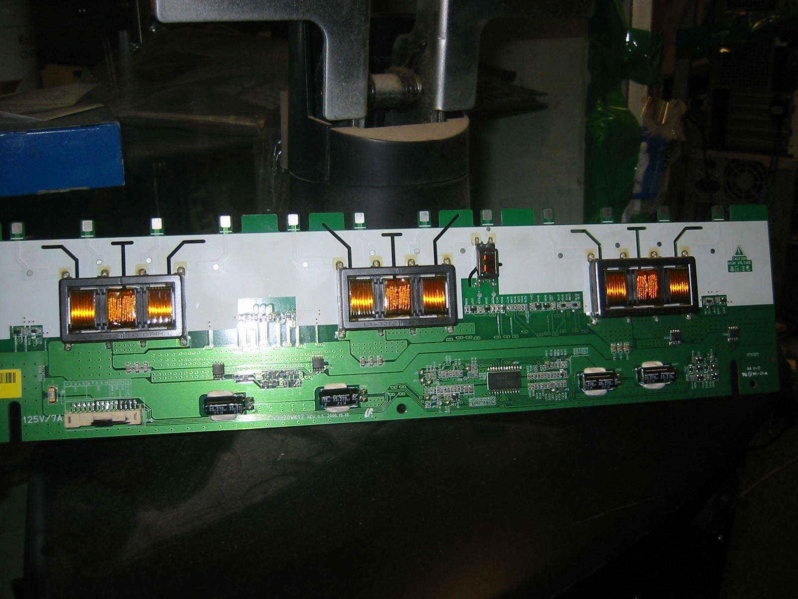

                      Hello Budm and Tom66.Now I try my camera.Just Let me know what I have to do.
                        OK, on the inverter transformer, make the bottom left pin as pin 1, so pin 4 is the right bottom. For the top row pins, top left is pin 8, so take the resistance read of pin 8 & 7, 6 & 5. Do the test on all 3 transformers, and report the reading, make sure to tell us if the reading is in Ohm, K Ohms, or M Ohm.
                          Tranformer left 7&8 1235 ohm 5&6 1240 ohm
                          center 7&8 1245 ohm 5&6 1245 ohm
                          Right 7&8 1212 ohm 5&6 1260 ohm
                            Hi, try to short pin 5 to pin 11(gnd) of sem2006.as the transformers seem ok could work.
                              I try to short pin 5 to gnd . no work. Any other pin should I try?

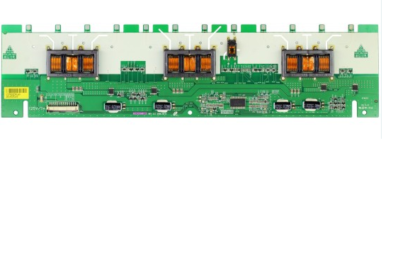

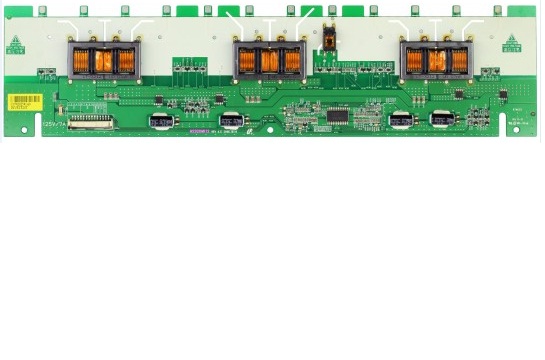

                                Yes Budm . I can read all labels. It is INVST320T.
                                Today I install another inverter I got it from ebay. TV still black out after 2 seconds flashing. All transfomers of new board have good reading ohm
