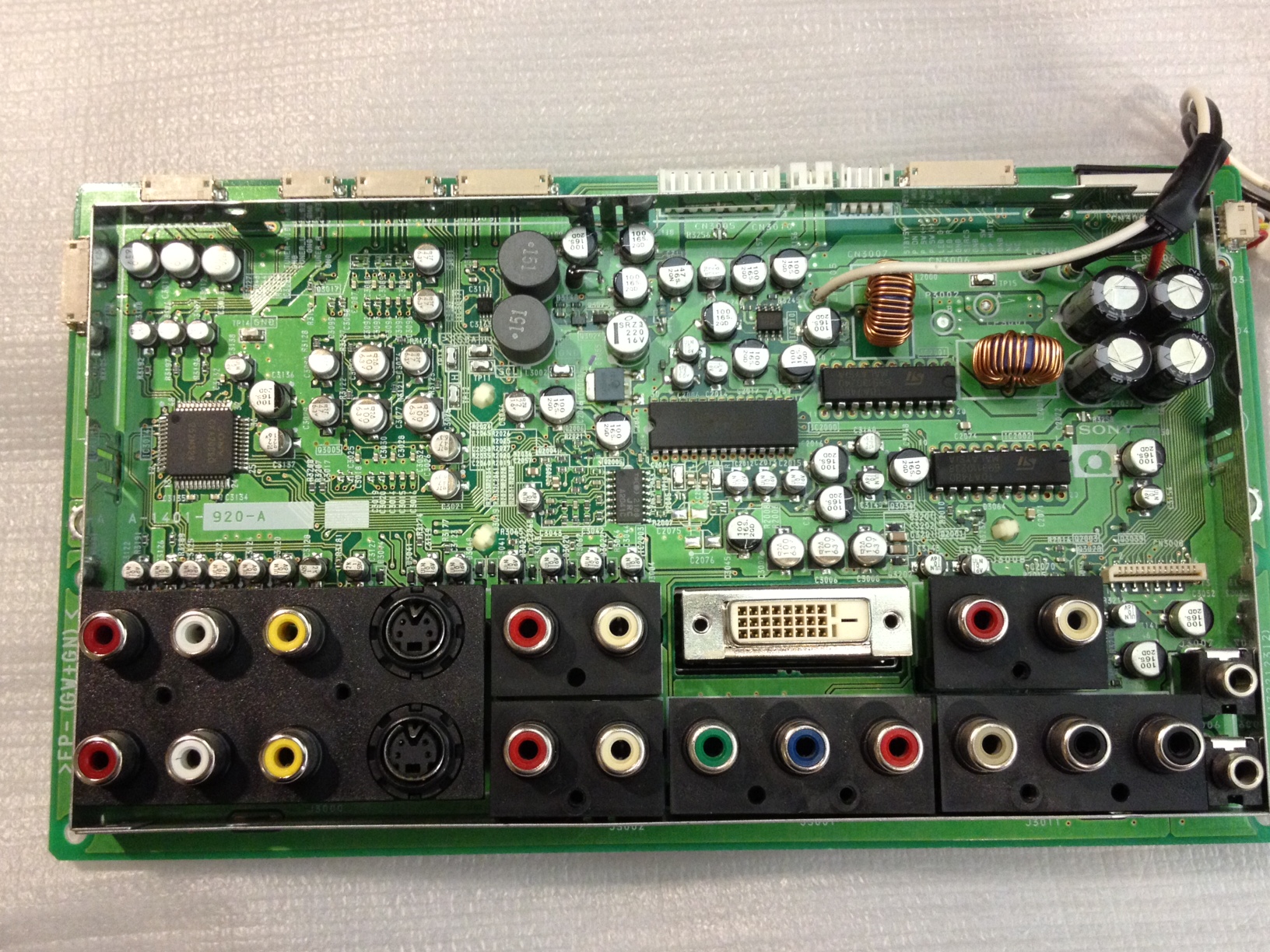

    After a lightning storm I have no picture on this TV. I can get the menu to show on the screen but it indicates that there is no signal into the TV even when i switch to any type input source. Any ideas on which parts i need to replace? I have never worked on a TV before but consider myself to be handy repairing things.

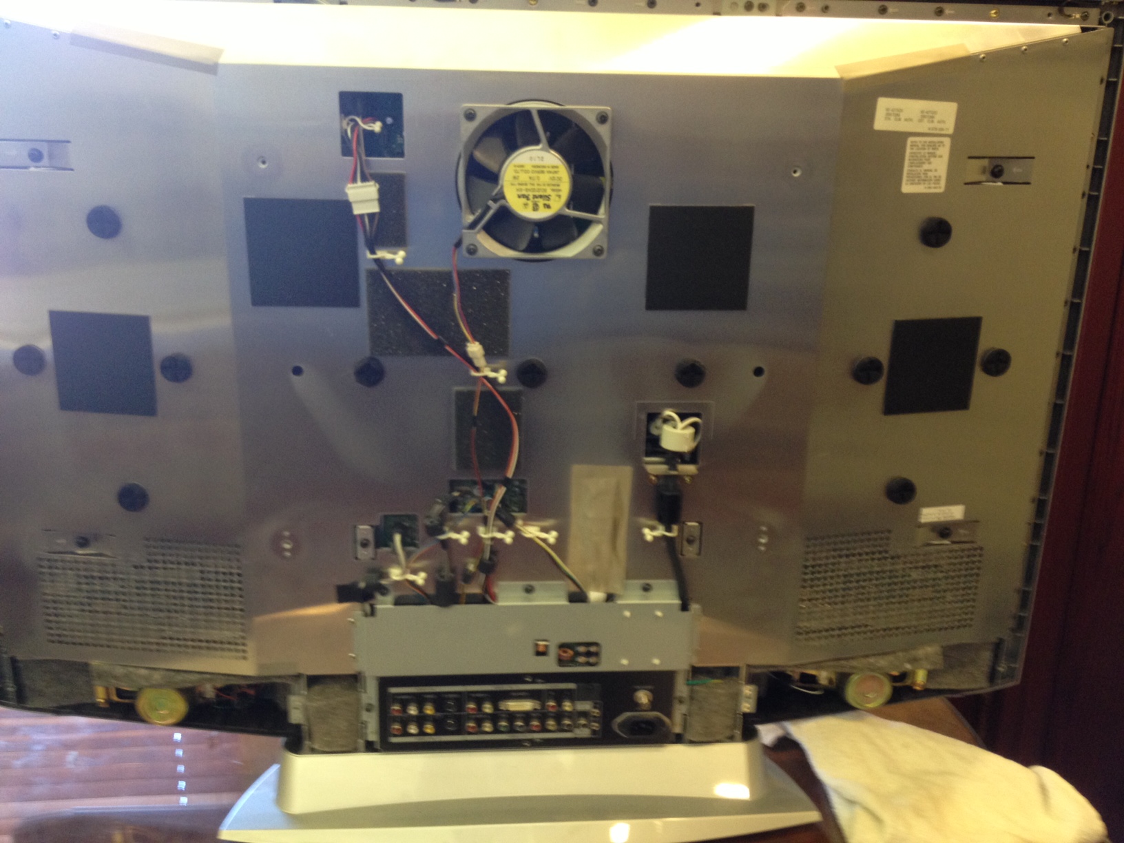

            Re: SONY KE-42TS2U can see menu but no picture

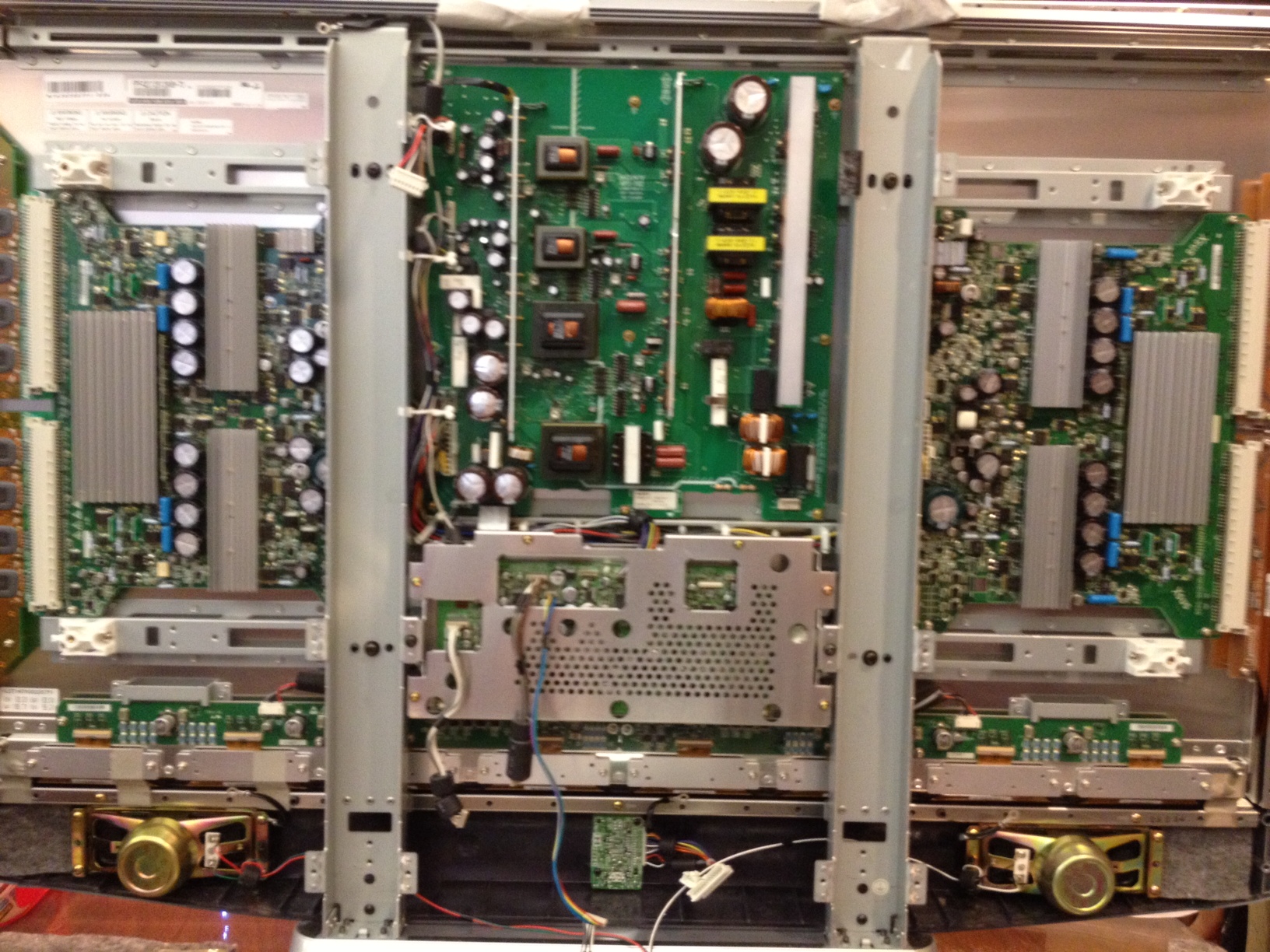

            This is a picture with the back off. I guess you need me to take off the metal panel also?
            Mark
              Yes. I have never seen an LCD with a shield like that over the electronics! Is this a plasma HDTV?

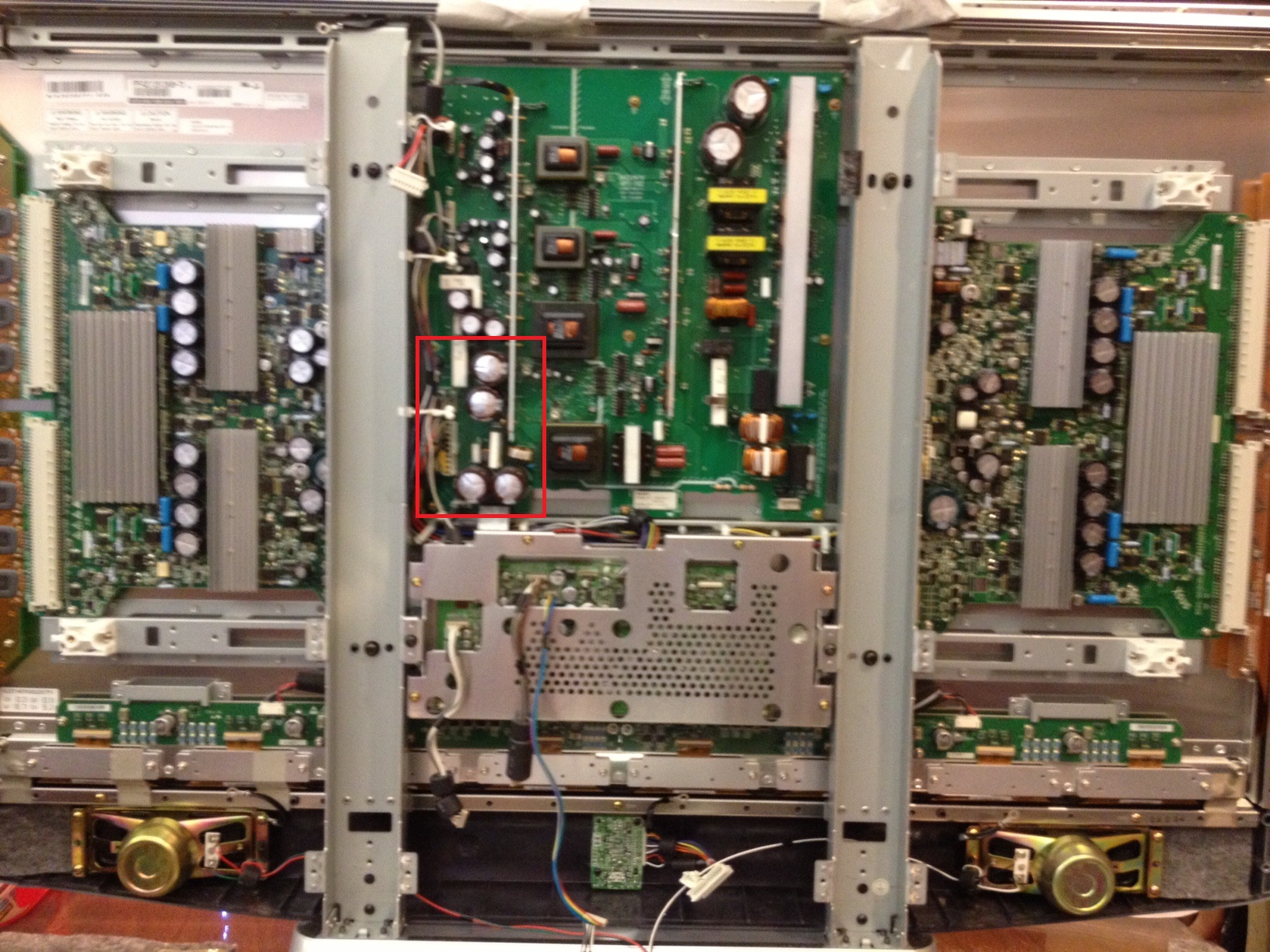

                    I have attached the photos.

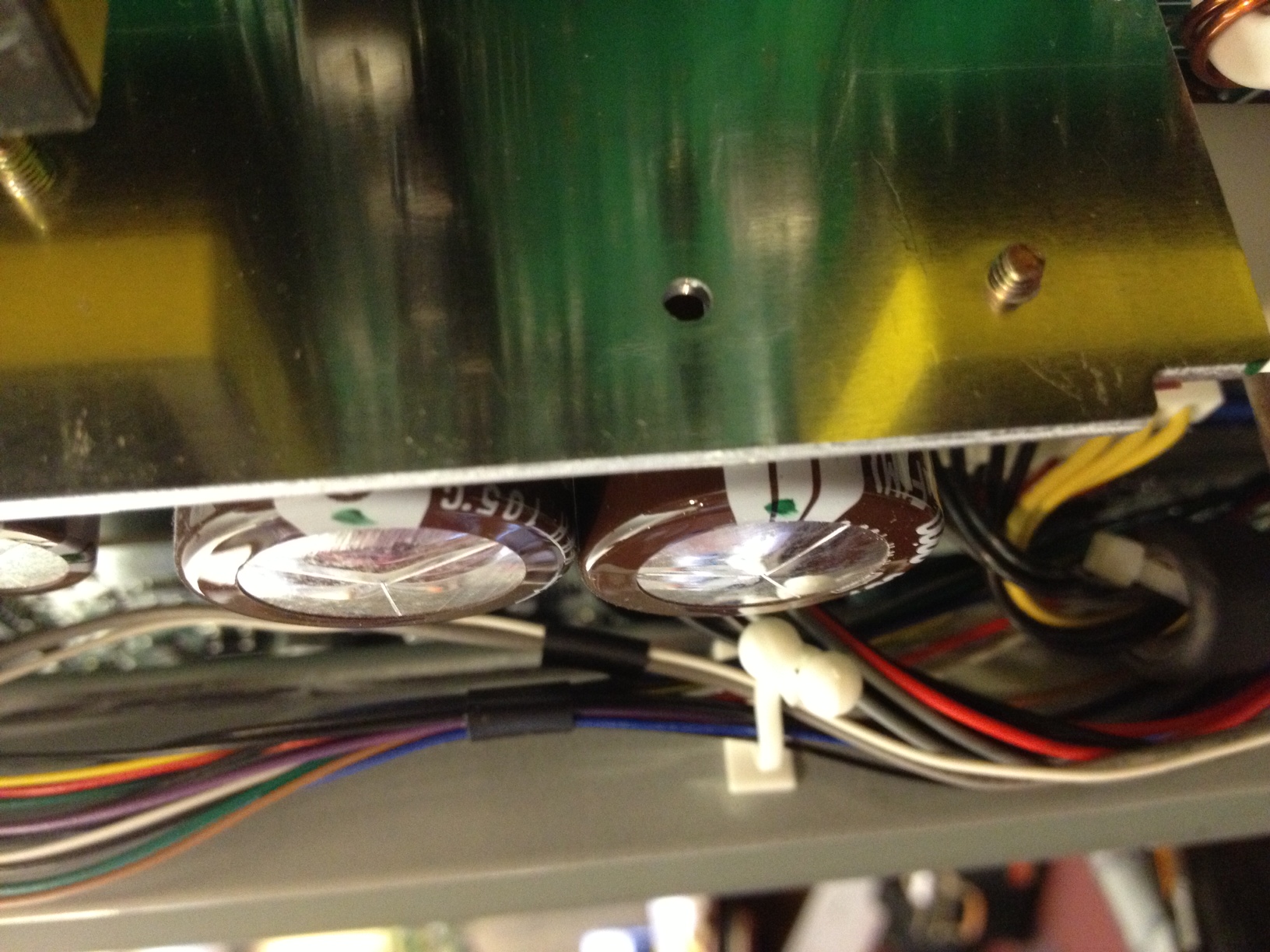

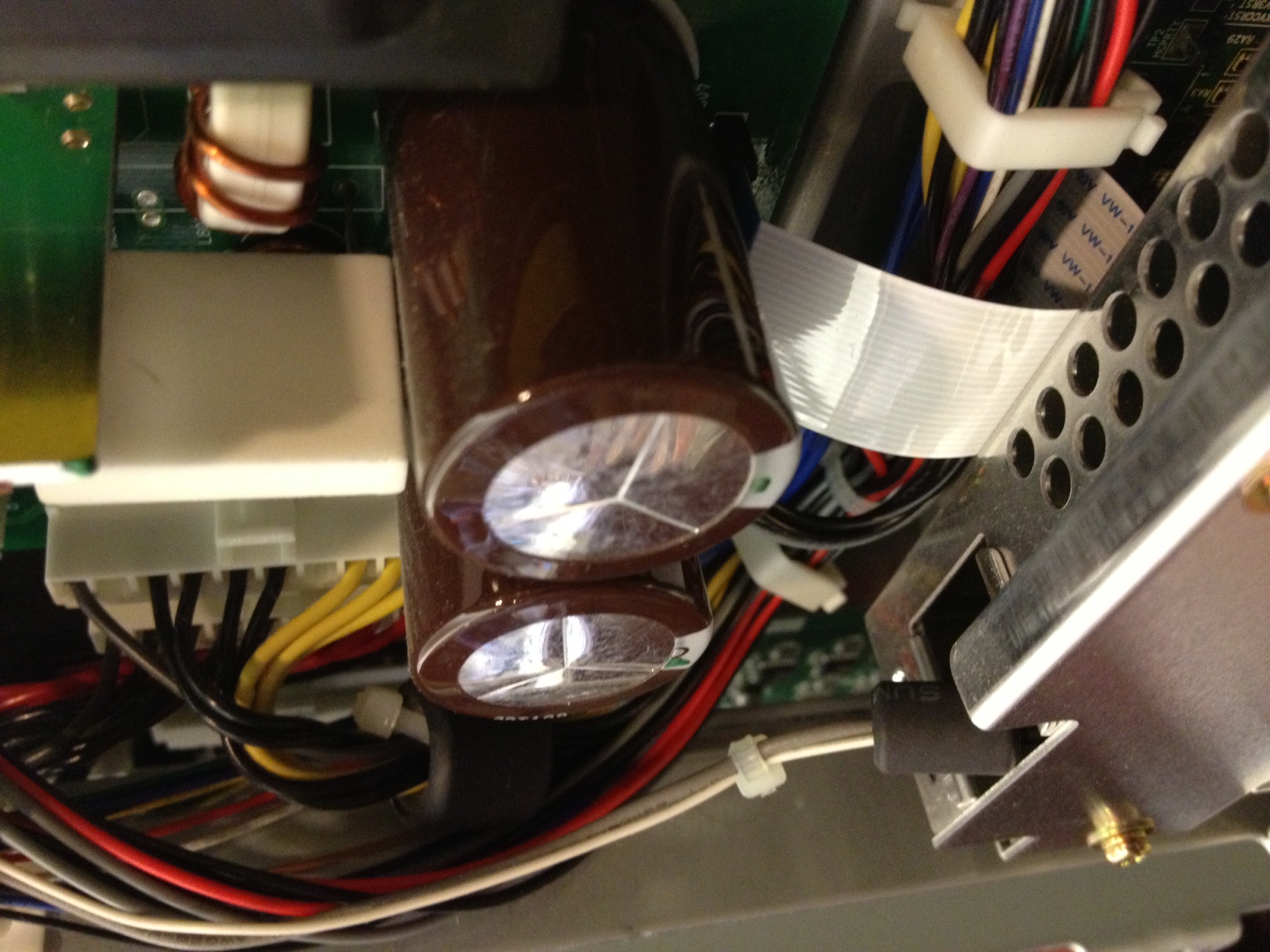

                      Can we get a closer shot of these capacitors? They do not look healthy.
                      The problem is likely below the capacitors (main board assembly), however, the capacitors being bad could conceivably cause issues with the main board.

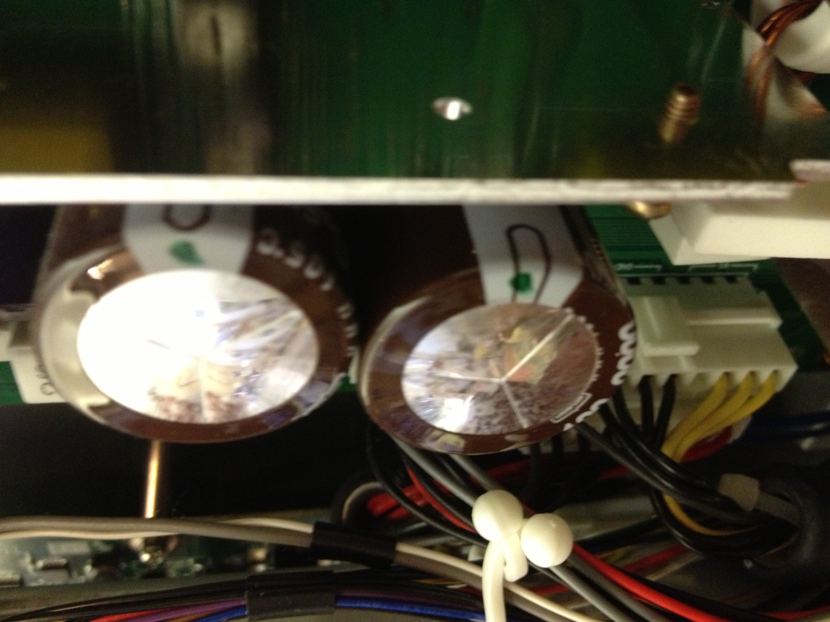

                        Yes those 4 seem to be bloated.
                          Hmm, they look OK to me. Bulging would be evident around the seal -- it would be leaking or broken.
                          So, can you easily remove that shield off the board below those capacitors? The main board is under there.
                          • truep
                            • Aug 2010
                            • 373
                            Those caps are bad. Replace them before going further. wouldn't hurt to replace all of them on that board.

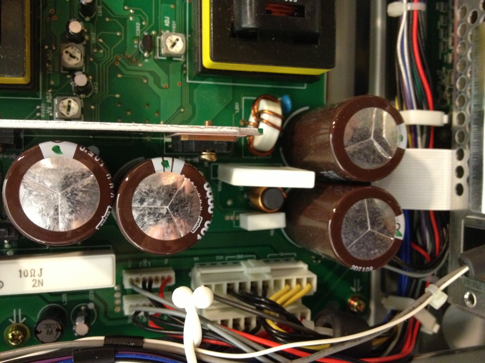

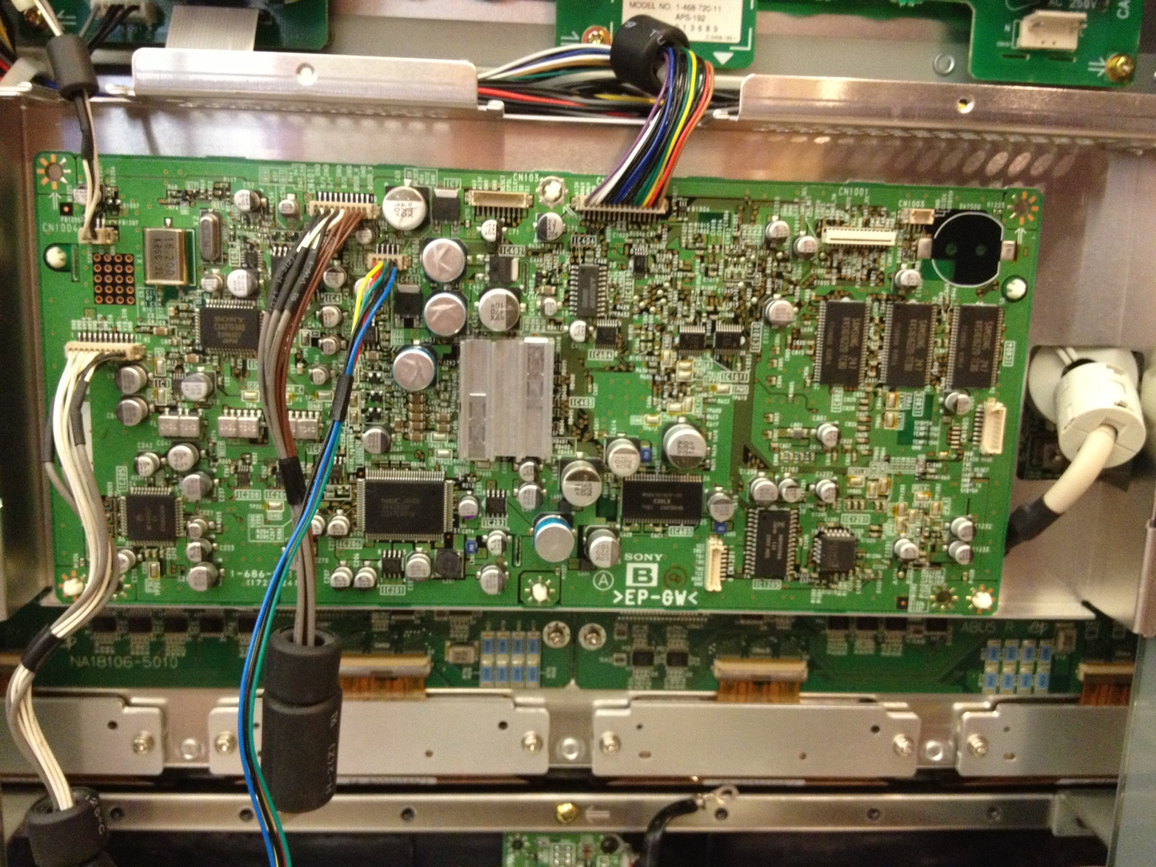

                              How do I remove the caps? I have attached a photo after removing the other shield.
                                I'm of the opinion they're not bad, but if you want to swap them, you will need to use a soldering iron; heat each leg one after another, while gently pulling on the capacitor.
                                As far as the main board goes, is there a separate area for the video inputs? It looks like that just connects to them somewhere?

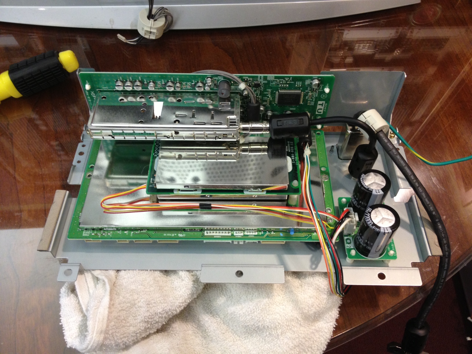

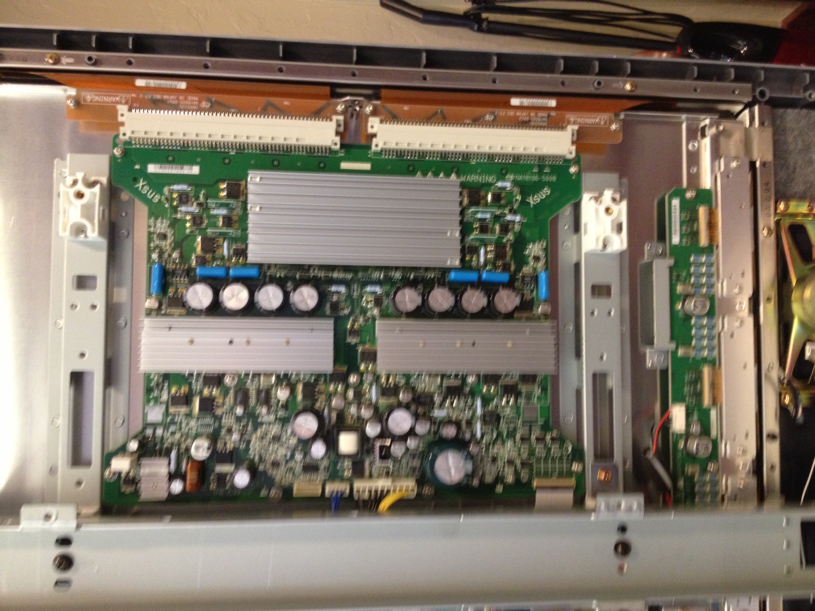

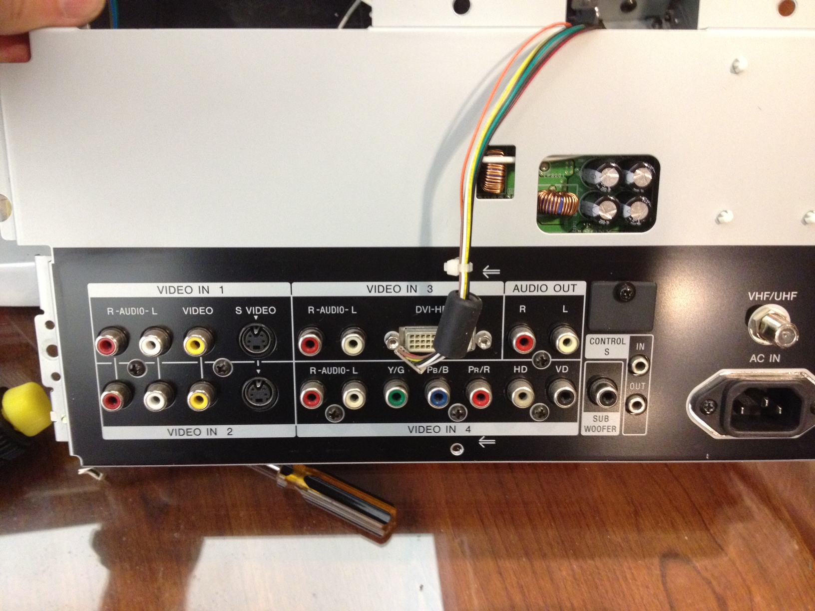

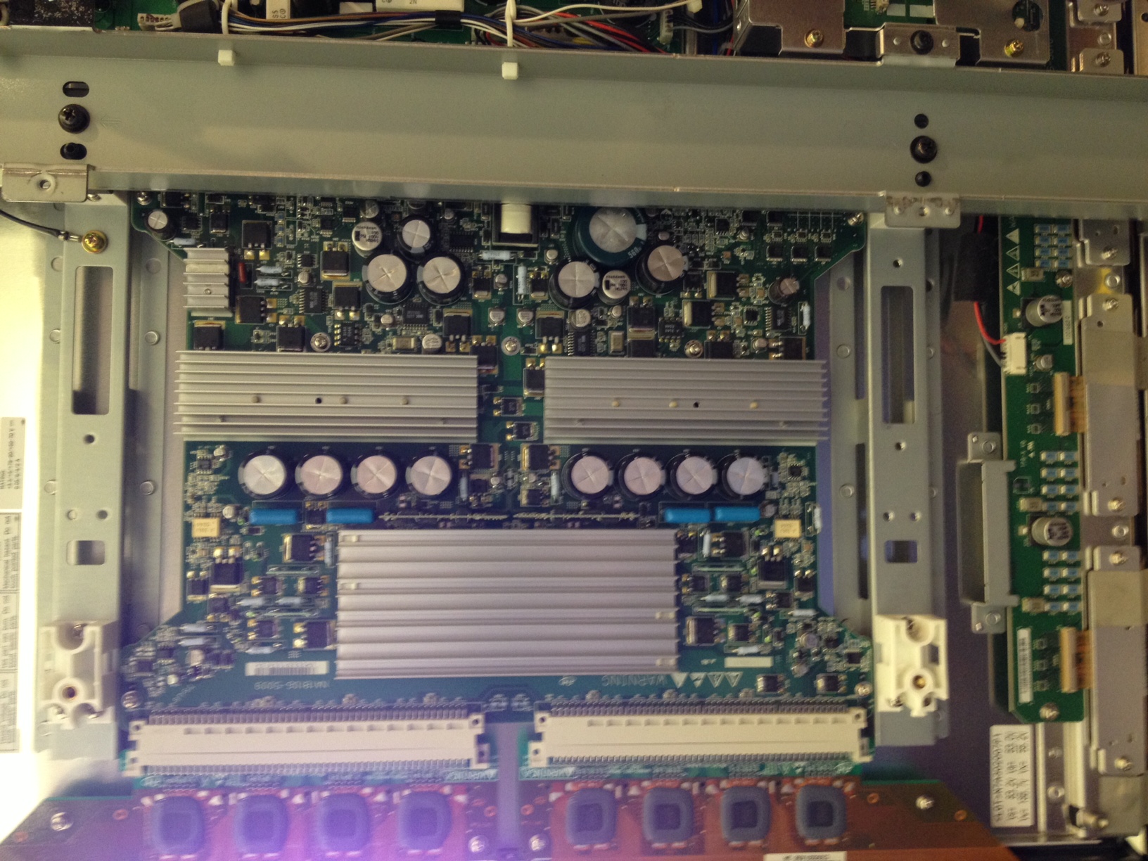

                                  The inputs are on pictures 4 and 5.
                                    Is there anything like a board under the input panel? Or just the jacks?

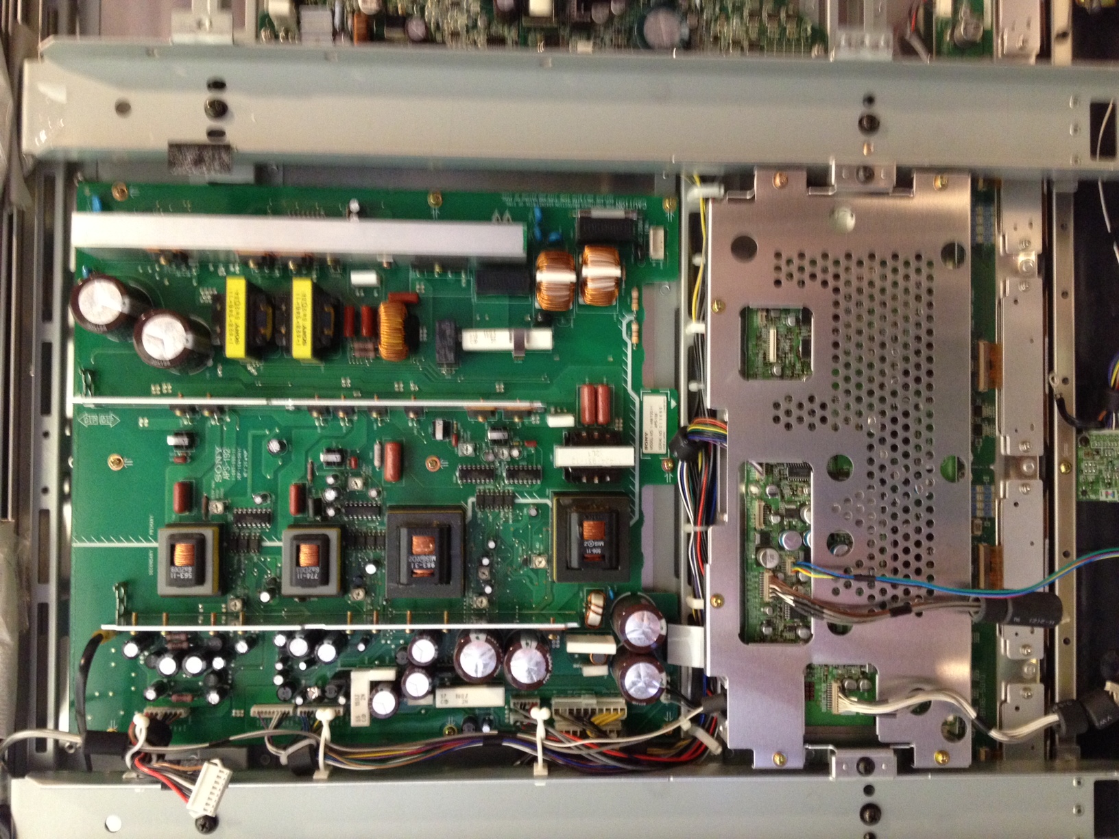

                                      Here are photos of what is underneath.
                                        Right, so it looks to me like that board handles the various video inputs somewhat separately and then feeds it in to the main board below those mentioned capacitors. (Input multiplexing.)
                                        It would be unlikely that all of the input multiplexing would fail at once, so I'm going to say that the fault most likely resides on the main board.
