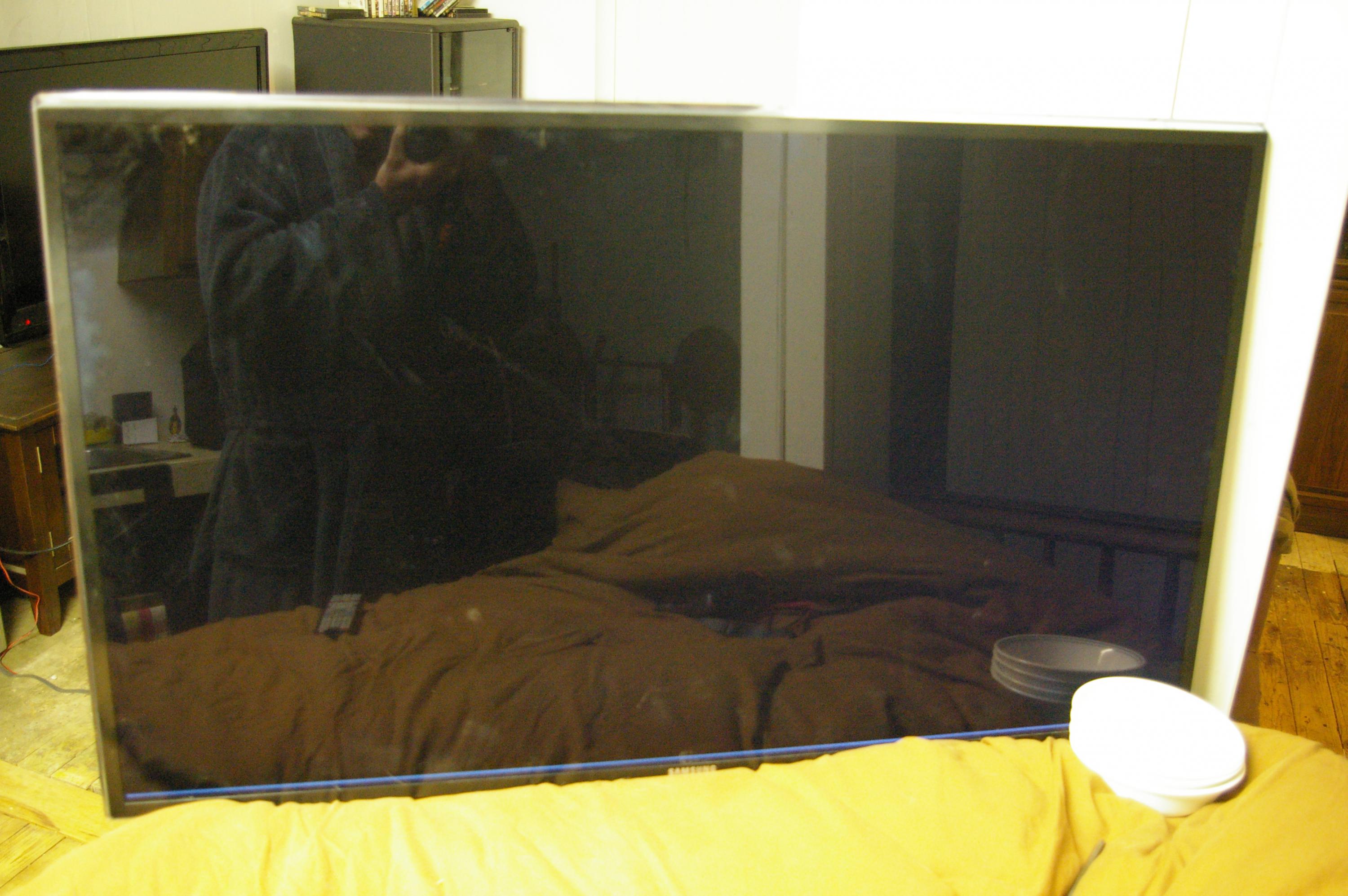

    im trying to post pictures right now, the screen is ok ,not broken
    when i turn the tv on they is a blue line that flash at bottom of screen but nothing more happen than it stop doing that.
    i have disconnected the tcon from the main board and the clicking sound are not happening.

      I've had a single pixel line on an LCD TV before... the LCD panel was bad. Try disconnectingone of the two white ribbon cables on this board:
      https://www.badcaps.net/forum/attach...5&d=1418210648
      Try with only one cable in at a time.
      If half the picture comes back, this would confirm the bad panel fault.
      Model number of the TV? Typically beginning with UE.... or UN.....

        model is un46d6500vf
        i tought the panel was the main board... ok the pannel is the board that connect with the flat ribbon.i dont know how to unplug those 2 flat wire?

          ok i found it,
          when i unplug only the flat ribbon on the right side the the blue line is half and still click. but when i unplug only the left flat ribbon i got half an image and no clicking sound
          if it is the pannel is there someting to do?

            Unfortunately the LCD panel (the "panel") in your TV has failed and this will not be economical to repair. One half of the panel has a short in the gate driver which is bonded to the panel. Hence why it works when one ribbon is removed.
