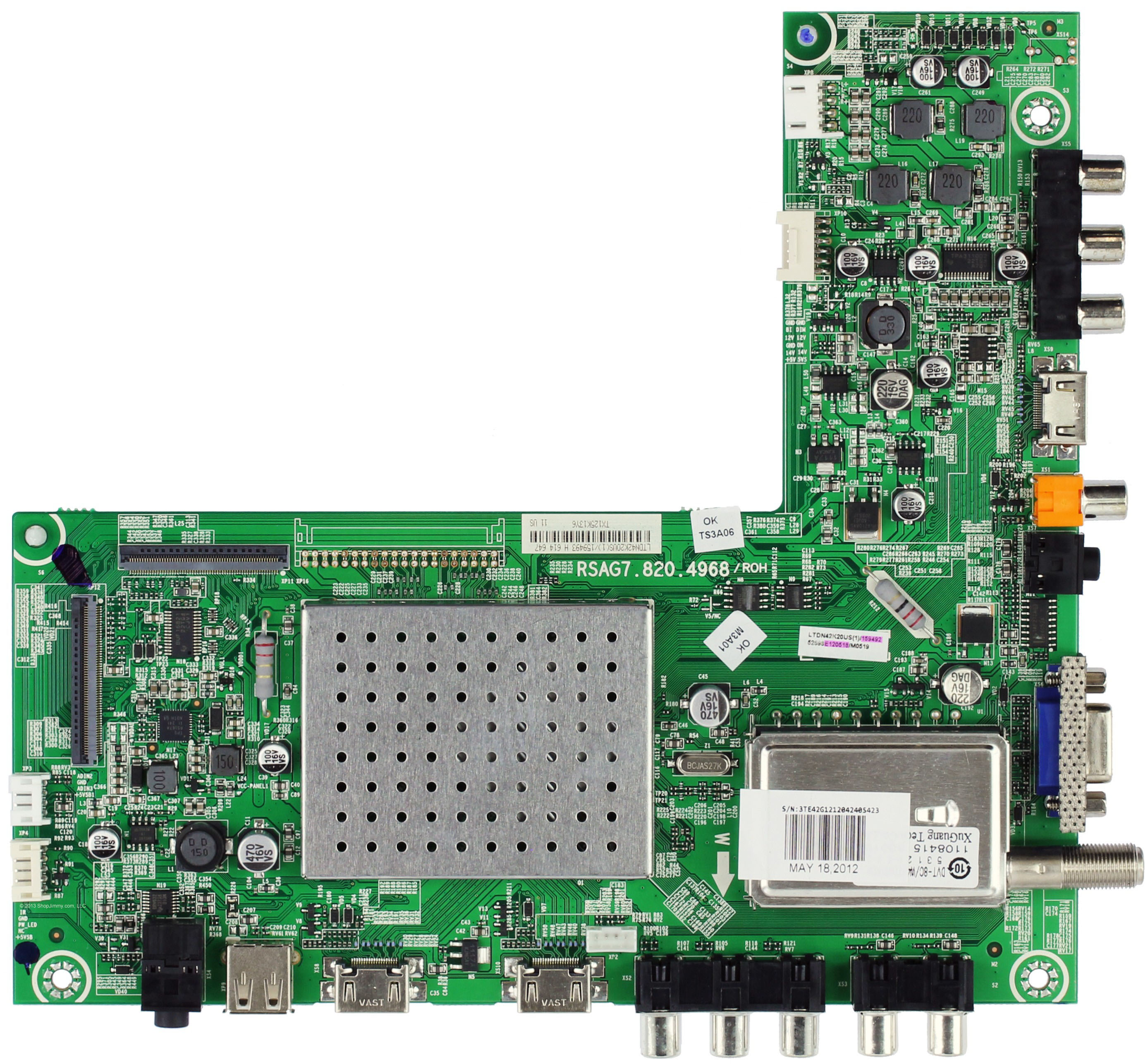

    This is an LCD set that won't turn on/off properly. I have 5V stb, 5v, and 14 V supplies on all the time. The LED supply doesn't come on. The on/off from the button board toggles, bur the power on on the power supply doesn't change(always low). There are a few regulators on the board. Most seem to test good. (5v in 3.2 out). One (I think it's a regulator) has 9.57v on pin 1, 0v pin 2 (center) Pin 3 4.98v. I can't identify the part. The markings are: CW78Do5, LZDDl5 (15?) , and MA104. It's the 3pin part just above the Tuner in the picture.
    I haven't been able to find a service manual. Can anyone help?

    Looks like a 5V fixed reg so 4.98V seems correct. May 2012, is that the date on your board? Warranty?

      Yeah, I kinda figured that it might be a 5V reg. I have 20 V on the power supply pins labeled 14v. Don't kn0if that's a problem or a misprint. 12V is fine.
        Technically if it is a 3.3V regulator, 3.2 ouput implies 3.2000 which is out of spec according to most datasheets.
        A 78D05 is your classic 5V regulator.

          That should read pin3= 4.98V so it is a 5v regulator with the center pin grounded. I guess the cw 7805 is a 5v regulator with the cw prefix added.

            May 2012 is the board manufacture date presumably, the TV would probably be at least a few weeks older (in terms of manufacture) and possibly months before it was sold, surely it has some warranty term left?
            CRITIC COMMENT: Not a bad main board layout, pretty well made for a "Hisense". No bodges. Power resistors are a little out of place on a mostly SMD board. 8.5/10; nice try Hisense.
              When I jumped on the SJ site, I realised where the photo was from so I doubt this is the actual board. The photo filename shows shopjimmy-159492-v.1-top.jpg

                Yes the photo is from shop Jimmy That's the same board numbers.
                Tom, I got this set second hand so I doubt they would honor any warranty and it's probably a "send it in" warranty.
