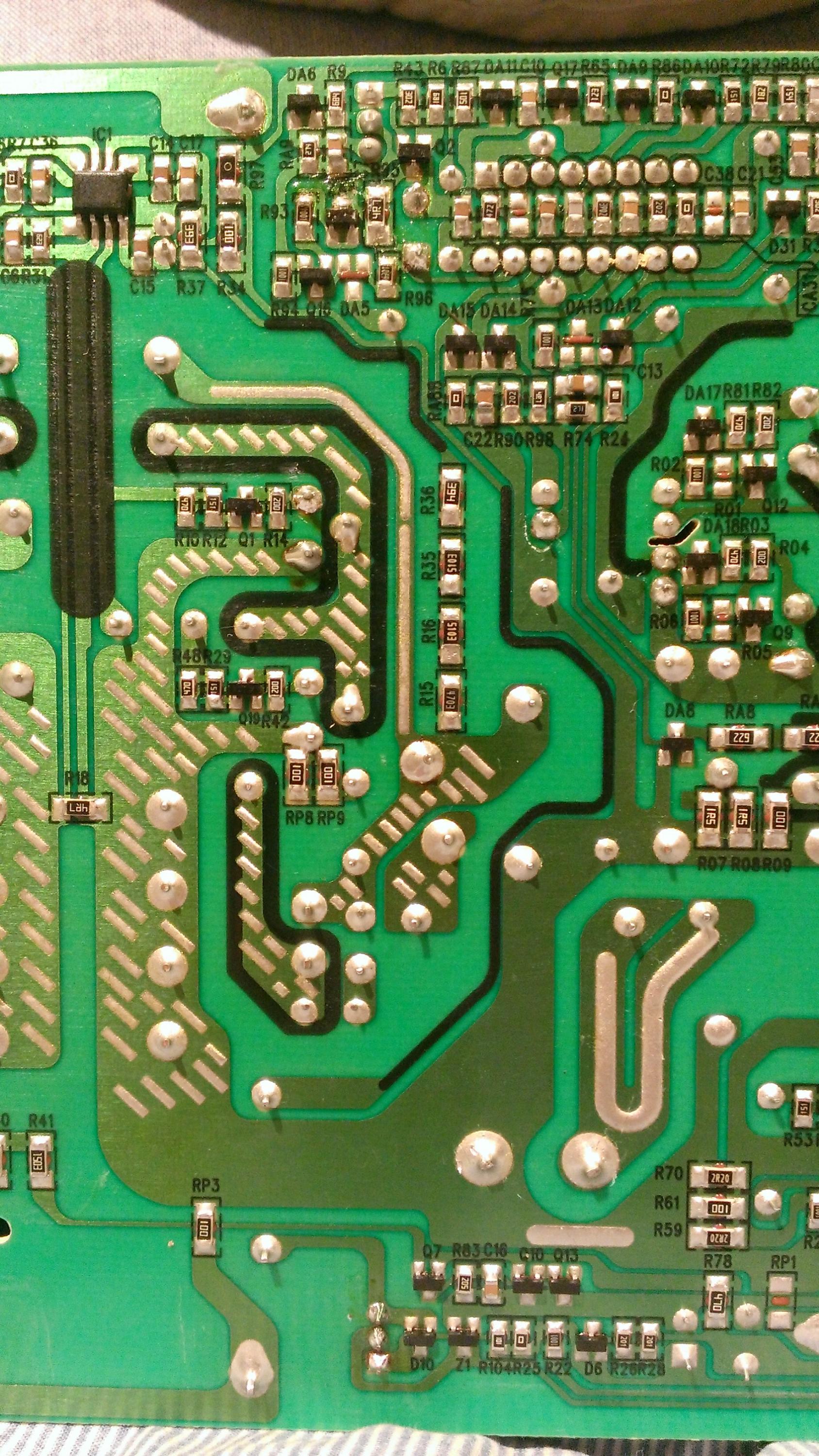

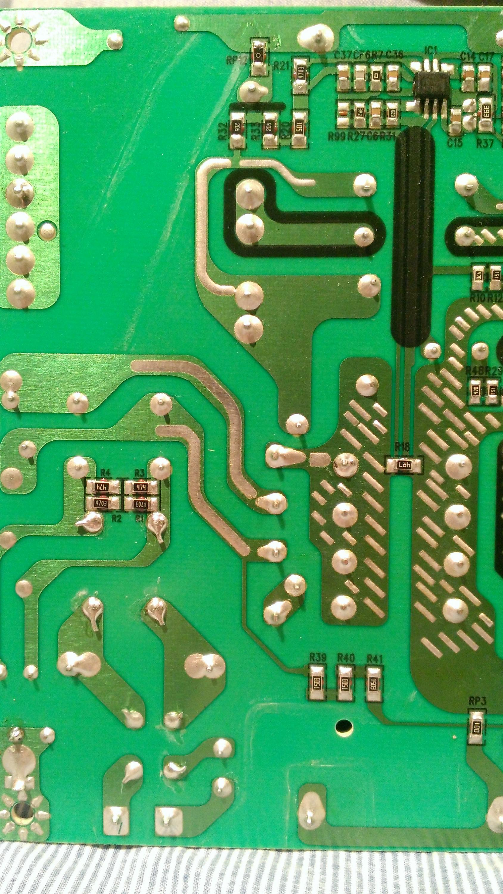

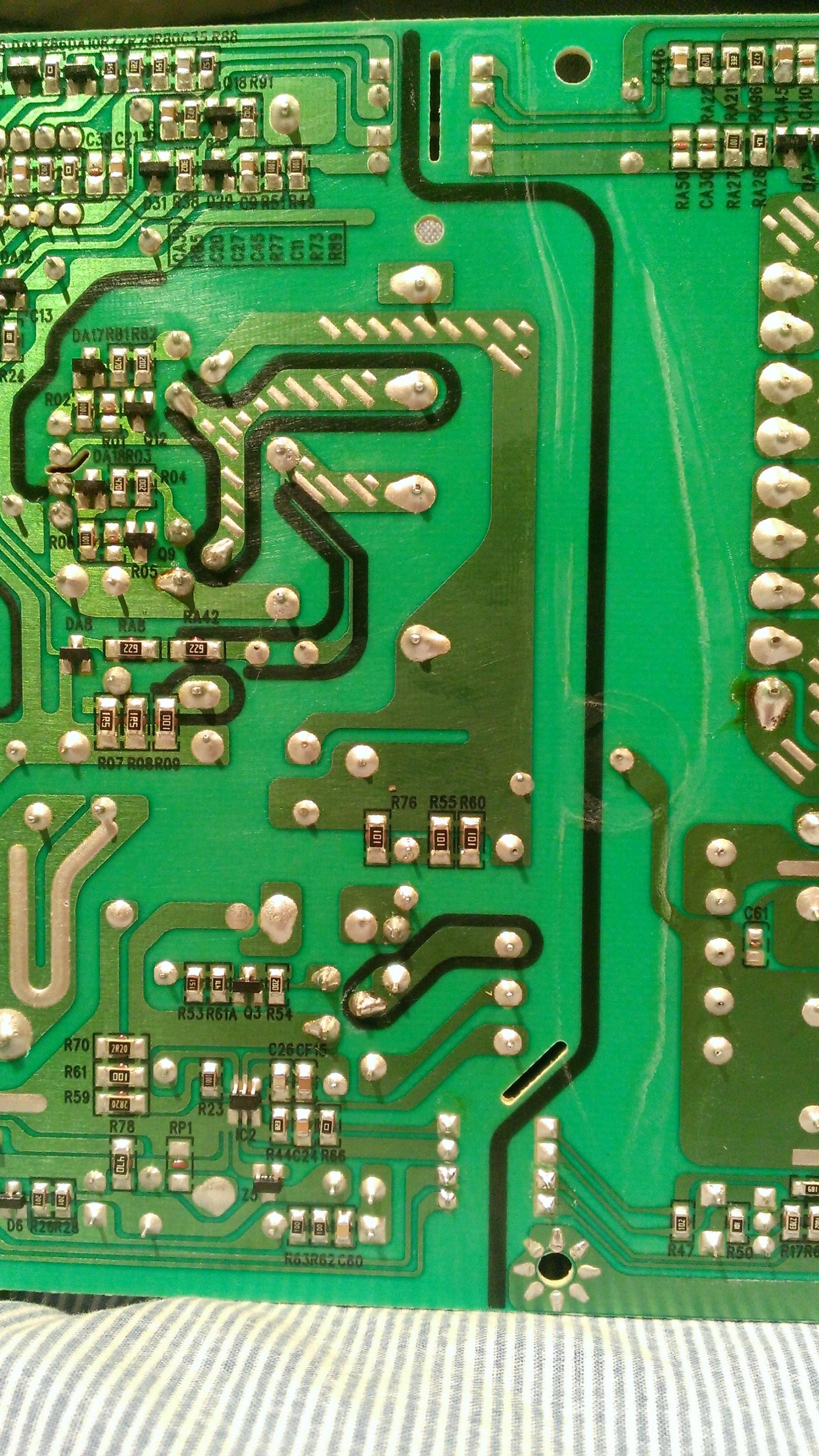

    Ill attach new pictures in a minute.

      Took forever to figure out a way to get no glare. Finally propped the board up vertically in a extremely bright room. Hopefully you can make do with 4 pics, if you really need 10 pics like you showed I can go take some more *sigh*...
      BTW clamp on part of the multimeter is worthless. I didn't buy it for electronics obviously, but for AC repair and what not , but the clamp only measures current and not voltage ...

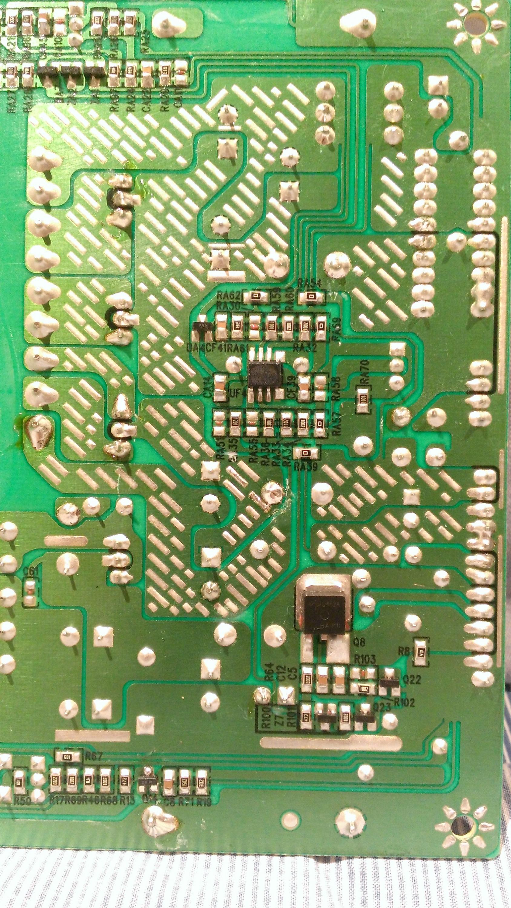

            Any luck? or knowledge gleaned from the more detailed pics?
            If your still having trouble making parts out I can take 10 smaller shots with a digital camera instead of that phone.
            Board is laid out horribly... cant see a p/n on a single damn one of the FET's and other to-220 parts.

              Re: element eldft551 not turning on
              From what I can discern from the secondary the large transformer creates 12v only then there are 3 identical power diodes (correct term?) mounted to the heatsink: 2 power diodes for the 24v section , 1 for the 12v .
              The smaller transformer leads to a power diode that creates 1 voltage follower by a dc regular (d452a) that makes it the 5v .
