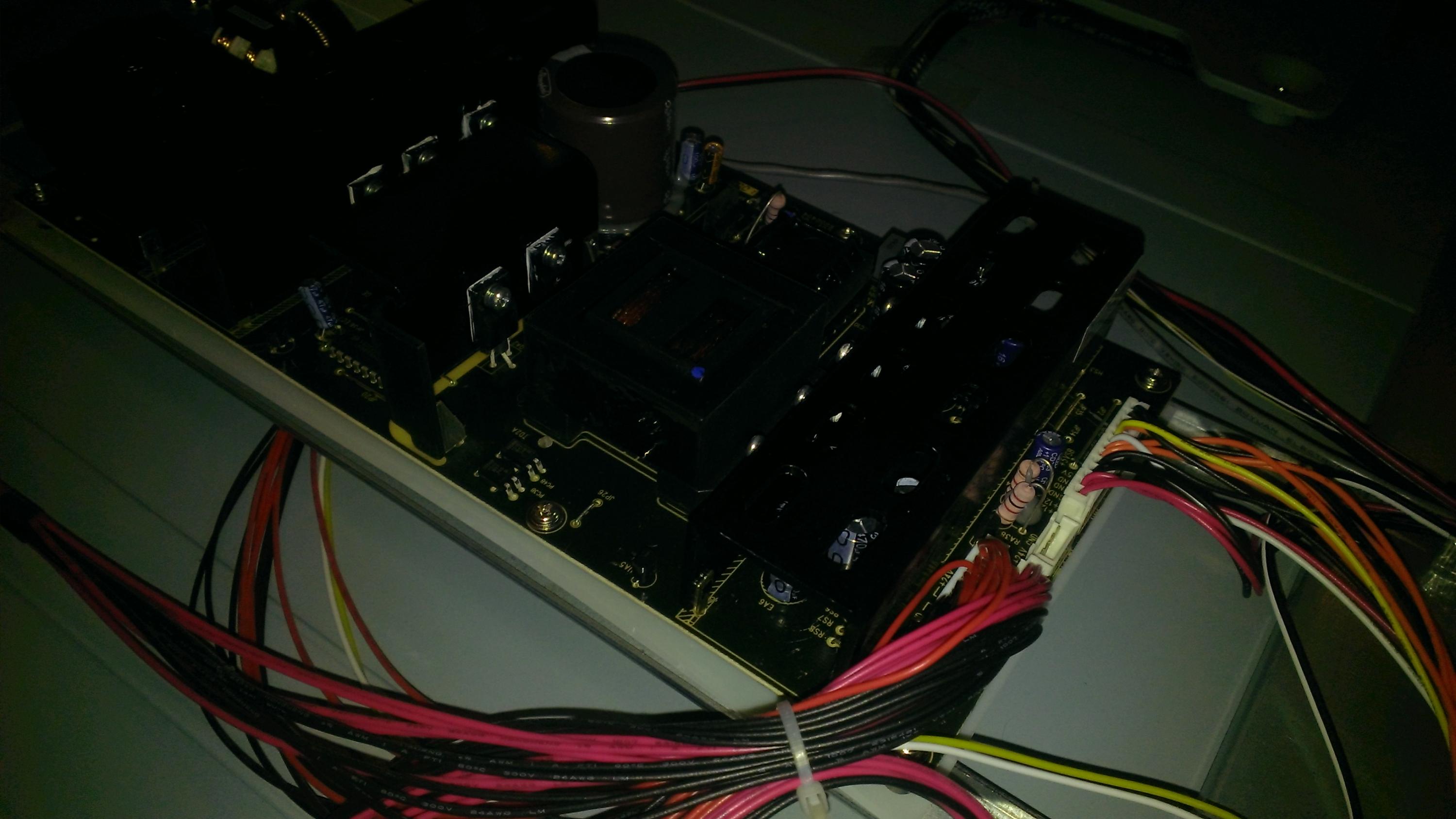

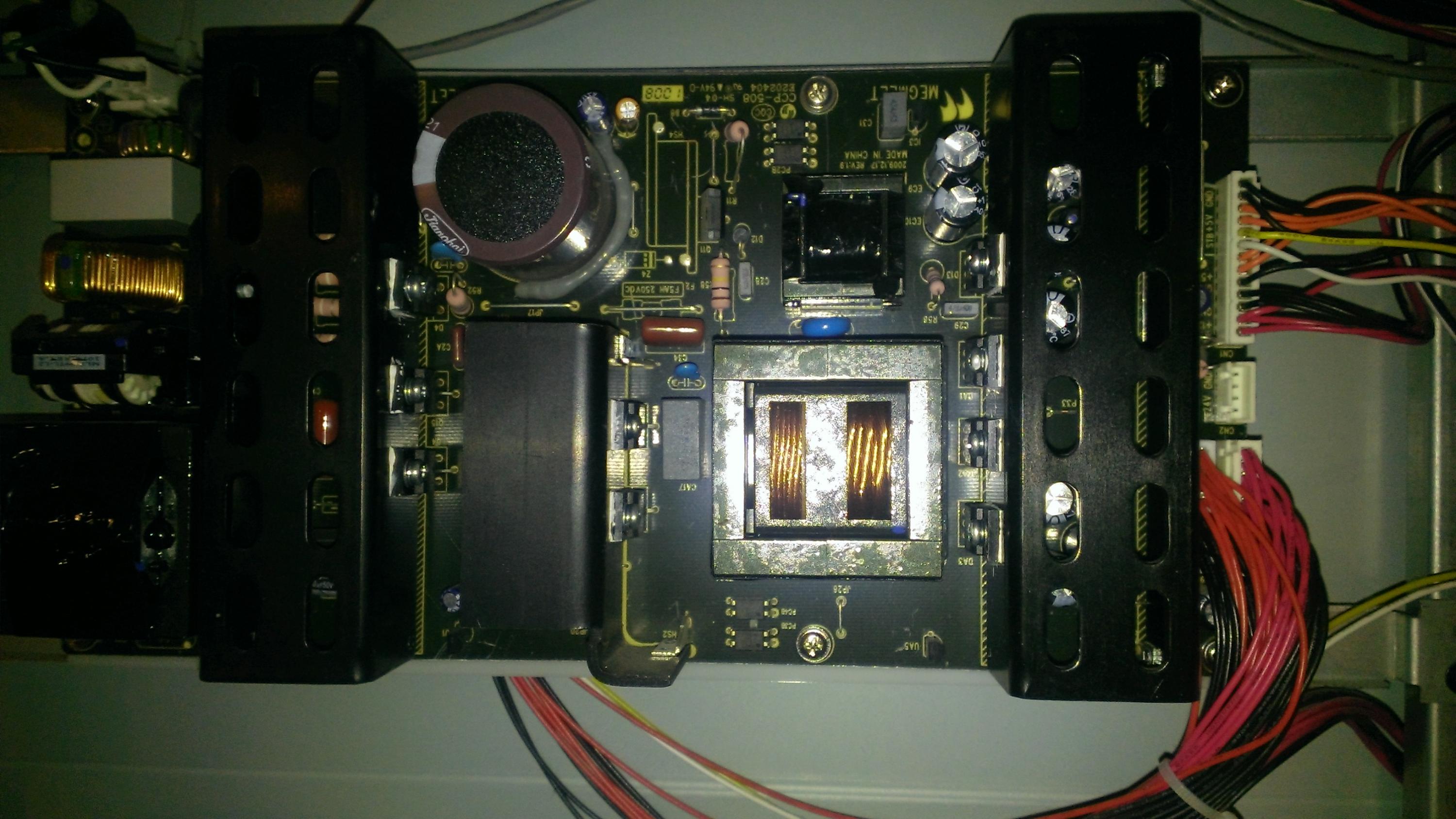

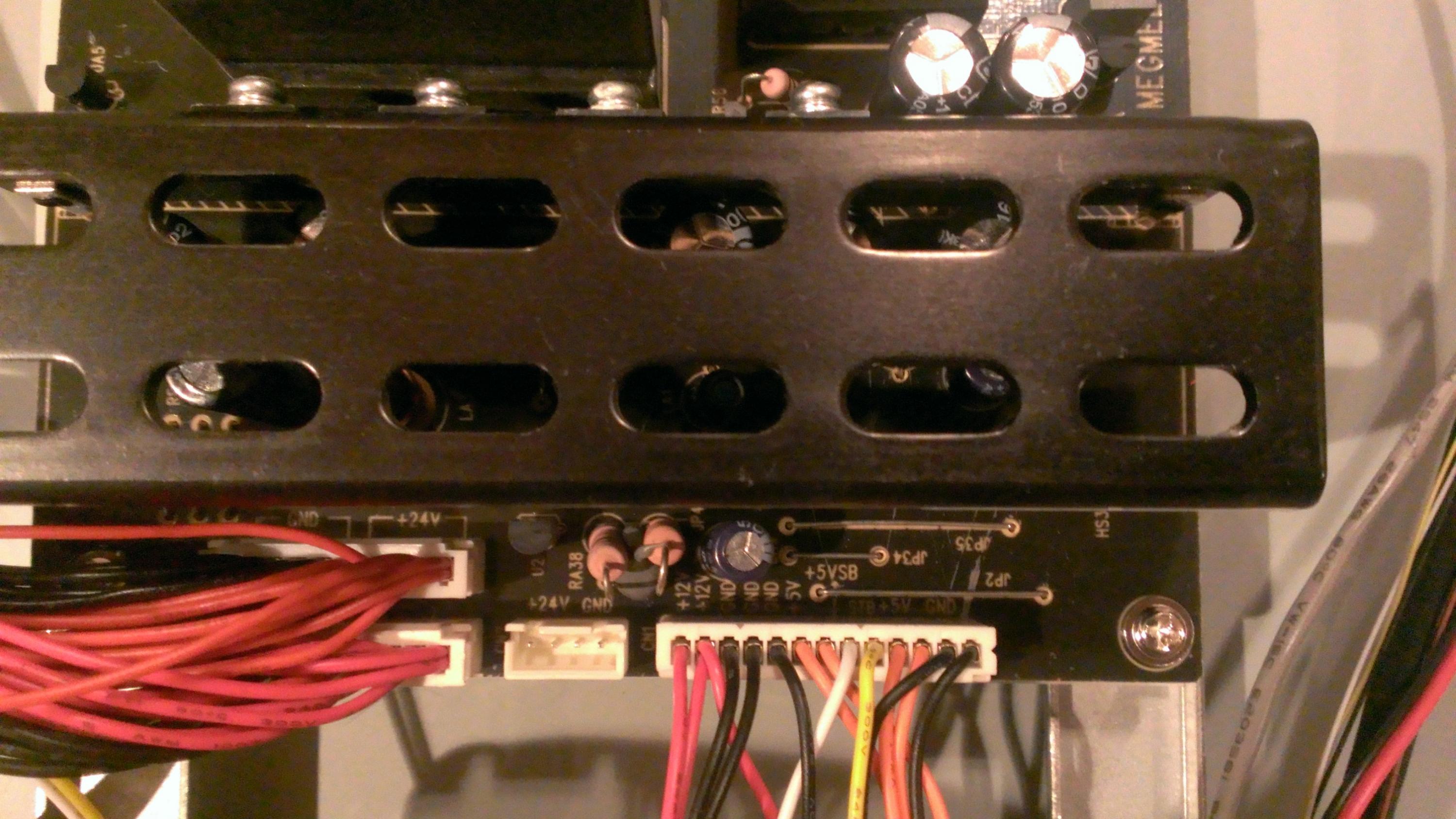

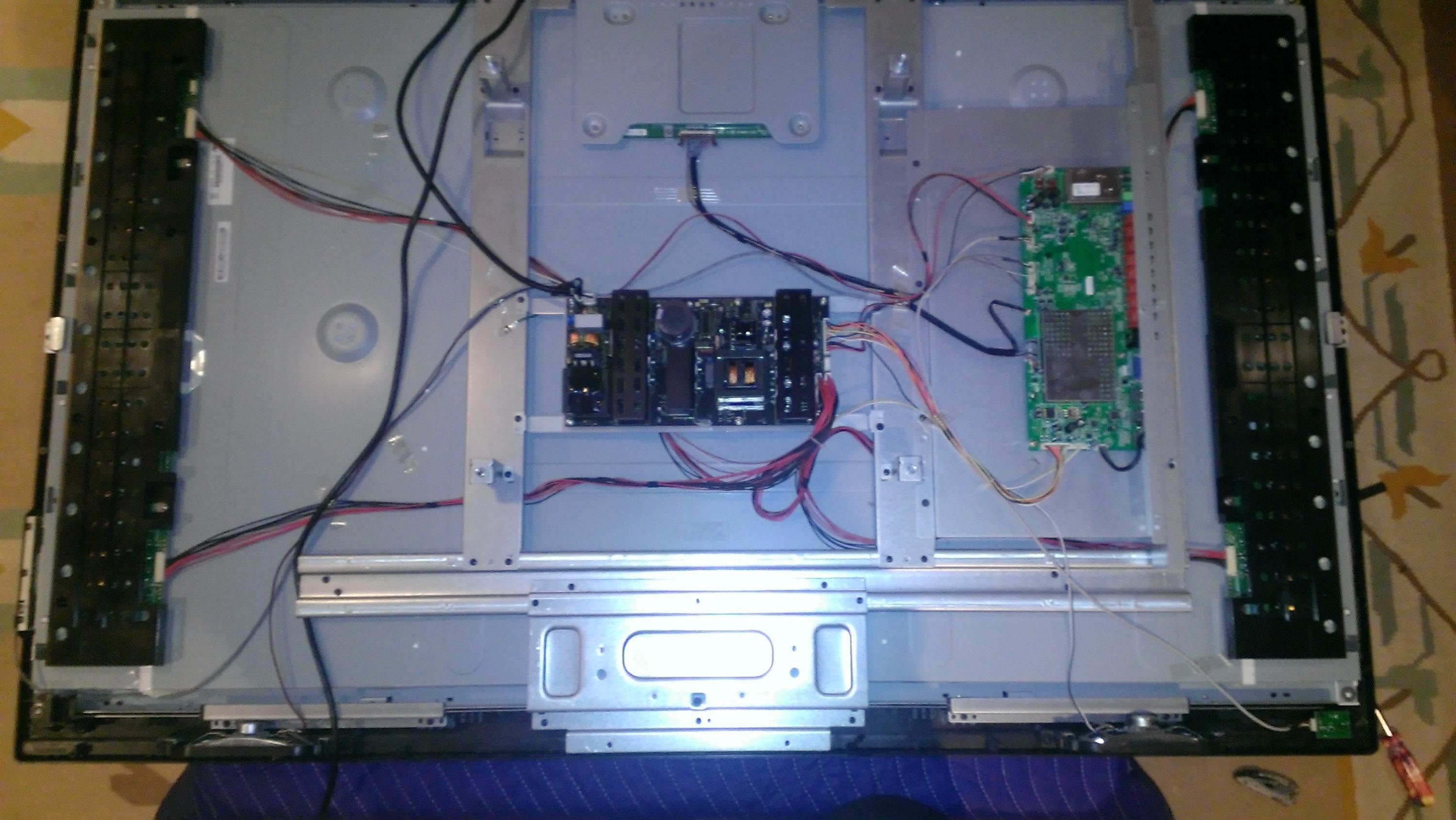

    I picked up this 55" element eldft551 where the symptoms are that you can turn it on and the power light goes blue, but other then that nothing happens.
    There were some hidden screws under the "label" that marks the ports (I think they changed the port layout after the plastics were produced), the previous owner had destroyed the back plastics cause he didn't realize there were screws there when he took it apart to try to fix it.
    I tested the power supply and there aren't your usuall "logical" markings so im not sure what pins it uses to know when to turn on. I did notice though that 5vsb is always 5volts and always there. Also when you first plug it in the 12v and 5v both come on, the 12v is a bit low (11.82 volts, this power supply has a bunch of crap capacitors from JH "" but unless there is a voltage monitoring ability that shouldn't be causing it to turn off the voltages) and after you press the power button the 12v and 5v voltages come on for around 1-2 seconds and then turn off , but the tv stay "on" with the blue led lit, and can not be turned off without unplugging. There is also a "stb" wire that goes to 4v when the set is on.
    The connector that runs to the main board (im quite certain its the only one that could be turning on the power supply unless morons are routing it through the inverter these days) is marked as
    GND
    GND
    5V
    5V
    STB < Stays at 4v when the led is on
    5VSB <always is 5v
    5V
    5V <comes on for a few seconds when plugged in and after pressing power button
    GND
    GND
    GND
    12V <comes on for a few seconds when plugged in and after pressing power button
    12V
    I tried jumping the 5vsb to "stb" with a 220 ohm resistor but that didn't make the power supply turn on (because I didn't see the blue light come on) , but perhaps that isn't the right logic so to speak and ill go see if the 12v and 5v come on for a second when I have the jumper in place.
    Sorry for horrible pictures, I haven't figured out the best settings to use on my new cell phone for indoor shots.
    Im gonna go look at elektrotanya for a service manual.

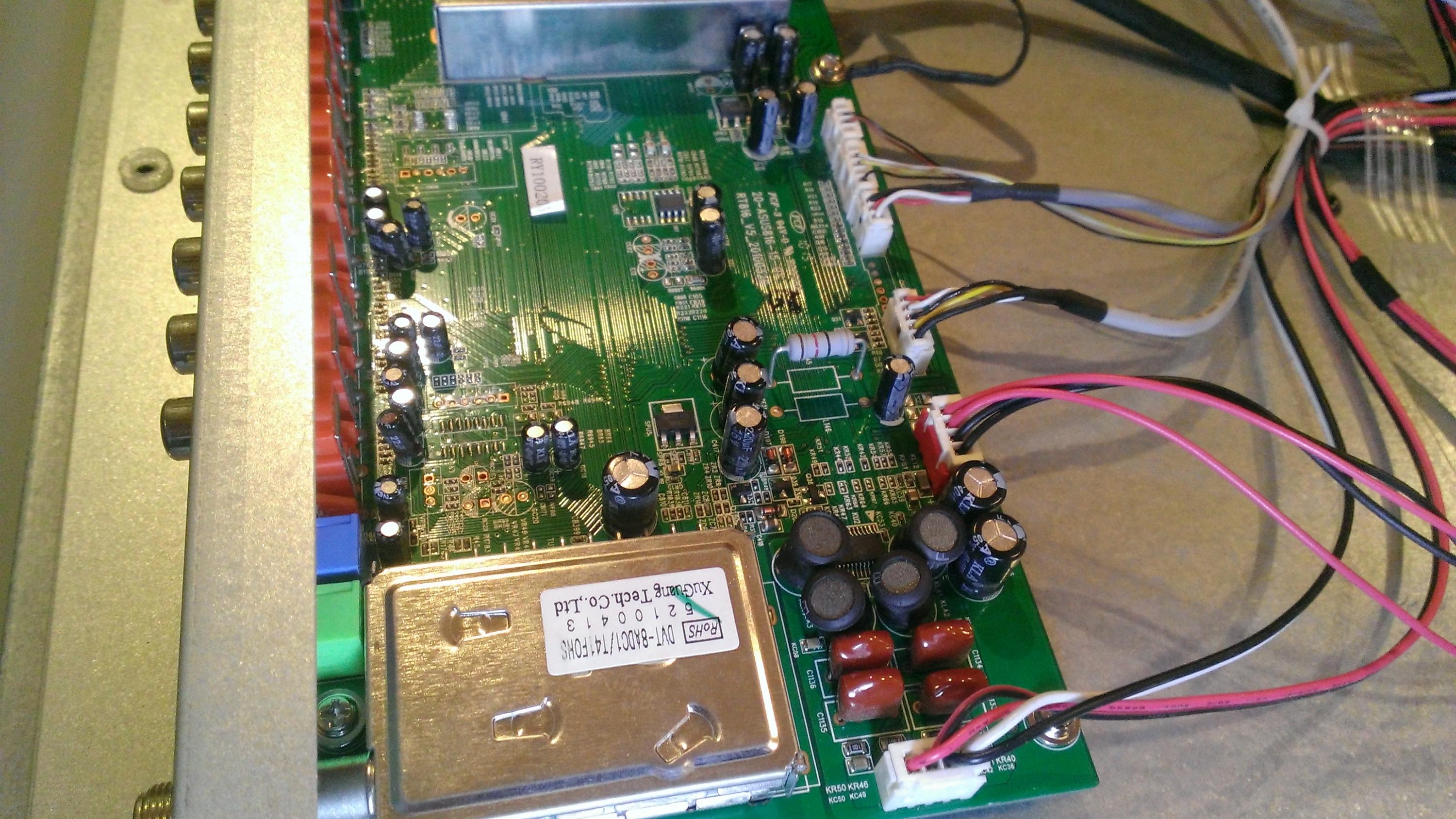

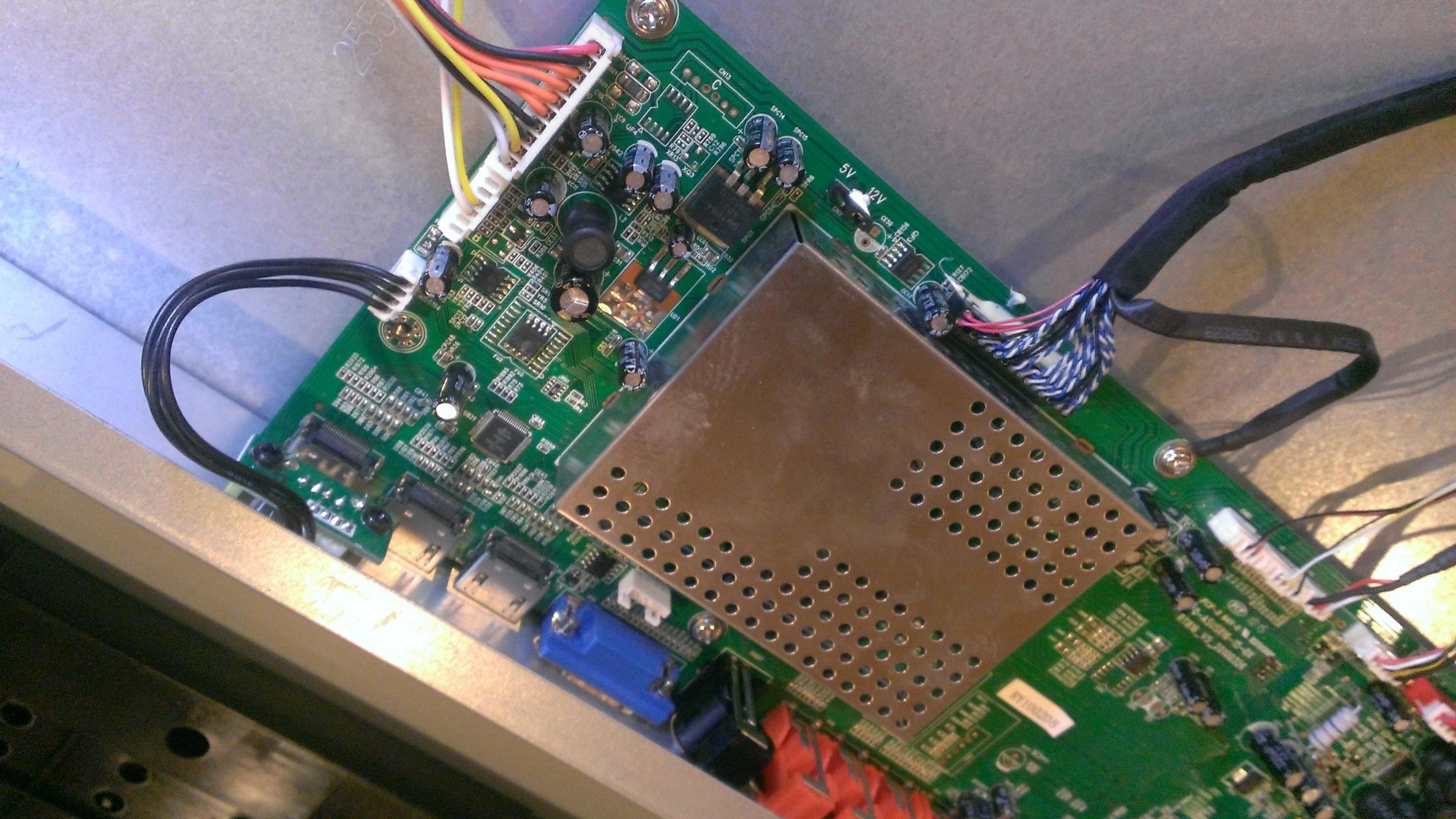

      Attached are some better pics, but tell me of course what youd like / if you want the backside of the power supply so on... seems my phone prefers no flash / and have to tap the part of the screen you want it to focus on
      The caps are all JH except for the large dc cap which is jianghai, so I assume all the JH stand for jianghai... the mainboard is all KLA... I think its great that Chinese companies can spring up over night have have a whole spread of different capacitor products, I mean if I was starting a factory I think I would focus on 1 series and perfect it, but these people somehow manage to overnight be turning out a thousand products...

              OK, you do have PS_ON (STB) signal of 4V, you can verify that again when the TV is off and when the power switch is activated. You should also see the 24V at those bundle of the red and black wires.
              Since this board has PFC Voltage booster, you need to monitor the voltage RIGHT AT THE TWO LEGS of that large 450VDC filter cap, it should go up from 160VDC (IN STANDBY), and the stay at aorund 380VDC when power switch is activated.
              One thing is not right is that you cannot turn off the TV with power switch, that will indicate the main board is not function properly either.
              You can also try disconnecting the 24V connectors that goes to the inverter boards to see if the 12v/5v/24V (they are generated by the same transformer) will stay on.

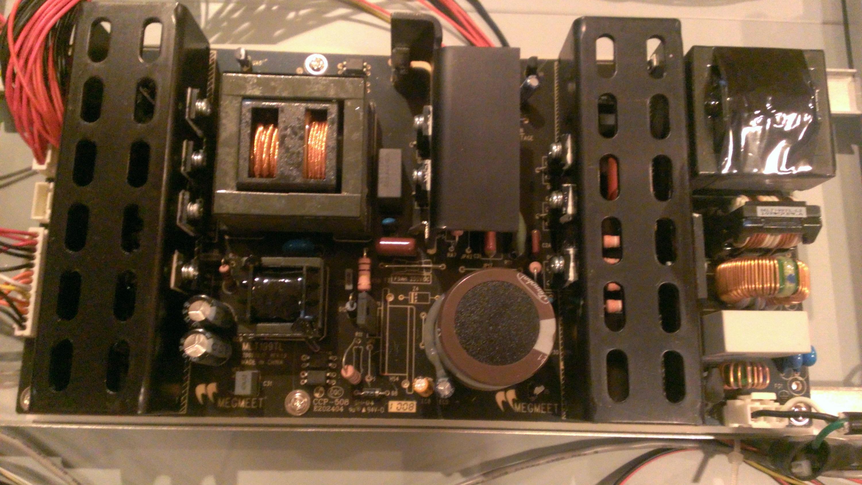

                    So the 380VDC is there and stays there after the 5/12/24V fade away, if that is the case then the PS_ON is OK, then we need to look at the 5/12/24V power supply section.
                    It the power supply MAGMEET MLT199TL?
                    There are a bunch of caps under the heatsinks also.
                    • cashkennedy
                      • Aug 2011
                      • 668
                      Re: element eldft551 not turning on
                      Yes it is a MAGMEET MLT199TL.
                      There are hidden caps under the heatsink on the secondary side (and 1 tiny startup cap hidden under the heatsink on the primary side). All the hidden caps are JH and all look as unbulged as the caps outside the heatsink that you can see... All the JH caps have extremly deep / agressive vent lines in what looks like some insanely thick material for a cap can to be made of (maybe the chinese think the cap will last longer if they like imprison the insides within a very thick steel can).

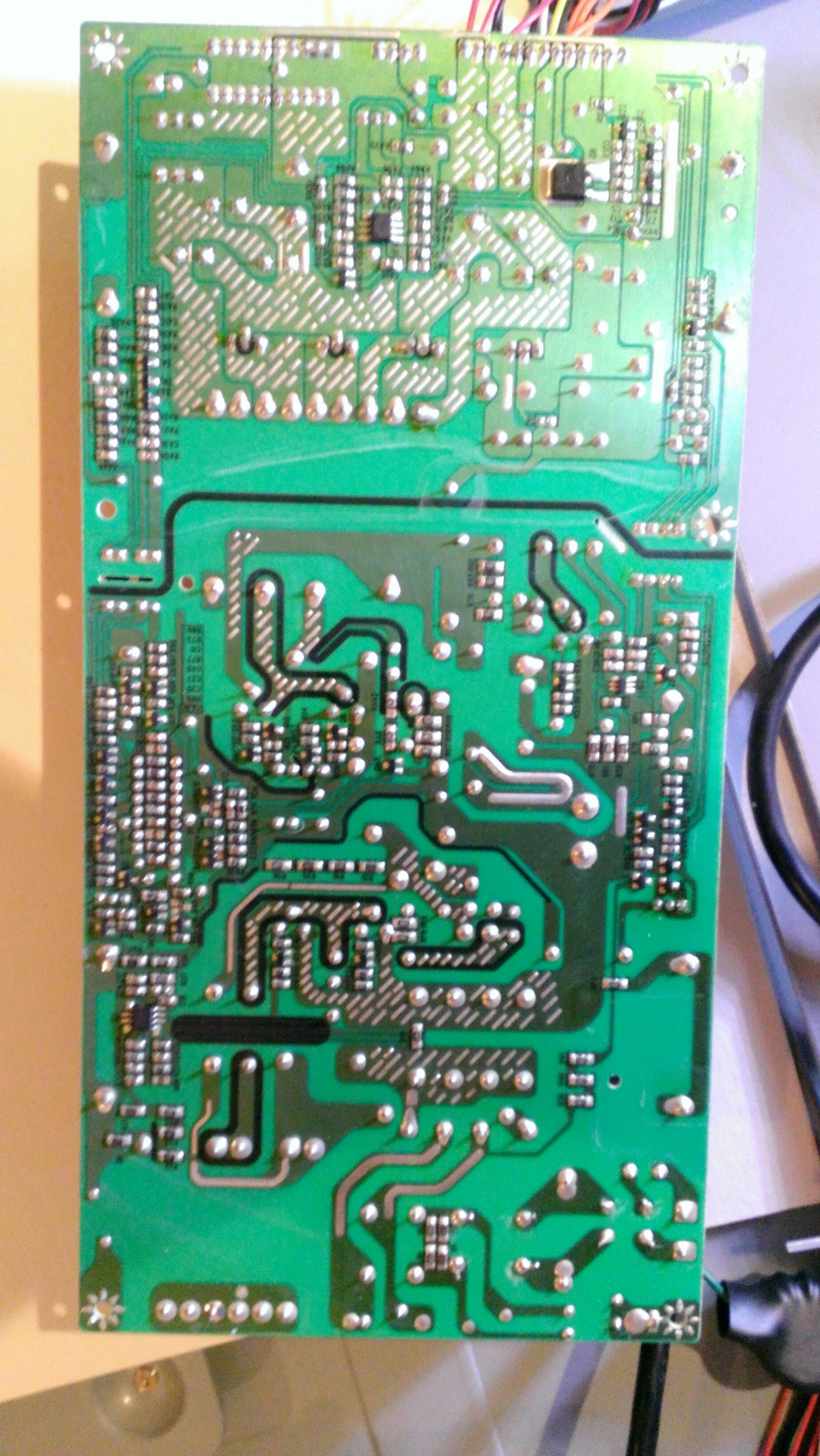

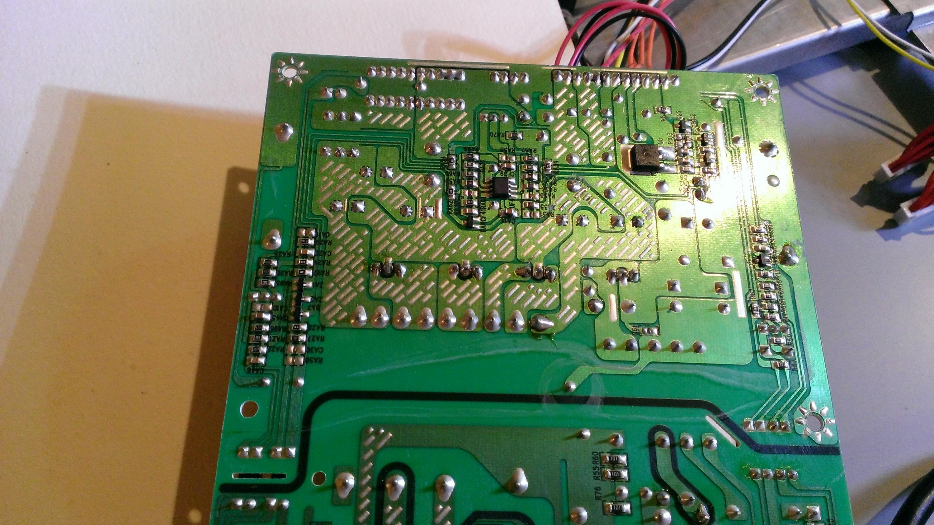

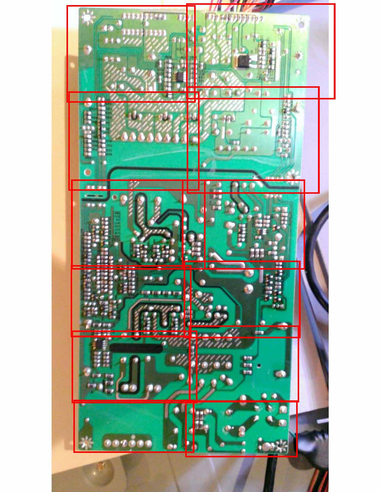

                          Since i now have the power supply unscrewed ill also take some pics of the bottom of the PSU and get the p/ns of any IC's on the secondary side.
                          There isnt that much under the secondary heatsink. Other the the caps i think there is just some ferrite inductors.

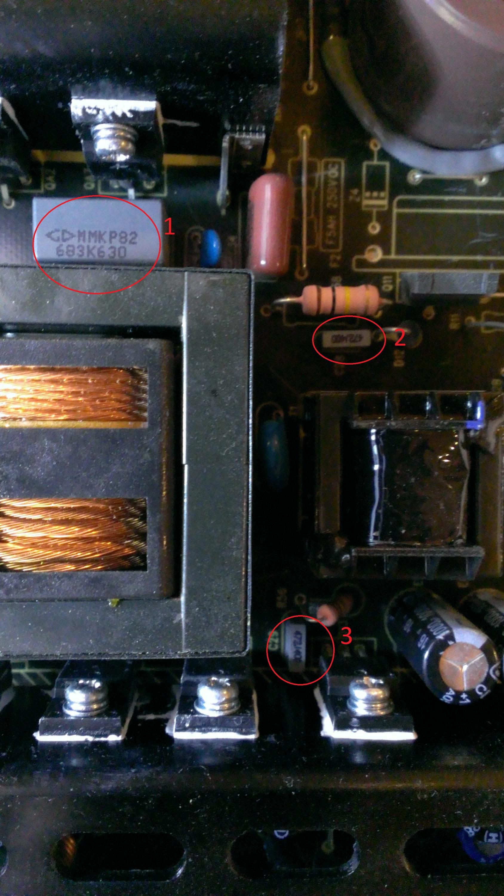

                              Ok now we can concentrate on the 5/12/24V switching power supply section.

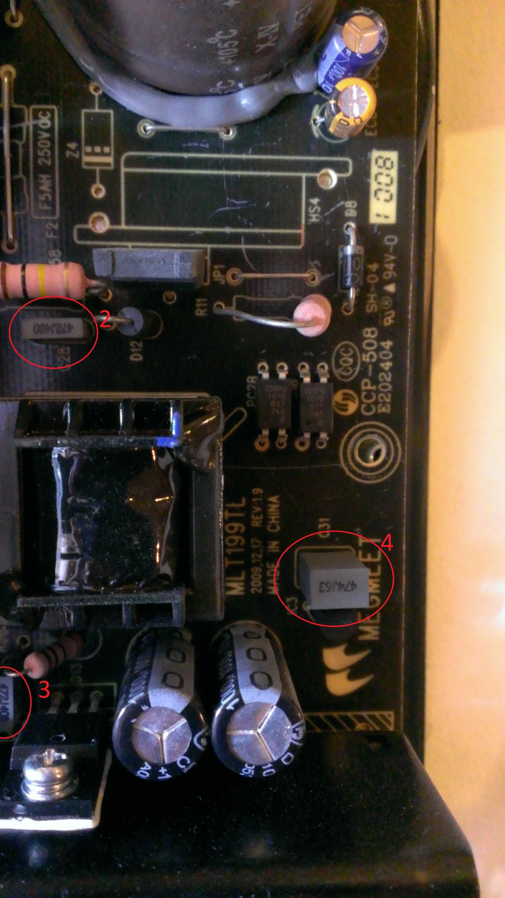

                              There is a gray rectangular cap between the big transformer and the two Mosfet's on the heatsing that drive he 5/12/24V transformer. Check the value of that cap and the solder joints on its legs.
                                It includes Darfon inverter schematics, Samsung power schematics (new LED and thin plasma too), FSP schematics, Delta schematics, and more.. I think it's from China, the land where "copyright" is a suggestion and not a law.
                                • cashkennedy
                                  • Aug 2011
                                  • 668
                                  Theres 4 grey rectangle capacitors , 2 in the primary, 2 in the secondary.
                                  I took pics and labeled them:
                                  1) CA17, <I> MMKP82 683K630, no resistance even on 2M (out of range or open)
                                  2) C28, 472J400, has a steady resistance that's rather high
                                  3) C29, 472J400, has a resistance that increases (cap charges)
                                  4) C31, 474J63, has a resistance that increases (cap charges)
                                  Im not sure how else you want them tested , but I don't own an ESR meter.
                                  This is a rather simple board actually / traces are all huge so you can probably make it all out from my bad pics. In the secondary there is 1 IC (markings are melted off I think) and 1 power transistor? ( alpha and omega d452a). The primary has 3 ic's , one on the front (sg3525an) and near that on the bottom of the board (J653a parw) and over by the main cap on the back is a tiny ic (62939)
                                  Fixed so far 12 lcd's , 1 plasmas, 5 monitors, 0 dlp's (plan to keep the dlps at 0). and 3 atx power supplies, and 2 motherboards.
                                    Do you have cap meter to read the capacitance? CA17 is the one I am interesting in since it is part of the primary side circuit for driving the 24V transformer.

                                        The picture of the bottom side of the board is way out off focus for me to trace out the connections. Can you take the pictures in segments so I can join them together into big picture? I still need good picture of the whole bottom side.
