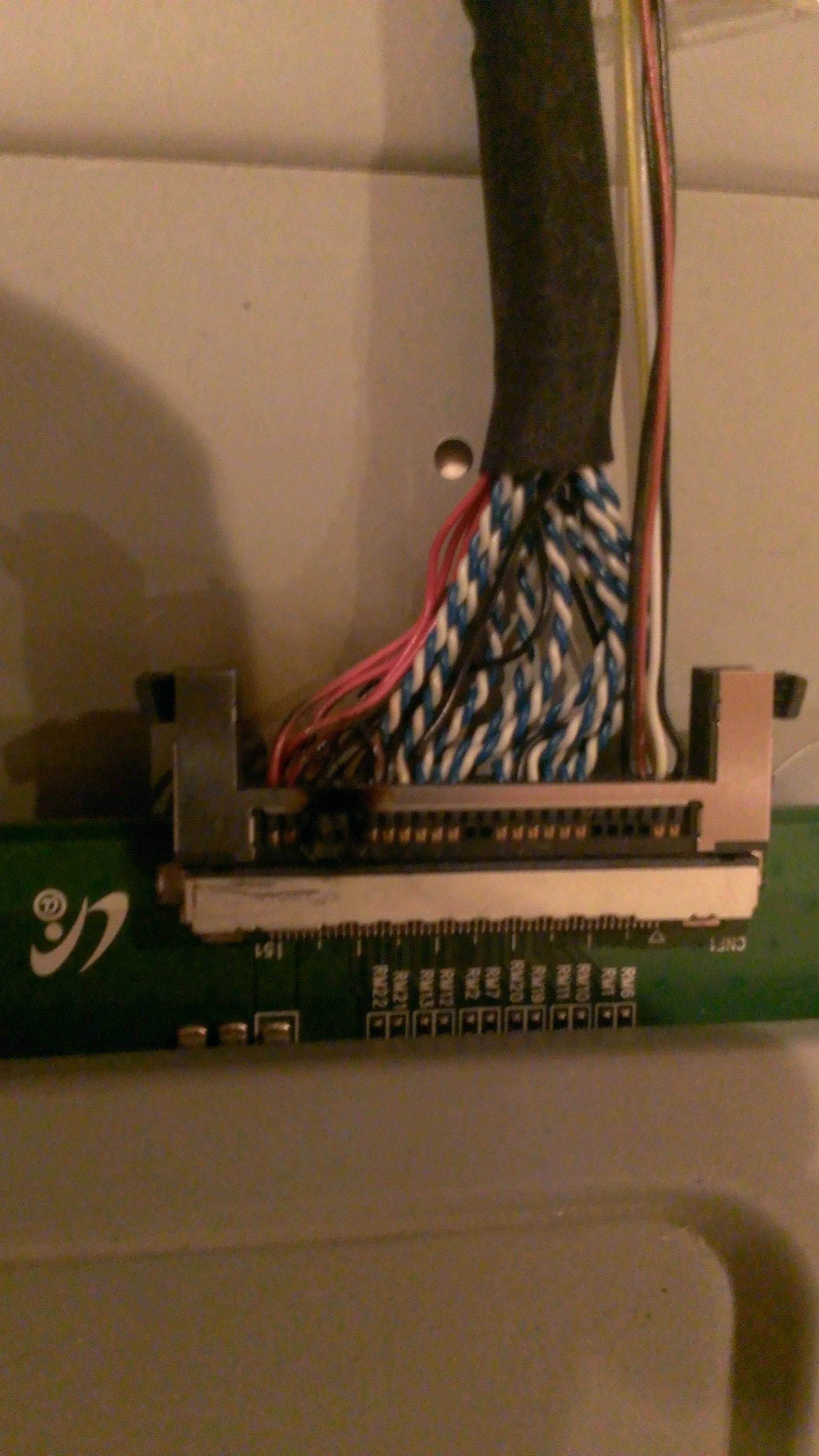

                          Re: element eldft551 not turning on
                          The piece of carboard I had the power supply on had some cellophane on the back / the cellophane shorted a few lvds wires together / burnt the connector out / destroyed wire and tcon as far as I can tell.
                          The LVDS on this is fairly unique to the set (with the extra separate wires / connectors on the mainboard) so Ill probably need a true replacement , not just make due with stealing one off a similar cmo panel set.
                          http://www.ebay.com/itm/ELEMENT-ELGF...item416c9d04e0 might have to buy that , still looking.

                              #74
                              I was pretty sure q18 was bad as it had 3 diode readings (see readings about 5 posts ago), I removed q18, power supply works great now , all voltages stable.
                              Only down side is that I started the set with cellophane over the lvds cable , and it shorted the cable, that burned a hole in the lvds and the connector on the tcon.
                              If this seems unlikely / and you think something else related to be removing q16 / starting the tv with out the power supply well grounded might have cause the tcon connector to fry, then tell me . I sure as hell don't want to buy a tcon and lvds cable (looks like ill be spending around 30 total) just to have them go bad again.

                                #75
                                The short story on how I isolated Q18 and decided to test it really carefully is > that I got .6 volts right after the opto, but 4.1 v on the shutdown pin of the IC, so knew the error was inbetween. Realized there was basically 5V on all 3 sides of Q18 so decided to test it carefully.
                                I just went back and tested the voltage of all the LVDS outputs from the mainboard with the set on, and the red wires on the LVDS read 12vDC, and 0v for all the black wires , and .5-2v on the LVDS pairs. So hopefully that's a good sign that the fried LVDS cable wasn't from the actual signal being transmited, but hopefully from the cellphane shorting it.
