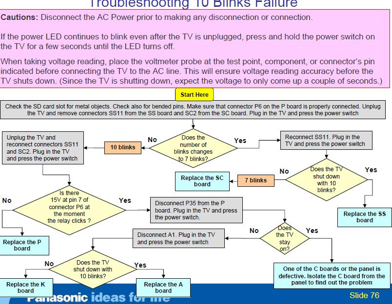

    Hi all.
    Does any one know the fault area when this TV displays 10 flashes? Is it the same as the older pana plasma power supply fault.
    Re: Panasonic txp50u20b
    It's usually the A board.
    • tw2005
      • Oct 2011
      • 6458
      I'd start with isolating the SC & SS board connectors and see if it changes just in case one of those are shorted.
      • blib
        • Feb 2012
        • 56
        Tom. Is that the video board ? Any idea what goes wrong on it?
          A Board is the video board yes.
          No I'm not sure, though I have a good feeling it is BGA bondings, like the Xbox 360/PS3 had, as some TVs before showing this failure apparently reported video and audio glitches and it can be intermittent.
