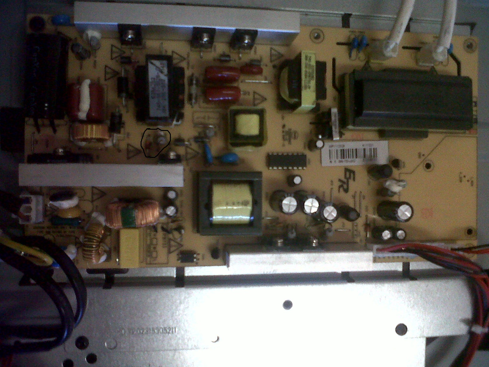

    hi all im working on a telefunken tv model tlcd-32hda
    the problem is when i connect the tv to power the standby light is on and i can hear the relay wants to click but it not i have tested for respective voltages even on the mainboard i tested the lvds connector on the mainboard but i am not getting any voltages on the pins any help please ?
    i have looked for bad and bulged capacitors but all the caps are good
    thanks in advance guys

    Can you explain how you can hear the relay wanting to click?

      Re: telefunken
      its like it opens and closes very fast i do get all the voltages i checked the mainbord as well and do get voltages from the regulators on the board the tv does not want to switch on at all and i want to save it from being trown away again i got it from my neighbours garbage can please help
        Re: telefunken
        You will need to post clearer photos for us to work on.
        Have you checked the PSON and 5V standby voltages? Do you have a DMM?
