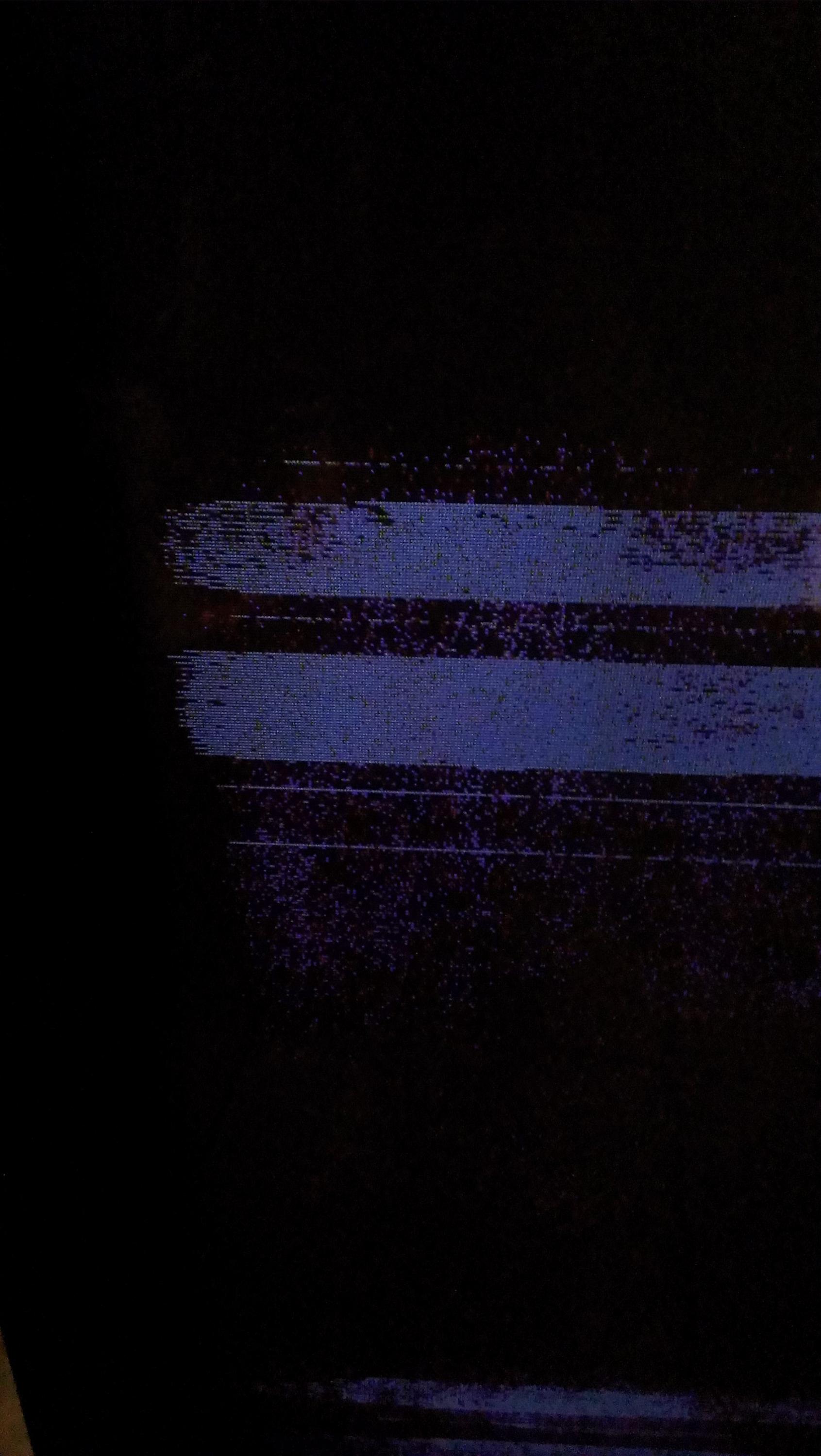

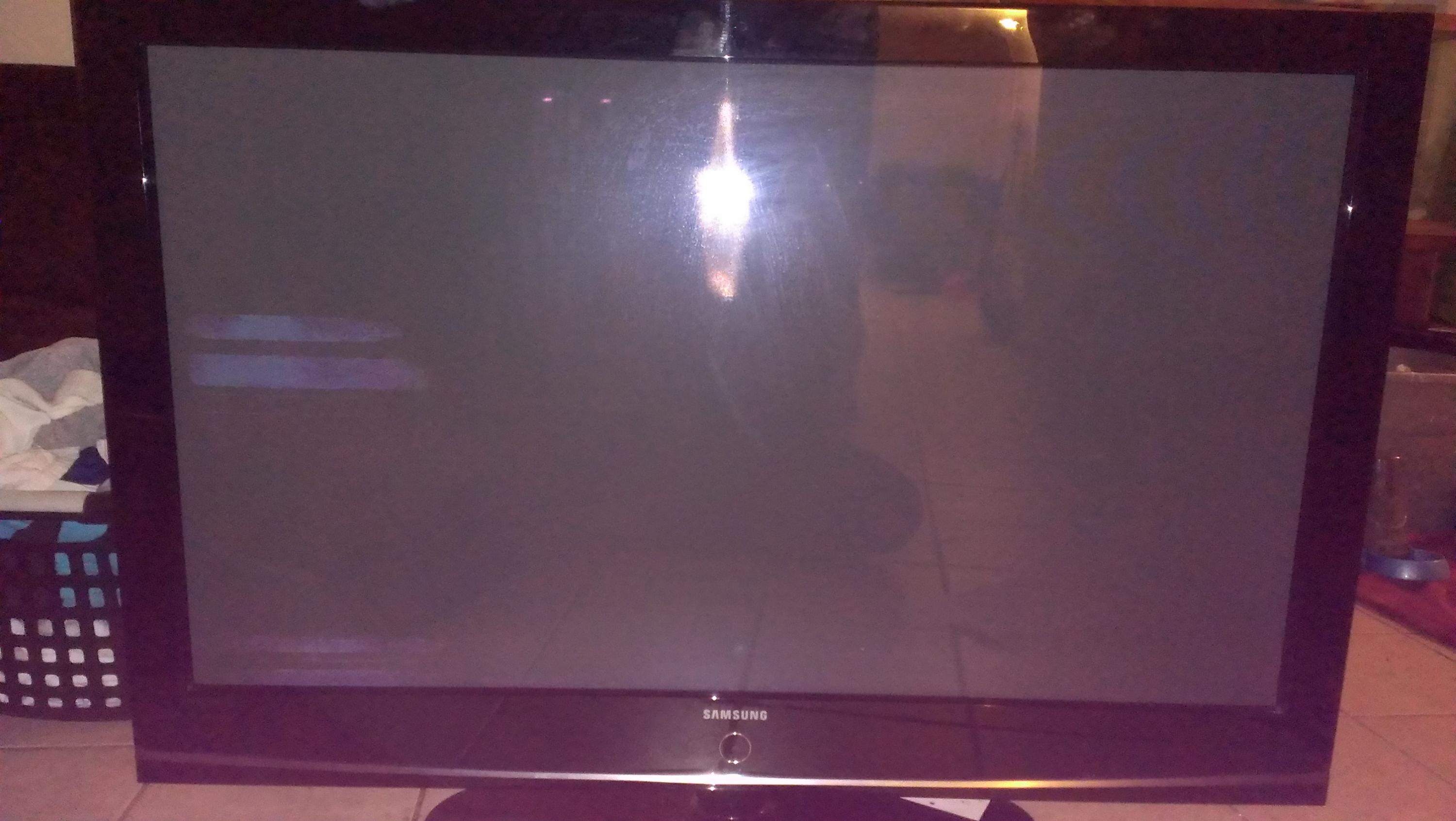

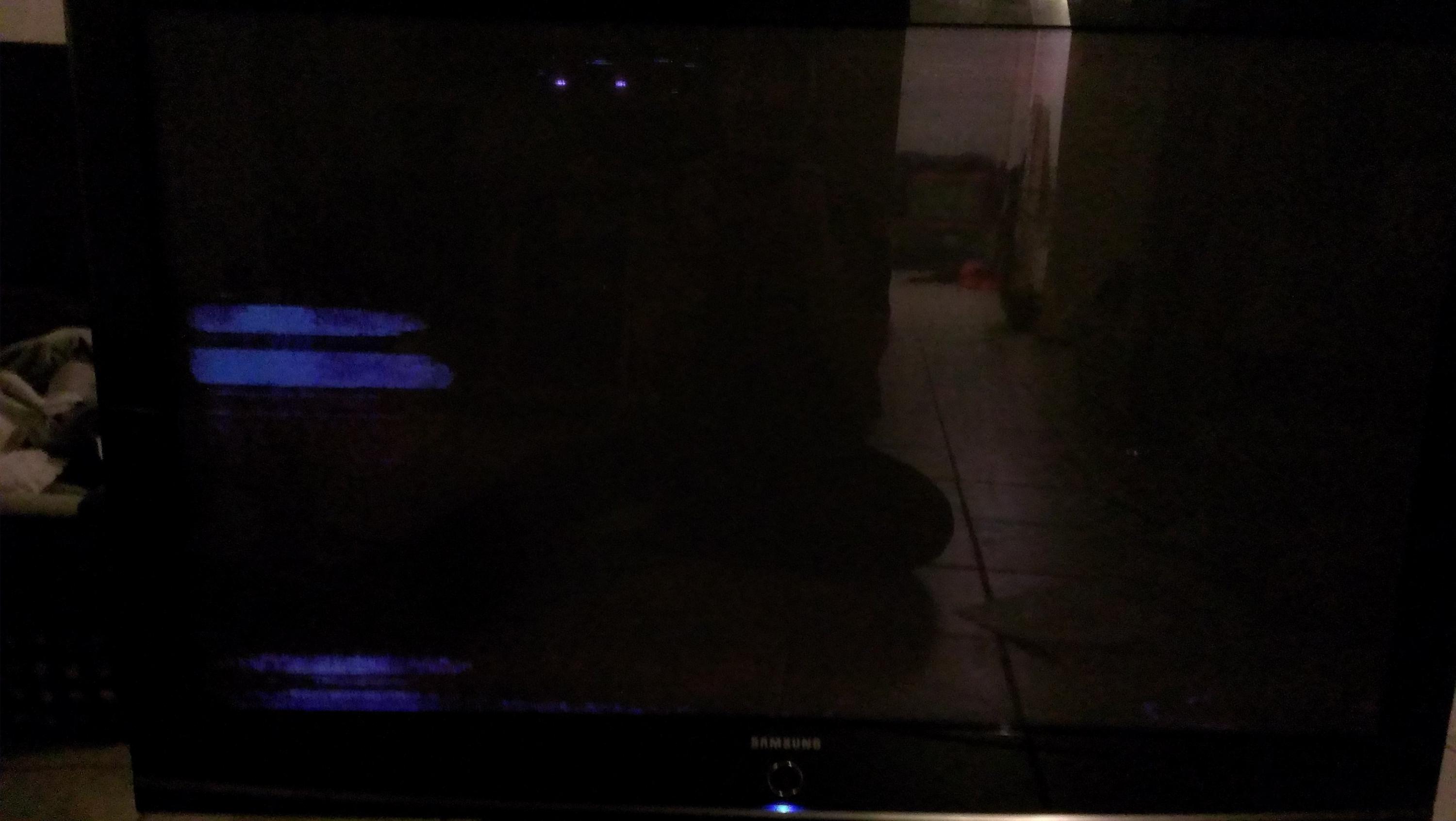

    Unit powers on, plays the startup melody.
    I get *some* output from the panel with no sources plugged in. Pressing menu, volume, etc changes the display slightly.
    I'm thinking logic board? I guess the first step is to short the jumpers on the TCON and see if the test patterns work?

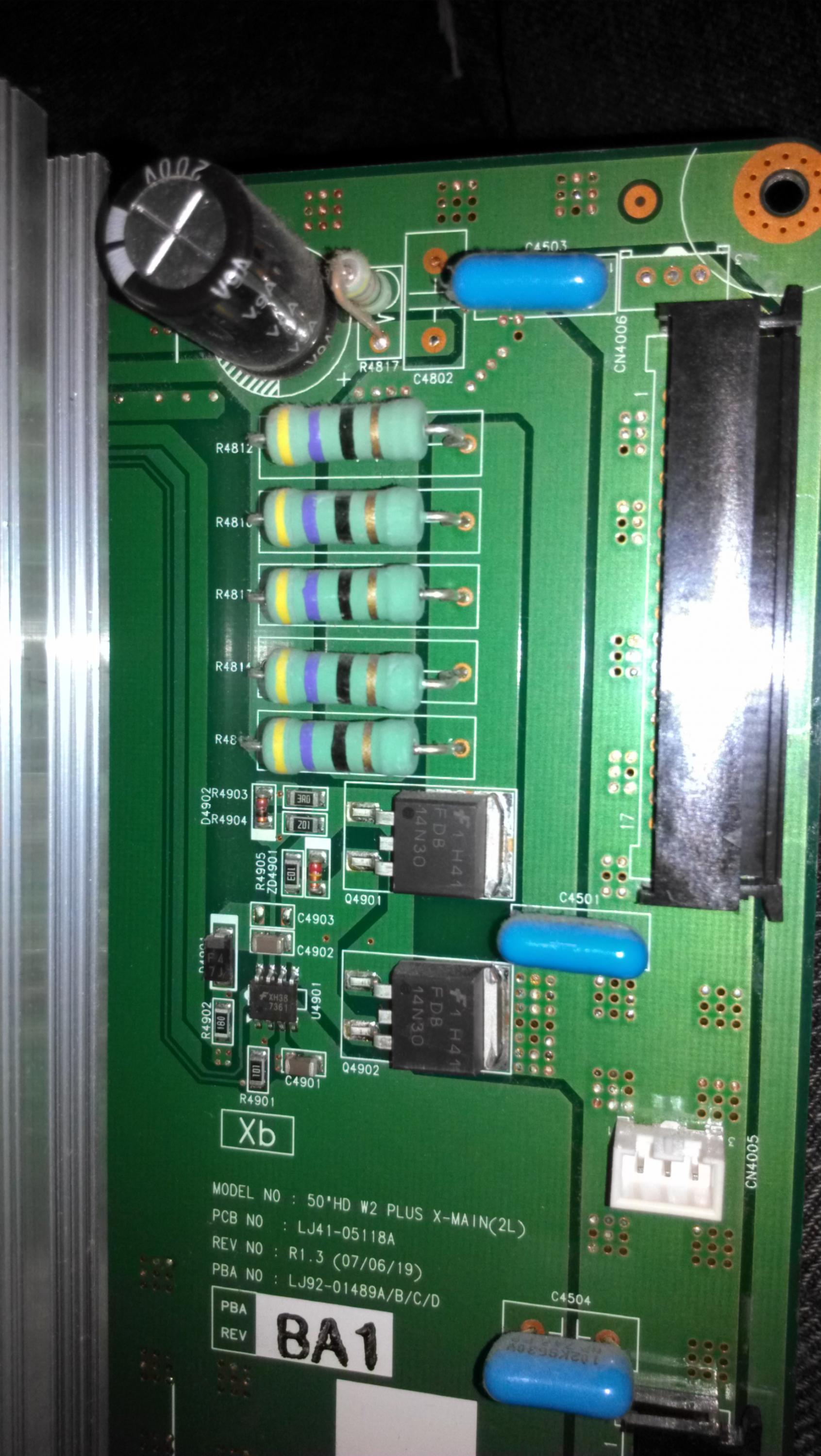

    Re: Samsung HPT5054X powers on, but only shows a few lines of distorted video
    I'm going for X-main.

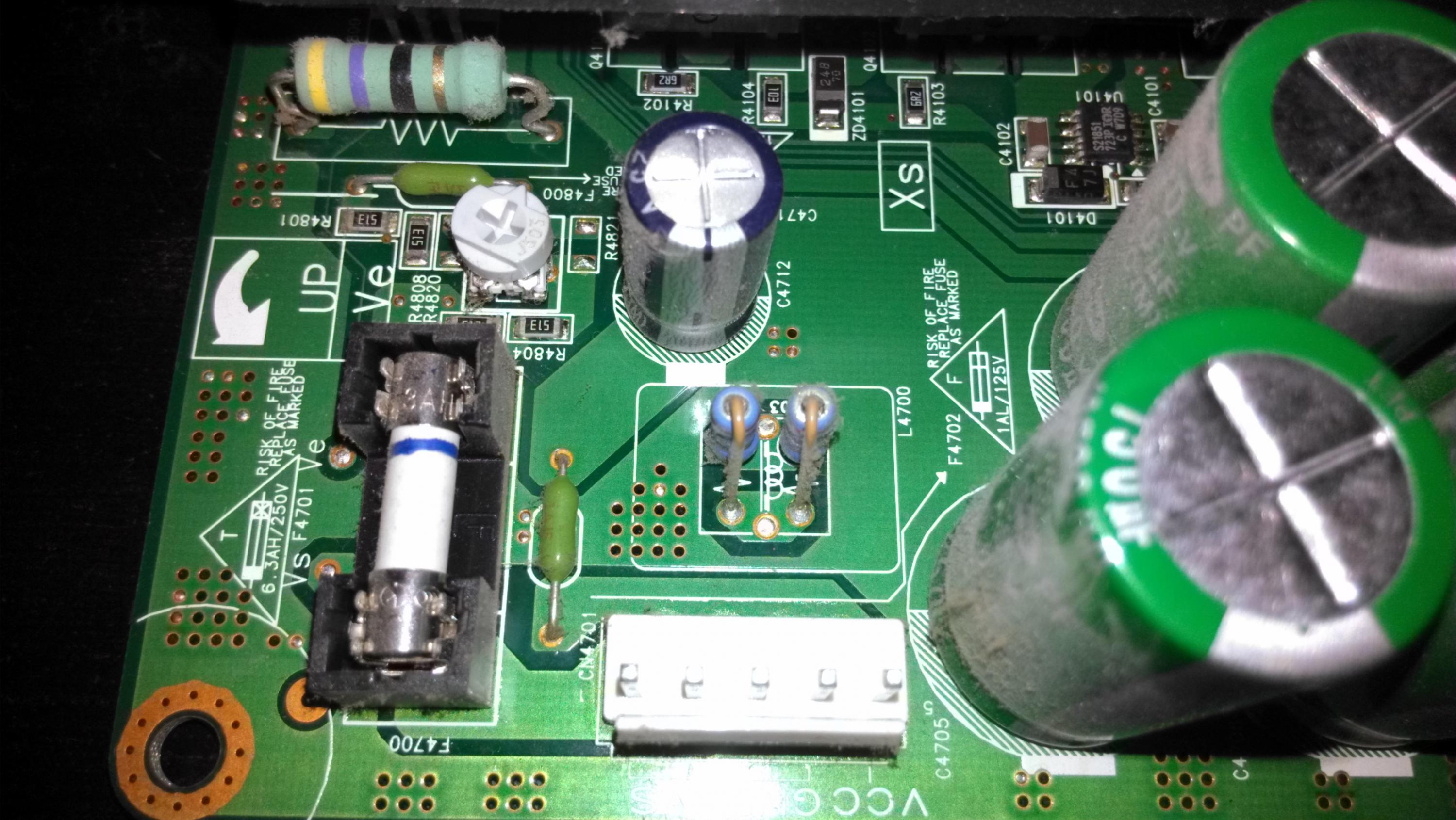

      Is there a method of testing the x main? Or just replace and see?
        You need an oscilloscope to test it. You can make some very basic tests with just a DMM, but not many tests.

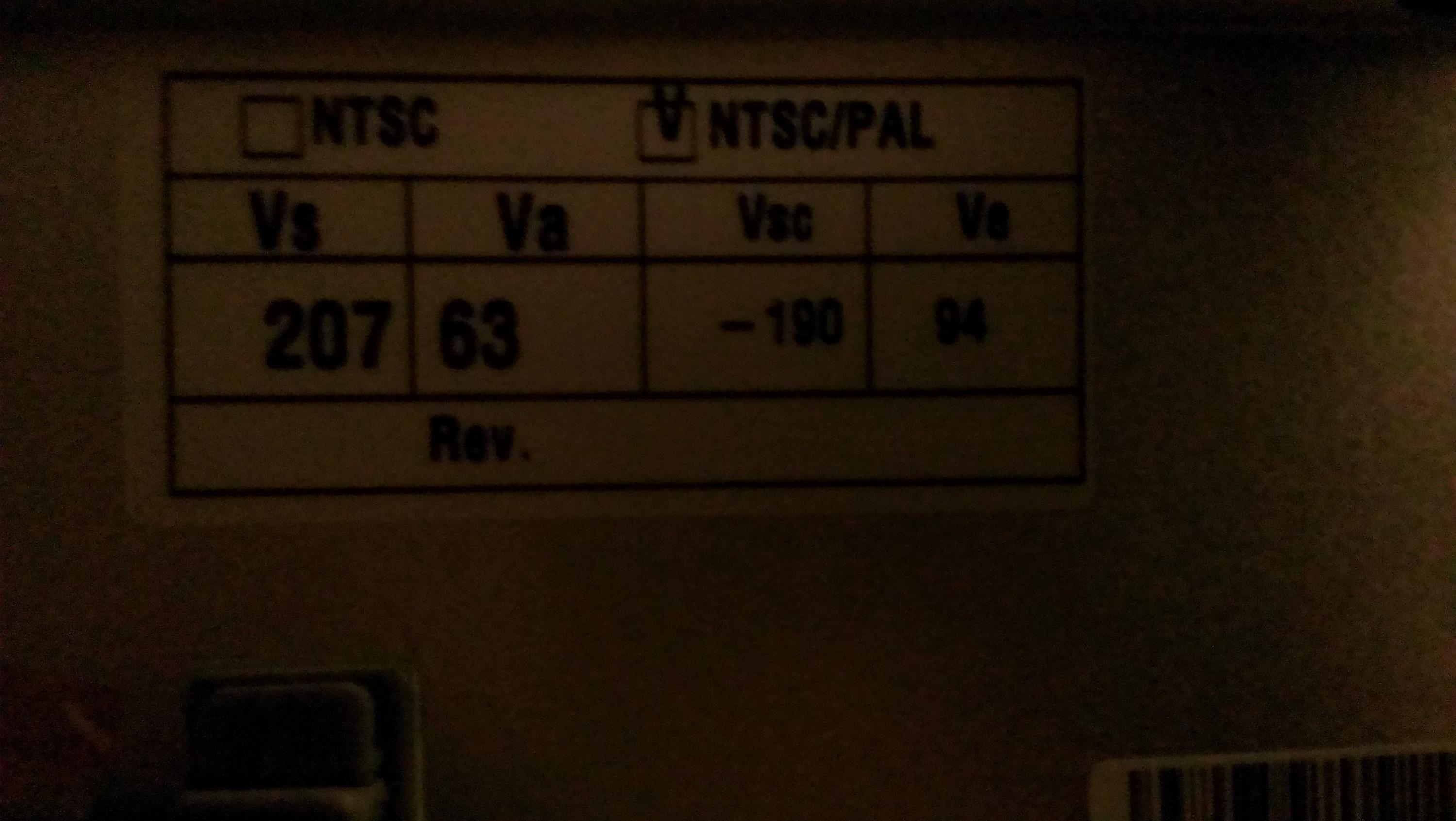

          Tested VCC and VS going to the X-main, all were within 1V of the spec listed on the panel.
          There was also a test point for Ve on the X-Main, that was within spec also.
          On a further note, it does appear that the slight output I'm getting on the panel is almost directly where the ribbons from the X-main enter the panel.
          I pulled the X-Main, there do not appear to be any physical issues with the board. Is there anything else I can do? I could simply replace the board and see what happens, it appears the X-Main is fairly cheap; $30 USD on eBay.
          I would prefer to isolate the problem before blindly buying boards :-]

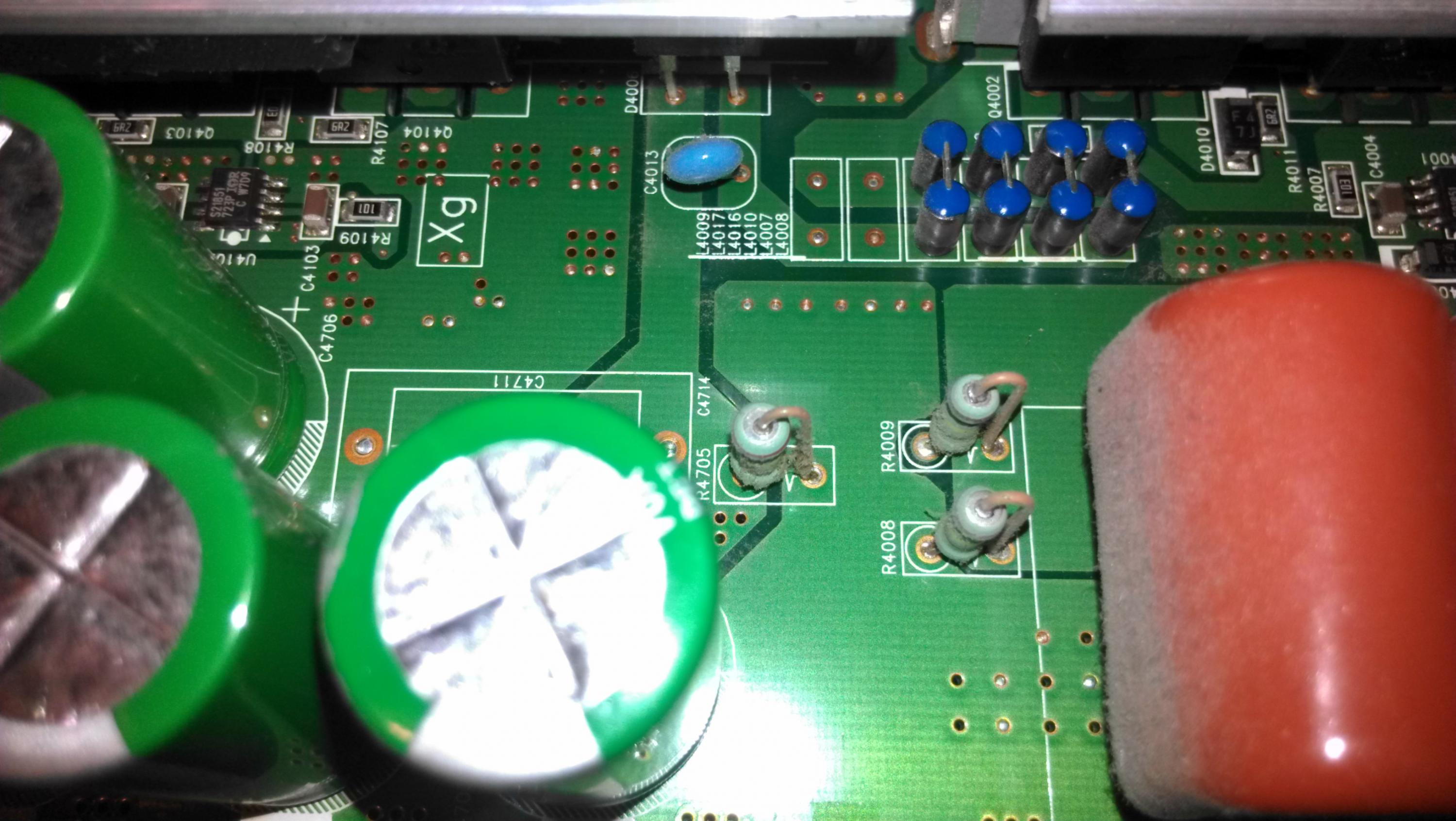

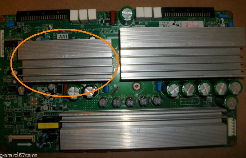

            There's a bank of 5 or 6 big red caps on the X-main usually, I think these are some of them on the left.
            https://www.badcaps.net/forum/attach...8&d=1367132656
            Test the voltage on one of the. It should be about the same as the similar red caps on the Y-main, and around 60 to 135V.
                  on both mains, the negative side of the big red caps are connected directly to ground.
                  Positive side of red caps on X-Main: 101.9 VDC
                  Positive side of red caps on Y-Main: 72.0 VDC
                    So, they should be around the same as each other, I would suggest an X-main fault is likely.

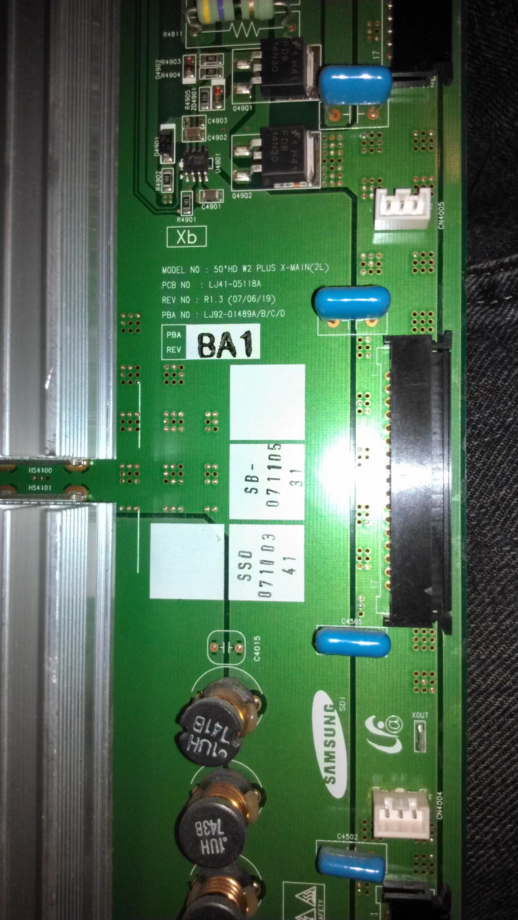

                        Just recieved the new X-main board, installed, and tested (and adjusted) voltages for VS and Ve before plugging in the ribbon cables..
                        AND.....
                        Still no dice. Exibiting same problem as before, in exactly the same place.
                        Just to be sure, I tested voltages listed on the sticker on the panel.
                        Vs - 207
                        Va - 63.1
                        Vsc - couldn't find
                        Ve - 93.8
                        Red caps on X-Main - 101.7
                        Red caps on Y-Main - 72.3

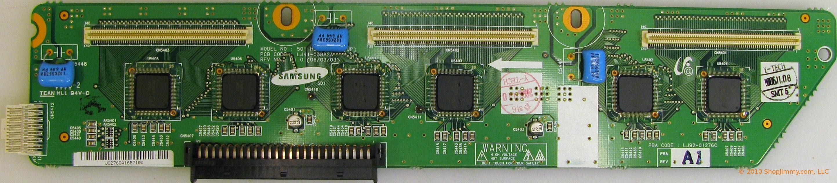

                                look closely at the y-buffers a common failure on these sets. screen will prime but no video in these areas.

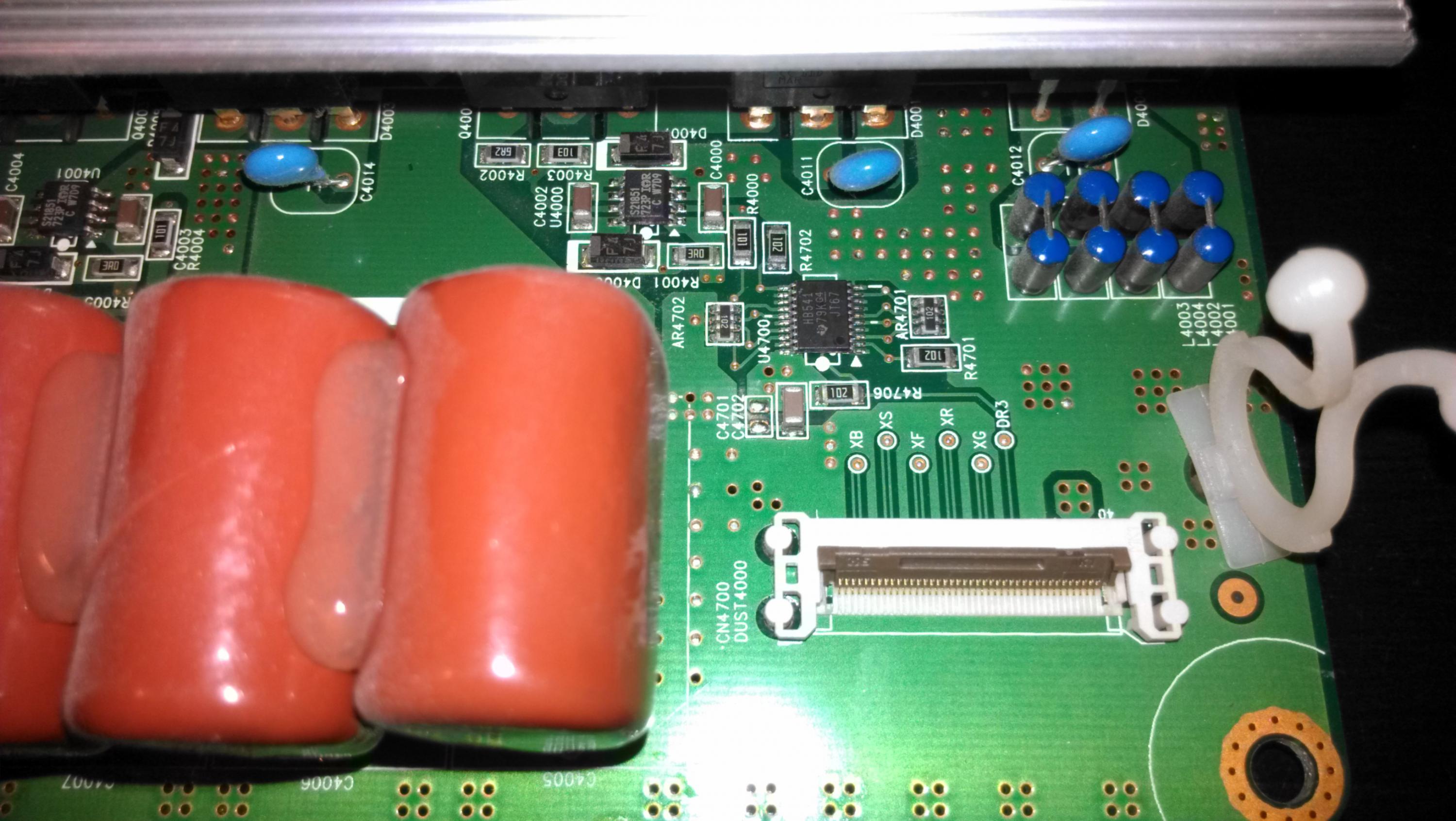

                                    Y buffers are the 2 boards LHS attached to the Ymain. Common failure is shorted buffer boards( usually the top one) and also shorted FETs Ymain (88N30W) can have other parts failed , fuses blown. Visual inspections don't always reveal much, grab a meter and bell them out for shorts.
                                    I think the bottom buffer boards are known as E & F buffers, I don't think you need to mess with them. If you do, don't run the panel without that long aluminium heatsink mounted and don't spike them with residual power from PSU if you disconnect the power cable for them.
                                    I've done both, cooked and blew the COF ICs and that's game over for the panel.

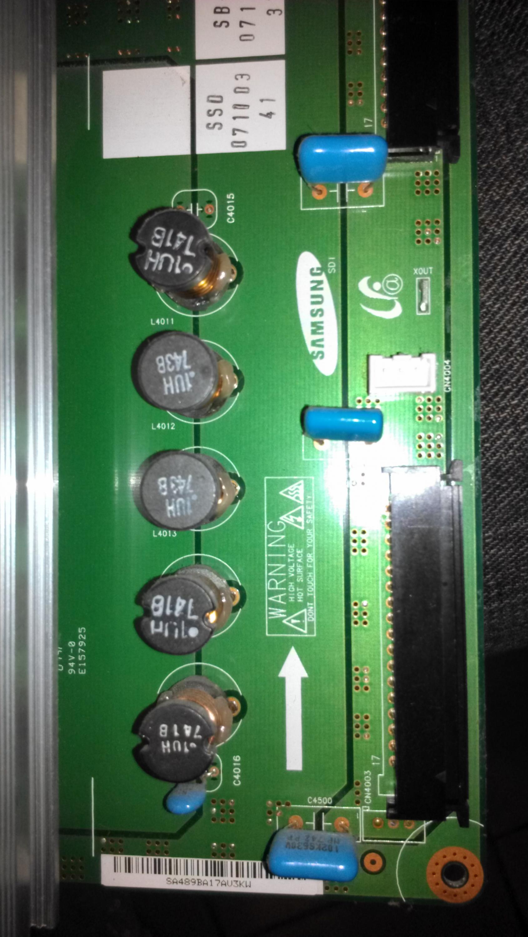

                                      Just pulled the Ymain, took LOADS of pics. Visual inspection I found a bulged capacitor, C5709, need to pull it to see what value it is if I have one on hand.
                                      In laymans' terms, you're saying to pull the boards and check all the FET's for shorts, gotcha.
                                      However, not quite following you about the pulling power and spiking the buffers with voltage....
                                      EDIT.
                                      Pulled both the buffers on the left side of the panel (looking at the back of the panel)
                                      No FET's on the buffers, but tested all three big white connectors (the ones that go the panel) to ground, no shorts. Mabye you meant the 'supply' side?
                                      Pulling C5709 as we speak
