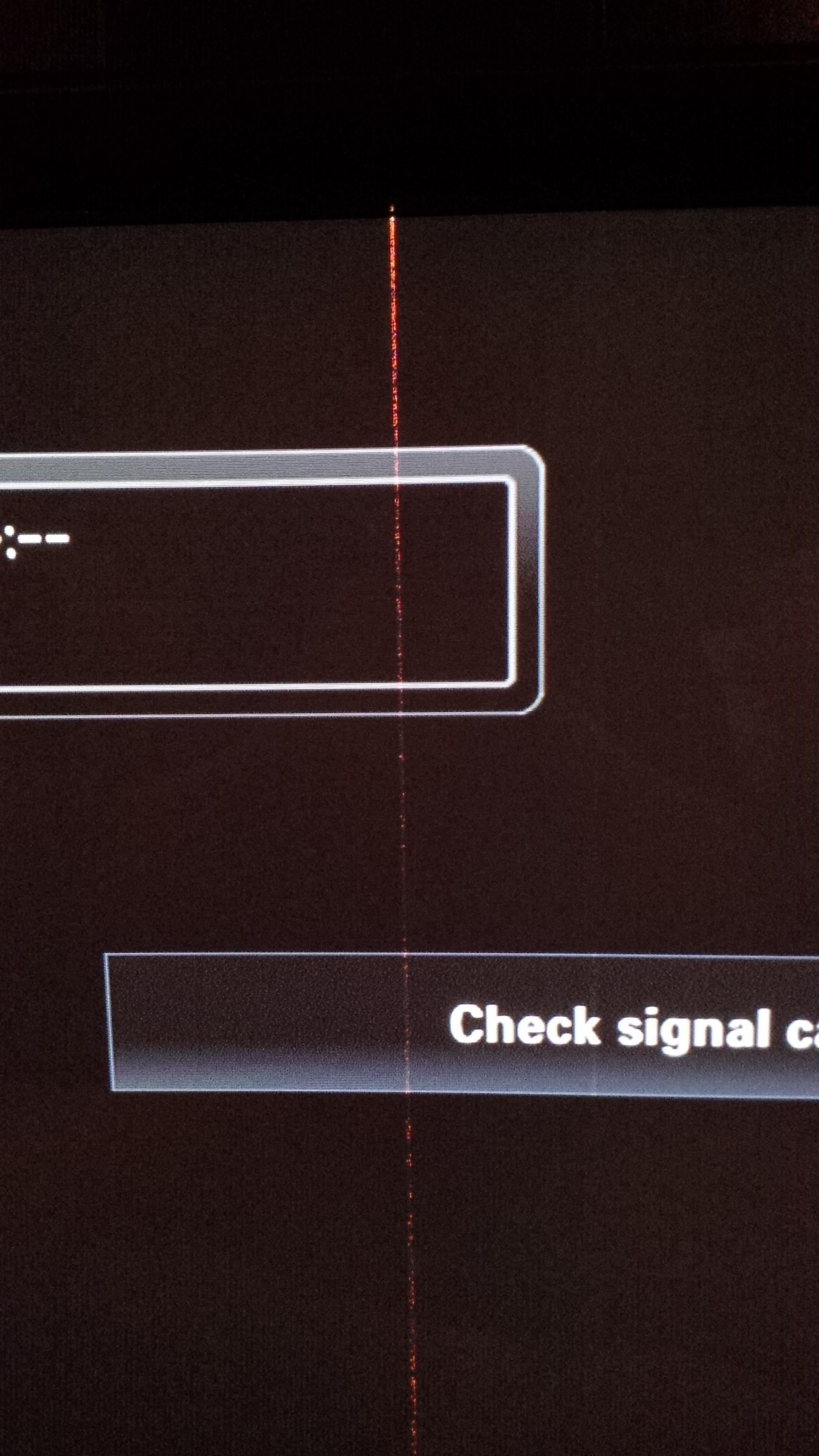

    Samsung PN50C540 Plasma Red thin line from top to bottom of the display, please help
    Samsung PN50C540 Plasma Red thin line from top to bottom of the display, anyone know what could be the cause? please help. I have included an image of the issue.

    Re: Samsung PN50C540 Plasma Red thin line from top to bottom of the display, please h
    I'd say you have a faulty panel - can't be fixed economically.
      It's not necessarily a faulty panel. I have fixed many TVs with the same problem - I think they were all LCDs but I can see how the same principle would apply to plasmas.
      I'm not really familiar with your model (in truth I kind of specialise in LCDs so if anything I say sounds stupid or inapplicable I do apologise).
      The LCD TVs I repaired that had single coloured vertical lines, it was simply a case of cleaning the connectors on the ribbon cables that attached the T-con board (plasma equivalent would be logic board) to the screen driver board. I pulled those ribbon cables out, used a rubber (that's an eraser not a condom) to scrub the metal contacts on each end then reseated them and - hey presto!
      Hope that helps.
        Plasmas are not equivalent to LCDs when it comes to screen issues, but cleaning contacts wouldn't hurt. I doubt it will make a difference, though.
          Any other ideas?
            You have a C series Samsung. Also happens to B and D series. Very common, not repairable. The panel is bad.
            Basically on any type of display a single or few pixel wide line is a bad panel. Repeating patterns are rarely bad panels.
