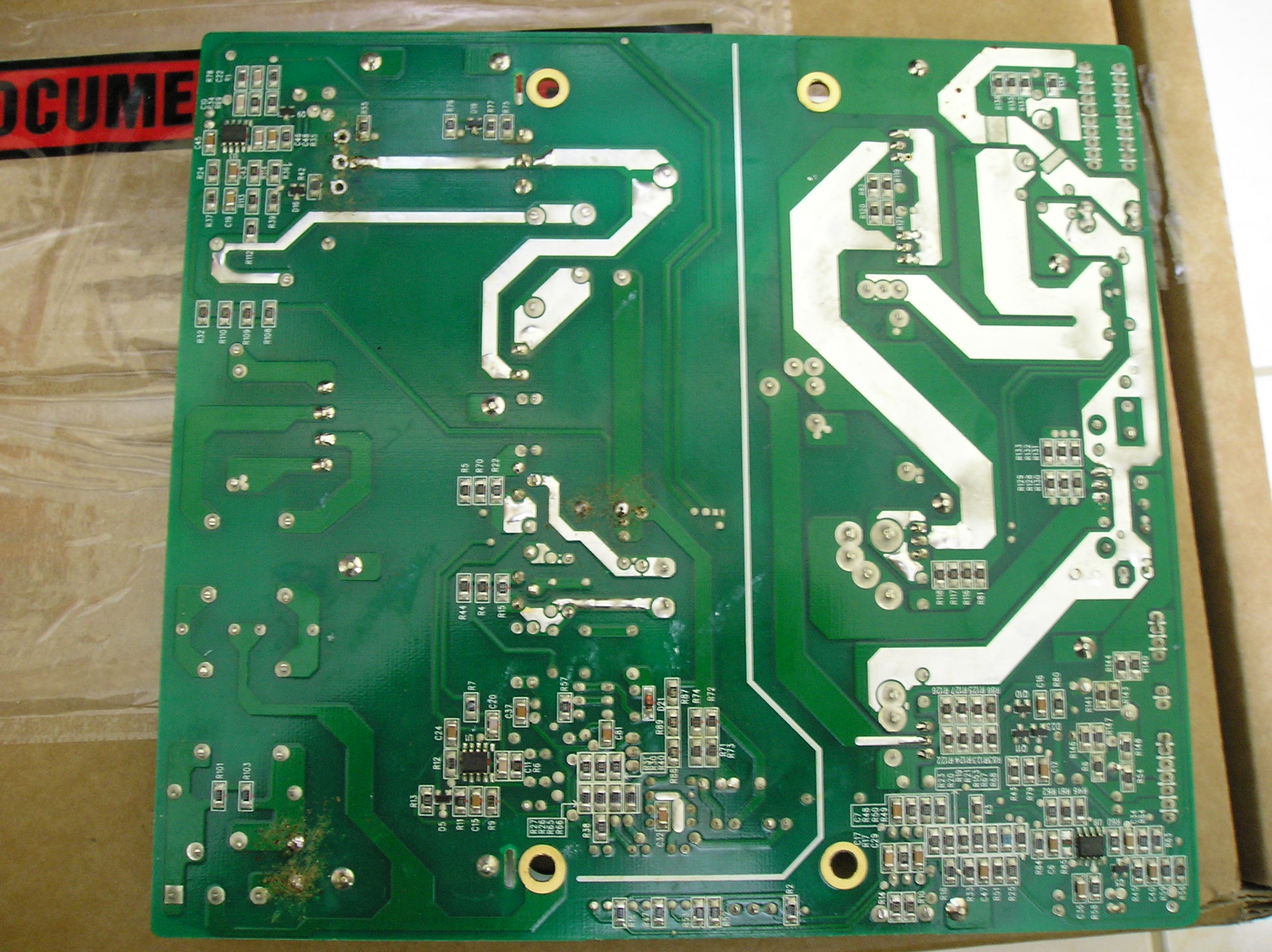

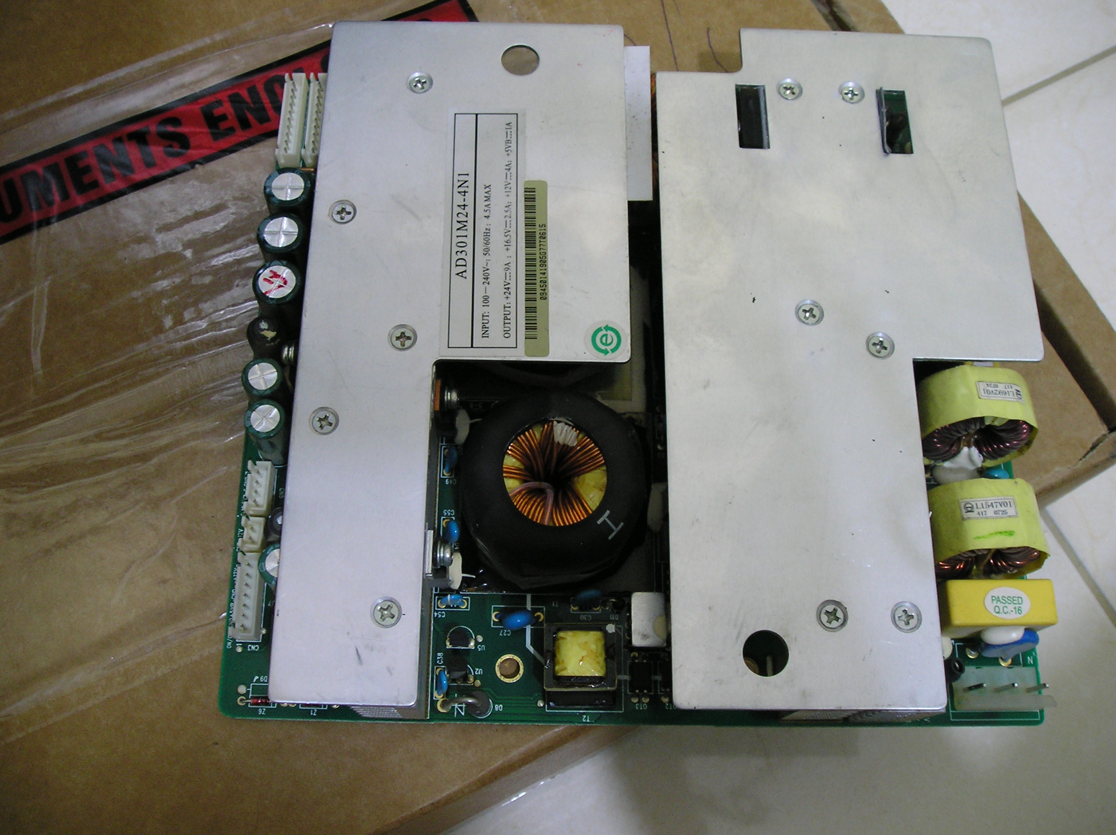

    Re: Haier L37A9A-A1 NO POWER
    front and back pics

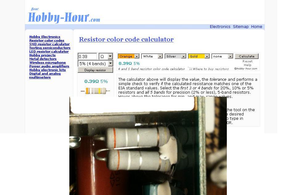

                  by the way is this resistor calc any good?
                  dont know which resistors to buy,(ohm,watt)

                    Yeah that resistor calculation looks good.. Its a current sense resistor.. It's probably beside the PWM IC which works out the current by checking the voltage drop across this resistor, and if it's too large it shuts down.. Fairly common for them to blow.. Not sure of the wattage..
                        The resistors measuring 0.29 ohm are probably good if they are 0.39 ohm rated; the measurement is so small your meter can easily make an error.
