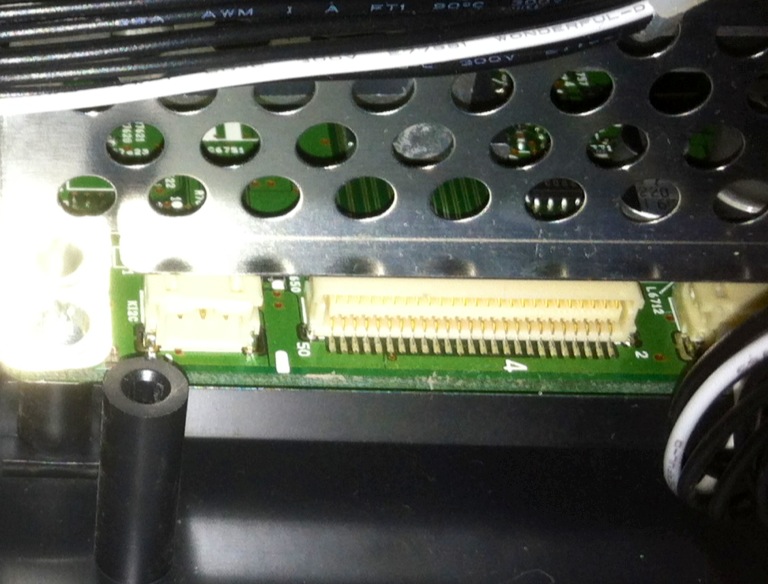

    Can you perhaps ask for a photo of the item?
    Can you supply pictures of connectors on each end, maybe they are considerably different?

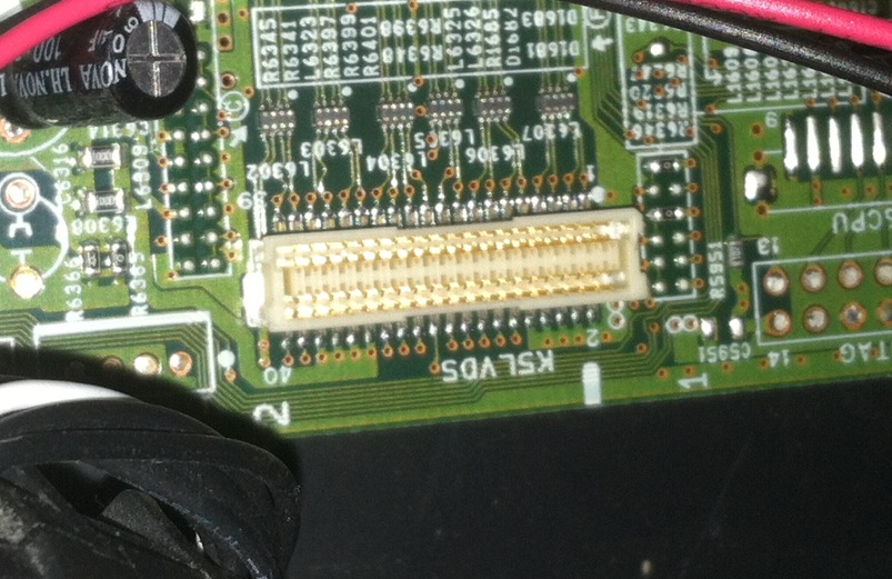

      I can get pictures of the connectors on the boards but not the ends of the cable. I asked for more info and was told that their system is currently down. Seems odd that she could get me a price and a part number if the system was down. It also seems like that happens a lot when I deal with authorized parts dealers and companies.

          The picture with the connector labeled K5LVDS is the main board. The picture with the connector partially shielded is the PC board.

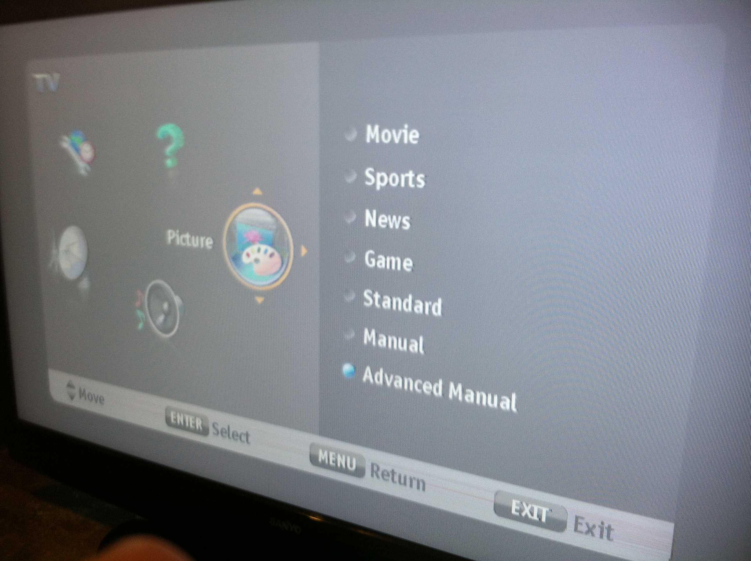

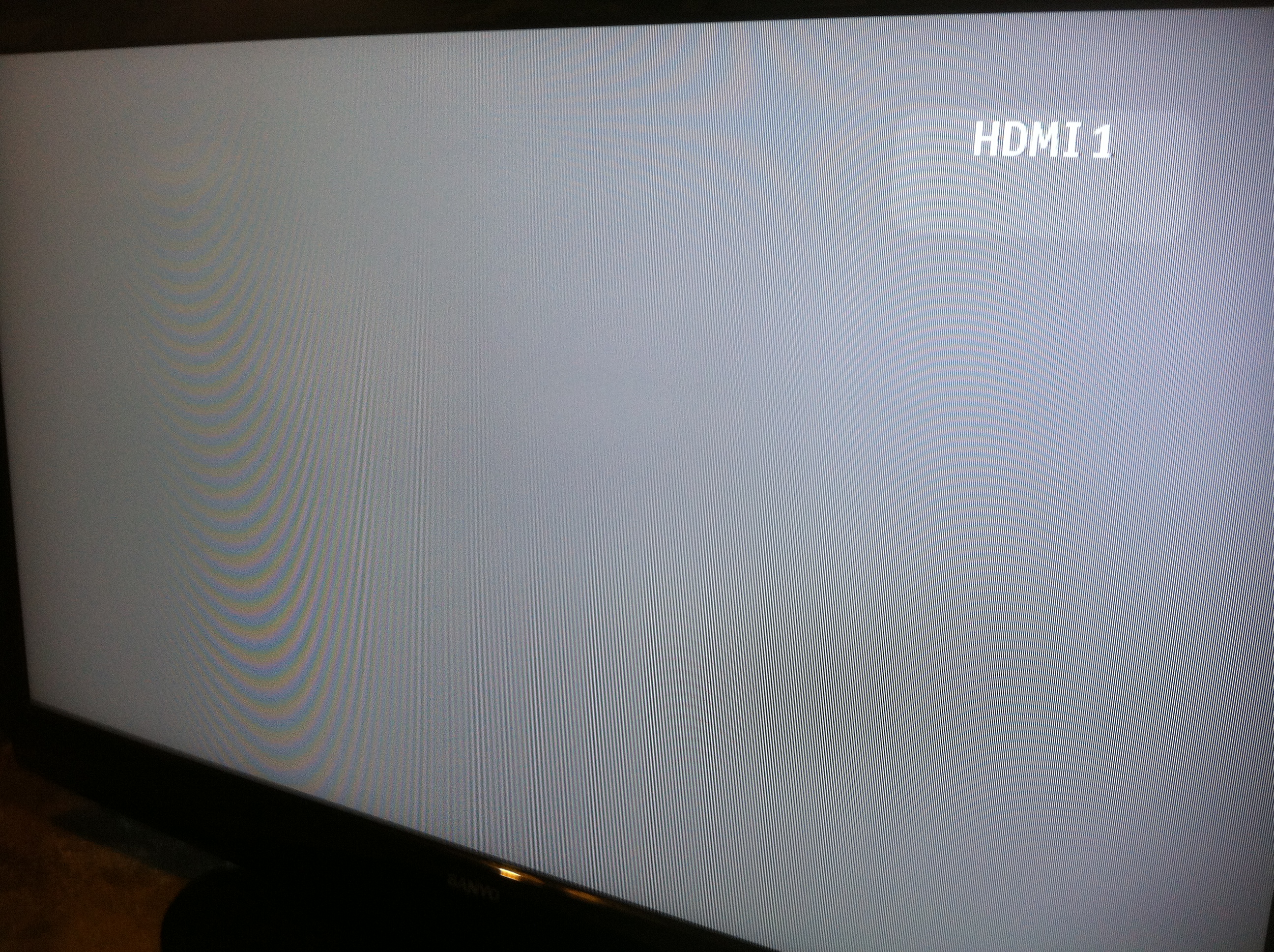

                        The cable arrived in the mail today. I put it in, fired it up, and ugh...
                        Is this a T-Con issue? The screen is greyed out. I'll connect a source later this afternoon and get a pic then too.

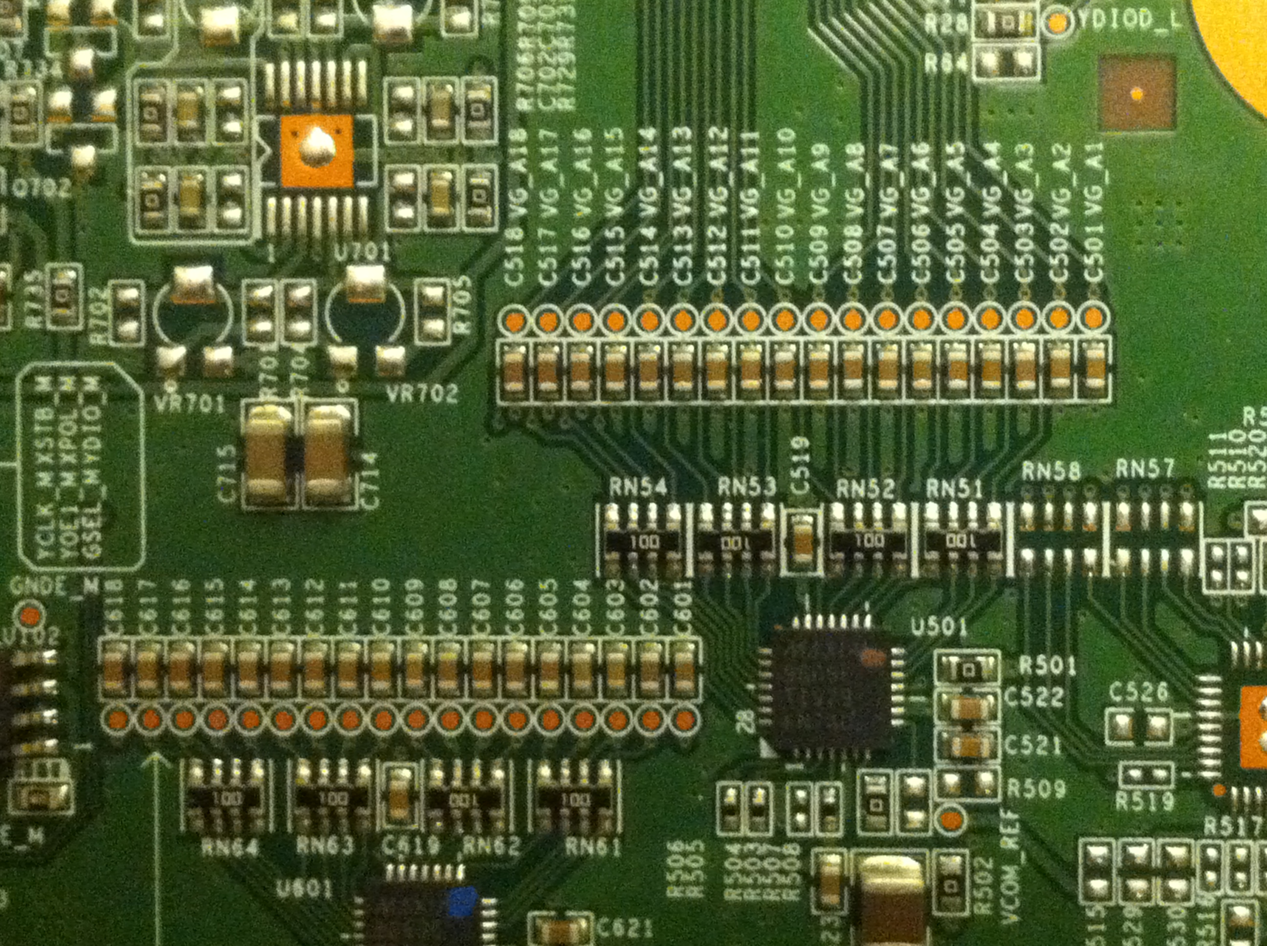

                          Check the brightness control. If not, check the T-con is the same model, and check the gamma IC voltages.

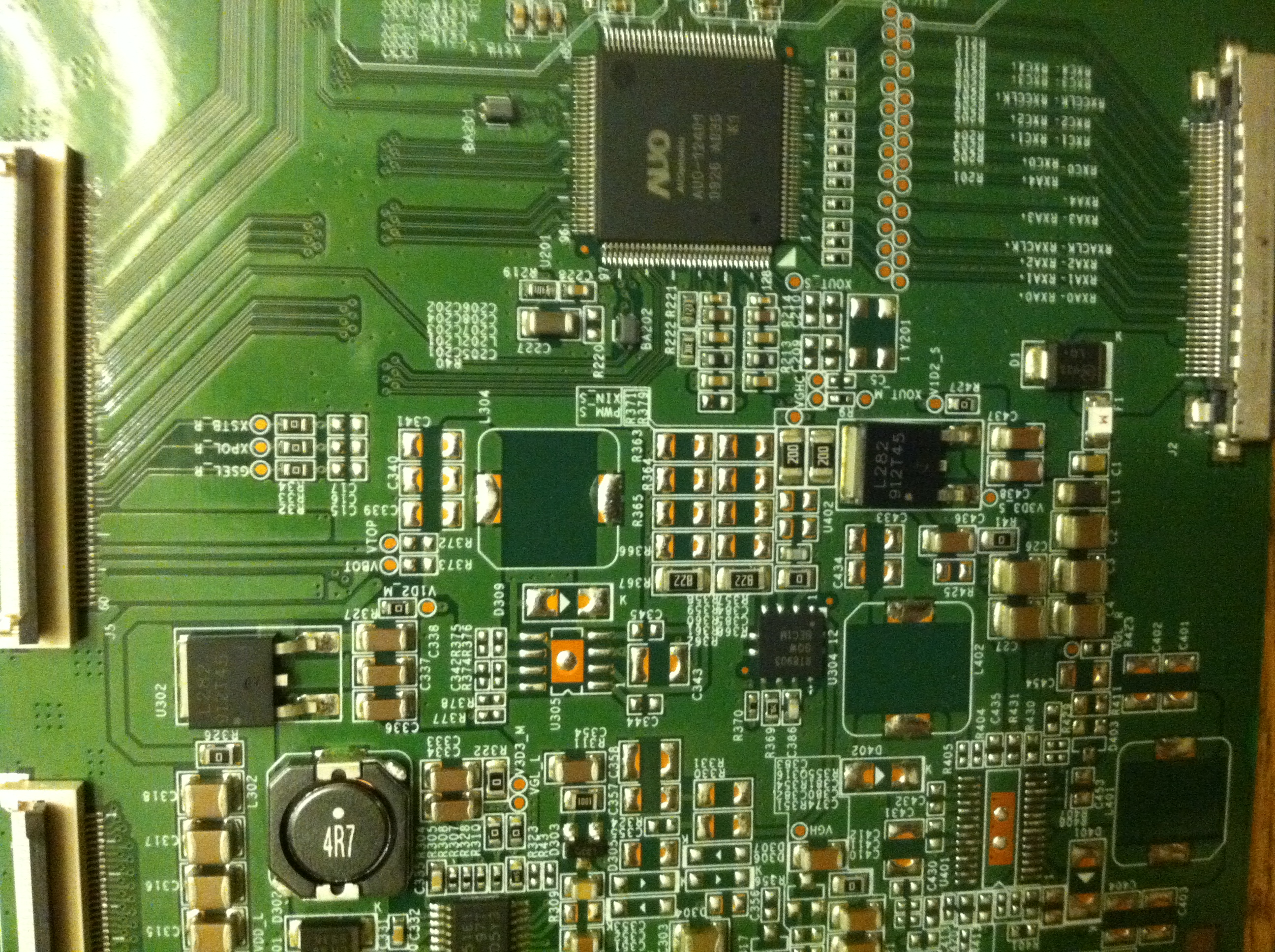

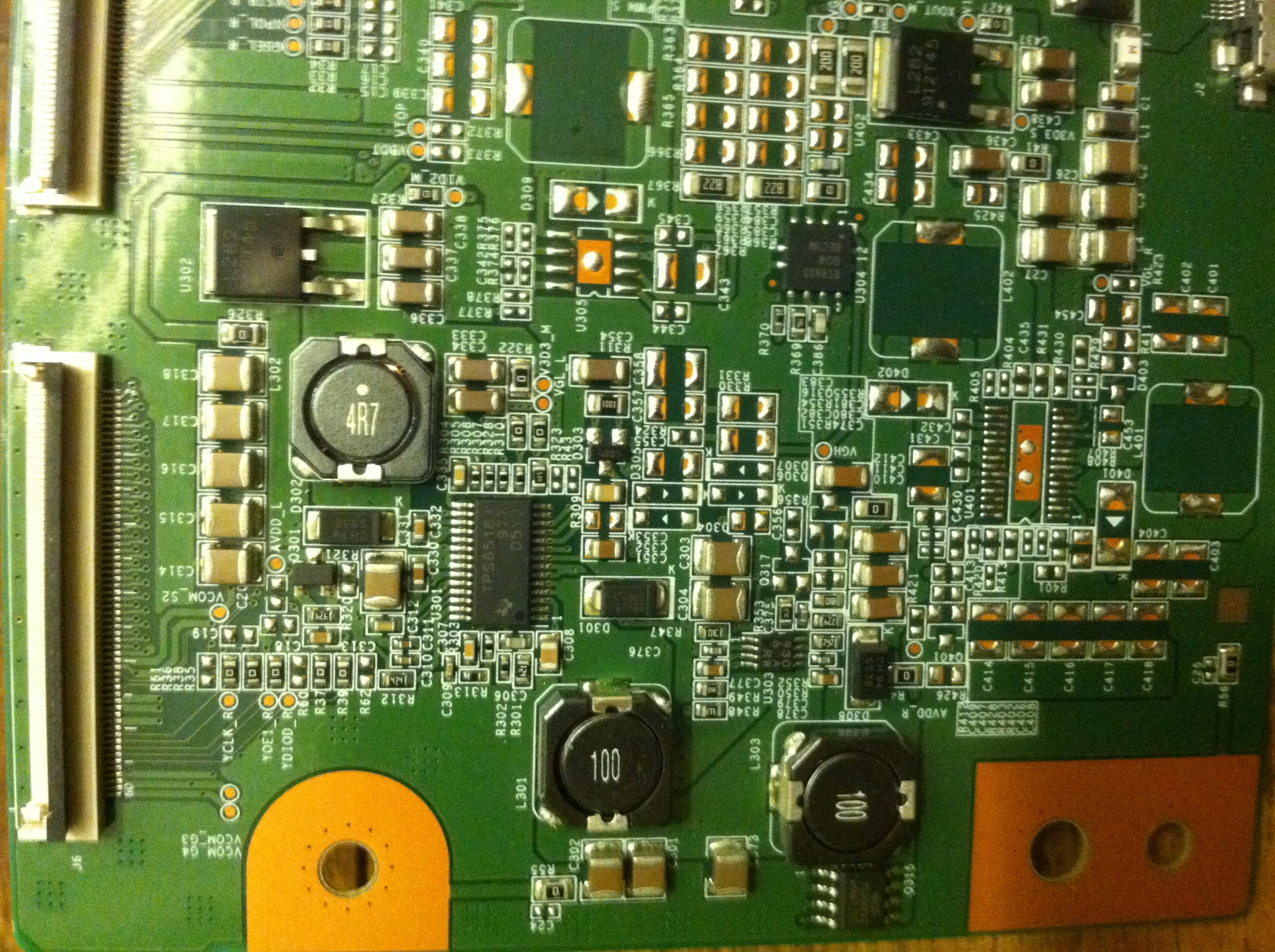

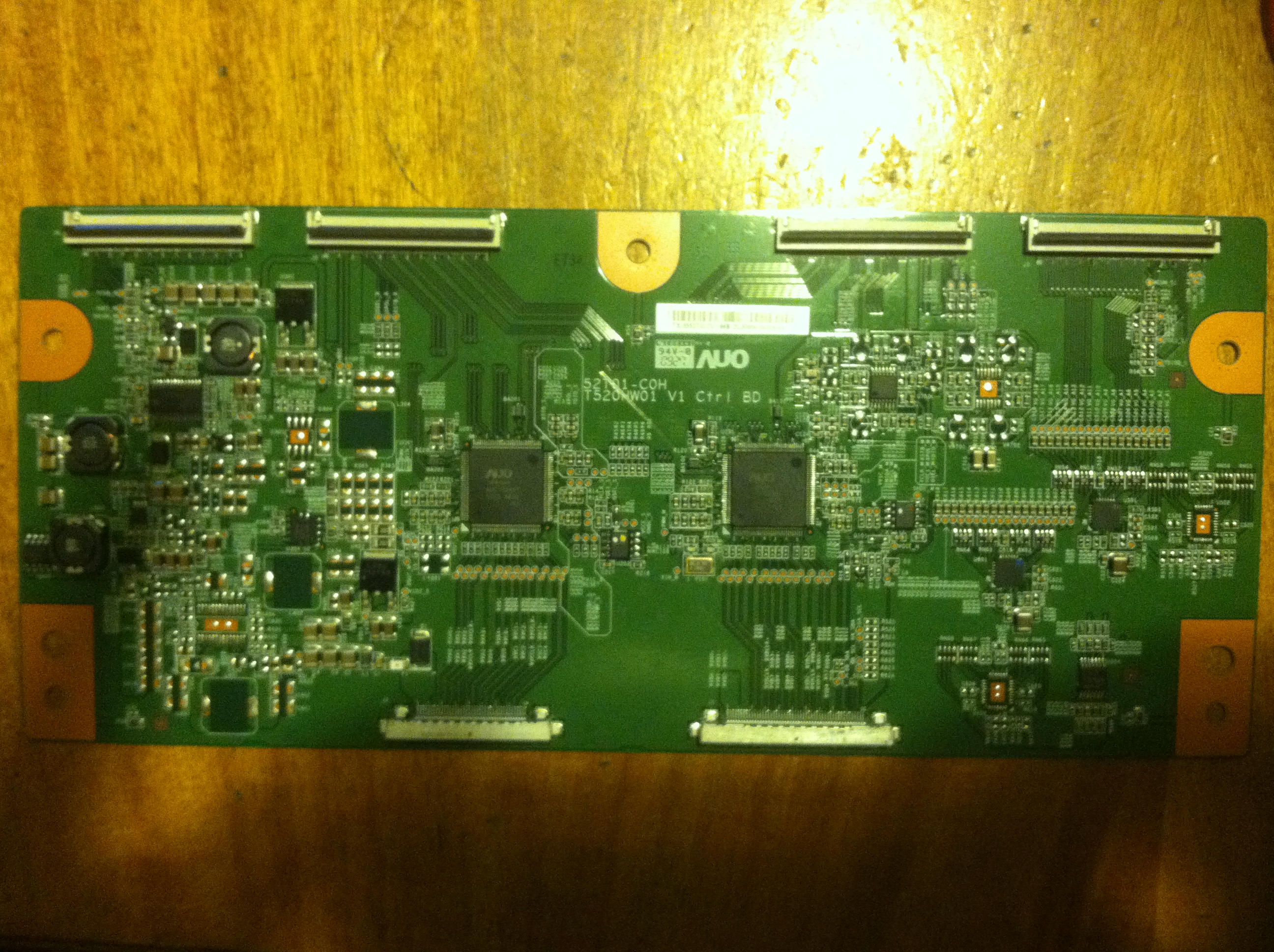

                              Can you take a picture of the T-con?
                                #35
                                Re: Sanyo DP52449. Won't turn on & main board problem.
                                Yeah. I've still gotta get the back off. It may be tomorrow.
                                  #36

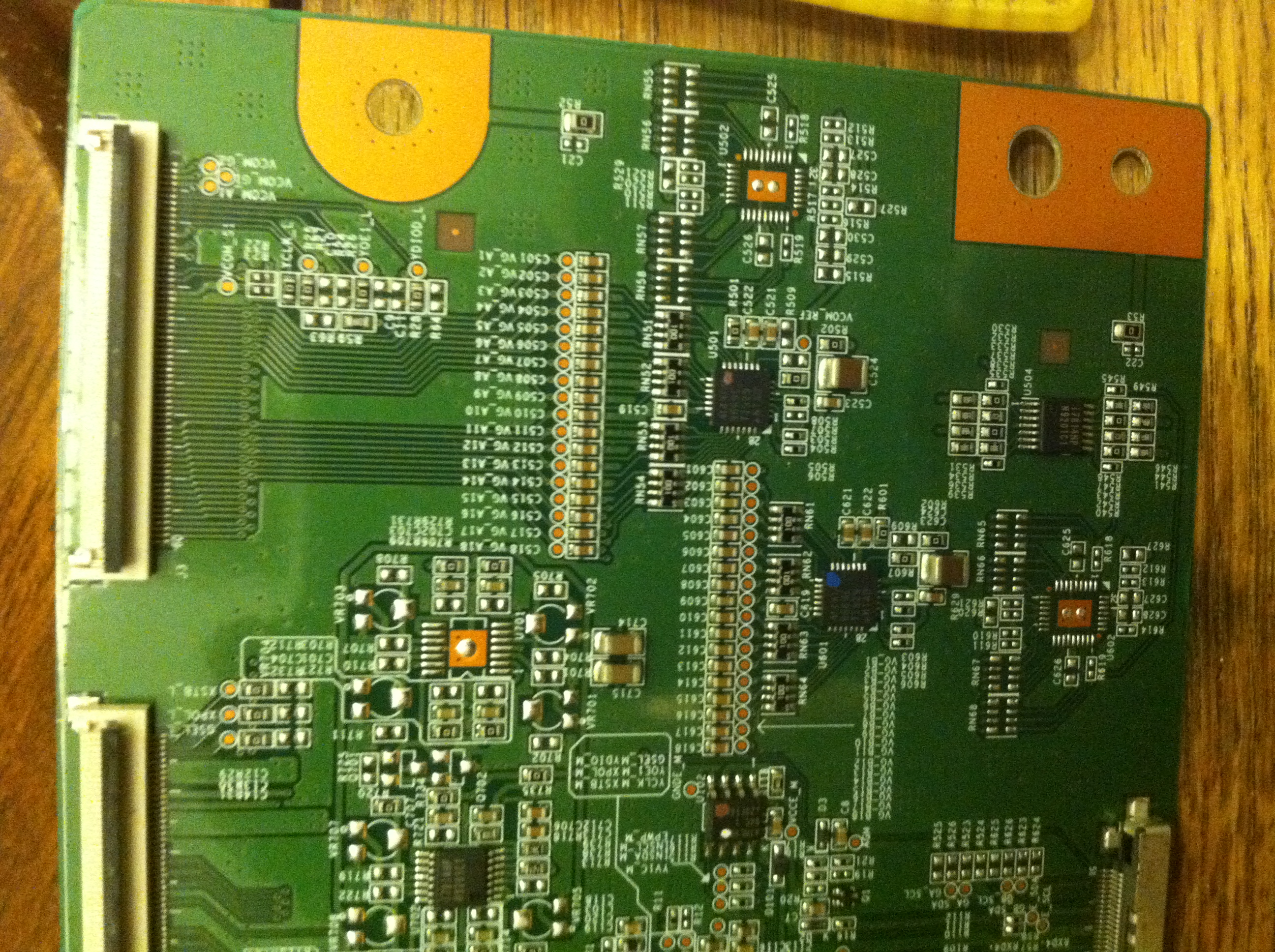

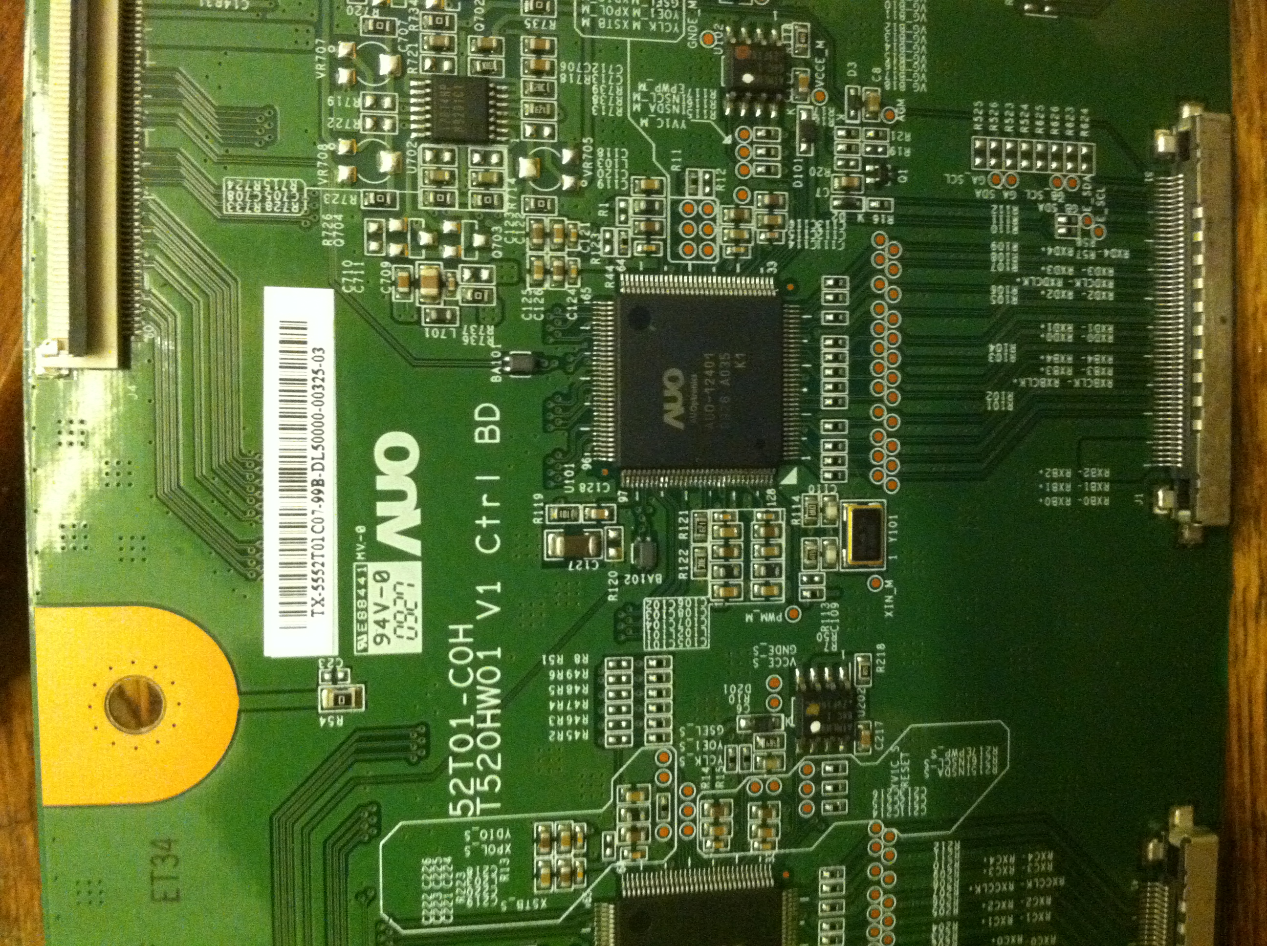

                                  What a pain in the a$$. It was nearly impossible to get the back off this thing. The wires inside are all too short to pull the back away far enough to get anything unplugged. I was finally able to get the T-Con out. Before I pulled it out, the screen was all washed out. I pulled it took some pics and re-installed it. Now half the screen is pink with vertical lines and half the screen is white with vertical lines. Wiggling the cables from the PC board to the T-Con makes the lines come and go. Reseating the cables eliminated the lines, but not the pink or white. Reseating the ribbons to the panel had no effect. No amount of flexing or tweaking the screen has any kind of effect.
                                  From the test points...
                                  C618-C601
                                  .4
                                  2.62
                                  3.24
                                  3.9
                                  4.3
                                  4.6
                                  4.8
                                  5.0
                                  7.0
                                  7.5
                                  9.4
                                  9.6
                                  9.8
                                  10.1
                                  10.5
                                  11.08
                                  11.68
                                  14.09
                                  C518/VG_A18-C501/VC_A1
                                  .35
                                  2.42
                                  3.11
                                  3.66
                                  4.14
                                  4.56
                                  4.93
                                  6.0
                                  7.26
                                  7.66
                                  8.9
                                  10.1
                                  10.36
                                  10.7
                                  11.2
                                  11.68
                                  12.3
                                  14.09
                                  From what I read, it looks like these all appear to be correct. After buying the TV, the main board, and the LVDS cable, I'm in it for $200. I'm not gonna make a dime off this thing at this rate. I really hope this isn't a bad panel.

                                    Well, I found a used T-Con with both cables for $20 on eBay. Fingers crossed.
                                      #38
                                      I guess I forgot to follow up. I ordered a second T-Con and there was no change. Unfortunately, this one's been sitting in the corner, untouched since June.
