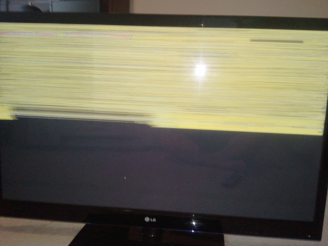

    lg plasma 50pk540
    Just pick this 50in lg plasma, model 50pk540. Top half of the screen has distorted color and nothing on the bottom. I replaced y-main and top/bottom y buffer board. Has sound, picture is distorted like the pic. When x board unplugged, have sound, have distorted pic as in the picture. When y board, unplugged, have sound, picture is blank. Any suggestion?

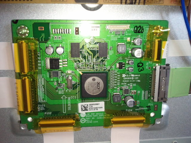

    Re: lg plasma 50pk540
    Can anyone help me out here? I replaced both the X and Y main and buffer, still have sound, but no picture. Could it be my main Control board where all the ribbon cable for the X and Y are conected are bad? Any help or suggested?
                Tom, here's a picture of the TV when I first brought it home, I suspected a Y board was bad, change that and also the x board. Now the TV screen is blank. Hope this help you help me troubleshoot the issue.
                  When I turn the tv on, I can heard the sound coming off of there, but still no picture with the new board. I did noticed that on the main control board. The little green led light does not stay on steady. It flashes a couple of times, and shut off and does it repeatly.
                    It looks to me more like a buffer board fault but I'm not certain.
                      which buffer board? X or Y, could it be a bad buffer board they sent me?
                        Y buffer.
                        Yes buffer boards are often bad.
                        Test yours, here is a video I made:
                        https://www.youtube.com/watch?v=51SZsfH60EY
