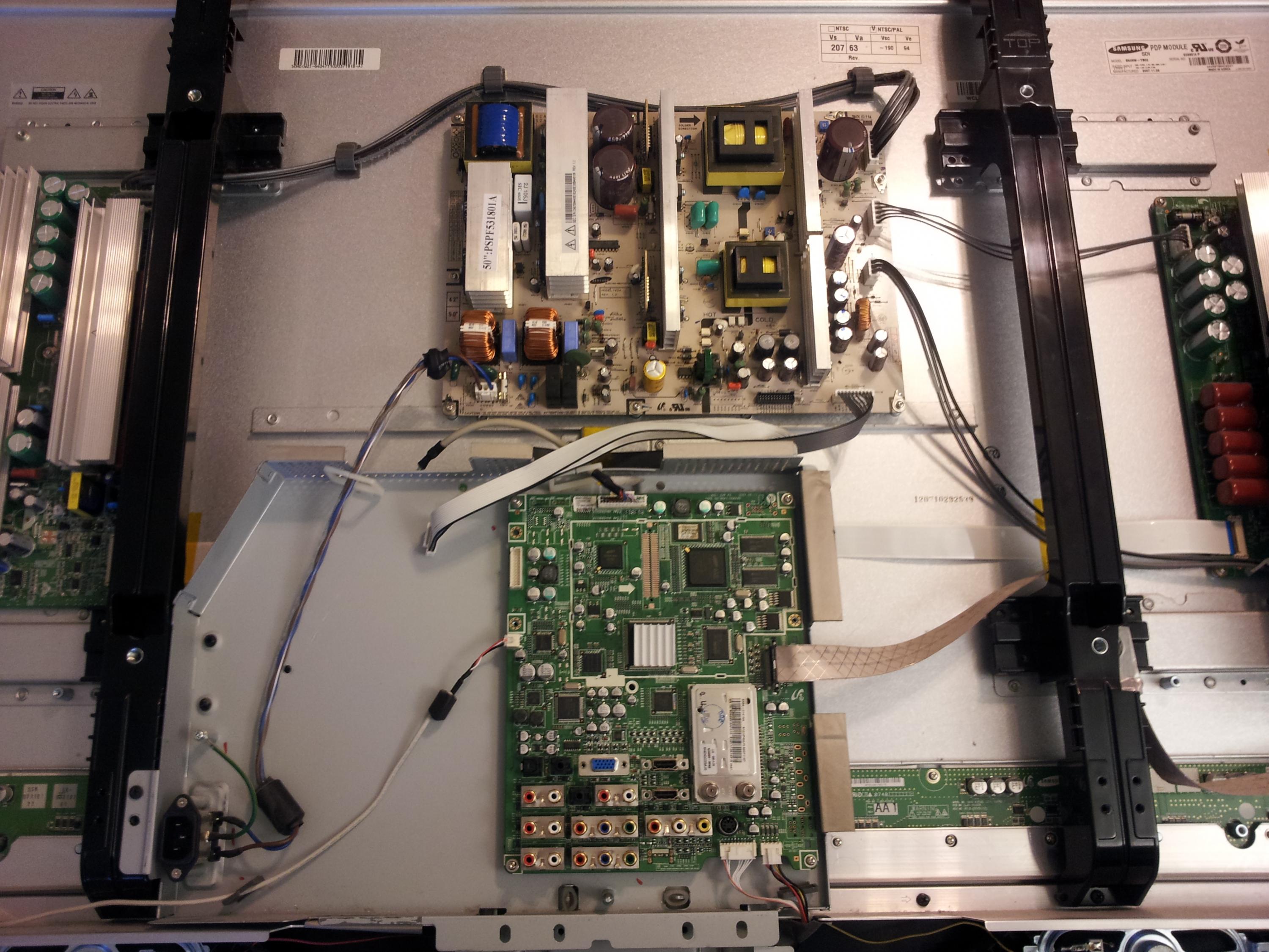

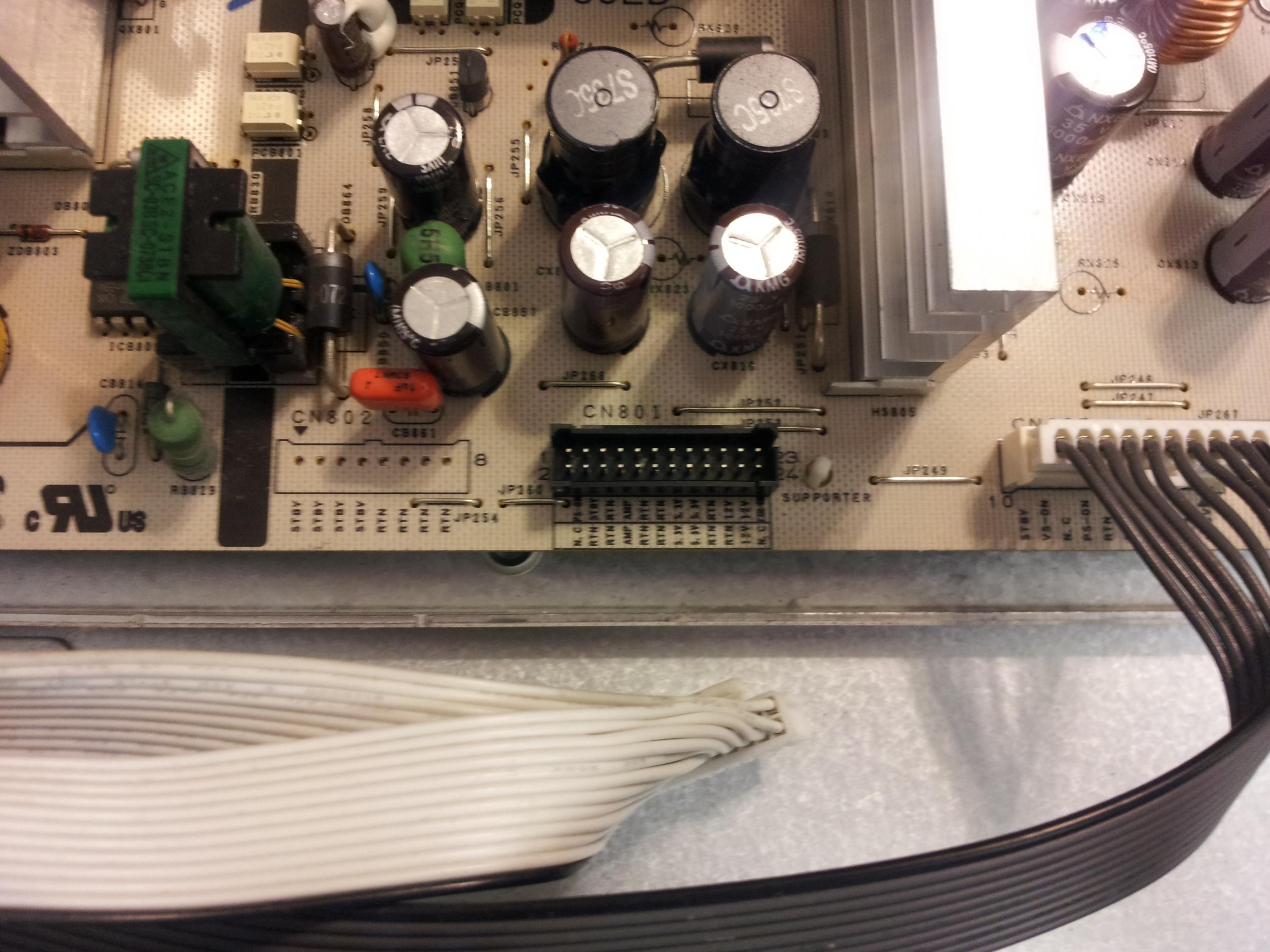

    Re: SAMSUNG HP-T5054 will not turn on,clicks when power is applied to it
    here are pictures ,ihope they will help
      The connector to the right has PSON and VSON, does that go to the main board?
      • Mr Fix it
        • Apr 2013
        • 22
        • US
        I see the connector with PSON and VSON,It goes from PS board to control board.Do you still want me to check for polarity?
          I'm thinking that it's going to be difficult to test it due to the odd design Samsung have used. I think the main board is the fault. There appears to be a PS-ON on the connector (no VS-ON though) going to the main board. Can you check what voltage appears on there?
            I checked PS-ON pin at the PS BOARD WITH POWER PLUGGED IN ,iGET LESS THAN ONE VOLT. It changes a little .096 to.149 when it clicks.
              That's with the main board disconnected though? Can you try with it plugged in?

                                      That makes more sense. This tells us a LOW signal turns the power supply on. So, get the resistor and put it from PS-ON to RTN or GND (whichever is present.) Then do the 3-4 jumper with LVDS removed from the control board, and see if test patterns appear.
                                        when i install the resistor, i do keep the main board connector connected.what return do i connect to ?,is the test pattern i am looking for on the tv screen ?
                                        • Mr Fix it
                                          • Apr 2013
                                          • 22
                                          • US
                                          #40
                                          I checked all the fuses again , the fuse in the center of the power board was blown,I replaced it when i connected power and turned it on it blowed again.
