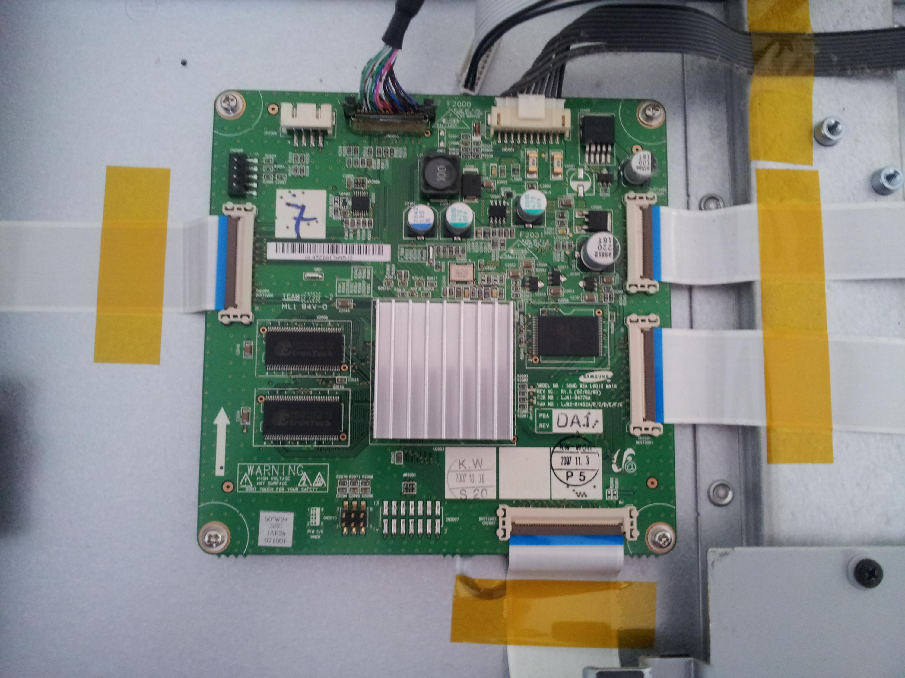

    this Samsung model HP-T5054 TV WAS GIVING TO ME.WHEN I plug it , there is a clicking coming out of the center board in the back.First i looked at the capacitors they all look good.next i unplugged the Y main board(left side facing from the back)then plugged the power plug in, it still clicks.i did the same with the X main board(right side)powered it up still clicking.when i disconnected the board with the video connections (lower center)and plugged power cord in the clicking went away.still nothing else worked.Help me . thank you.

        your image 2of4 looks the same as my tv,but my control board looks different,its about 6 inches square pn#WL452DA17AN5J2. also if i disconnect the control board then connect power it still clicks. hope this will help

                Re: SAMSUNG HP-T5054 will not turn on,clicks when power is applied to it
                Here is the picture of the control board on my TV.
                  Bottom of board - CN2010 - pins 5-6.
                    do you want a picture of the bottom of the board?
                      No, I am pointing out the jumper for the test pattern.
                        I did the test,no change still clicks
                          OK, you will need to get some 100 to 470 ohm resistors.
