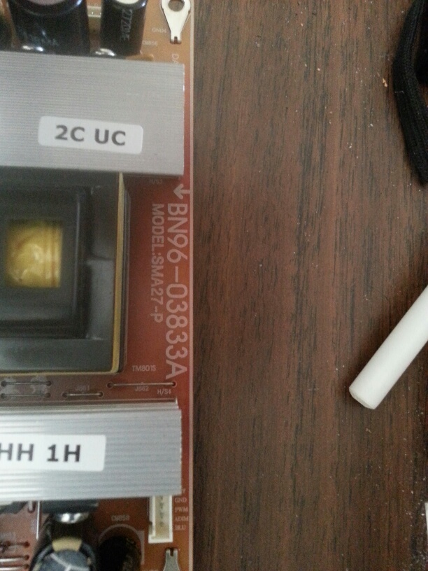

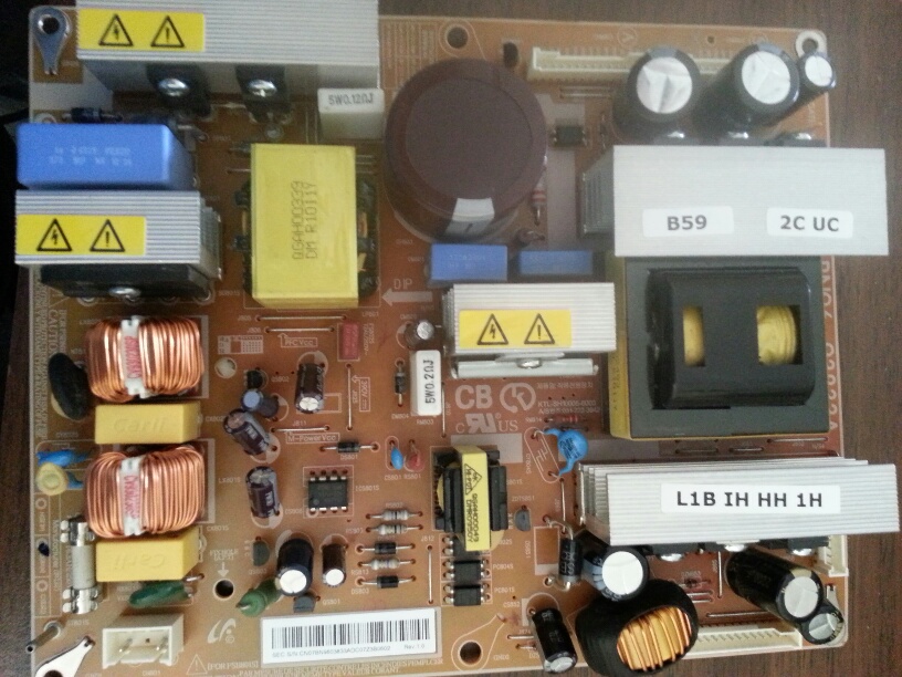

    I have a 32" Samsung Model LN-S3251D. It flashes the LED once when I plug it in. That's it.
    It appears to have a power board that is not common (at least I can't find much on it). Power board number is BN96-03833A.
    Non of the caps "looked" bad, but I went ahead and ordered a cap kit that was for a similar board. I replaced 11 of the 14 caps and nothing changed. I'm picking up the 3 remaining capacitors tomorrow.
    2 fuses check good.
    Any help will be appreciated.

    If you do replace the others but do not buy capacitors from RadioShack/Frys etc. I don't think it's necessary. Do you have a digital multimeter? The power supply can be tested.

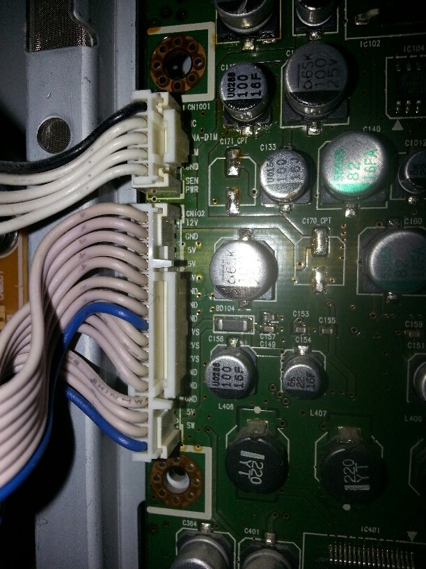

        OK, I would suggest you install the power board in the chassis, then measure each of the pins on the connector from the power board to the main board. Red probe on pin to be measured, black on chassis of TV. (All screws in power board should be secured.)
        Supply the results like this
        #1 - 5.61V
        #2 - 3.32V
        #3 - 0.02V
        #4 - 0.01V
        etc.

              Re: Samsung LN_S3251D LED Blinks Once
              This connector that says 12v, grd, 5v, 5v, ect? The one with whites and 2 blues?
              Whats pin #1? TV plug in? Connector off at main board? Check voltages at the connector?
                All of the pins except #1 and #15 are 0.0v.
                Pin #1 is 0.1v and pin #15 is 6.04v.
                  Please report the reading on CN102 with respect to the label so you/we do not have to figure out which is pin 1.
                  from the top pin down:
                  12v =
                  GND =
                  5V =
                  and so on.
                  • Jim8181
                    • Nov 2012
                    • 12
                    Thanks for the help.
                    #1 12v = 0.1v
                    #2 GND = 0.0v
                    #3 5v = 0.0v
                    #4 5v = 0.0v
                    #5 5v = 0.0v
                    #6 GND = 0.0v
                    #7 GND = 0.0v
                    #8 GND = 0.0v
                    #9 12vs = 0.0v
                    #10 12vs = 0.0v
                    #11 12vs = 0.0v
                    #12 GND = 0.0v
                    #13 GND = 0.0v
                    #14 GND = 0.0v
                    #15 5v = 6.04v
                    #16 SW = 0.0v

                      Something is wrong with the 5V. About once a week, we get someone who reports incorrect voltages due a weak or dying battery in the multimeter, but there is no such indication of a low battery warning on the lcd.
                      Recheck pin 15 with a fresh new battery in your multimeter.

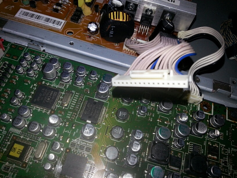

                        Okay, I changed batteries and tested #15 and it is still 6.04v. I checked it with a second multimeter and got the same results - 6.04v.
                        And to make sure I'm checking this correctly... I have the tv plugged in, the ribbon cable disconnected from the mainboard and I'm checking at that connector end (the other end is still connected to the power board).
                          The strange part is that the other 5v pins shows 0V. I will need to trace out the board to see if the other 5v that shows 0V is switched 5V not standby 5V.
                          The one that is showing 6.04 may have bad Ref Zener TL431 or bad feedback circuit.
