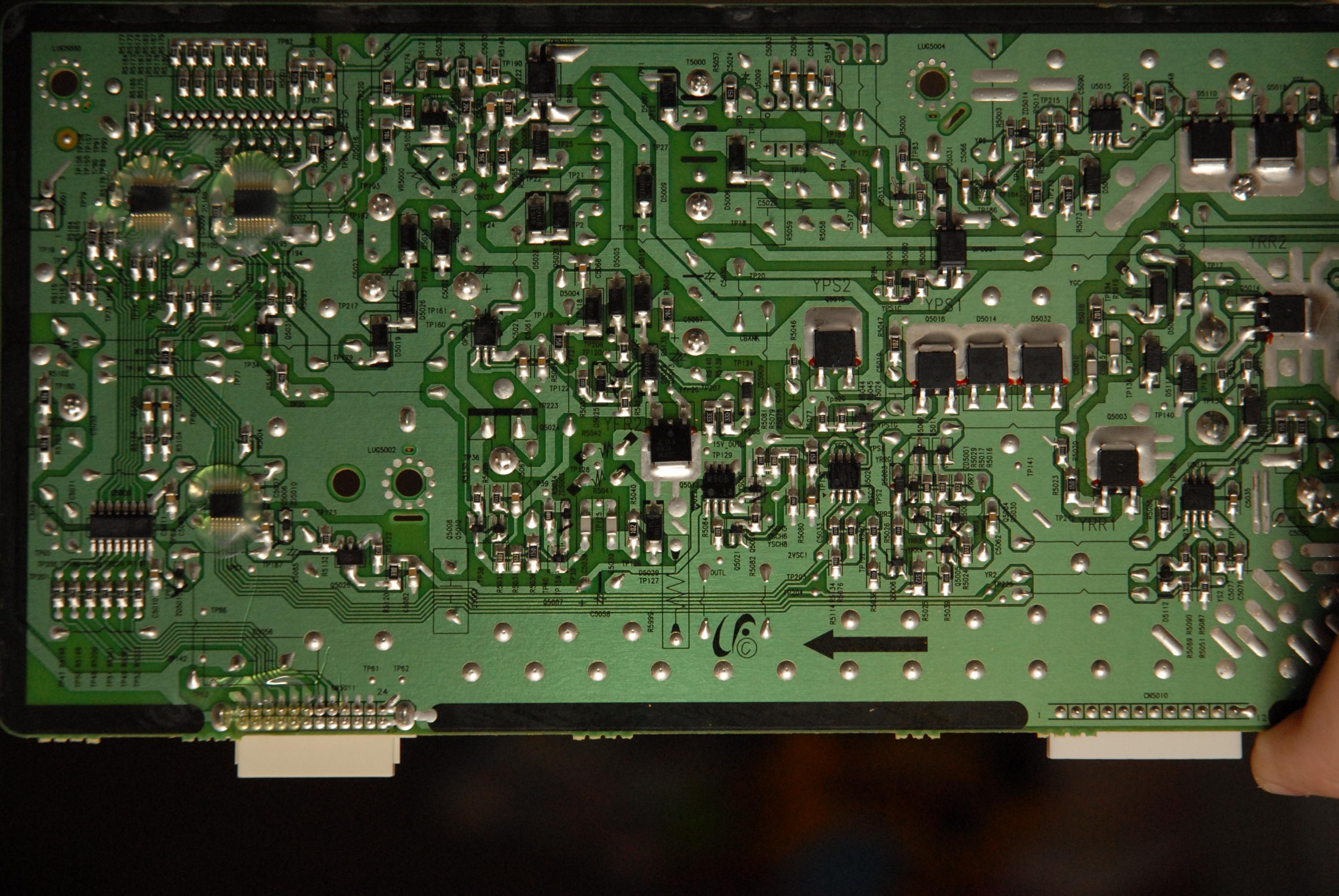

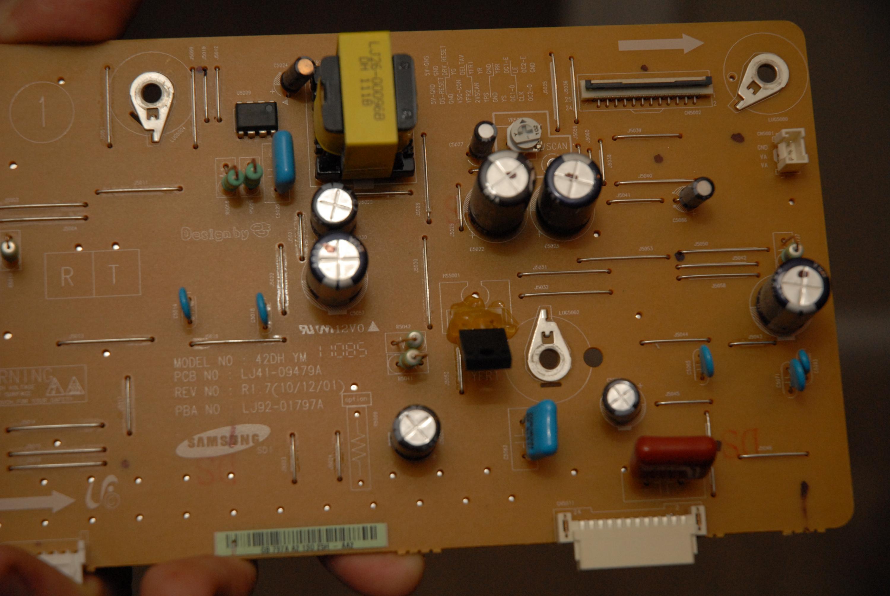

    You will need to unplug the X-main board, take it out, and we can show you how to test for shorts. It is sometimes advisable to swap or repair both X-main and Y-main.
    • phantom715
      • Mar 2013
      • 20
      Re: Samsung PN43D450A2D No Video
      X-Main Front:
      X-Main Back:
      Thank you so much.

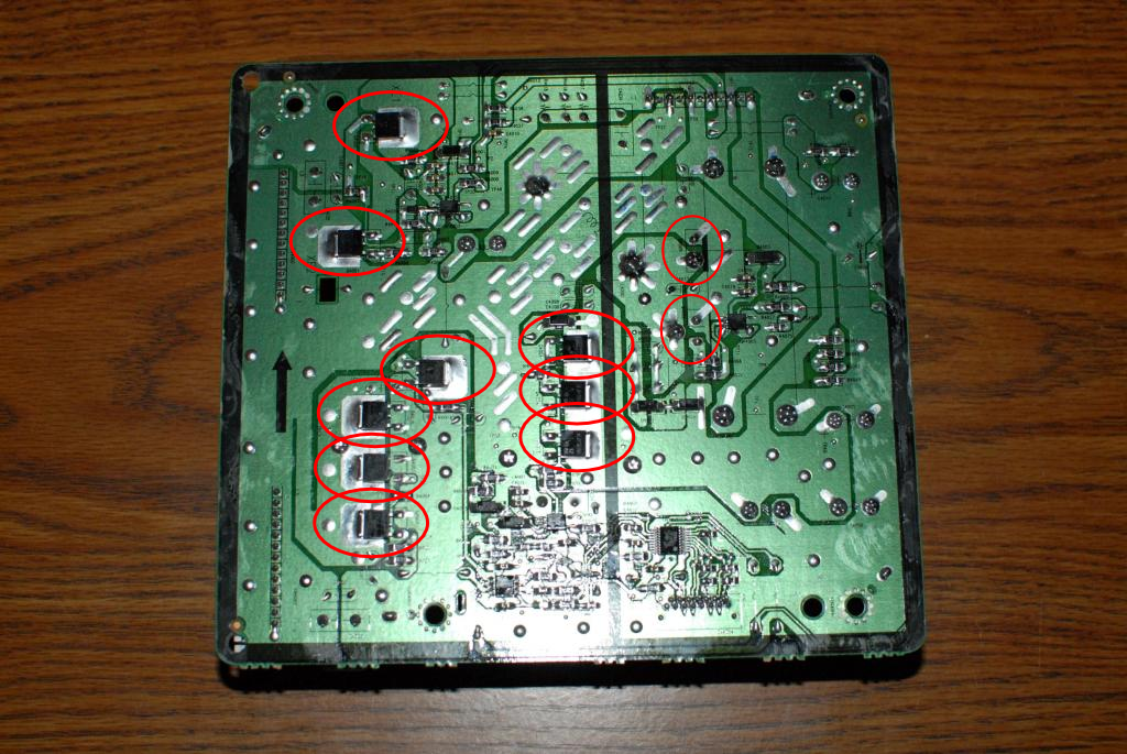

        I've highlighted some places to make tests.
        On each of the devices I have highlighted note the part code e.g. D8280 or Q8099 and the resistance (200 ohm scale) measured between pins 1-2, 2-3 and 1-3. Note numbering is arbitrary (i.e. as you wish), but between each device try to be consistent.
          The attached PDF table is slightly easier to read.

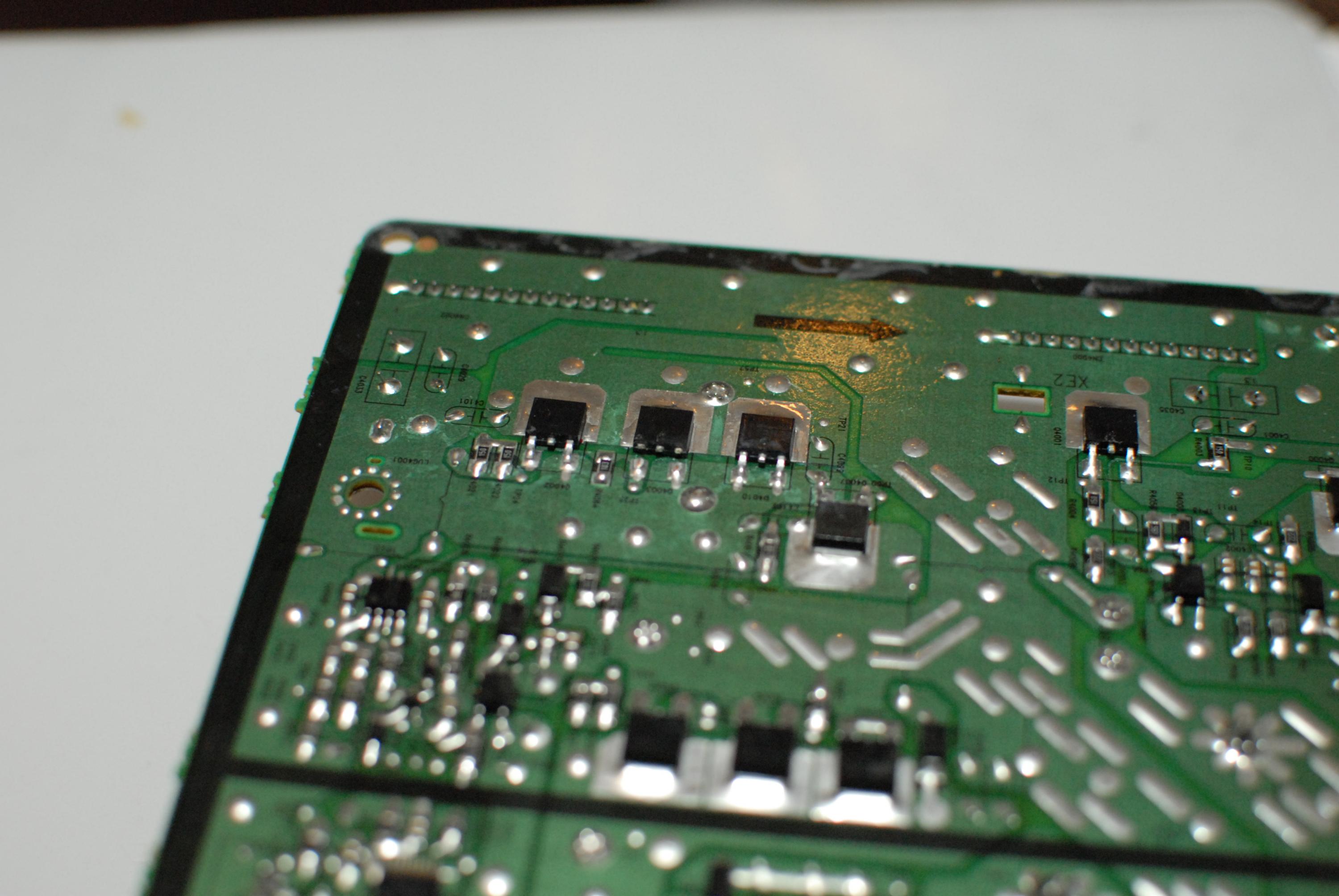

          *Value is averaged; value is measured, & disappears – is instantaneous and does not hold steady.
          **Solder connects the two pins across the board – see picture.

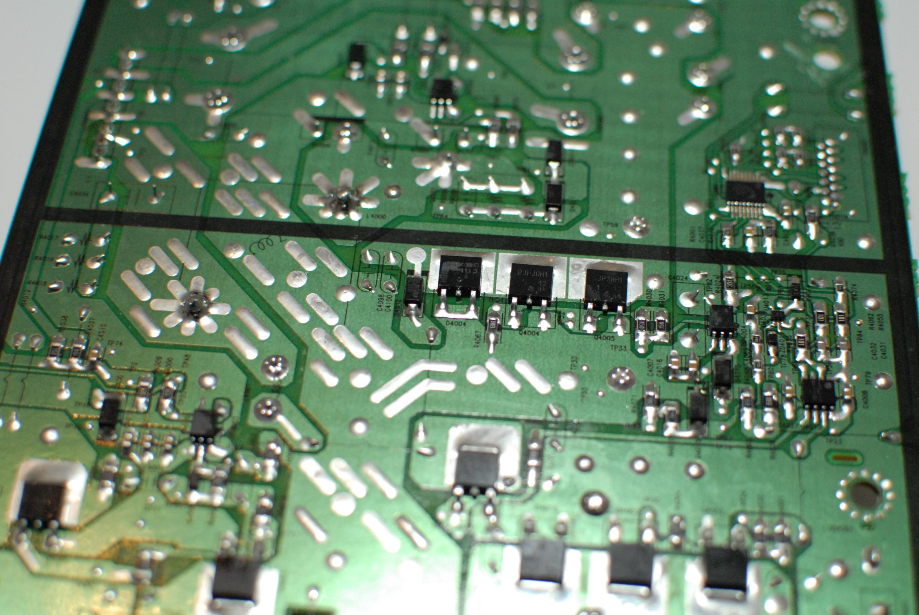

          #Picture is attached – does not appear to be connected properly – is missing the outer 2 posts connecting to the board like all the other components.
          Thank you again.
            Looks like there are no shorts. That FET with the missing leads is very strange. I have seen later versions of that board with that FET completely missing. Chopping the leads would do the same thing as not putting it on at all, so it's probably a modification done after the fact. Wonder why they did that...
            Next step is to look at the Y-main. You can test similar devices on it.
