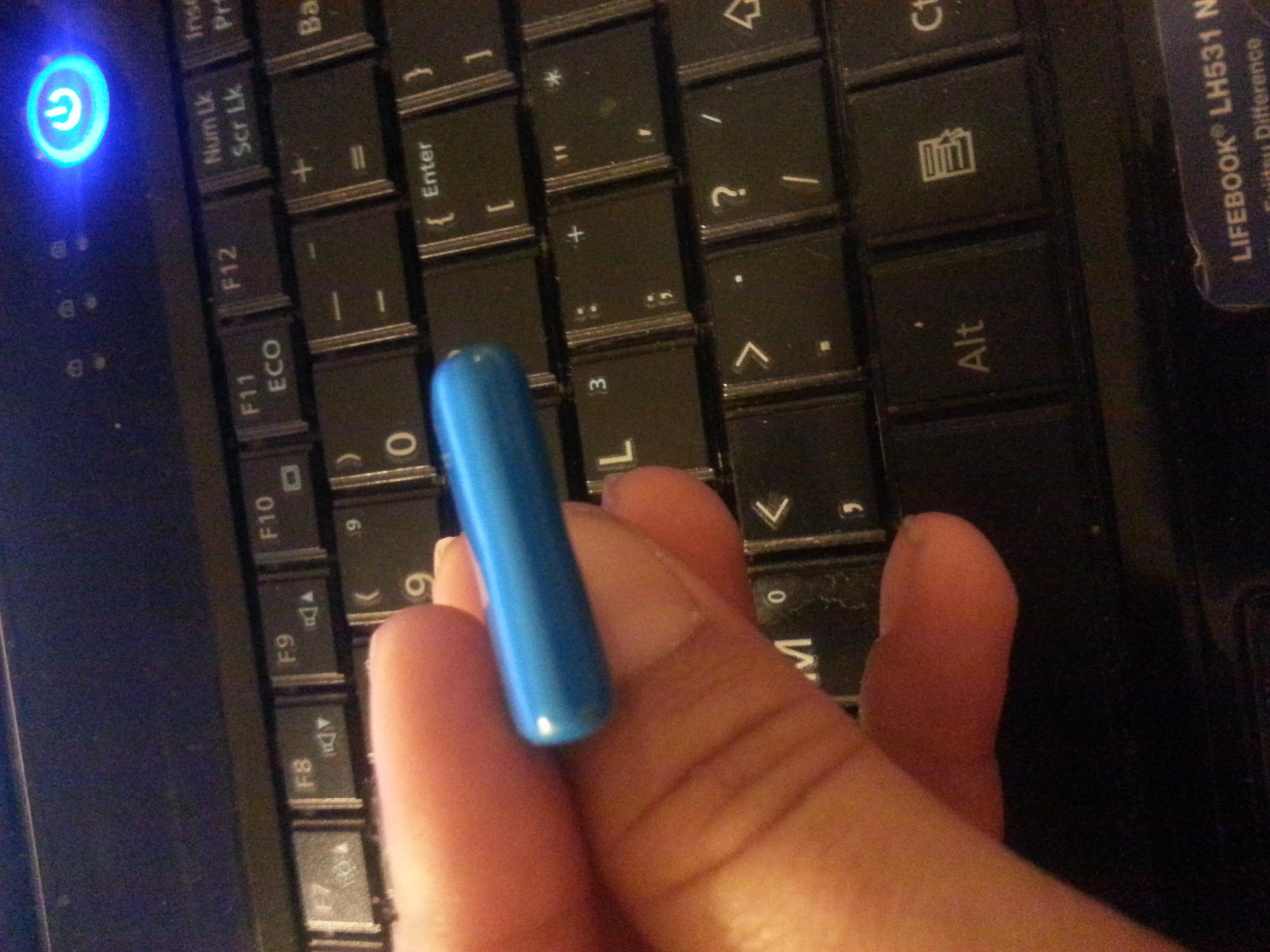

            i ordered the 399-5982-ND and it did not work The other part should be here tomorrow but if this one didnt work how do i figure the next one will? my led light is on and you can hear it make a noise when you plug it in this tv is only 3 yrs old what else could it possibly be??

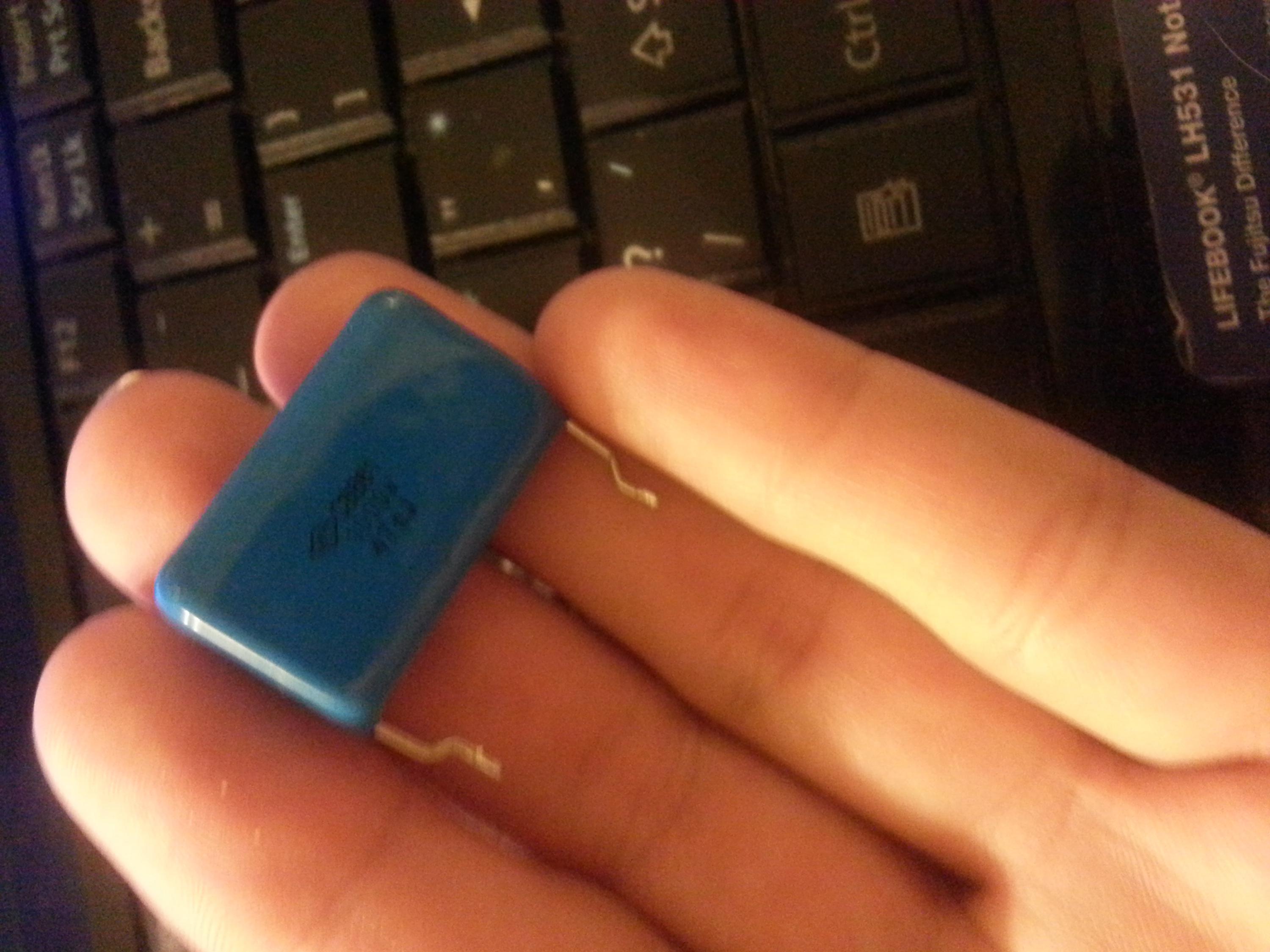

                the symptom sounds the same. .. red light on plus click but no response to touch sensor or remote... did it have a bulged blue capacitor? if so is that the one you replaced? Did you make sure to double check your soldering? all cables connected? it was a quik ez fix for me..

                      and no the blue thing wasnt bulged the repacement wasnt blue it was black??

                        when the blue cap fails its noticeably buldged on one end if its not then there's a good chance it did not fail and that is not your problem and yes the replacement is black... most of these tvs fail do to the blue cap.. but your seems to have a different issue

                          hopefully the pictures uploaded
                            #33
                            Re: Element ELCHW402 - Will not turn on!
                            im thinking so cause the blue cap is not bulged as you can see
