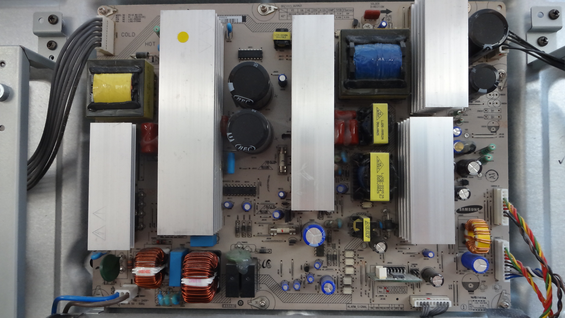

    Alright, so I have a VIZIO VP423. When you plug in the power cable it makes a click (as TVs do when you turn them on), the backlight comes on and there is some faint static on the screen. Neither the power button nor any of the other buttons seem to do anything at all, and there is a faint buzzing coming from the Y-main board. The readings off of the main power board are as follows:

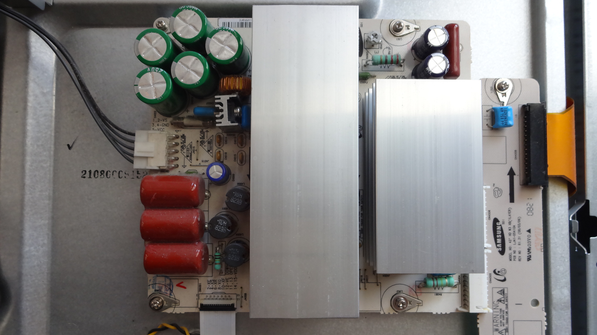

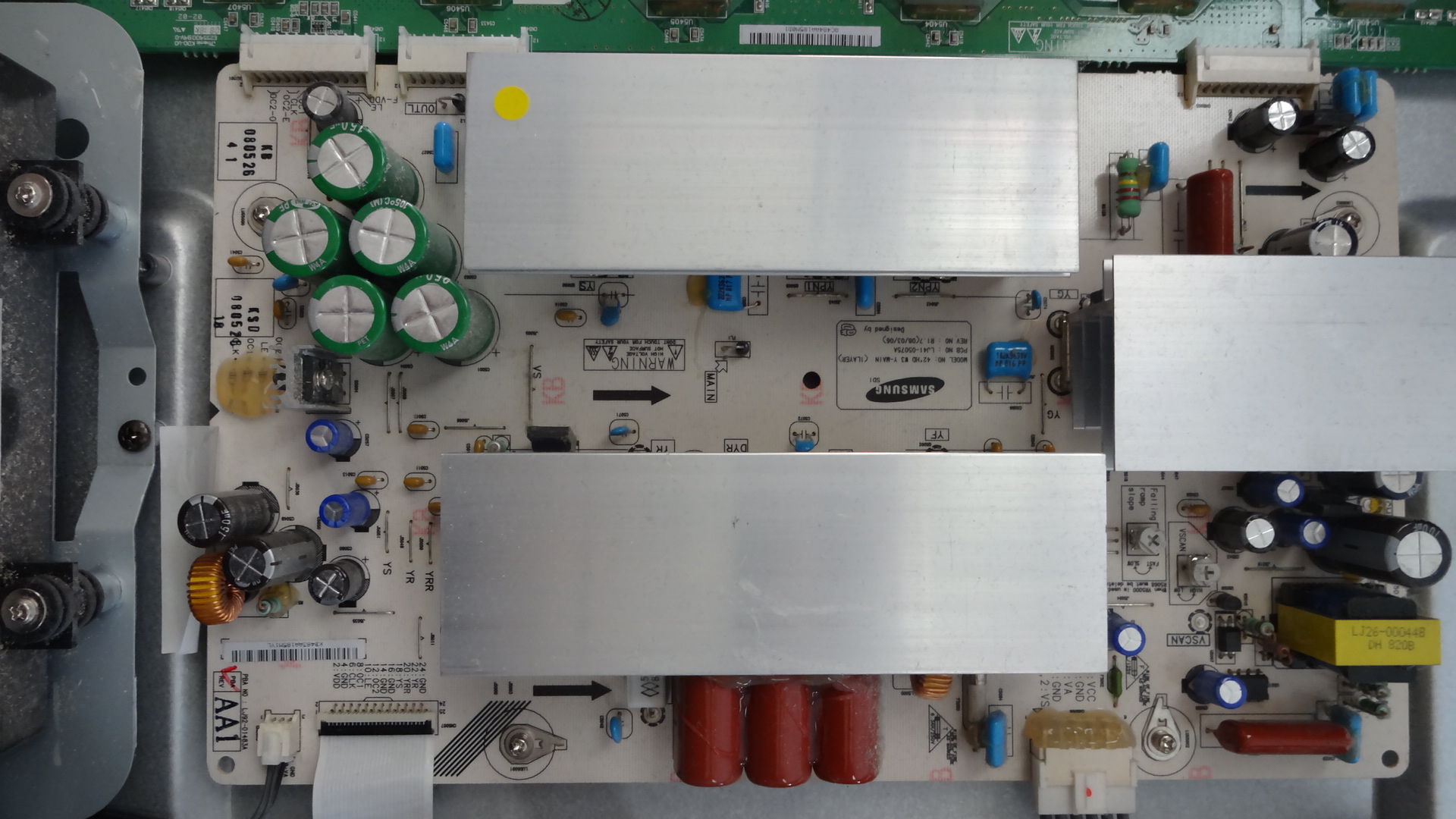

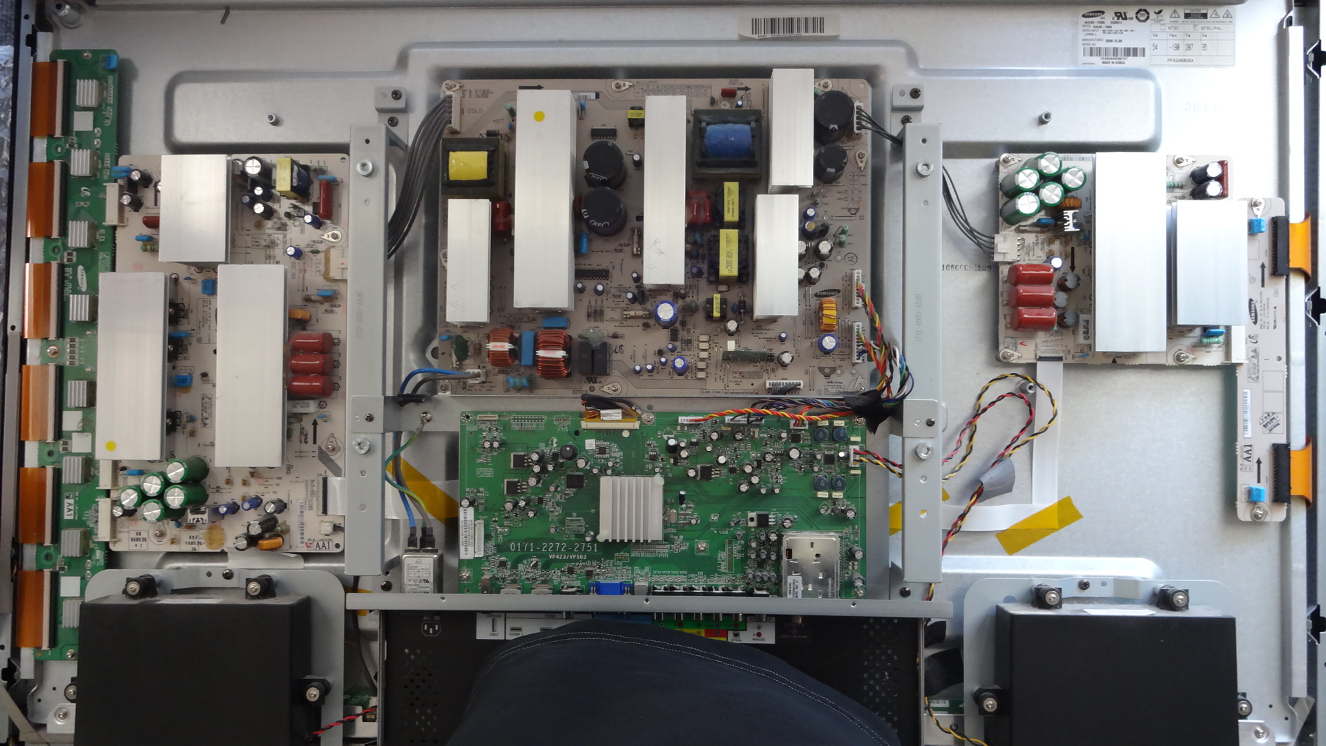

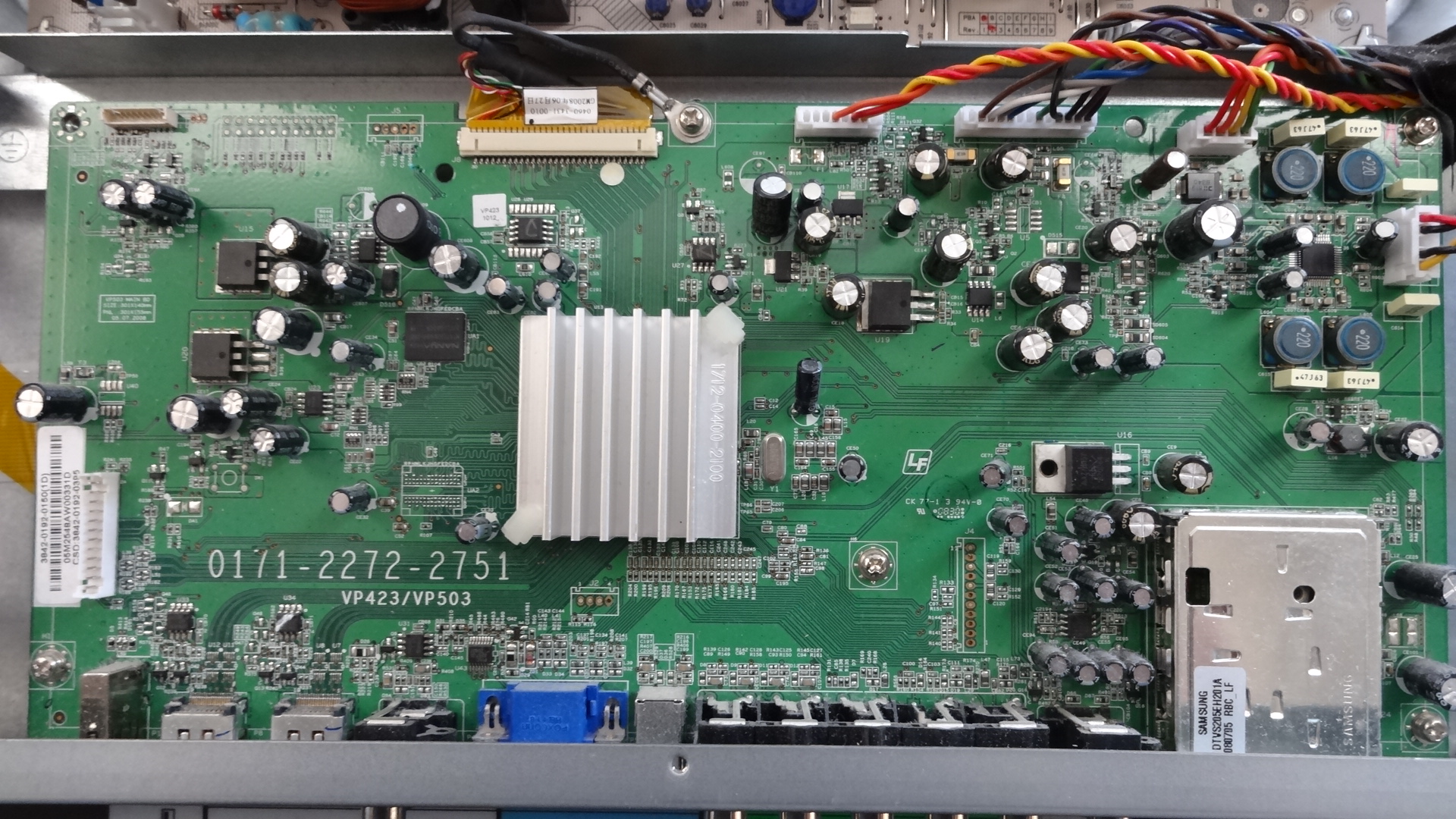

    Higher Res Pictures:
    Power Board
    X-Main Board
    Y-Main Board
    Input Board
