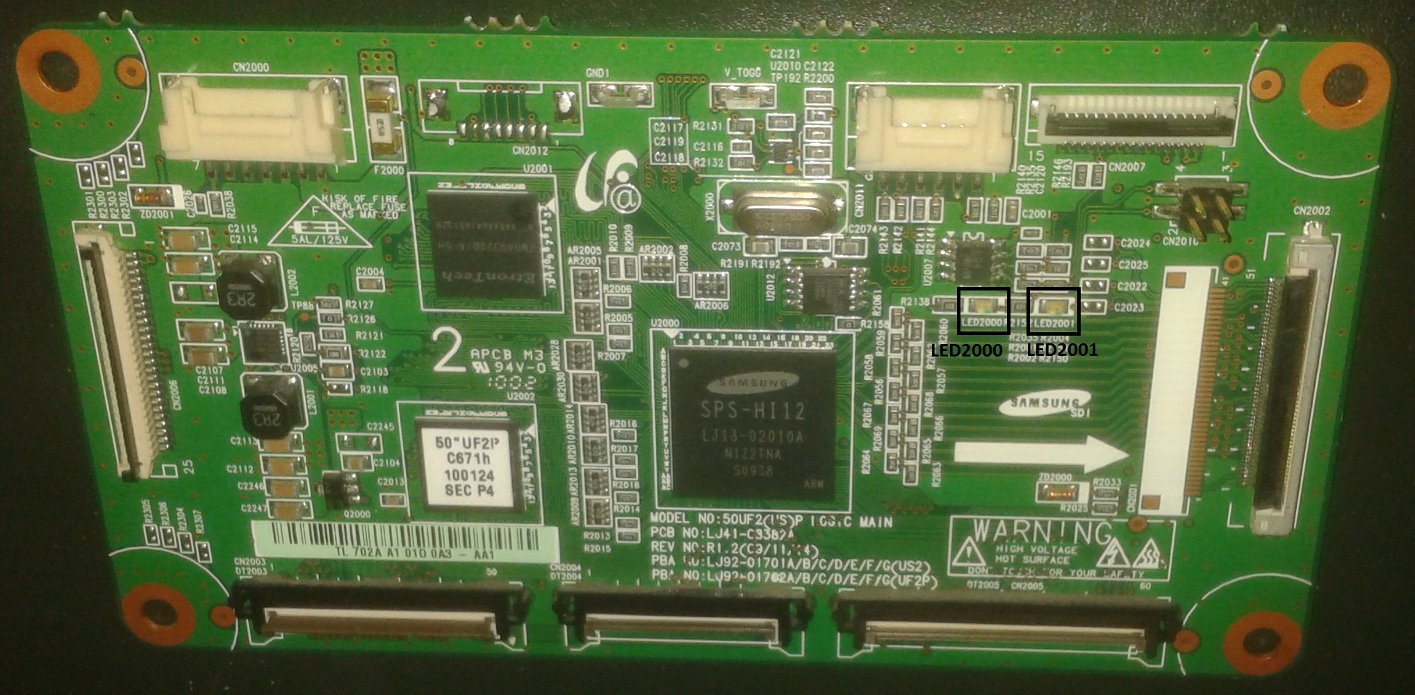

    With all the boards plugged in I get 6 flashes from the power LED after turn on.
    With all the boards plugged in, the Va and Vs voltages are not held up to there 210 and 65 volts, the PS_ON signal from the LOGIC board is held low so i'm guessing this is turning these voltages off.
    When I unplug the Y_SUS board from the LOGIC board, PS_ON is 3.3V and the Va and Vs voltages are good - also the power LED on the front panel behaves as normal, ON when in standby and OFF when TV is turned ON.
    This behaviour with unplugging the Y-SUS board is the same with both sets of Y-SUS and Y-Buffer boards.
    Does this indicate that there could be a problem with the new panel or possibly both sets of Y-SUS boards?
    I have also had a play around shorting out the jumpers on the LOGIC board with all the boards plugged in, to try and get the test screens to display. And I am sure I got the screen to flash up for about 0.5s with a display but have been unable to repeat this so think this could be a frustration induced hallucination!
    Additionally, does anyone know what the different LED flashing pattern are on the LOGIC board? The two green LEDs LED2000 and LED2001 - shown in image.
    With the Y-SUS unplugged, which I am presuming is running OK and not detecting a fault, is LED2000 flashing at approximately 1Hz.
    With the Y-SUS plugged in, which I guess is a fault detected safe mode, LED 2001 flashes much slower - maybe 0.25Hz.

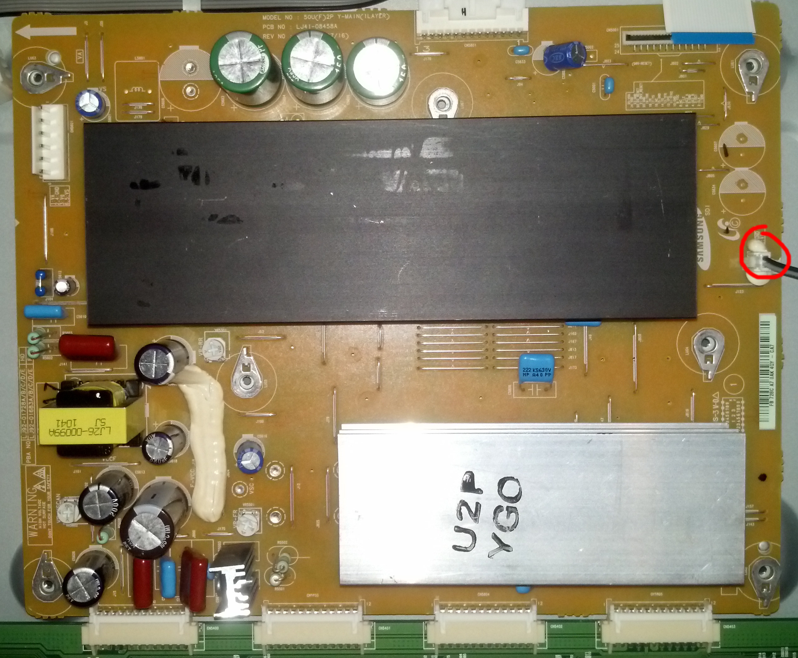

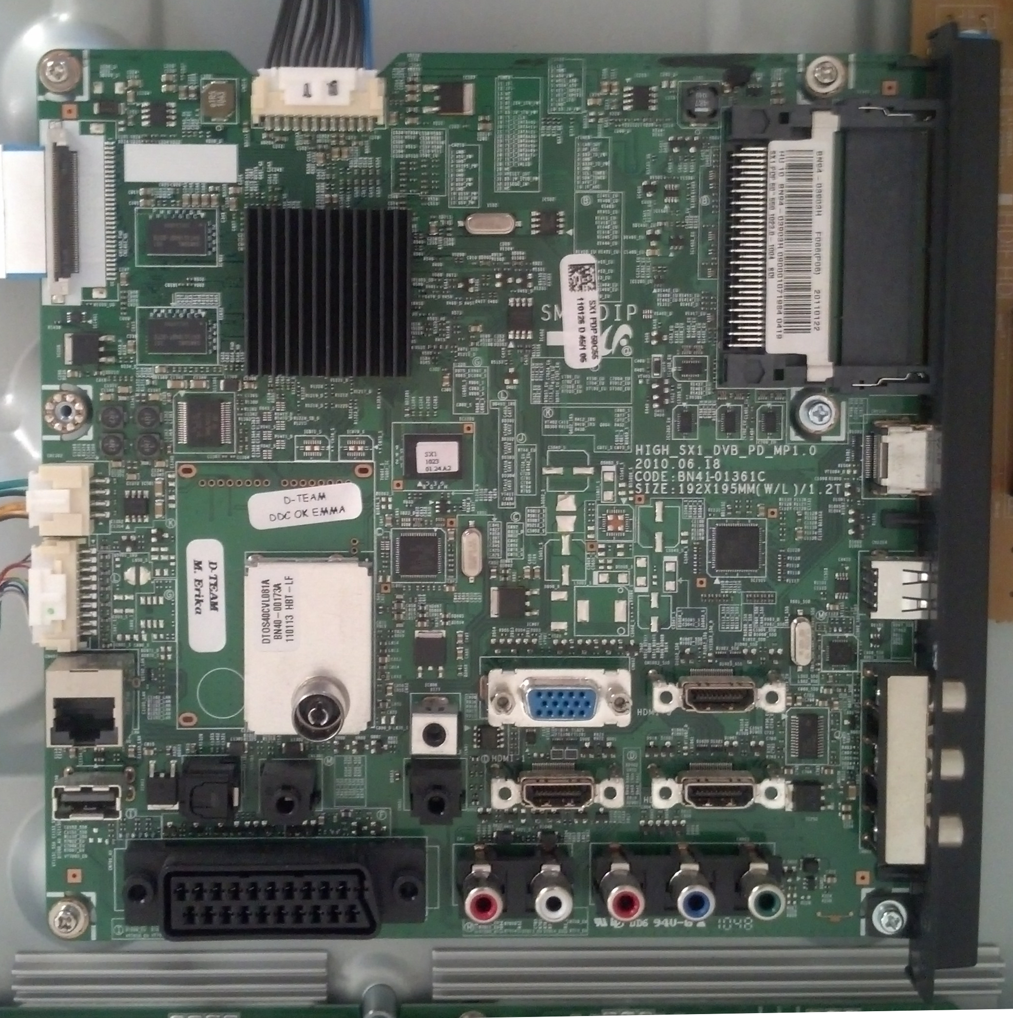

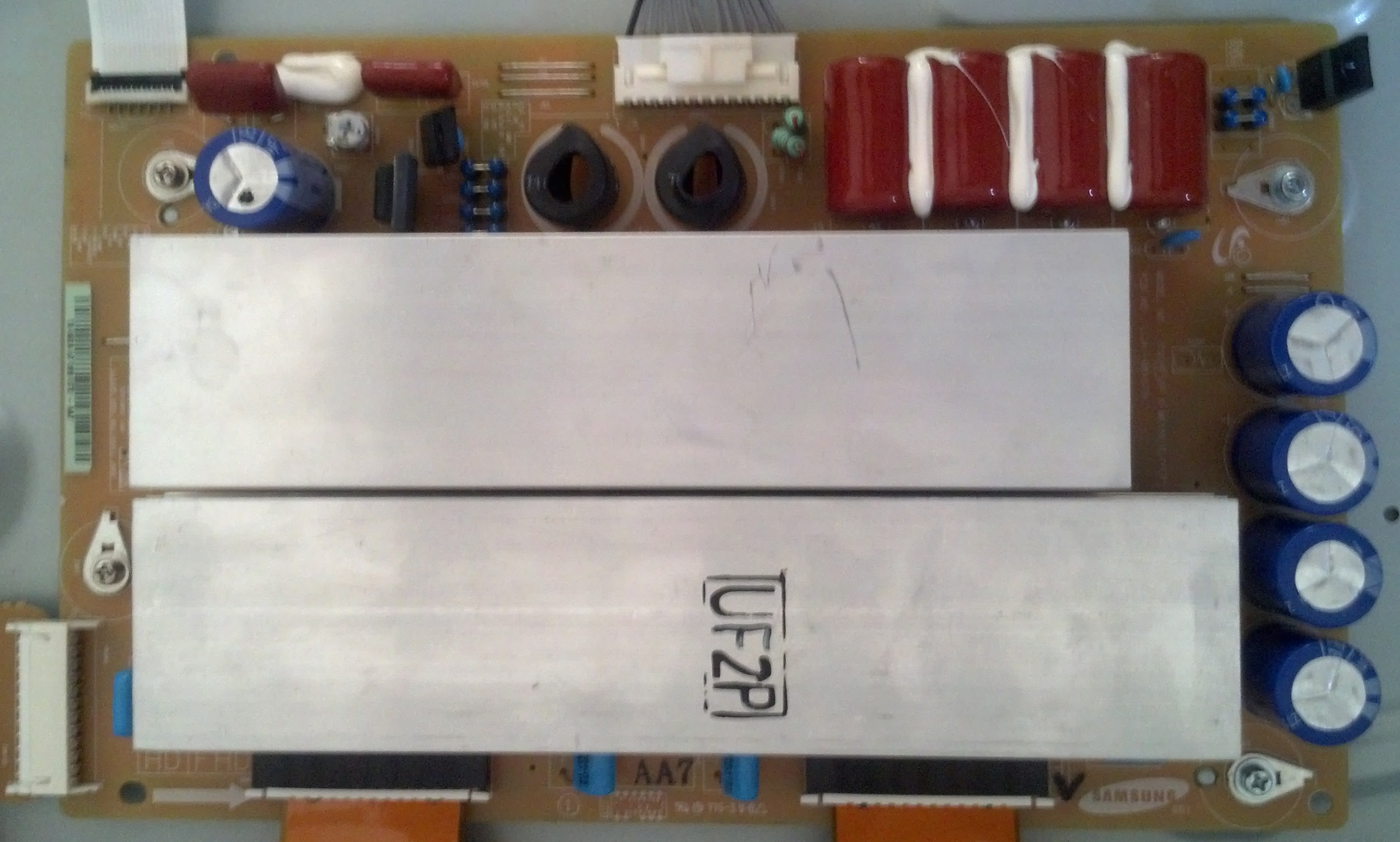

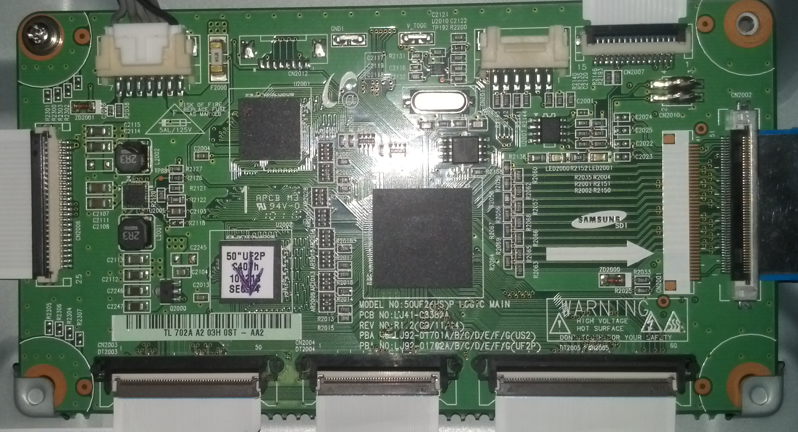

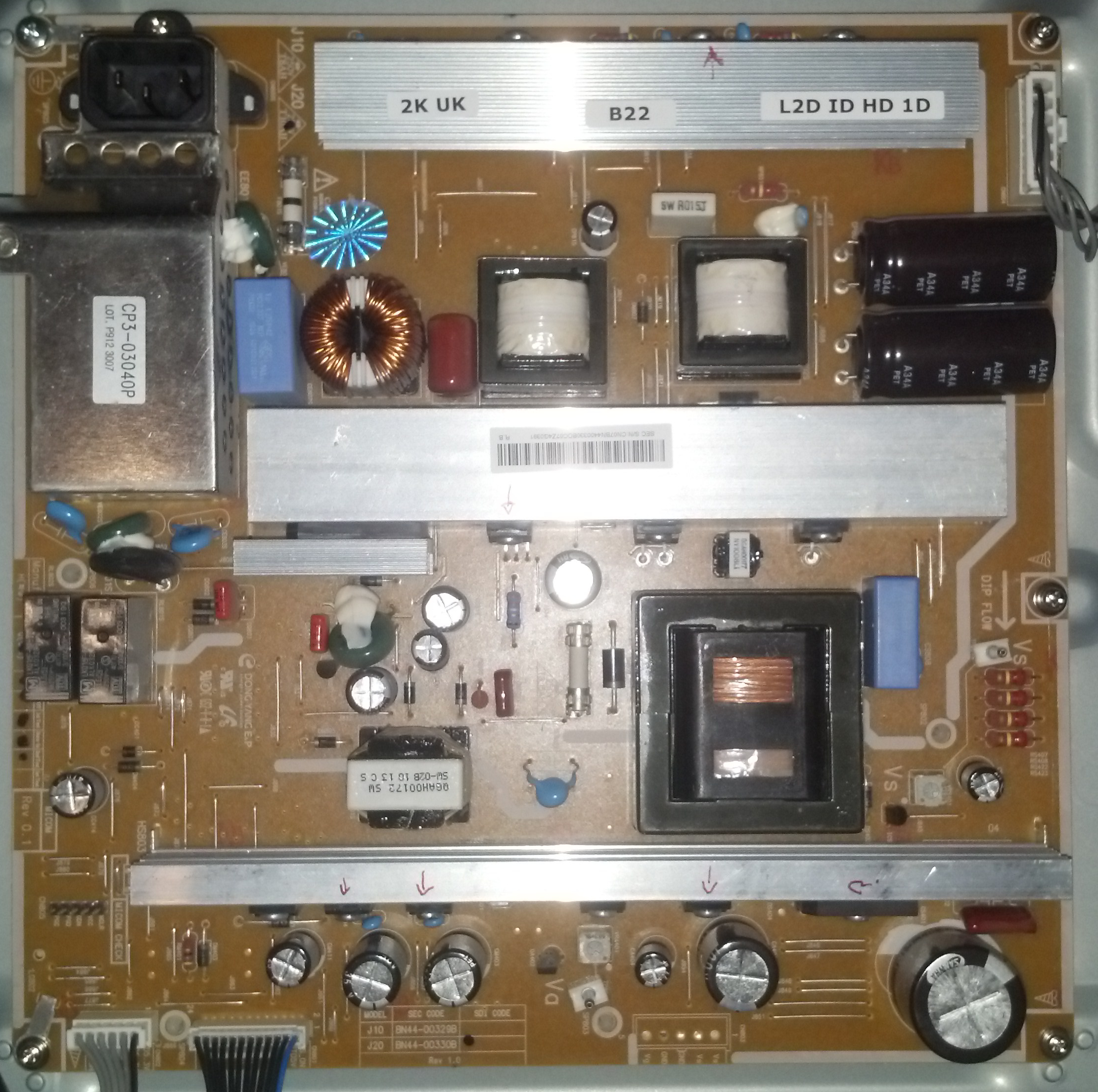

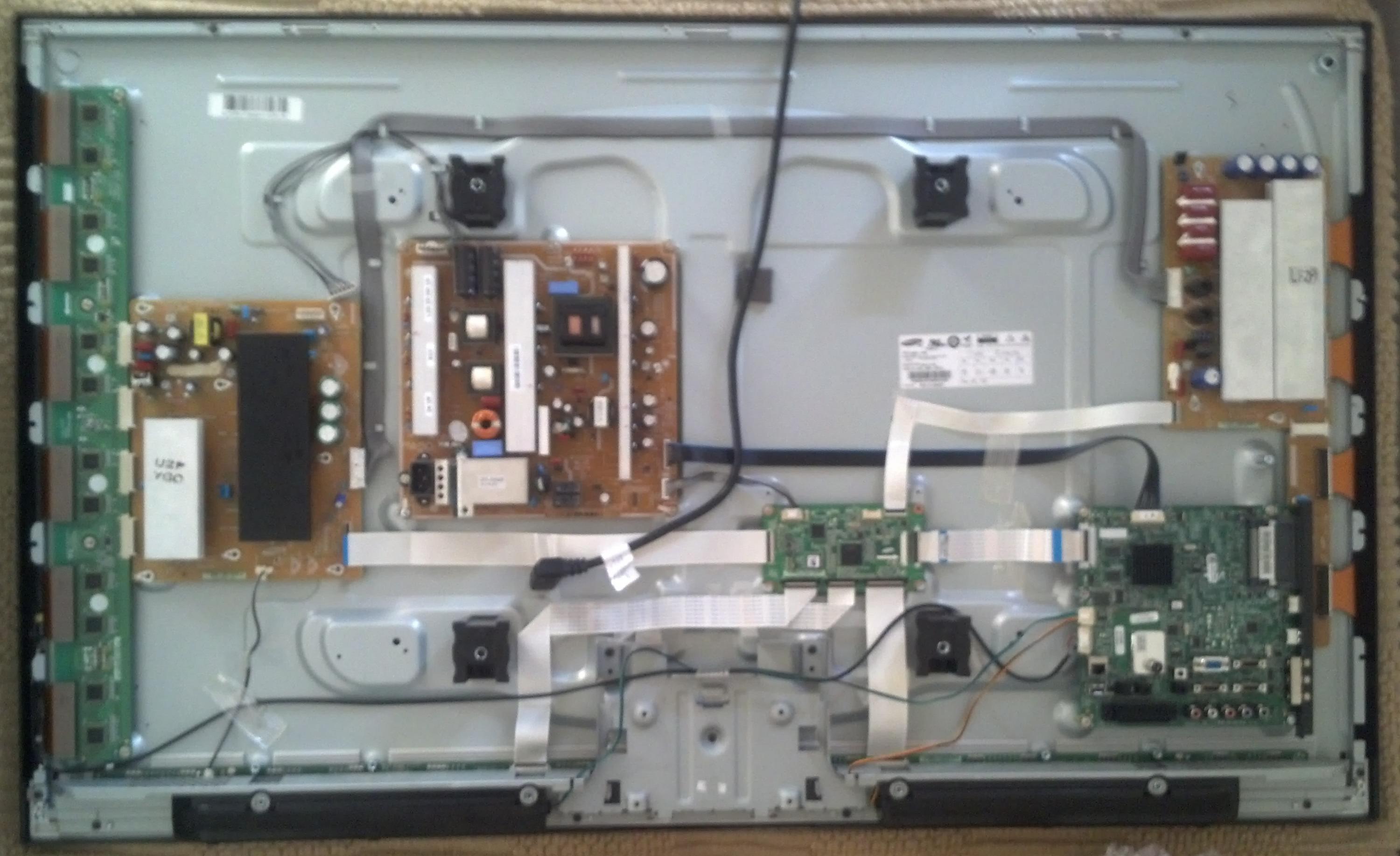

      Re: Samsung PS50C550 screen not powering

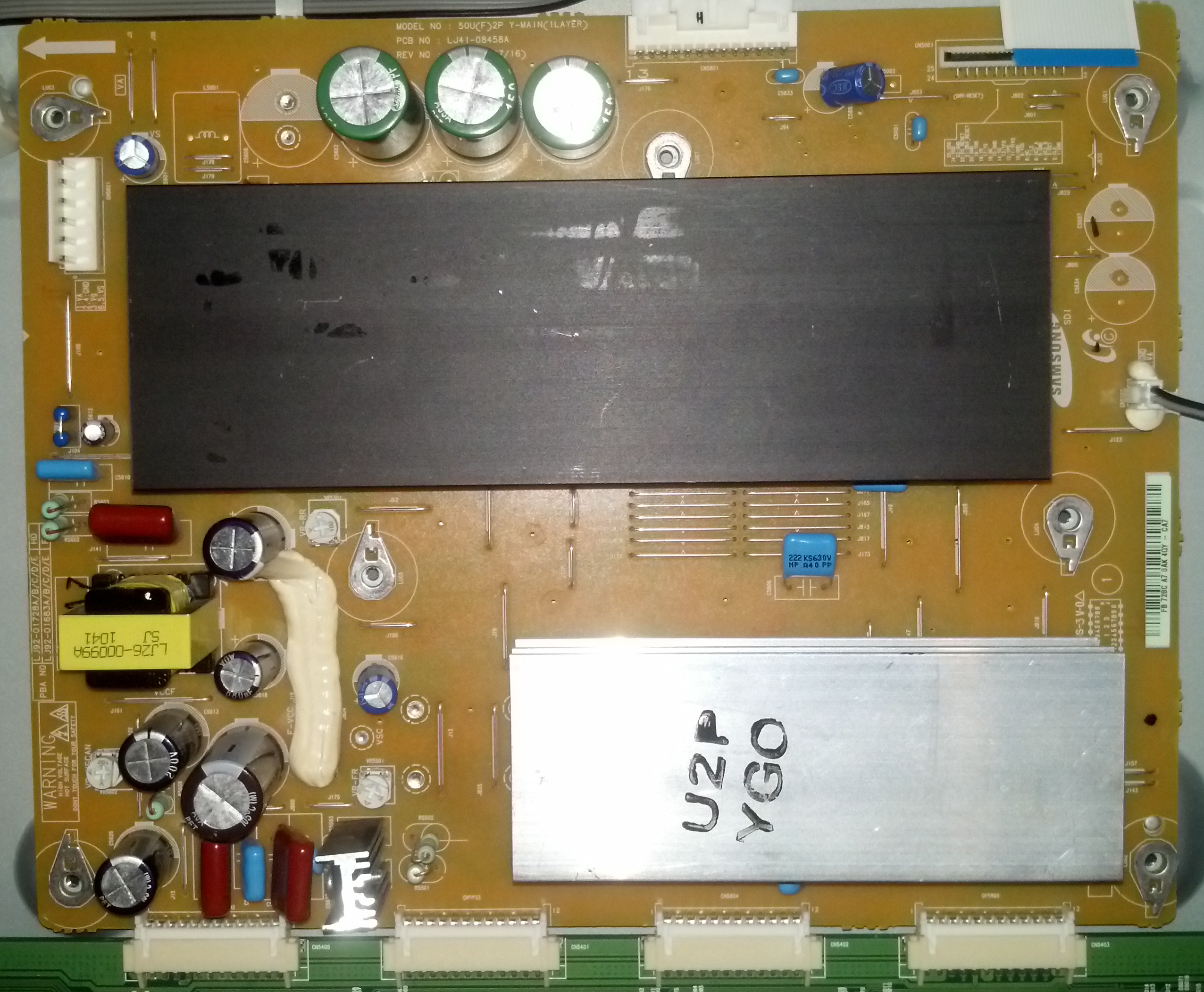

      Can you post a picture of the chassis layout and one of each board?
      • ViperRunner
        • May 2013
        • 32
        • Portugal
        Thanks for the quick answer!
        Here are the images! If you need anything else please just say!
        Best regards
          Unplug this connector here. Does Va rise to rated 55V? Does the screen glow?
          [Note: Do -NOT- re-connect this while the panel is powered up!! Doing so will permanently damage the plasma panel.]
