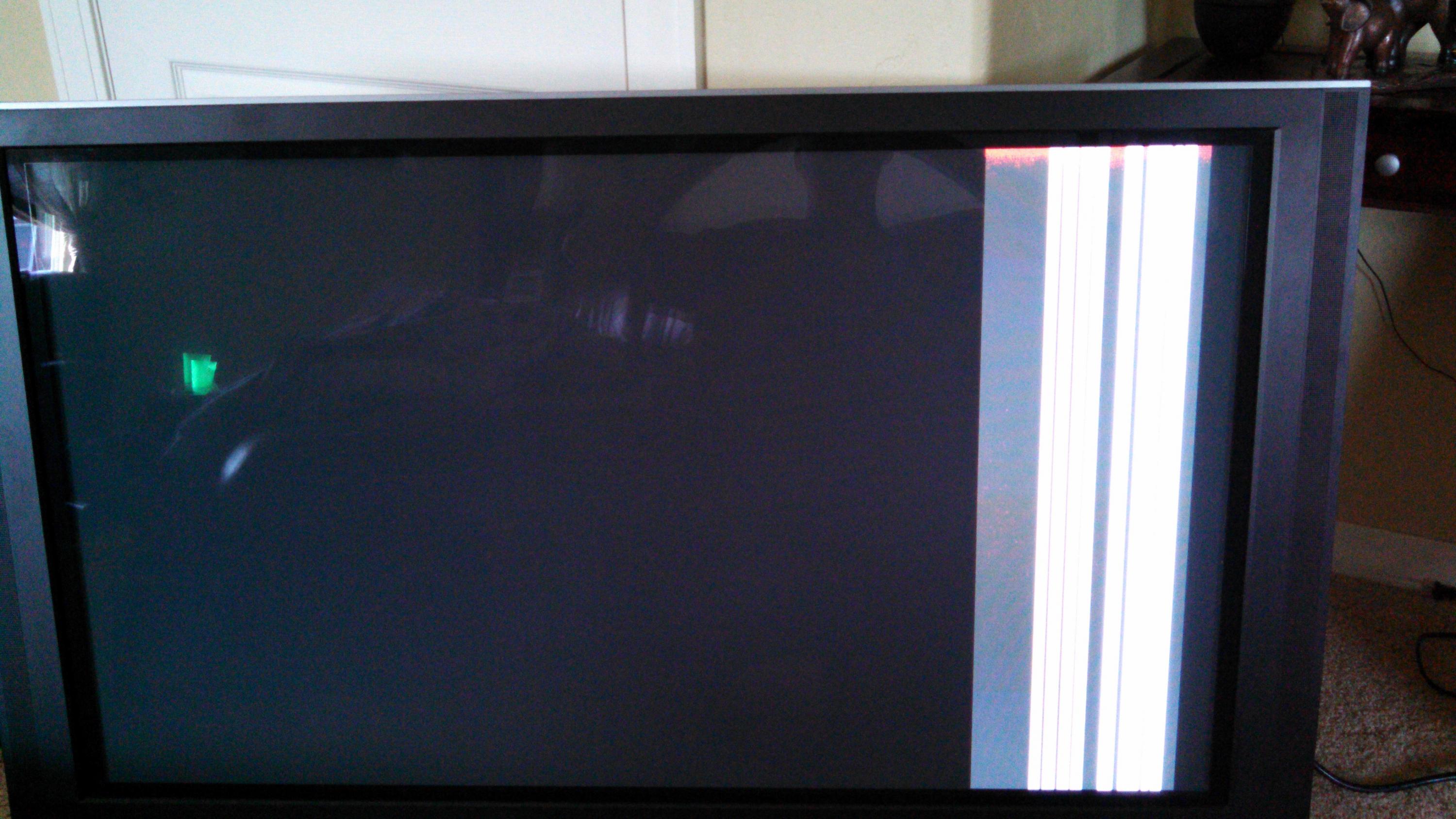

    50" LG plasma . Vertical lines up and down screen.
    I need help, I have sound but no picture. The vertical line are different colors and range in size. I have tried un-plugging, and check all hdmi hookups. I pulled the back panel off but i dont know what i am looking for.

          Re: 50" LG plasma . Vertical lines up and down screen.
          Plasma panel itself.
          Y-sus and Z-sus can never cause vertical lines.
          They are only responsible for making the whole screen light up.
          Please, we need pictures.
                Here is a pic, sorry it took so long... still learning how to do this..
                  Do those lines move across the display occasionally?
                  How's it look like with a menu or video on the screen at the same time?

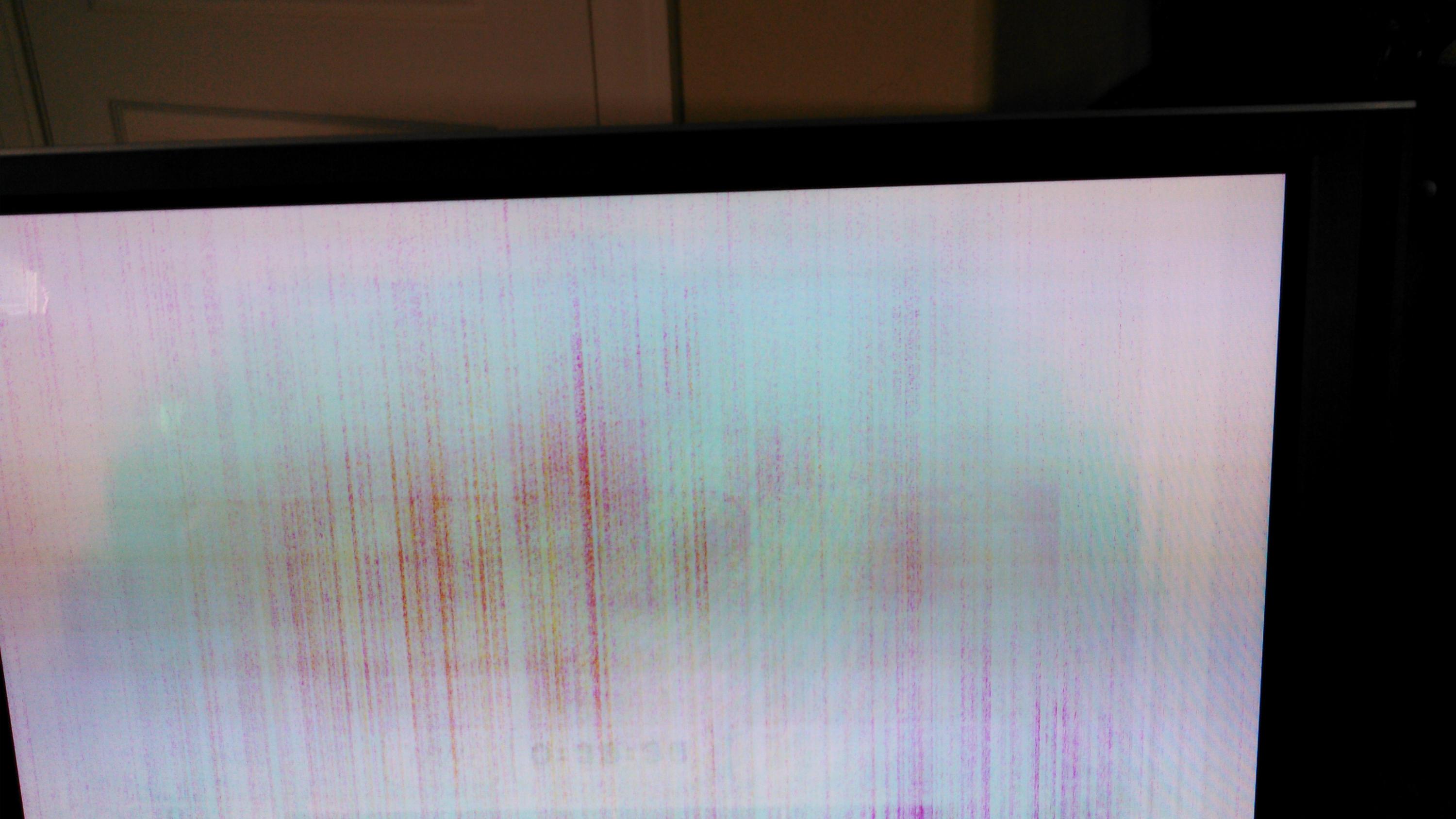

                    here is another. The TV now with shut off right after it goes to this screen.
                      Possibly Y buffers.
                        The lines do change, when i change chanels of push menu.
                          would this also cause the tv to turn off?
                            Y-buffers then.
                            I may have to retract Y-sus as "not being the cause"!
                            There is the possibility the Y-sus has damaged the buffer board.
                            Because of the cost of Y-sus and buffers it would most likely boil down to an IPM replacement plus replacement of up to 8 buffer ICs, which is not an easy job.
