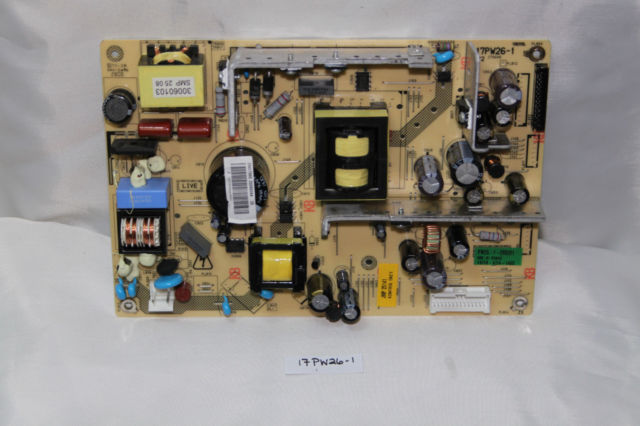

                        Re: Goodmans LD3265D2
                        Thanks for the replies guys...
                        Here is a picture tom...
                        So do my symptoms go towards the main board or PSU?
                        By the looks of the PSU it has been repaired and by checking it against schematics some of the caps are different ratings... The psu is also whining when live and clicks and buzzes. Dont know if that helps.

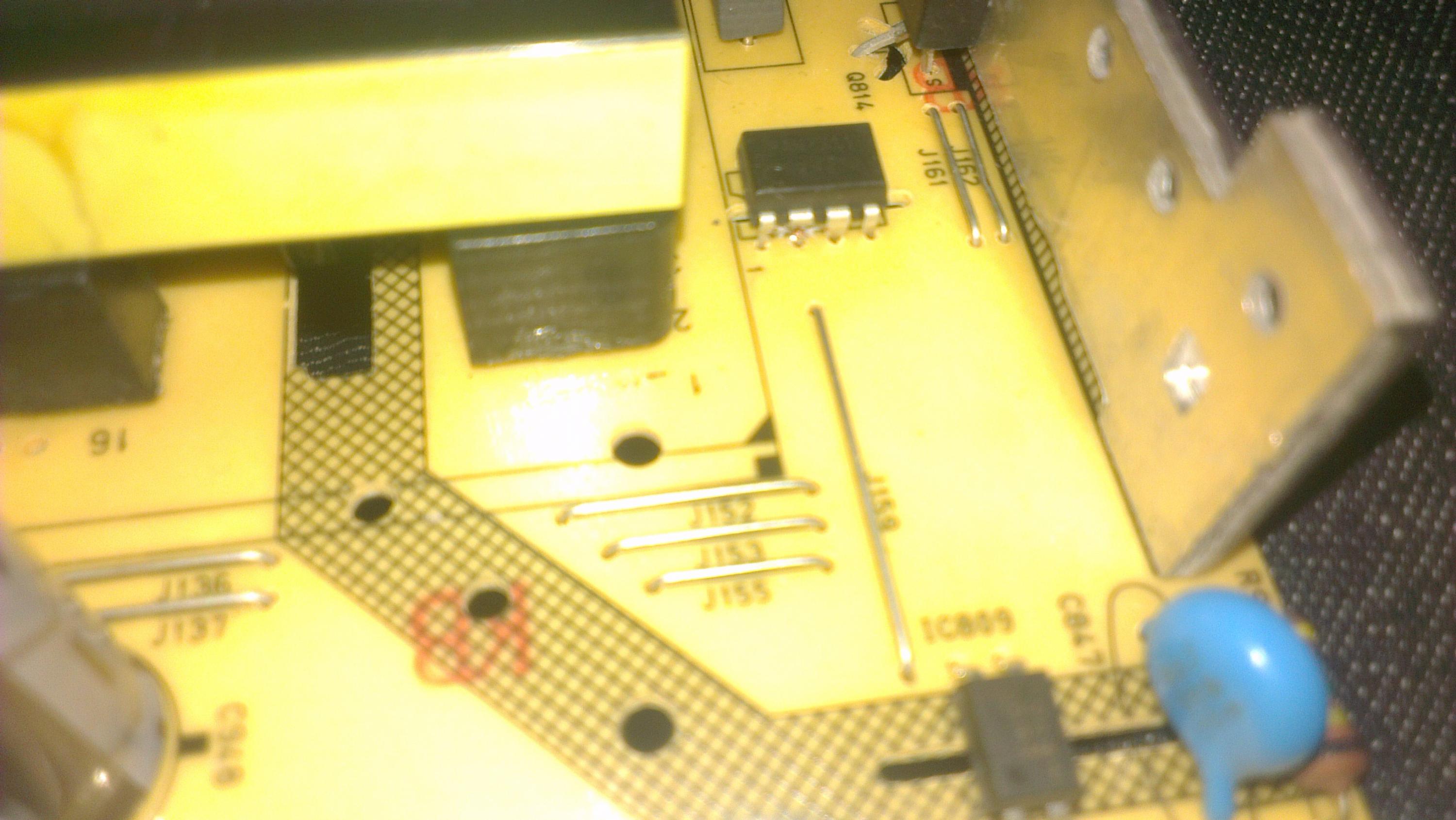

                              Also noticed a few other things.. looks like someone with no know how has done this board in an attempt at repair... Pin 2 of IC830 which according to the diagrams is the protection circuit has been severed :s
                              • newtothis
                                • Mar 2013
                                • 1556
                                • england
                                here is a pic of IC830... You can see the cut pin
                                • is_it_a_bird
                                  • Feb 2013
                                  • 59
                                  • United Kingdom
                                  Id change the cap straight away for the right one, Have you got a picture of the underside of the board? Has it blown the leg off the IC

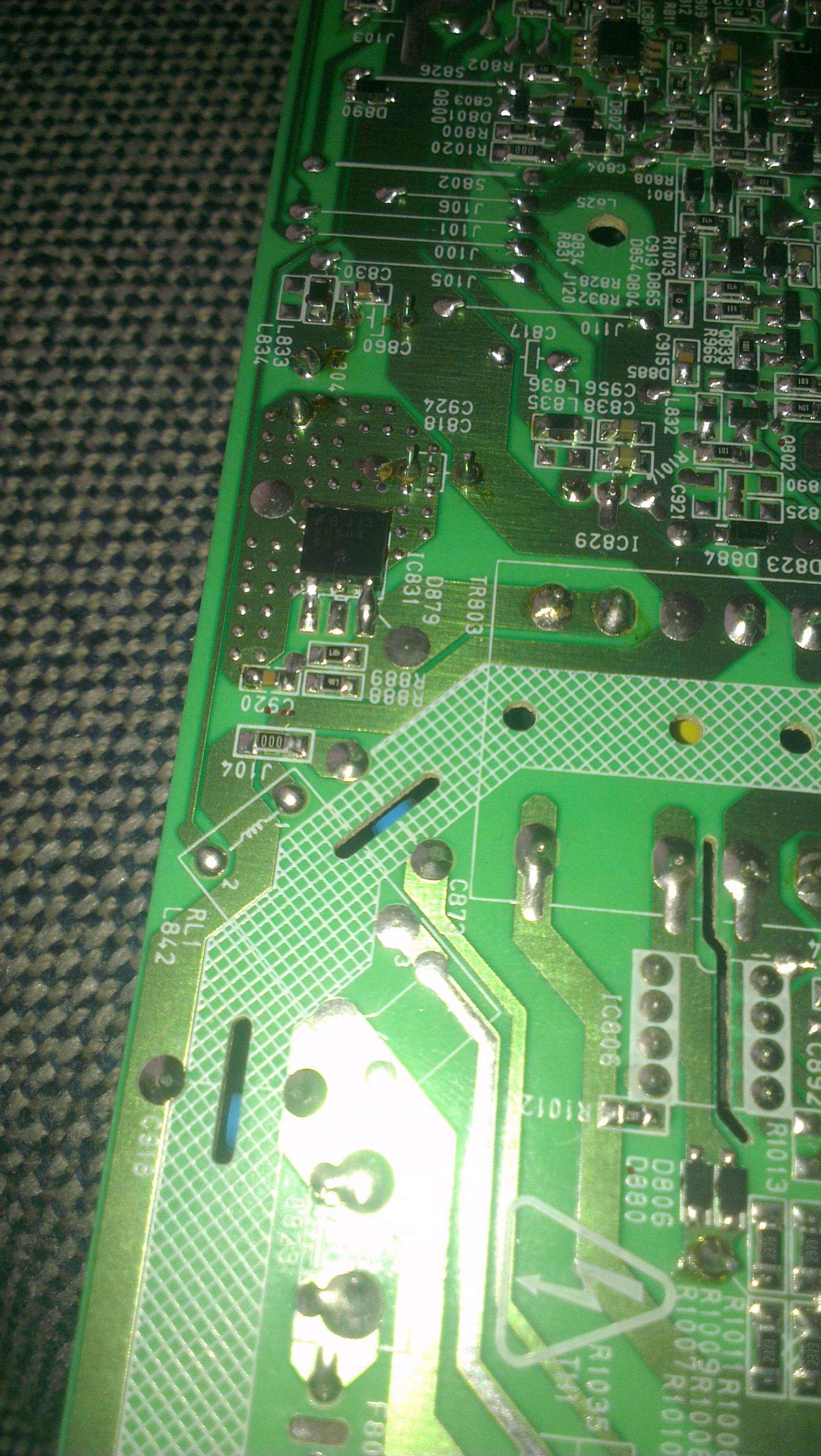

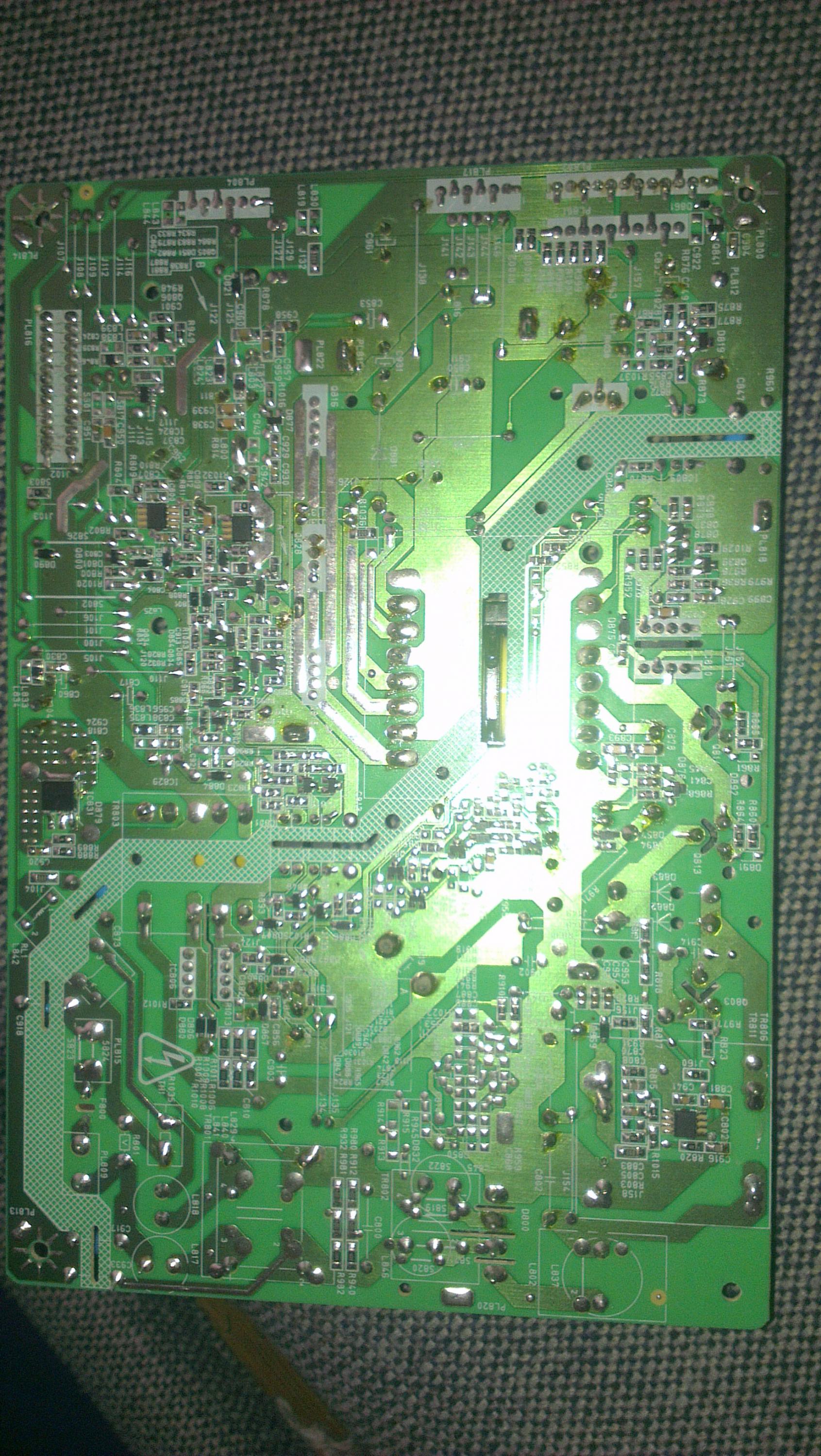

                                      Dont think im gonna check anything else as to what i can tell its got to be the PSU that is indeed shot.
                                      Here is a pic of the reverse side and of the IC that indeed has a leg blown.
                                      Dont see any point in repairing it as have one on order and should be here tomorrow.
                                      Would you agree it is the PSU that is dead with all of that?
