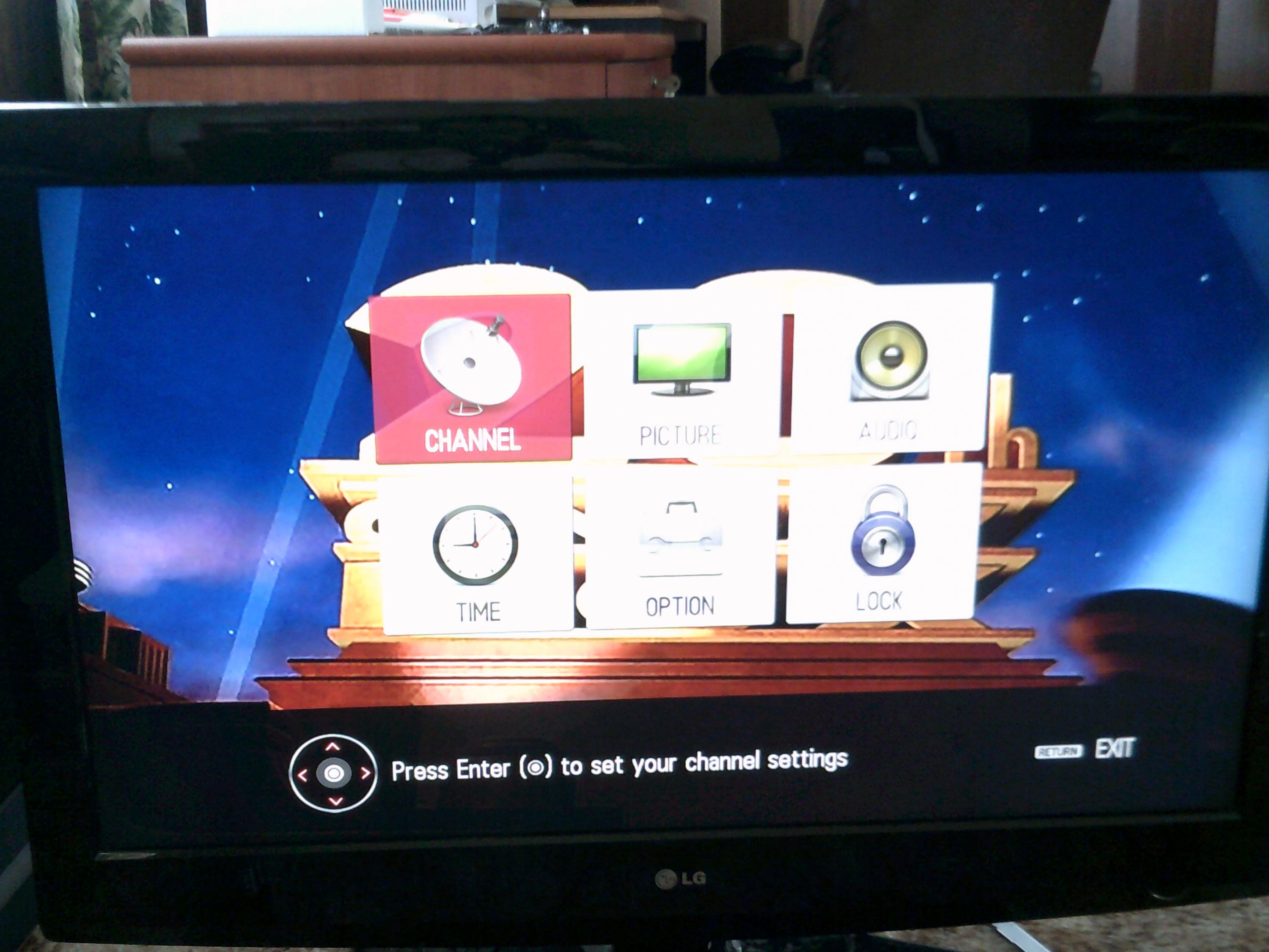

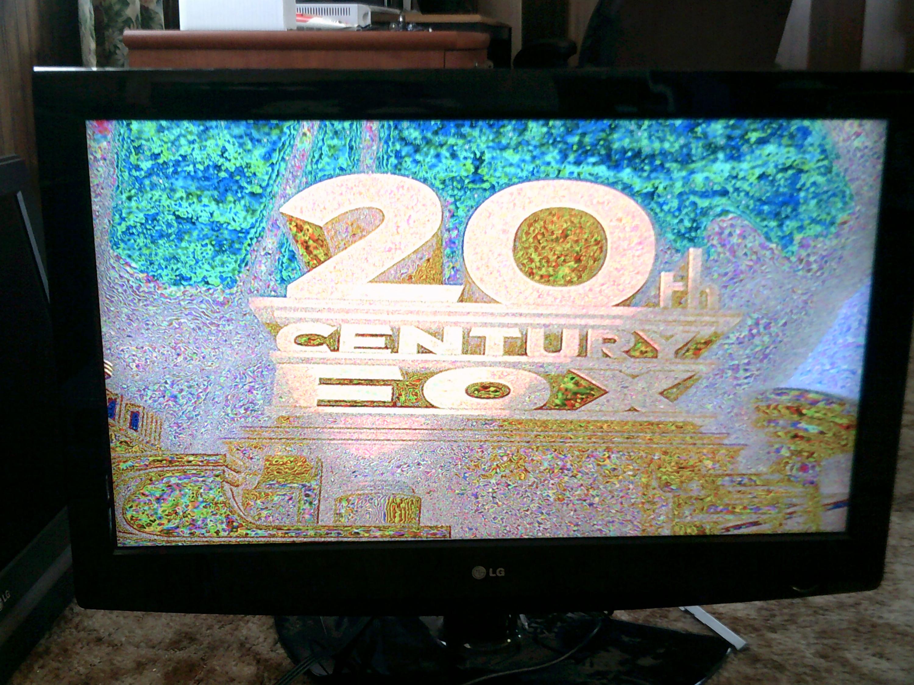

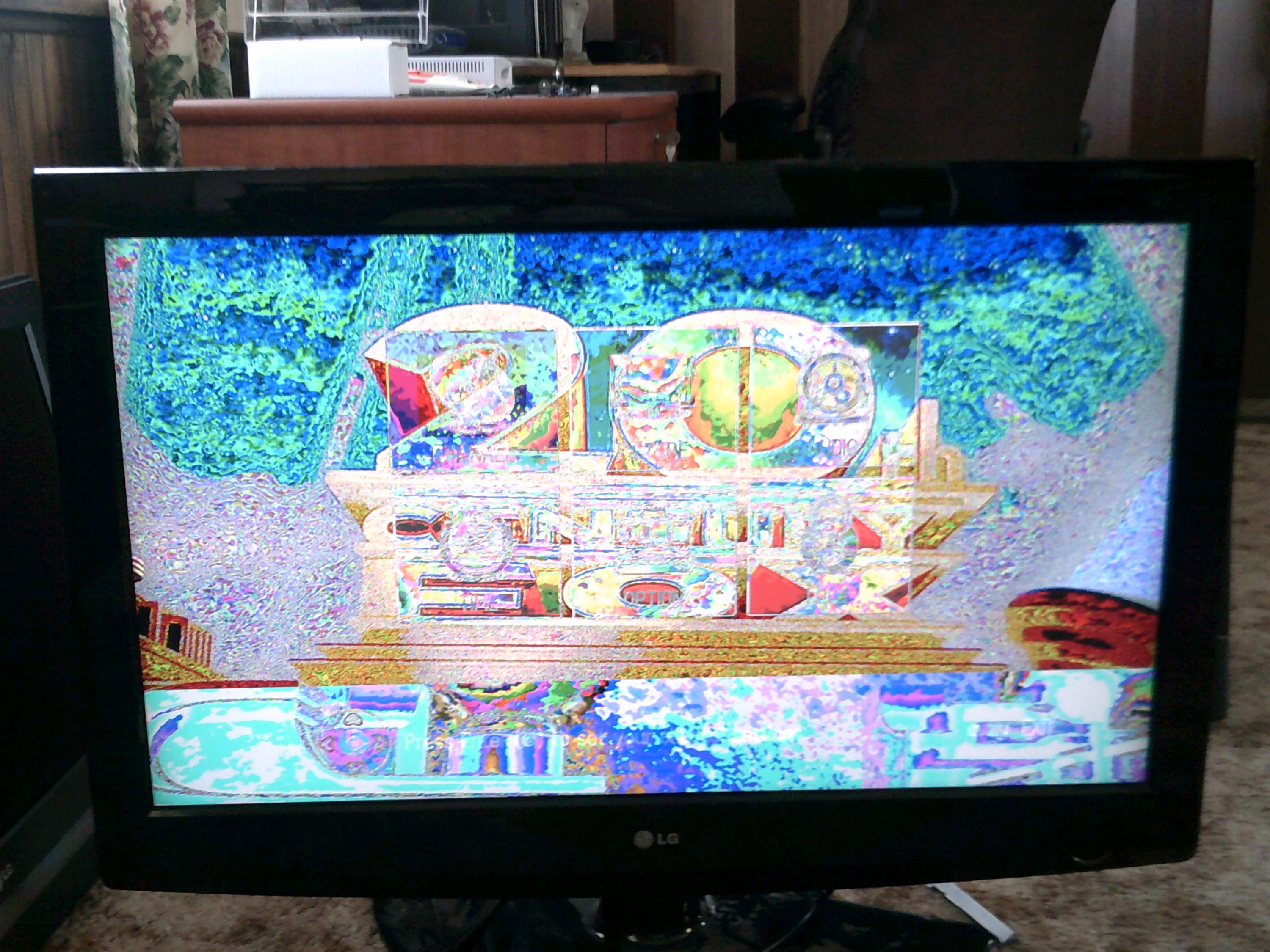

    The first 2 pics are what I saw after turning on tv. Second pic shows it affects menu/input also.
    There is also slight crackeling static and squeeling/whistling sound from speakers but audio is still there.
    I reset(eeprom) main board(upper right on main board) and picture and menu came back(pic3).
    Picture and menu work good until I change input on side of tv and it makes a pop sound through speakers and reverts back to what you see in pic 1 and 2. Sometimes I loose audio when picture is messed up but not always.

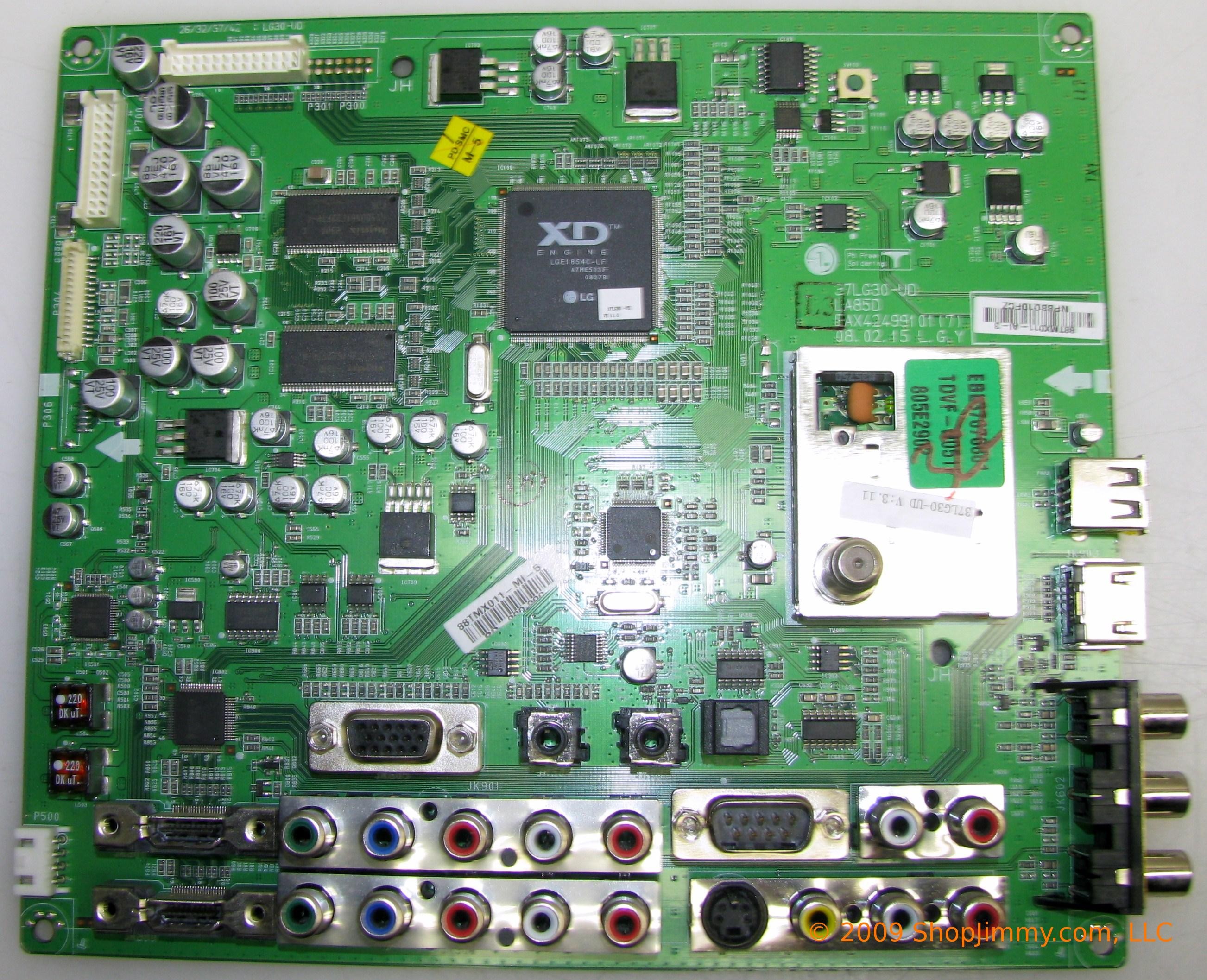

      I think this is the correct board.
      Main board#- 37LG30-UD.BUSQLJM
      http://www.shopjimmy.com/lg-37lg30-u...main-board.htm
      I dont have an original remote for this tv so I will program one and try your suggestion.

              Main board reset
              Power on- speakers pop.
              Picture and menu are fine, audio works but has static/whistling.
              When I change input control the speakers pop and picture/menu go bad.
              If I change input back or turn tv off and on it is still bad.
              All inputs work only after selecting input then reseting main board.

                Re: Lg 37lg30
                I want to save as much $$ as I can while getting the correct part the first time. Iam seeing many different boards that may work. Noone seems to list the barcode. The link below shows several. The very first one should work(but out of stock), but would one of the cheaper ones also work?
                http://populargaragesale.com/pgs/ind...me=eax42499101
                37LG30-UD.BUSQLJM
                LA85D
                EAX42499101(7)
                Barcode-E87V01131P
                Panel- LC370WXN
                (SA) (AI)
                fac. ID- LGDNJ
                37087N1600350
                • ryan74
                  • Oct 2012
                  • 471
                  • usa
                  Re: Lg 37lg30
                  I cant find a single barcode# to match mine.
                  this is all I seem to be able to search with.
                  37LG30-UD.BUSQLJM
                  EAX42499101
                  I found a few cheap ones but not sure they will work.
                  http://www.suncct.com/index.php?page...chk=1&Itemid=1
                  http://www.ebay.com/itm/LA85D-EAX424...item3cc9402eeb
                  If someone has time I need help making sure I find one that is a good replacement. Im just worried about the barcode. Or is model(26-42lg30) and EAX42499101 enough.

                      Re: Lg 37lg30
                      I dont think the barcode # I listed is correct. It looks like the # is cut off the top of barcode sticker(makes it harder to find replacement).
                      Iam still contacting people/searching for the correct board but so far it is out of stock or the wrong part. Everyone seems to list these boards with only P/N(37LG30) and board#:EAX42499101 like in this link:http://www.ebay.com/itm/370751172507...84.m1423.l2649
                      I am still waiting to hear from them about compatibility. I think there closed today, noone answered the phone.
                      Can anyone here confirm this board will work with the info given?
                      37LG30-UD.BUSQLJM
                      LA85D
                      EAX42499101(7)
                      Panel- LC370WXN
                      (SA) (AI)
                      fac. ID- LGDNJ
                      Quote-If the panels are the same series (e.g. both AUO, both LG etc) they will likely work.
                      This is part of the problem Iam having. Noone lists what panel the board came from when they are selling.
                      • is_it_a_bird
                        • Feb 2013
                        • 59
                        • United Kingdom
                        Re: Lg 37lg30
                        If it was me and the board was the same part number and all the connections are correct...taking more importance to the tcon connection/ribbon (they move them about/change them panel dependent) then I would buy the board, if it doesnt work send it back for a refund, one of your links states they accept 14 day returns.
                        I dont think I have every ordered a 'LG main' before with the same part number/connections and it didnt work...the only thing you do notice is when you go into the service menu options it has a different model number...defo no love lost there :o)

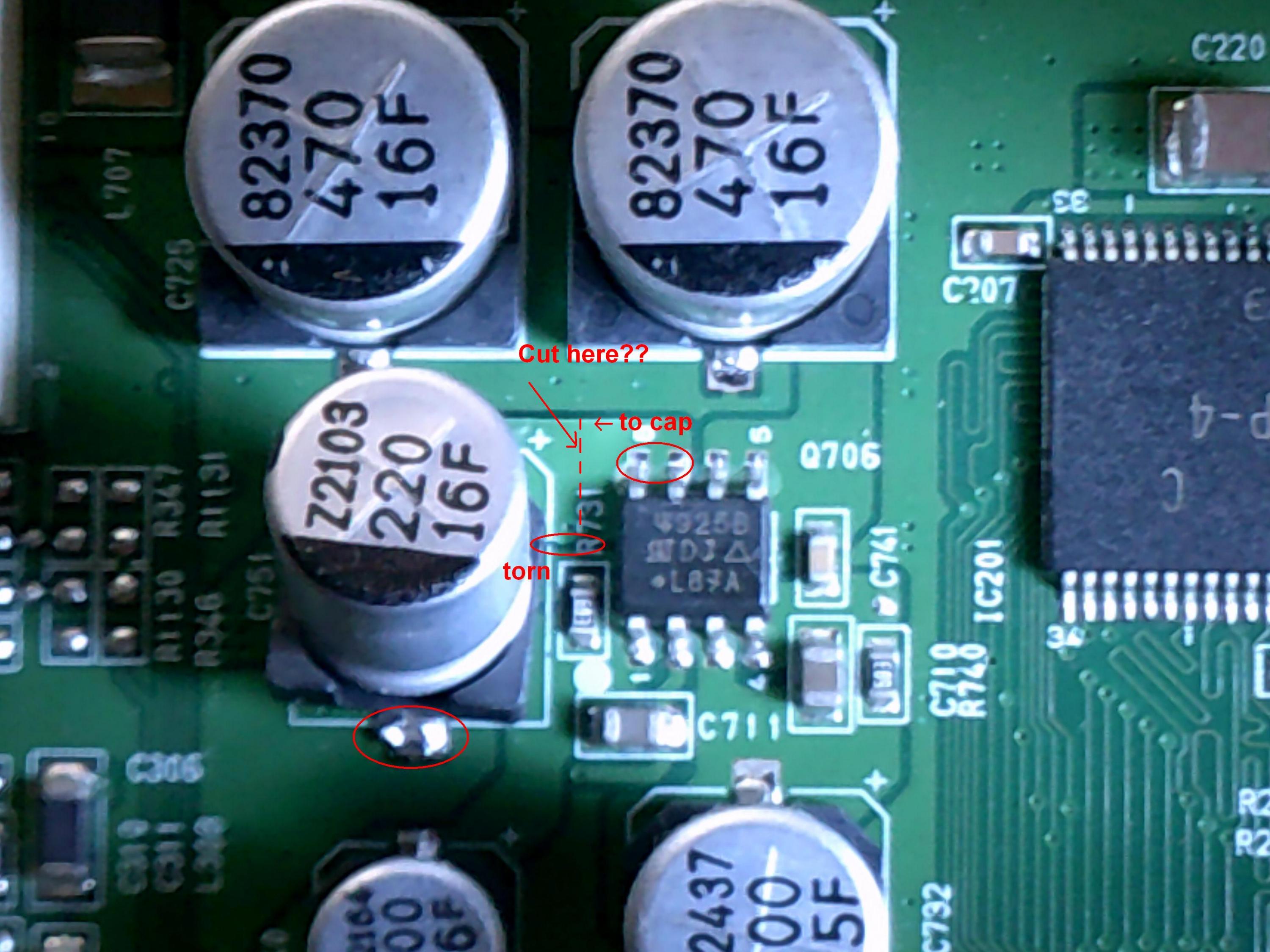

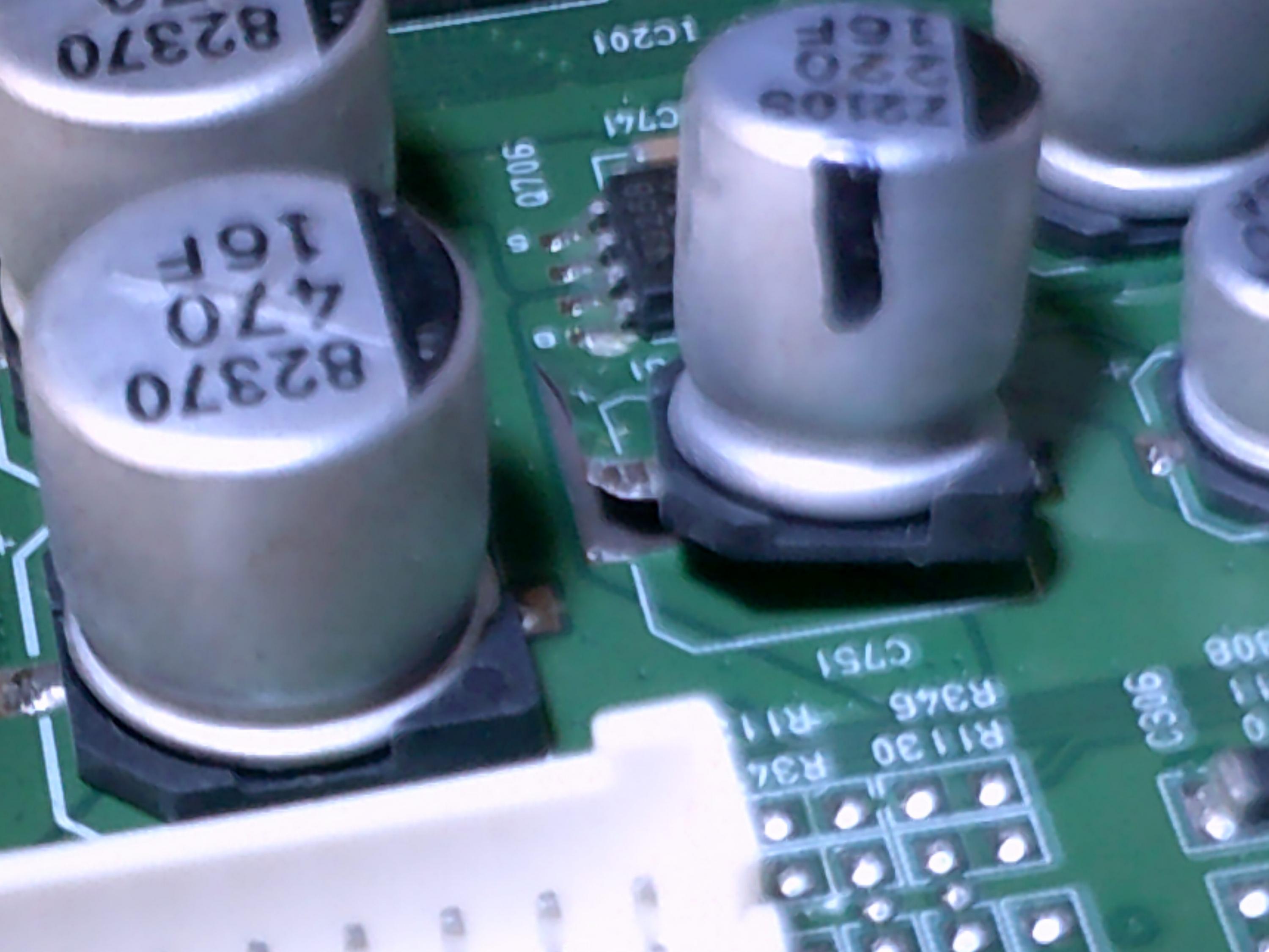

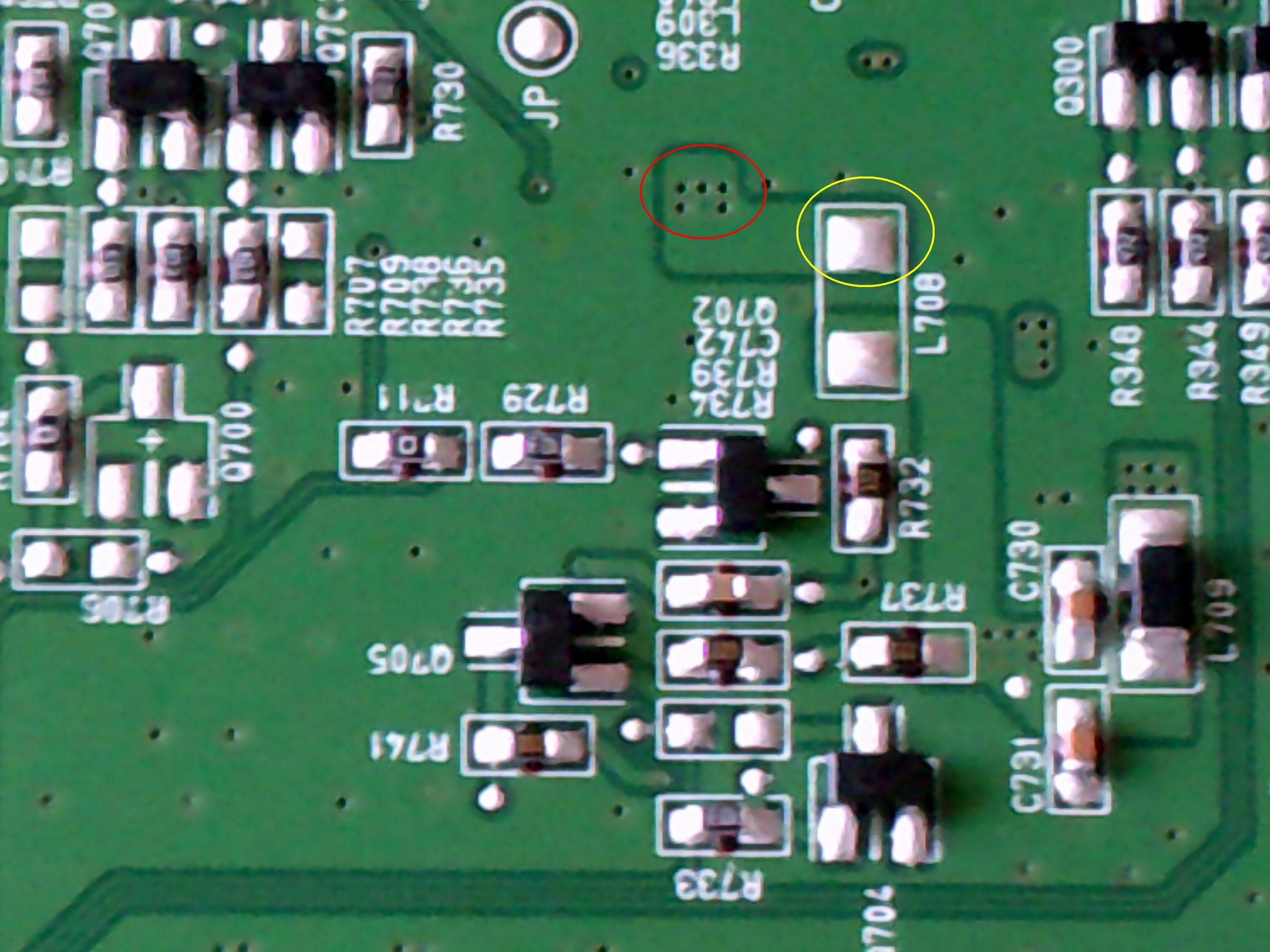

                            I got the main board today and it is defective. The trace under a capacitor for audio is lifted and torn a bit(see pic). When I pushed down on cap sound worked fine.
                            Should I attempt repair or send it back? return shipping I must pay.
                            If I repair it what should I glue trace down with?
                              Re: Lg 37lg30
                              How much was the board?
                              Contact the seller and ask for a partial refund at the very least.
                              You can solder a wire to that nearby component to repair the damage.
                              • ryan74
                                • Oct 2012
                                • 471
                                • usa
                                Re: Lg 37lg30
                                That is what i was thinking. I paid $80.95.
                                If I repair it do you suggest cutting off the lifted trace or just adding a wire on top of it?
                                I plan on useing a wire lead from a good capacitor for wire.
                                I made a few notes on picture.
                                That component surrounded by caps was burnt up on original board. So I have to decide to repair new board trace(easiest and more reliable) or change burnt component on old board and hope it works.

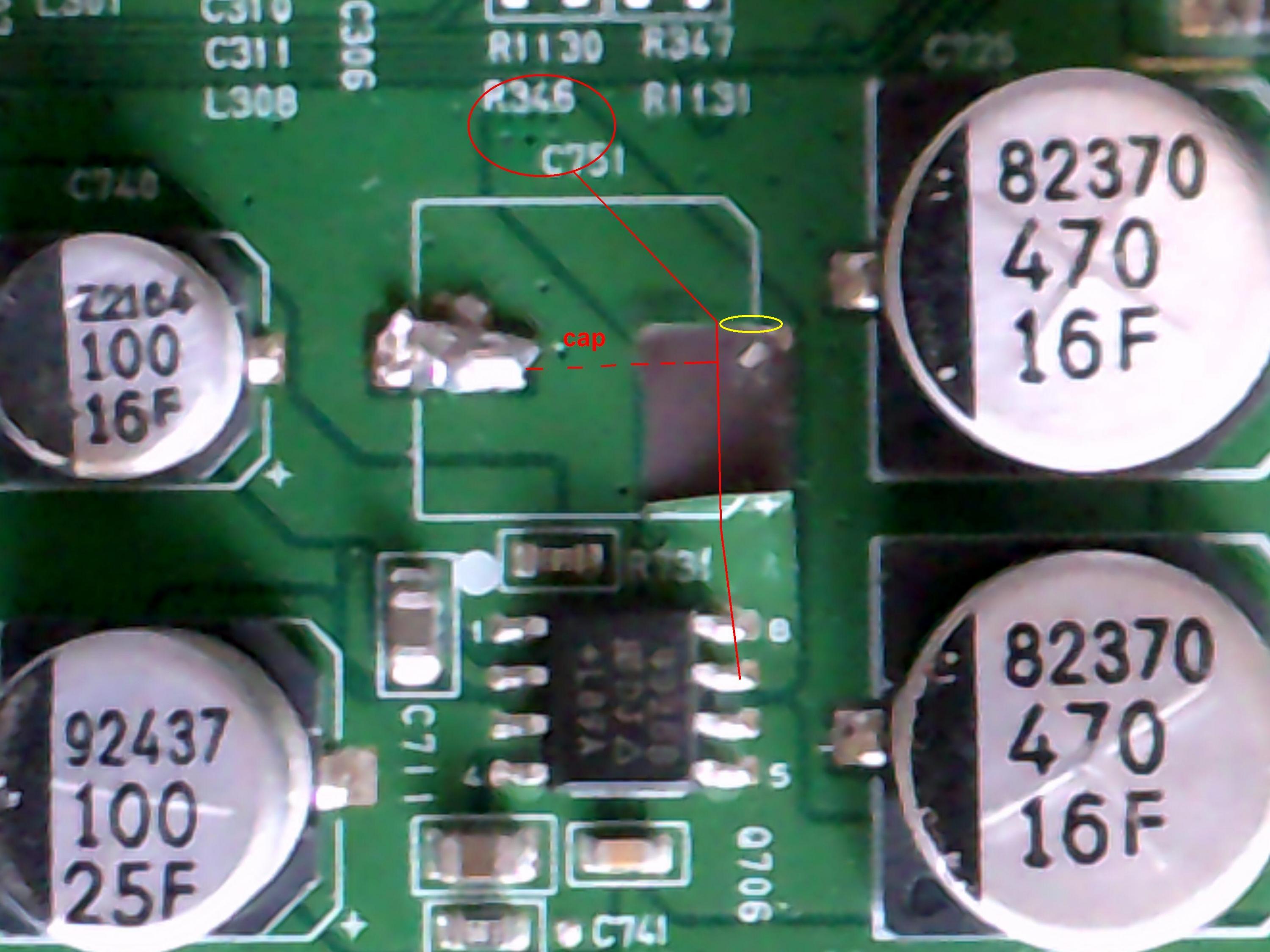

                                • ryan74
                                  • Oct 2012
                                  • 471
                                  • usa
                                  Re: Lg 37lg30
                                  Do I need to repair it like this? see pics.
                                  or
                                  just a short lead to cap?
                                  the circuit continues through those pinholes to other side but it seems to end there.
                                  there is continuity between spots in yellow on pics.
                                    Re: Lg 37lg30
                                    You need to scrape the green soldermask off near the lefthand pin and solder one cap lead there.
                                    Repair the break in the other trace (use similar method) and connect the cap to the join.

                                      Re: Lg 37lg30
                                      I may have a bad solder joint, im not sure.
                                      Audio sounds fine, but it does not go loud.
                                      At full volume it is a little louder than typical listening volume.
                                        Re: Lg 37lg30
                                        ...May just be cheap speakers, most LCD TVs have bad sound, you get used to it.
                                        One TV I had gave loud sound from 0~10 and all the way up to 50 sounded hardly any different!
