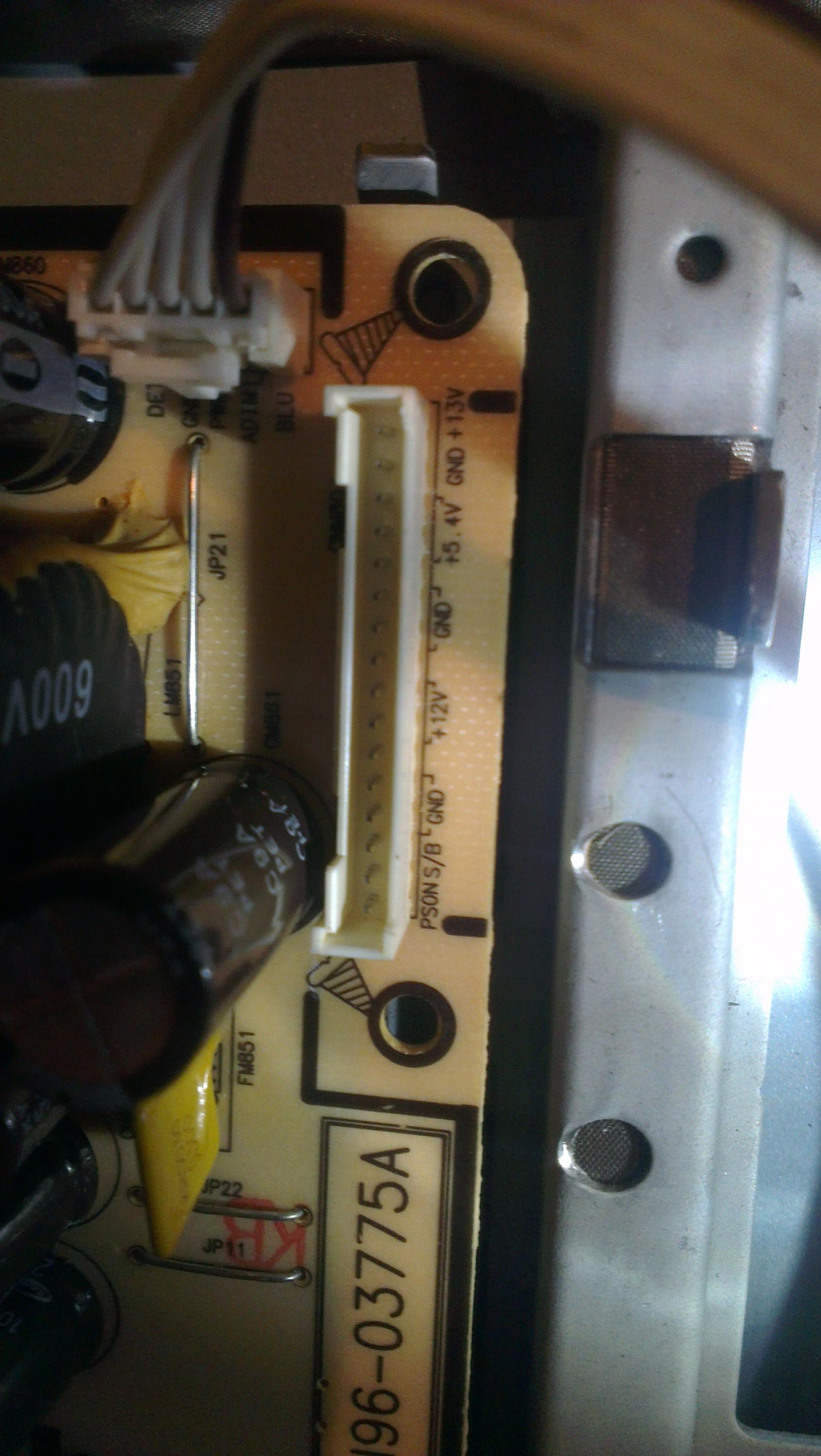

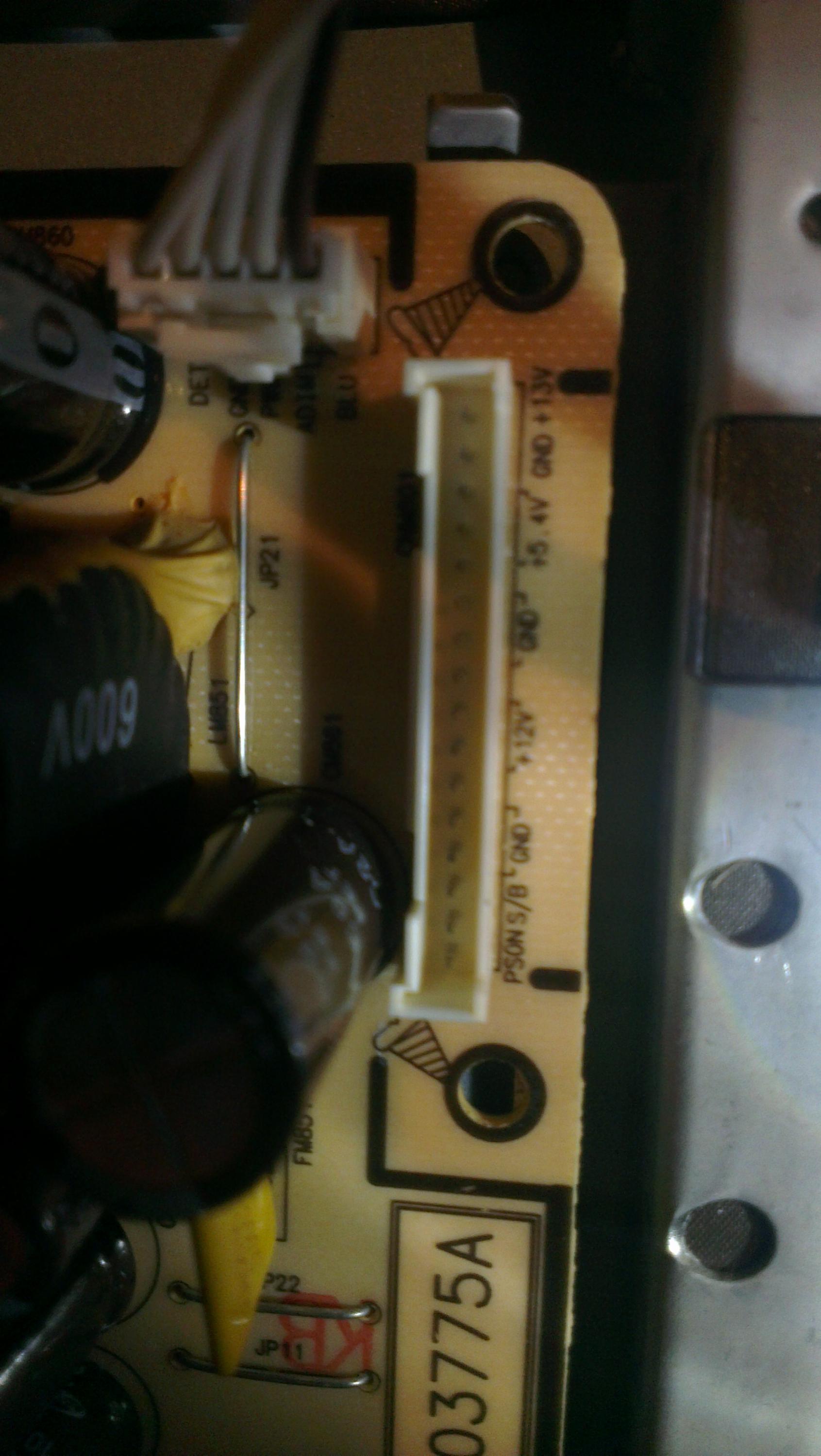

        I've attached a picture of the board for reference. The connector on the top right is the one that leads to the main board (ribbon has been disconnected in pic).
        I'm getting 0.0.41 v on the +13 v pin to ground and 5.85 v on the PSON S/B (the second pin from the bottom) to ground... The 5 and 12 v read zero v.
        Not sure if it is relevant but with no cable connected and listening closely I can hear a very faint and rapid repetitive clicking noise. When the ribbon to the main board is connected again the tone changes.

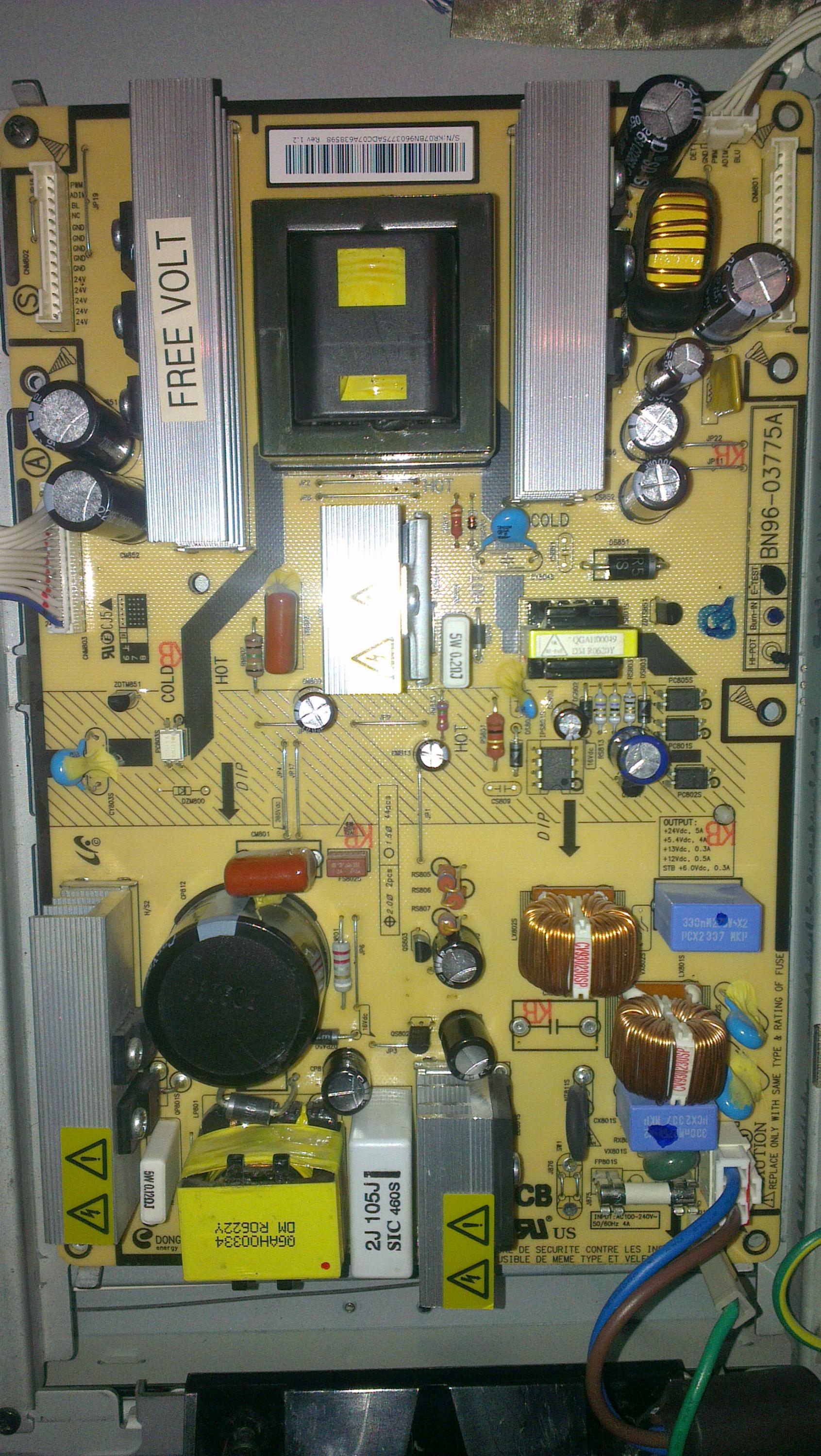

              Disconnect the cable between the power supply and the inverter board to see if the 12/24V will come up to 12v, 24v. I have a feeling you have bad IC (the one in the middle with small heat sink) is bad. Right now the PFC/Voltage booster is OK because you are getting the 380V.

                      The one mouted on the small heatsink at the middle of the board as shown in your picture, please read the link I provided.

                            OK, thanks I'll see what I can find... In your opinion I would be best off just getting a new power supply board and not bother trying to replace the F9222L IC mentioned in the other post?
                              Re: Samsung LE32R72B won't power up
                              You can try checking the DC voltage feeding the IC per schematic to see hwat you are getting at the IC's pins, but since the F9222L seems to be common failure which is more likely.

                                I've ordered an F9222L IC, so I'll see how I get on and report back. Fingers crossed.
                                • Kamikazi
                                  • Mar 2013
                                  • 11
                                  • England
                                  Big thank you to all who helped. Changing the IC worked for me, I'm typing this on my now working tv
