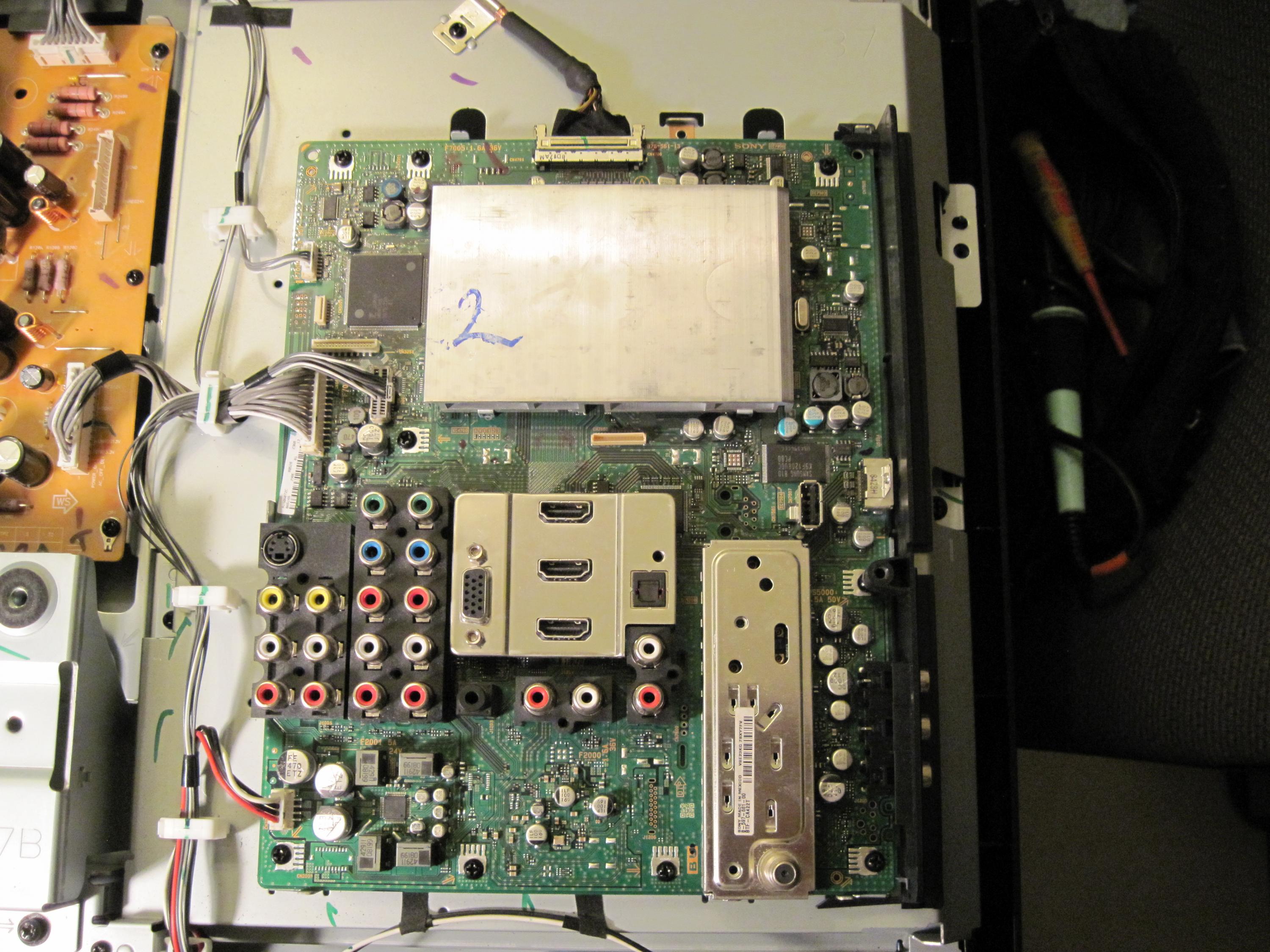

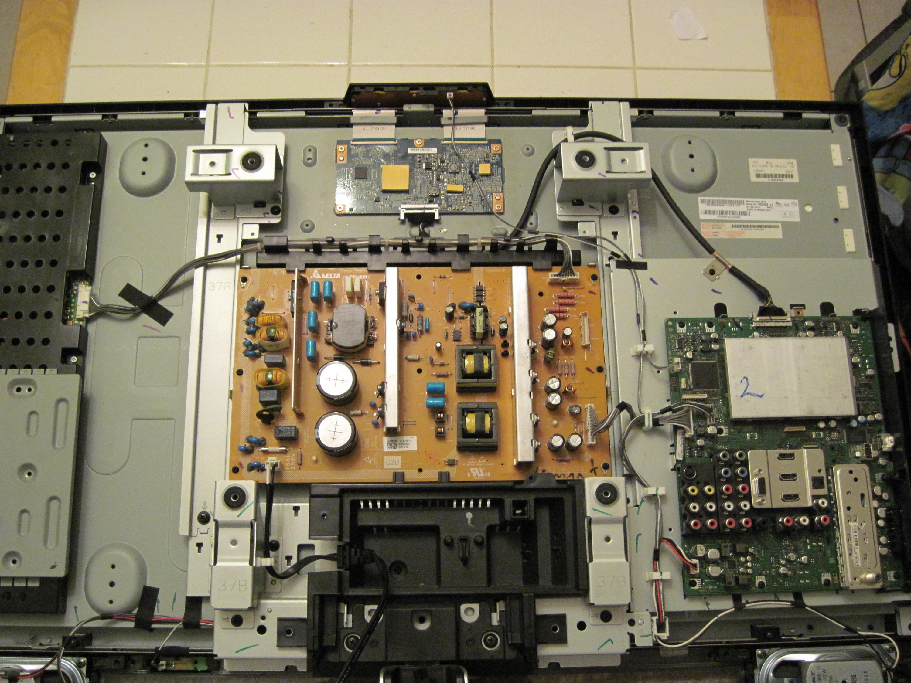

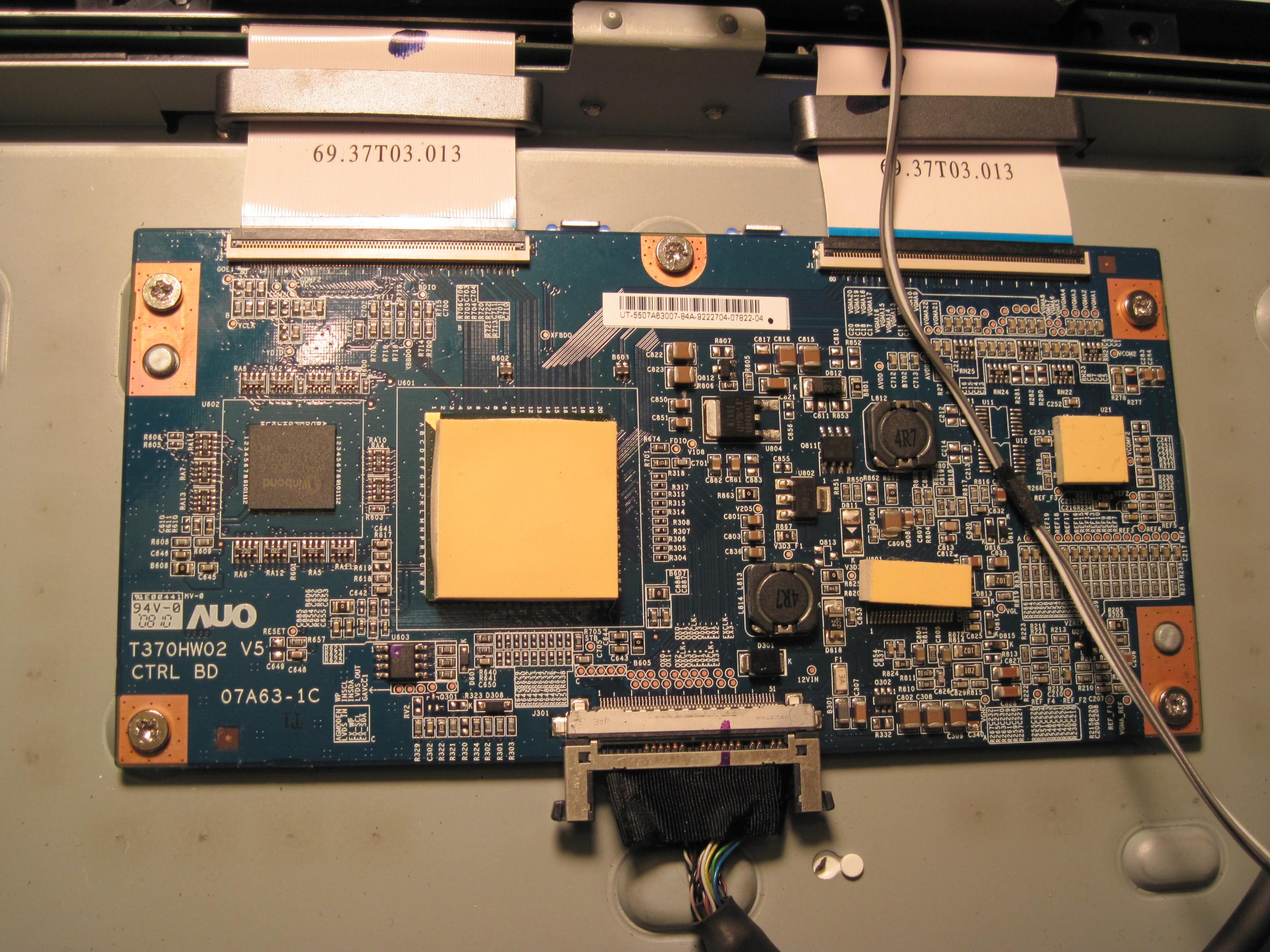

      I have a sony kdl-37xbr6 that Has sound and backlight with no picture. Other than no picture, turns on and off fine.

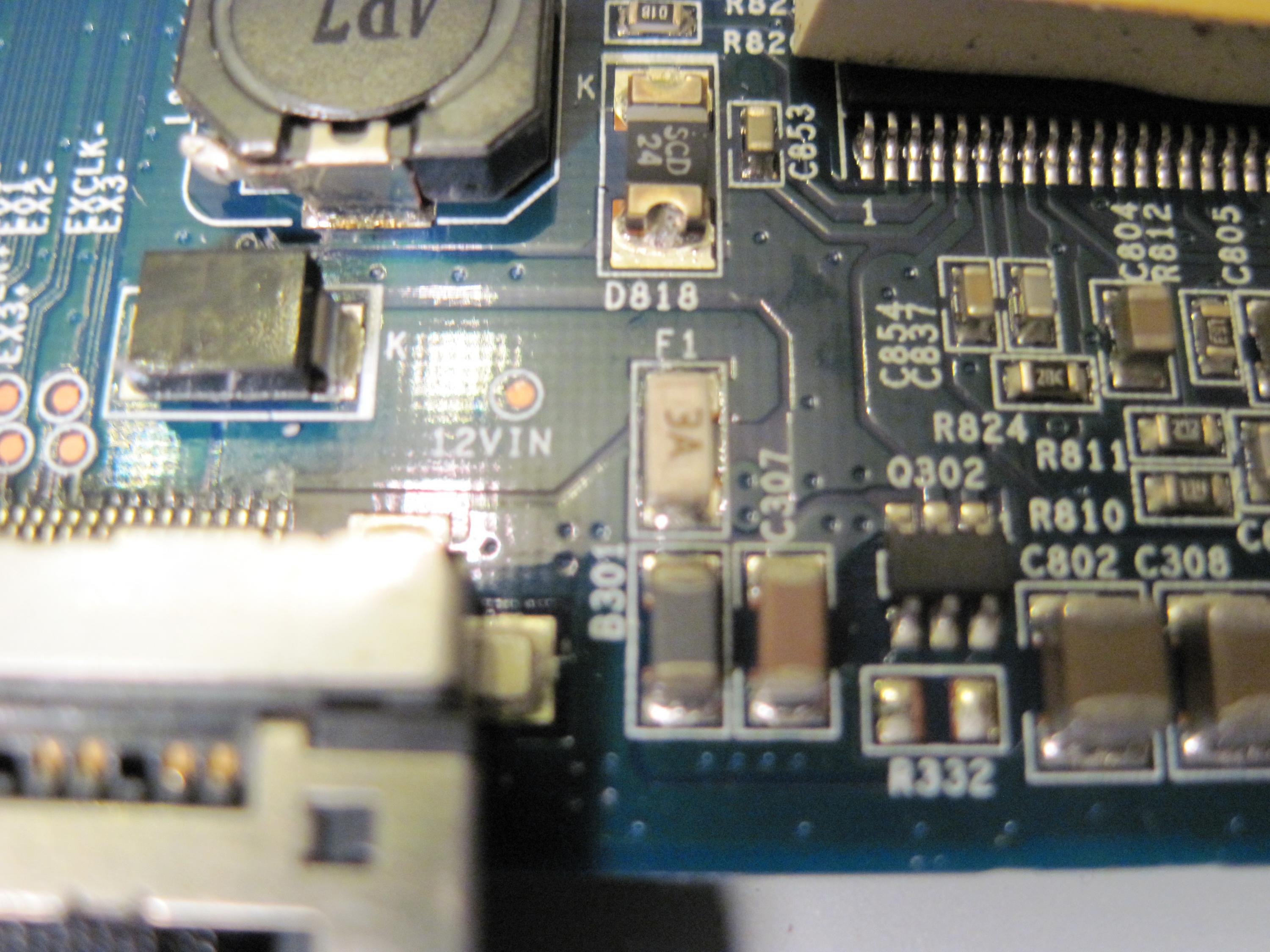

      I checked f1 on the t-con and it has continuity but no power to it on either side.
      I checked through a bunch of forums but could not find one that dealt with the fuse not getting power.
      Not sure where to proceed from here. Any help would be great..
      I have attached pics.. Please let me know if anything else is needed
      thanks
