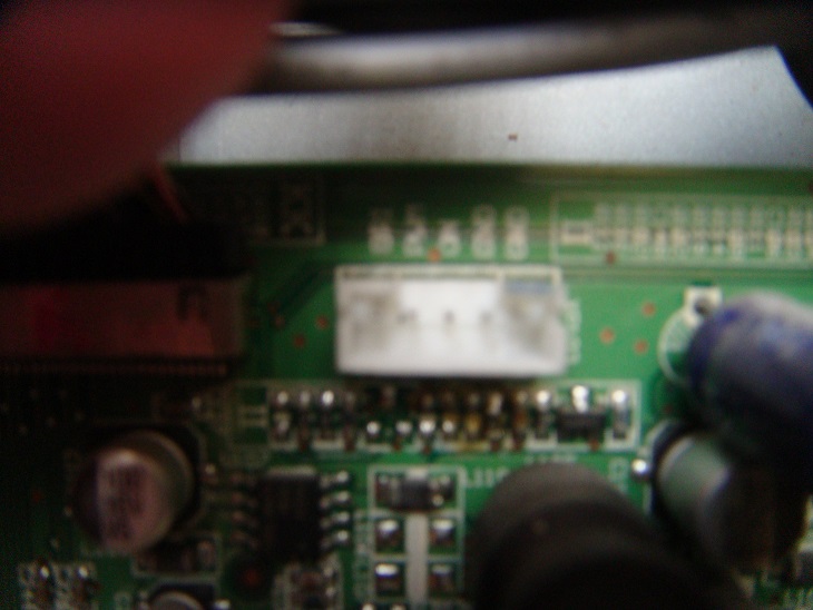

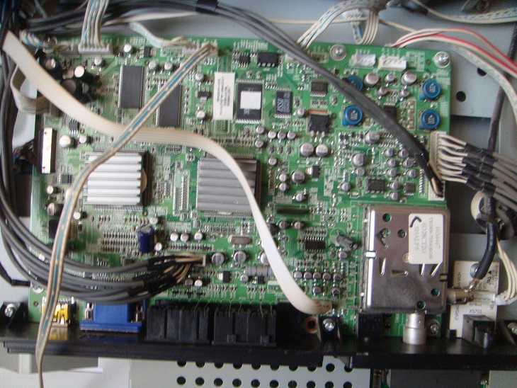

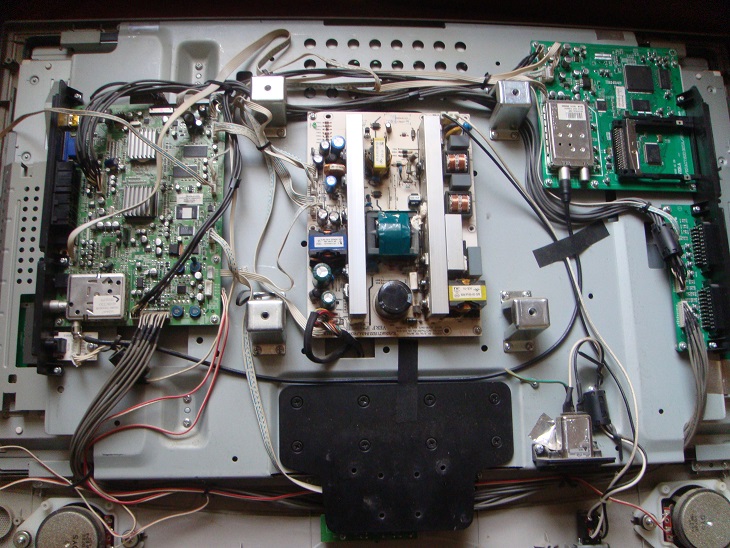

    Hi guys not seen or heard of these before! Hisense LHD3206EU,
    It's stuck in standby, I suspect the main board as I bridged the 3.3v from the standby plug to the p-on which started the psu bringing up all the voltages but set still dead
    Any input welcome, trouble is not been able to find any boards for sale anywhere?
    main board has lots of plugs, tried to picture them all!
    thanks Ronnie

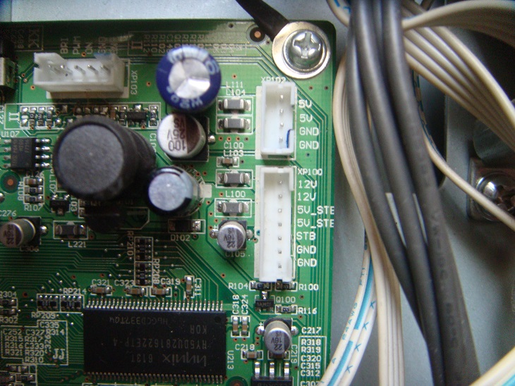

    on the connector xp100 are you getting a permanent 5v on the pins marked 5vSTB ? while the tv is just plugged in.
        Hi Tom, yes good 5volts there

          Tom only one regulator showing voltage, think it's feeding 3.3v to standby led?
          Thanks Ronnie
          sigpic
            Re: Hisense 32 lcd stuck in standby!
            List all three pin voltages and the part code.
