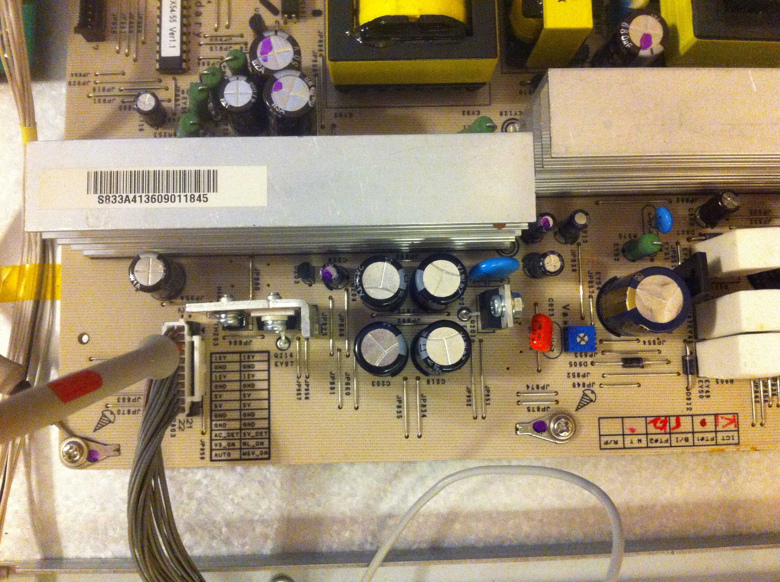

    I jumped before measuring 12 and 16V... M5V doesn't seem to change upon heating of main board..
      #42
      Re: 50pg20 Power Cycling When Power Applied
      Power board should be heated not main board sorry for not being clear.
        12V and 16V is cycling on and off but seem OK , 12.2V and 16.3V... (with warm Control/Main board)
          Oh OK... I actually just tried heating up Power supply board near 5V regulator.. Still Cycling..
            There is a smaller power resistor (.150 at 5W) on the top side of the board I didn't check.. only the three that you mentioned the other day..
              I think M5V is the main issue. If all the heating up does not work the startup cap for the 5V may need replacing.
                I did replace the four 3300uf caps and one 680uf cap on this board the other day... near this voltage regulator circuit... There is a 470uf, 25V near this connector I DID NOT replace...
                  Startup cap is on the primary side.
                    Replace four caps in middle of picture (3300uf) and one to right hand side (680uf)... NOT the one on left side (470uf).
                      I will have to pull the board out and look at the traces (NO Schematic) to find primary side of regulator at cap... I know its @19V coming in and 5V coming out..
                        You're looking for a 10~100uF cap on primary.
                            I replaced the 10uf , 63 volt cap on the primary side of an adjustable high accuracy voltage regulator on this plasma. The cycling problem still continued. I went through the 5 volt standby circuit and when I ohm out the input (19v) side of this regulator (a KA431) when its on, the main board goes into standby and the TV then turns on with the main power switch.. I have to order this regulator from China, very inexpensive.... Is it possible that there is a capacitor in this circuit that is causing this voltage regulator not to bleed down when its turned off? Also, the output of this regulator is only 2.4 volts.. Its data sheet says that it's capable of regulating between 2.5 and 63 volts... could this be the problem because the voltage is lower? Thanks...
                              That is part of the feedback path... 2.4V is a little low (should be 2.495V or so) but probably OK. I would be considering any other startup caps. Shorting that reg is not a good idea, the PSU loses feedback control, so 5V standby will rise to excessive levels and could cause damage.
