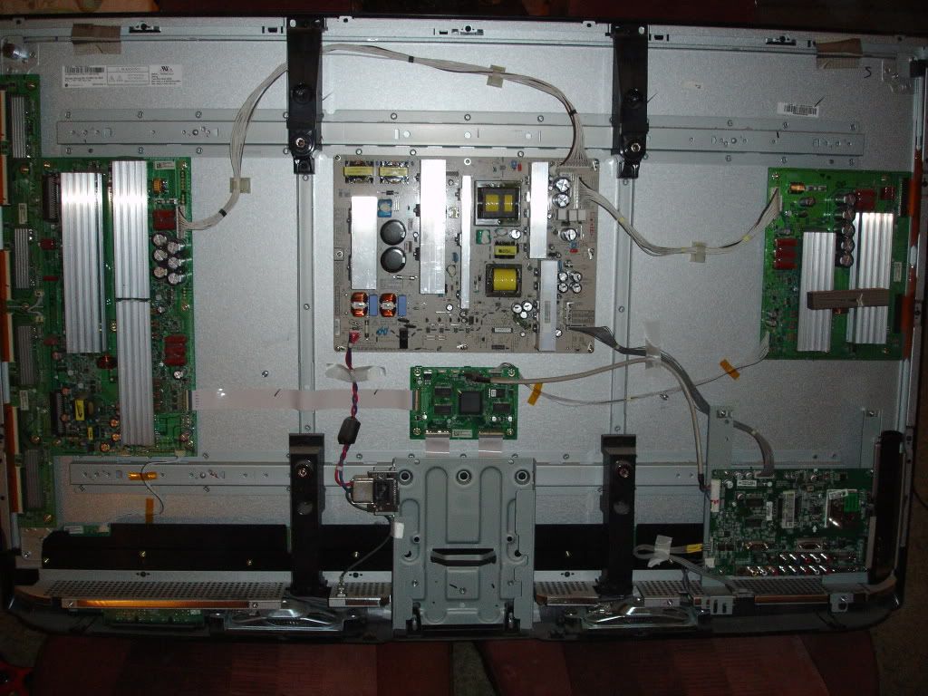

    Check Vs/Va on PSU. If you need help, post pictures of the chassis.
    Very common issue on the PSU of this LG is a failed power resistor.

        Having a tough time trying to figure out how to post pictures....
          Re: 50pg20 Power Cycling When Power Applied
          Exactly like this one on another post:
          http://i469.photobucket.com/albums/r...b/DSC01980.jpg
            Use the "Manage Attachments" feature, it's below the post window.

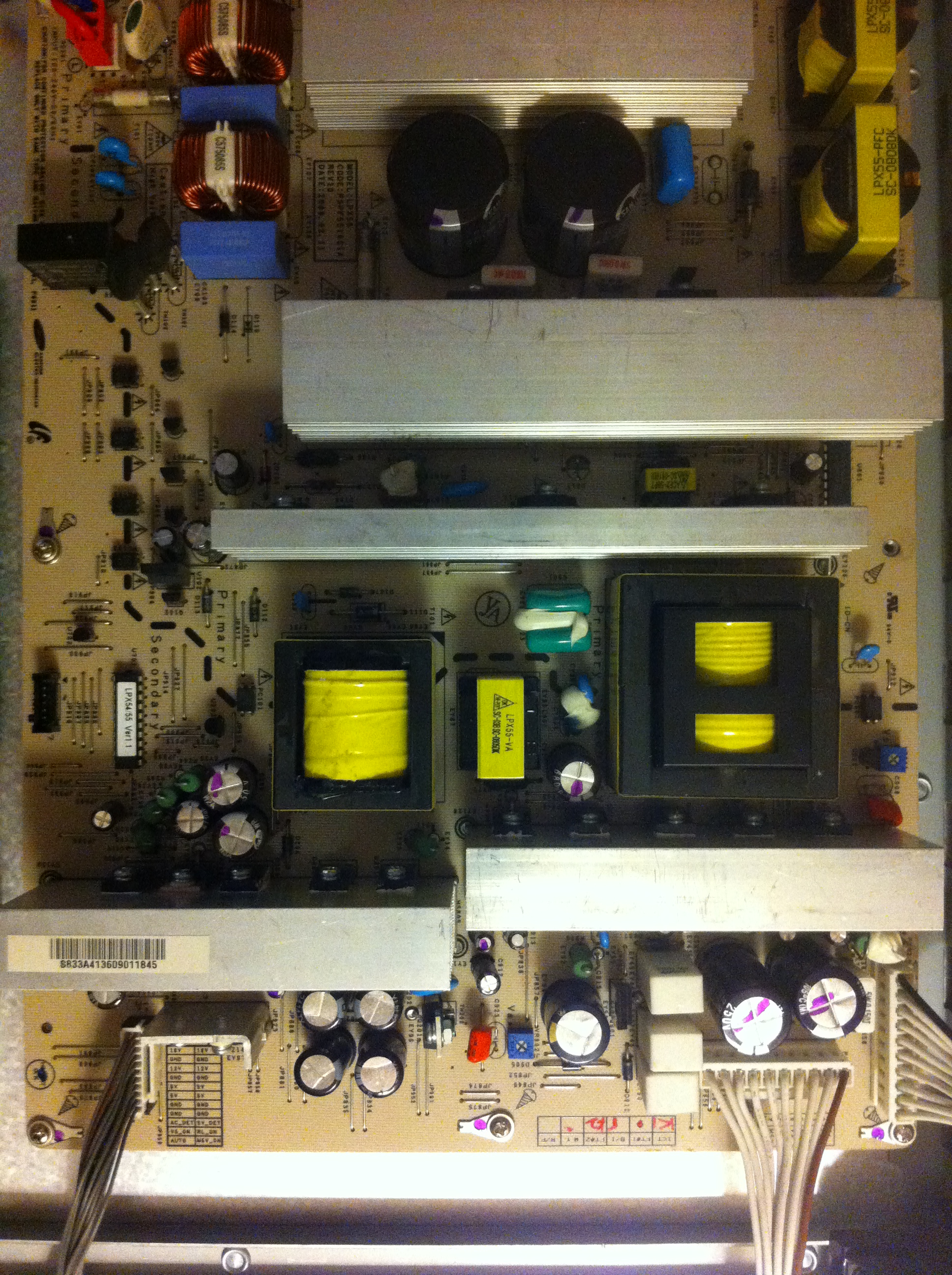

              Not the best resolution.... Where would this power resistor be located? secondary on power supply?
                Those three white cuboids, top right of PSU.

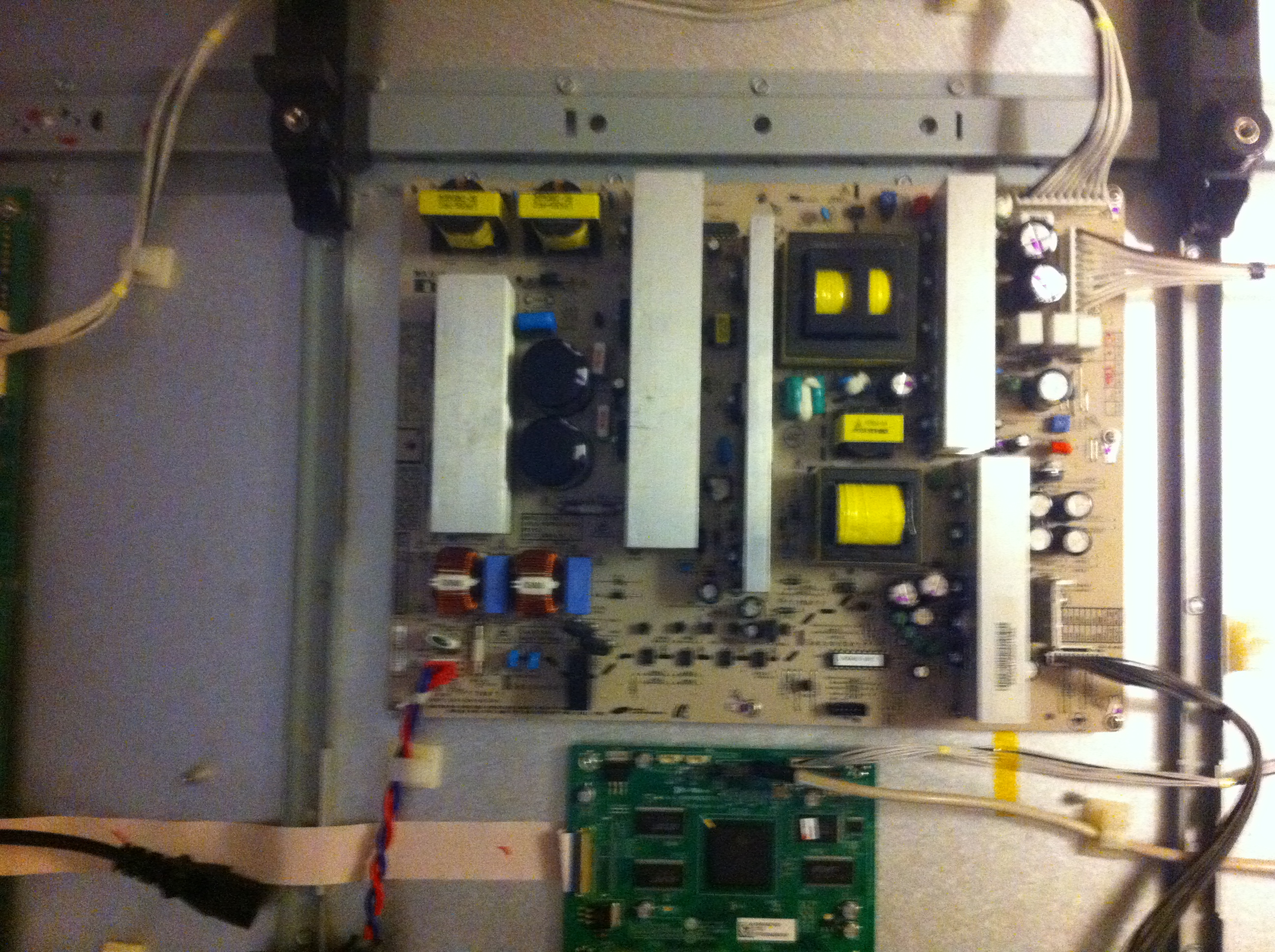

                  Better one of power supply...
                    Is there a way of verifying the values of these resistors? Simple ohms check?
                      Yep, read the value on them & check in circuit.
                        In circuit I'm getting 10.25, 10.07, and 10.47 ohms on these three resistors..

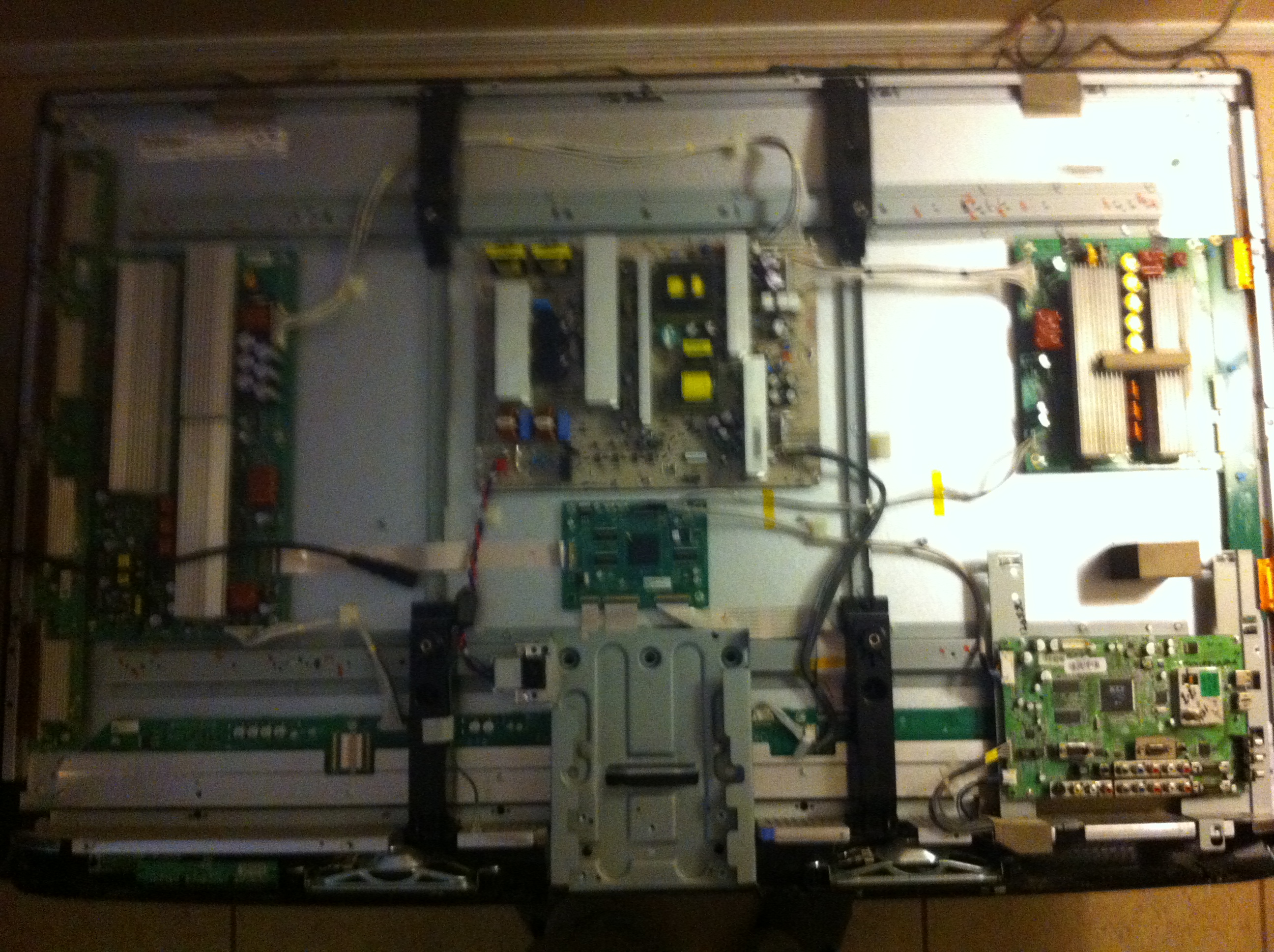

                          I don't think the problem is caused by connection of the Ysus or Zsus boards... Problem occurs when the Finger main input board (AV Inputs board) is connected.. Tried another board with same results.. Could not find short on either of them..
                            OK, do you see a point marked EXT AUTO GEN on the control / logic board?
                            The control board is the board connected to the main board, Y-sus and Z-sus, and it's green.
