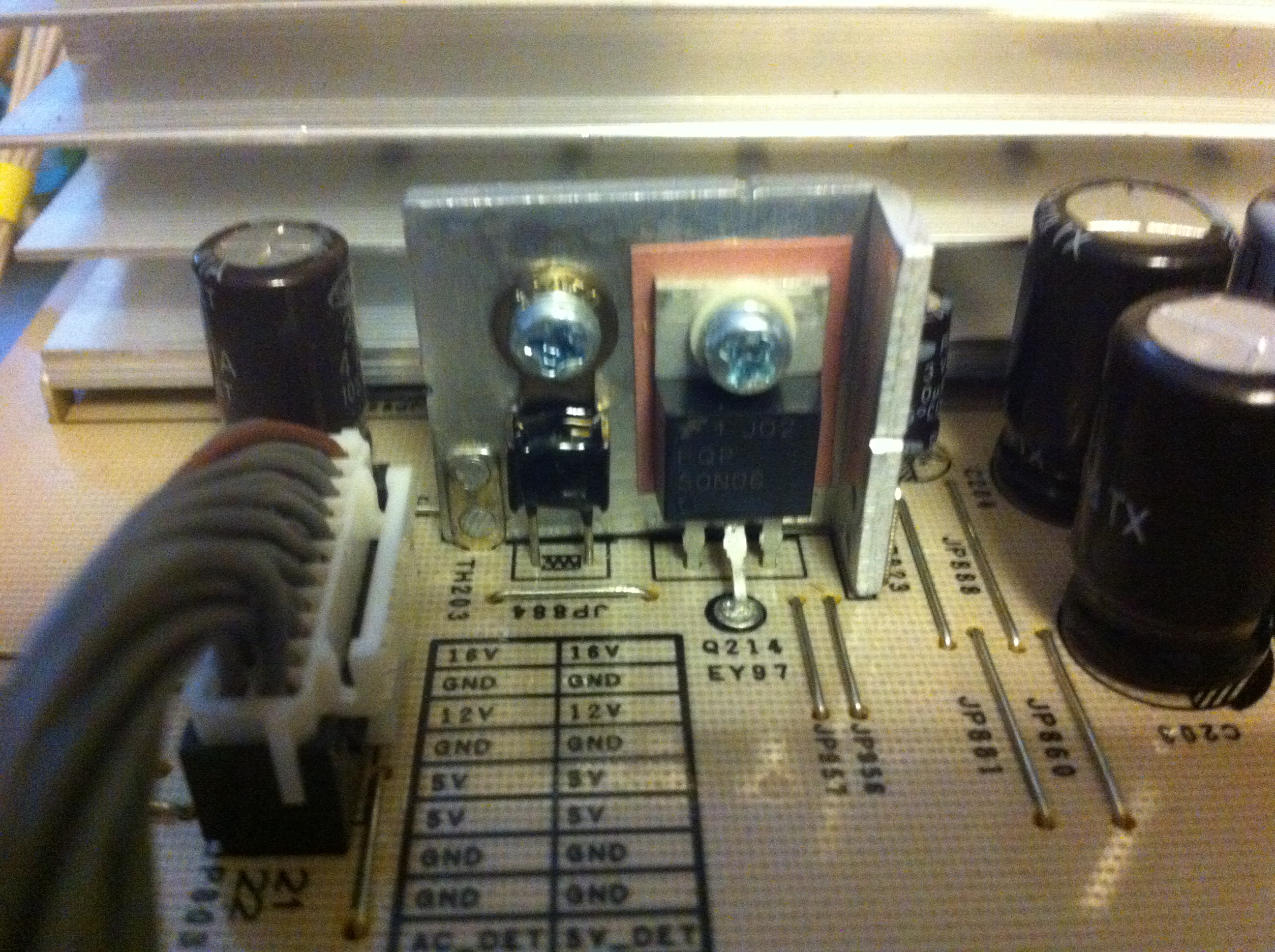

          Sorry about the delay.. Yes I did change out the Zsus board... if I unplug it the TV still cycles on the relay... Would you happen to know what the component labeled TH203 next to the 5v voltage regulator is? One side is 5V the other very low (@10 mv)... Thanks!
            Re: 50pg20 Power Cycling When Power Applied
            Can I have a pic of TH203? It sounds like a thermistor.
            • Vladas
              • Dec 2012
              • 41
              To the left of the 5V voltage regulator on heat sink...
                Interesting -- looks like a temperature sensor. I don't know what that is doing there, other than just measuring overall ambient temperature of the set.
                • Vladas
                  • Dec 2012
                  • 41
                  OK, there is three LED's I believe that indicate system temperature... It could be measuring this temperature from next to this regulator.. Interesting though , when I tried to measure resistance across it, it did a high pitch scream and arc'd slightly..
                    #29
                    OR... perhaps... it may be thermal compensation for the diode to avoid failure from hot spot localised heating... potentially.
