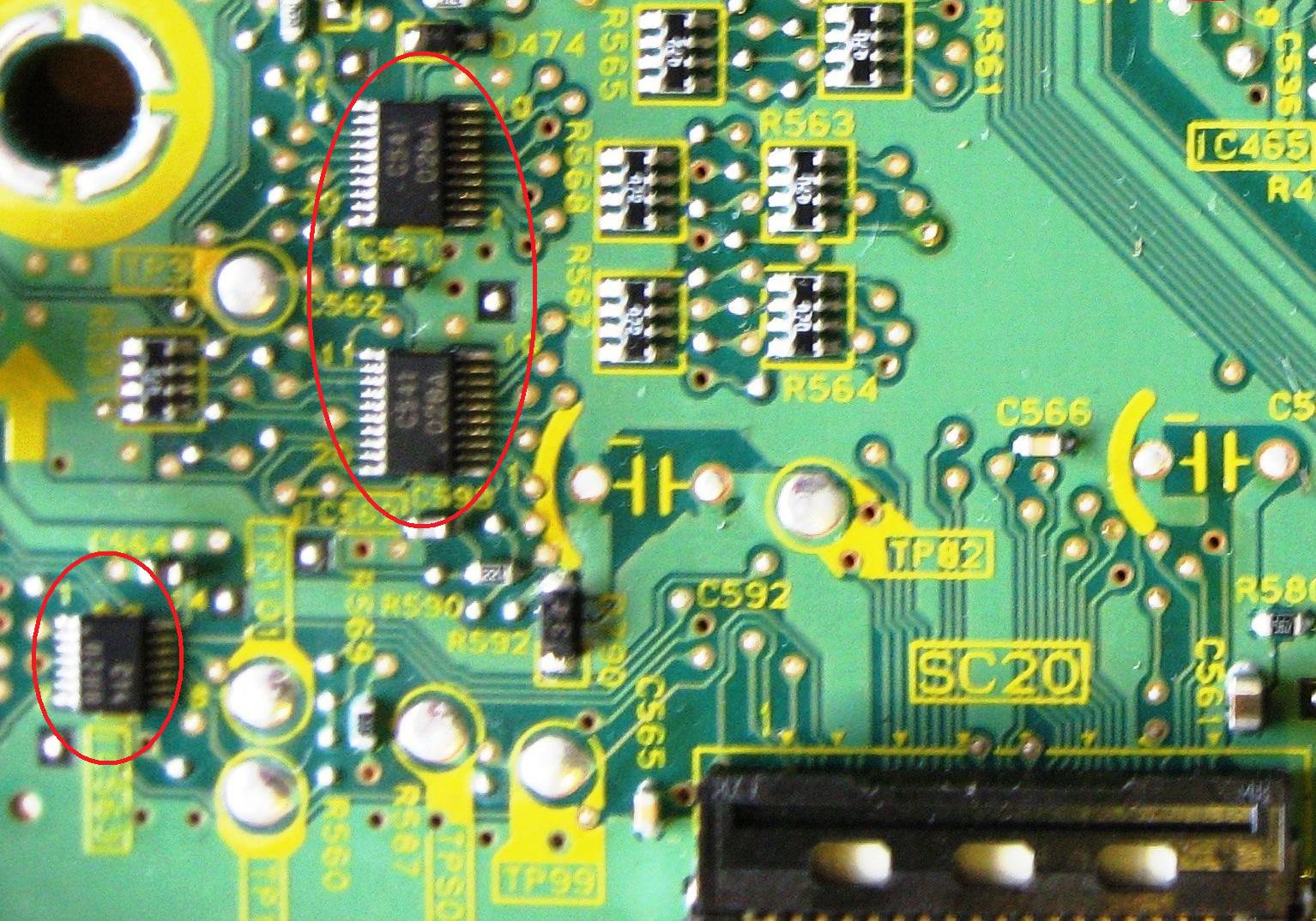

                                      last board is troublesome. This was the prototype which was powered with shorted q701 q702.
                                      Had 2 attempts and q661 fails on panel on. Anyway discovered P5V line in to gnd only had 360ohms.
                                      Take a bit to find but one of the octal buffer iC marked C741 has failed and had 380ohm on its Vcc-gnd.(removed)
                                      Also NEC opto PS9856-2-F3-AX is bad and no info on that one yet.
                                      Hi everyone, I'm new here on the forum
                                      I'm trying to repair the SC board, replaced all shorted components, but Q661 failed again on power up. I'm having hard time finding that C741 you mentioned, can you pin point it for me? It is on SC board right? I powered the set with buffers connected, but buffer boards seem fine, there are no shorts on them. Another thing, I did not change IC 501 as it seemed OK. I just changed another M81737fp as it had short between pins 7 and 8. Other than that I would not know how to determine if IC is bad. So maybe that another
                                      M81737fp caused Q661 to go?
                                      Thanks in advance

                                        Sorry to hear your repair failed. Did you repair it and then found this post or have you gone through my list of parts replaced and then had no joy?
                                        One of the problems is that not all boards fail exactly the same and the jury is still out on my last board although i have found a number of items missed and I am chasing my tail a little because once the SC board stops shorting the VS the TV will apply power and new items are being damaged.
                                        That's the same transistor giving me grief so you may be unlucky and have more difficult repair on your hands. I've still got parts in transit so I can have another crack at it, that way I feel this post will be more complete for what parts to check.
                                        C541 is the marking on one of 2 octal buffers located left of the SC20 connector. IC561,562,563 all feed off the 5V in.
                                        Can I suggest you list in a logical manner every item you found suspect, it's condition and what's been replaced and with what part#
                                        Saying you replaced all shorted components is too broad a statement. I thought I had too but if that were the case it would be working.
                                        Also any measurements/resistances taken and where.
                                        I have good boards here to pick from so if you list any check points you want resistances or continuity checked for comparison , list them and I'll do my best to post that info.
                                        I think the important thing here is to take your time working through the cct before powering up again.
                                        The timezones don't help.
                                        Post as many photos as you like especially anything that shows me enough detail of parts replaced, markings etc. Visually there was nothing obvious to to see fault wise but spotting a blown smd resistor that's 1mm I found hard, hopefully you have a magnifier too.

                                          Another tip, until you get it going properly, I would not risk the buffers just in case there's a chance the SC damages them when it blows. I would re-check them for piece of mind.
                                          None of my buffer boards were hooked up until I proved my repaired boards good which is straight forward.
                                          SC50 is a factory test connector which allows the SC to powerup fully without a SOS trigger due to disconnected buffers.
                                          Simply short those 2 pins together which ever way you can(small alligator clip should do it) and if the Tv completes its startup and no blinks, it's good to go.
