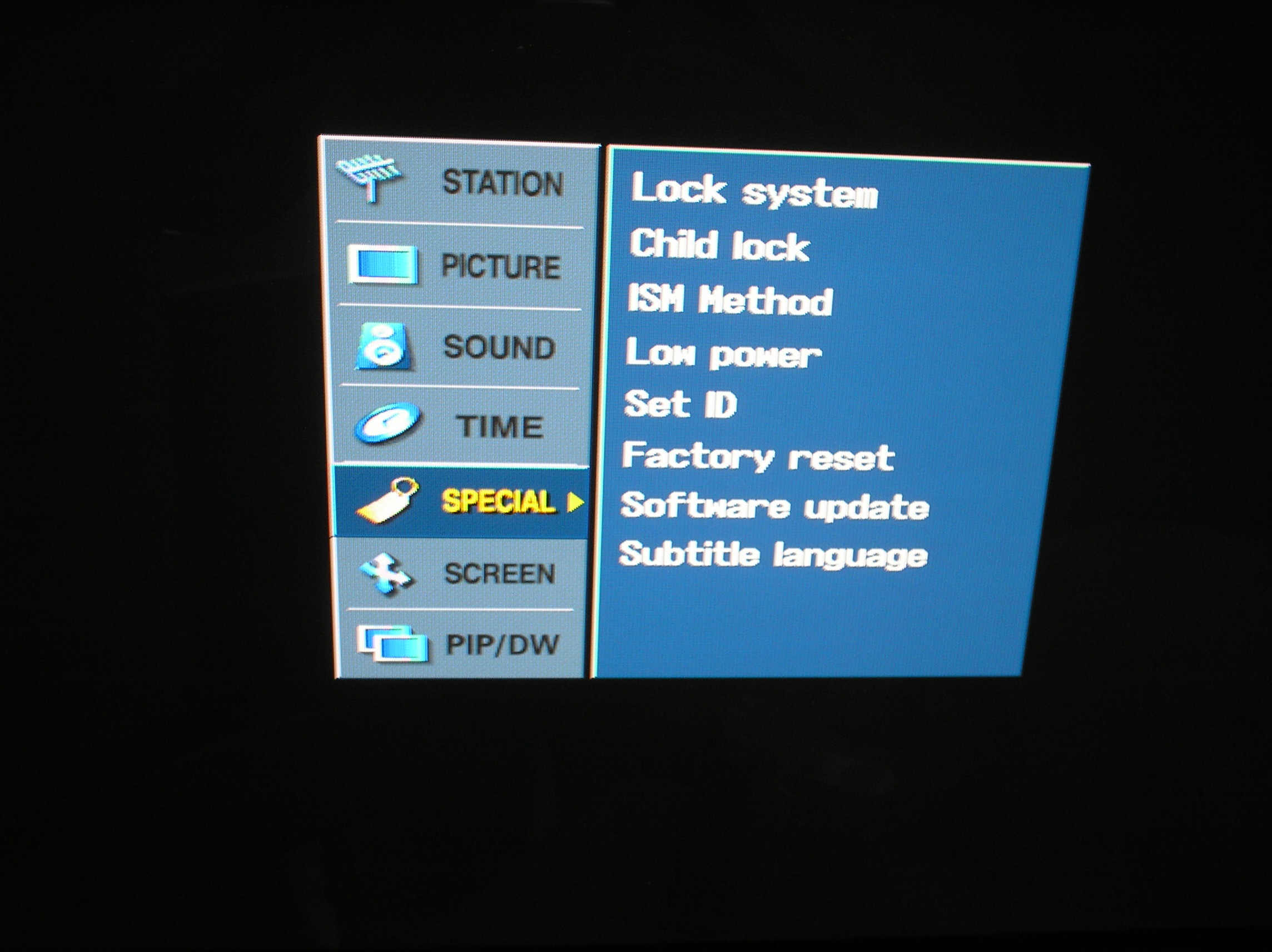

      did have the same thing with the other power board had to drop the Vs to 170v to get a cleaner video that is why i thought it was not giving out enough wattage, and why i rebuilt the old board, would a bad control board do this if you lift the Vs it looks like an LCD with a bad T-con
        #43
        Re: LG42PC1D power board swap
        Have started from scratch with the set up again, have set
        Vs 186v
        Va 60v
        -Vy -200v this was where i went wrong yesterday if you reverse the meter leads it reads 193v or -200v when across the resistor
        Vsc 120v read 120v across the cap either way
        Vz bias 100v all voltage taken with white screen and no av input

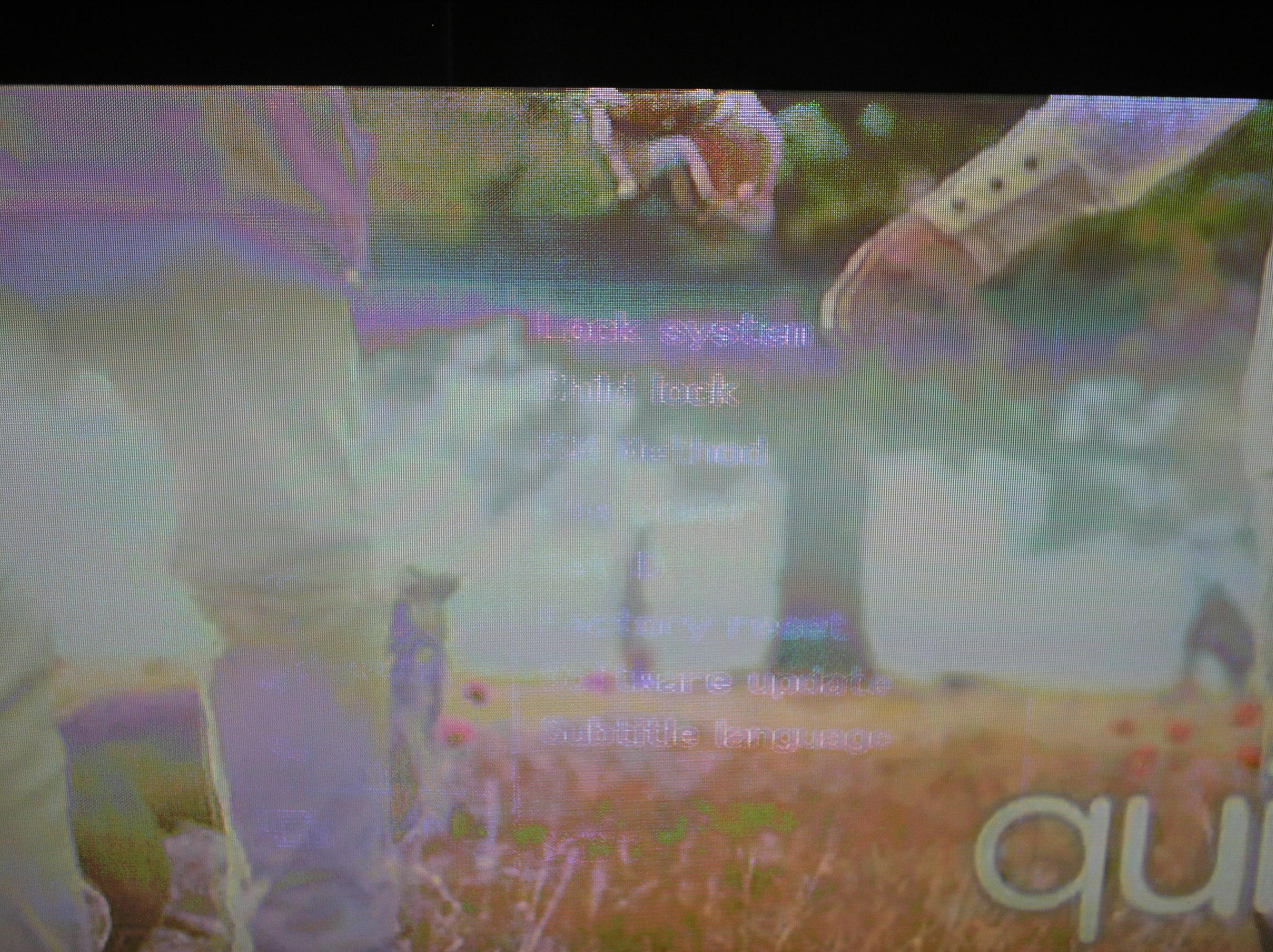

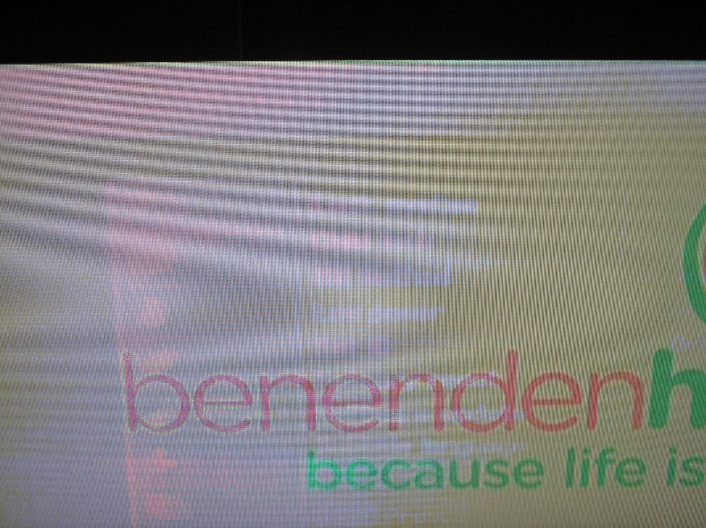

        with the screen showing menu or the poor signal jumping around looks good, as soon as i put some video input in to it thats when it goes bad,you can still see the menu in the background, could this be a main board problem.
          #44
          You have severe image retention (IR); this is usually -Vy, Vsc or the SETUP/SETDN/RAMPUP pots.

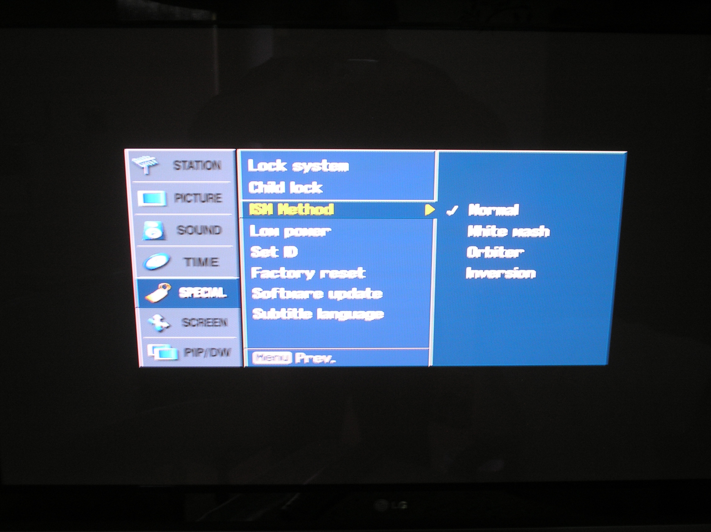

              just checked -Vy and set it again to -200v on white screen when you turn this off the -Vy jump to 239v does that sound right,in ism method i have been trying to trim in setup/ set down pots by jumping from normal/ white/ orbiter and inversion,i seem to get one looking ok then the next looks bad, do not seem to be able to get a good setting to cover them all
              In ISM the readings for =Vy
              Normal 239V
              White 200v
              Orbiter 239v
              Inversion 200v
