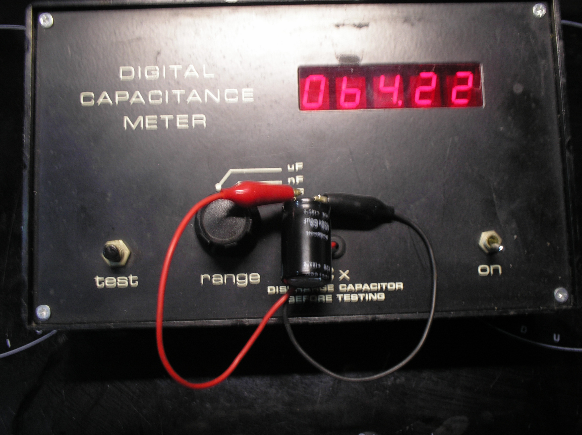

          Re: LG42PC1D power board swap
          well i pulled the cap and tested 64.2uF so not bad, maybe i have put a bad one in when i replaced them? still am thinking that the Vs on is were the problem is as it does not come up till the relay drops out

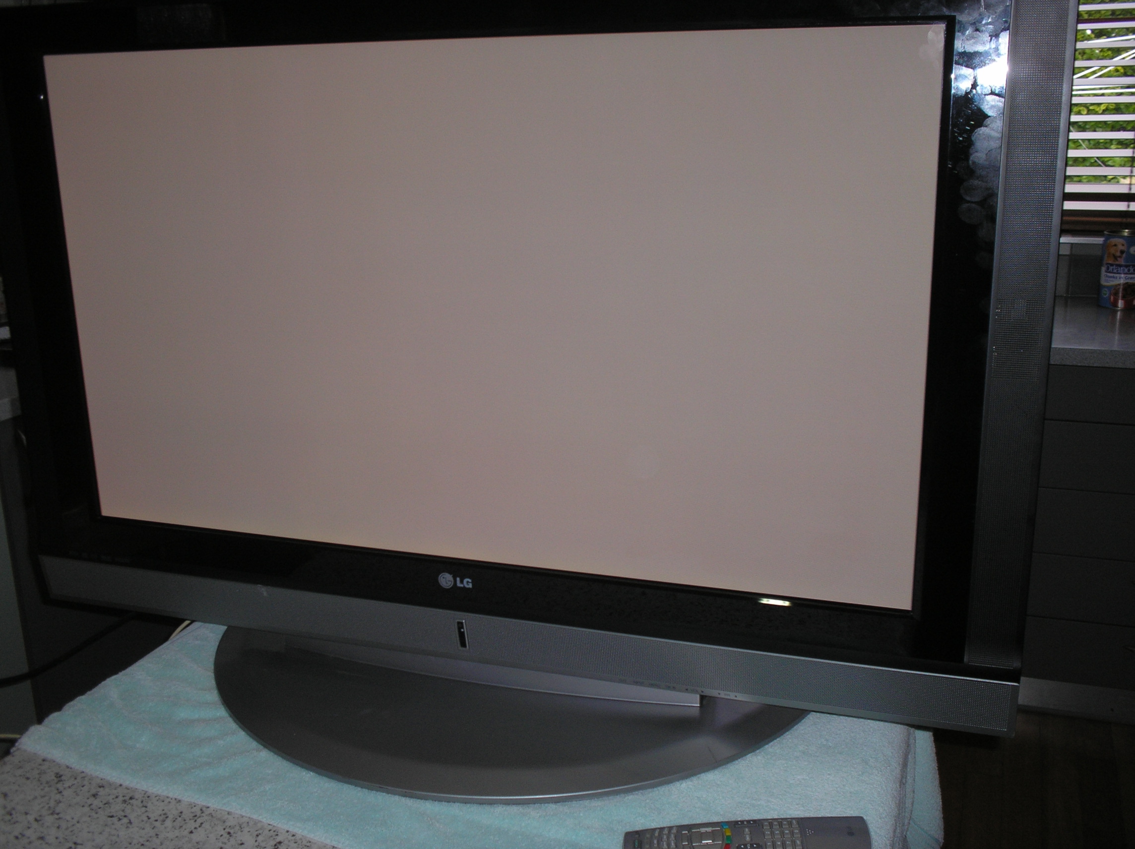

                    when on full white it seems a little pink and when back on video thats when it flickers and the colours flash.
                      #30
                      If it's pink tinged then Vs is probably a little low.

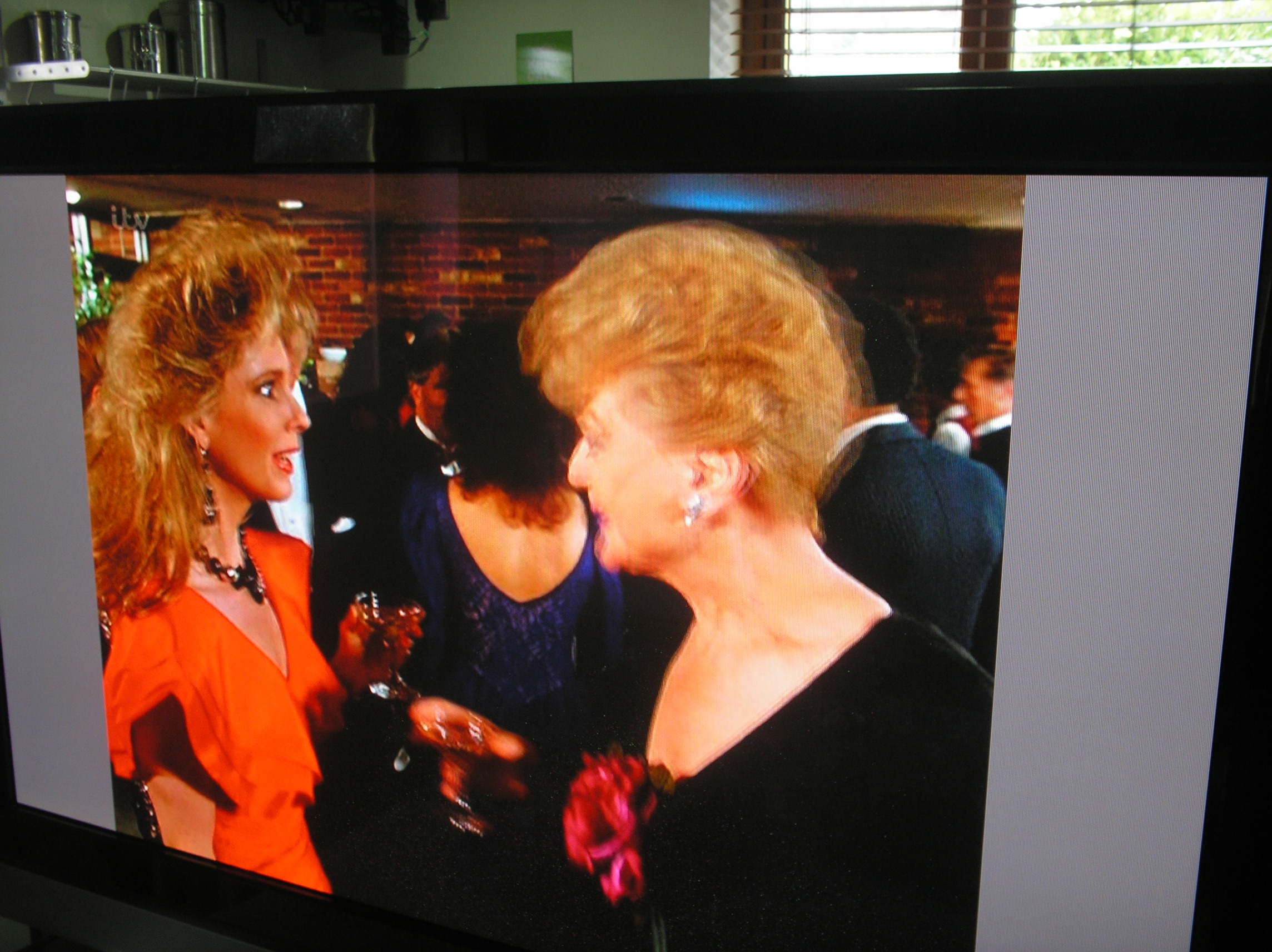

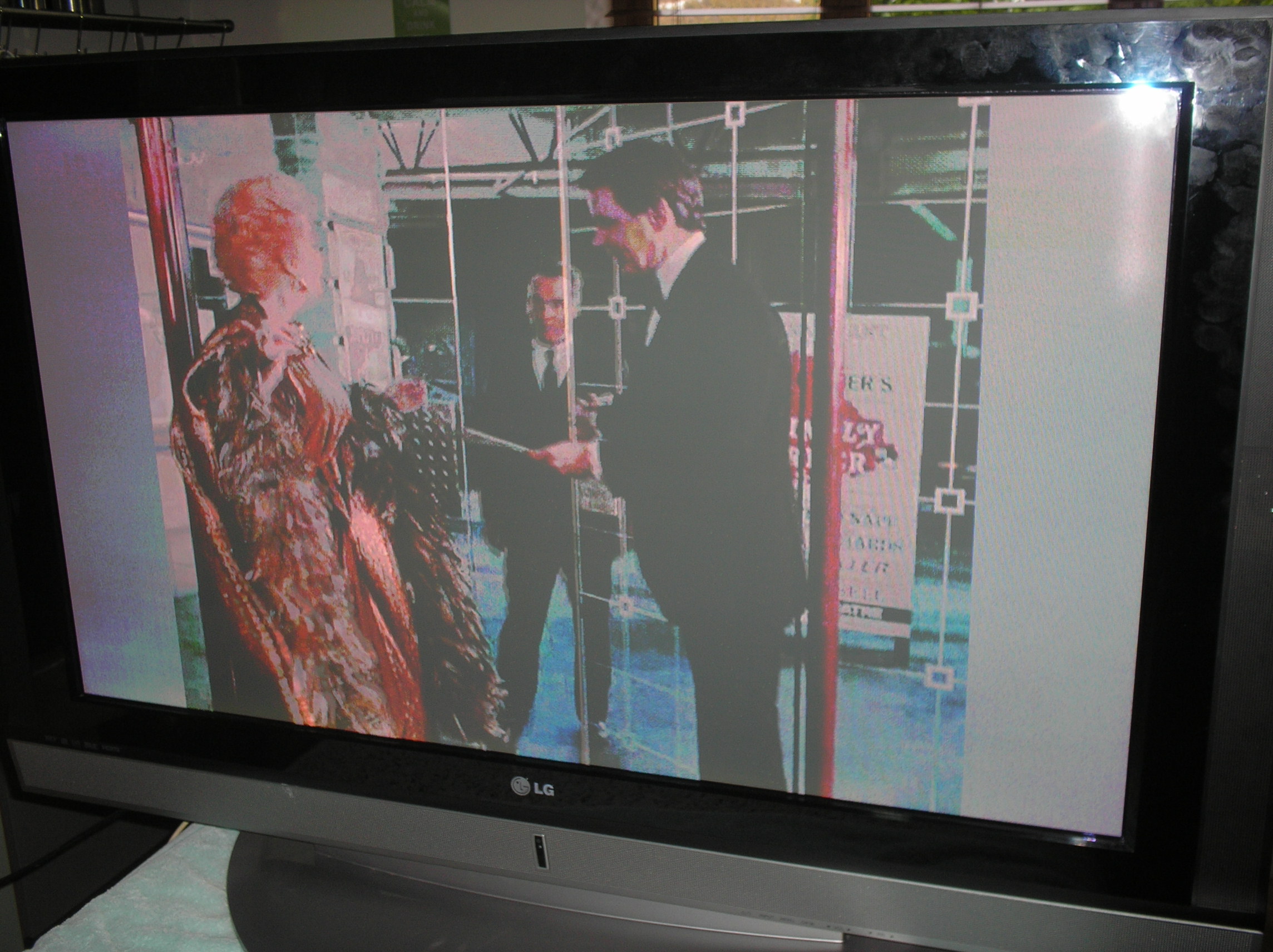

                                  photos of white screen with Vs 186v video Vs 186v and with video Vs 172v lowering the Vs cleans up the video. cleaning the ribbons and reseating did not help
                                    #37
                                    Underdiffused. Tweak the RAMP UP and RAMP DOWN controls. If that has no effect, try tweaking -Vy, Vsc and Vzbias. Can't really suggest much else.
