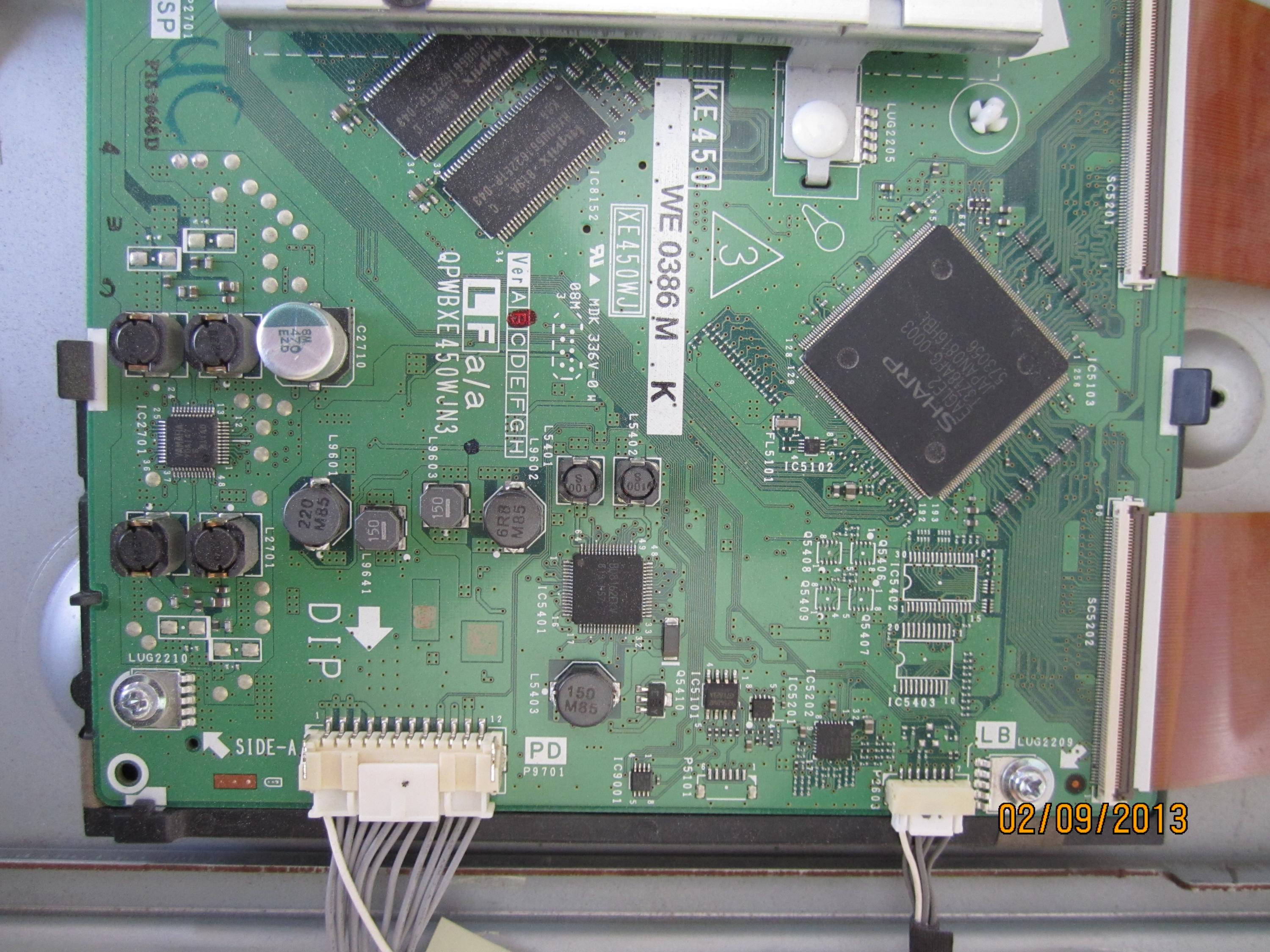

    I have the following error code: POWER LED 2, OPC LED 5. In a post from June of last year a forum member indicated that this would represent a Panel 5 volt failure.
    How do I repair a Panel 5 volt failure? I have a 37" Aquos that fell off a shelf. I have replaced a broken power board and two CCFL backlights. I checked the backlights before closing up the unit and they were all working. The TV comes on, gives me the error code, I do a reset, the power light no longer blinks, then can get the audio to work and backlights to work but no picture.

      Yes this model LC-37D44U does not have a T-con. How do I test the main board or should I assume with the error code and no picture but do have audio that it is the main board?
        Re: Sharp 37" LCD Panel 5 Volt Failure
        Ah, I recently worked on the LC-32D44E. The T-con is on the main board itself. I'd expect the mainboard is the same -- can you show some pictures?

          I will get a picture but one of the parts suppliers that I have used before indicated that there is no separate T-con board for this model.
            All of the T-con's functions on this model are integrated onto the main board. So whilst there is no T-con board, there is a "T-con", specifically, a few voltage regulators and a large SHARP processor.

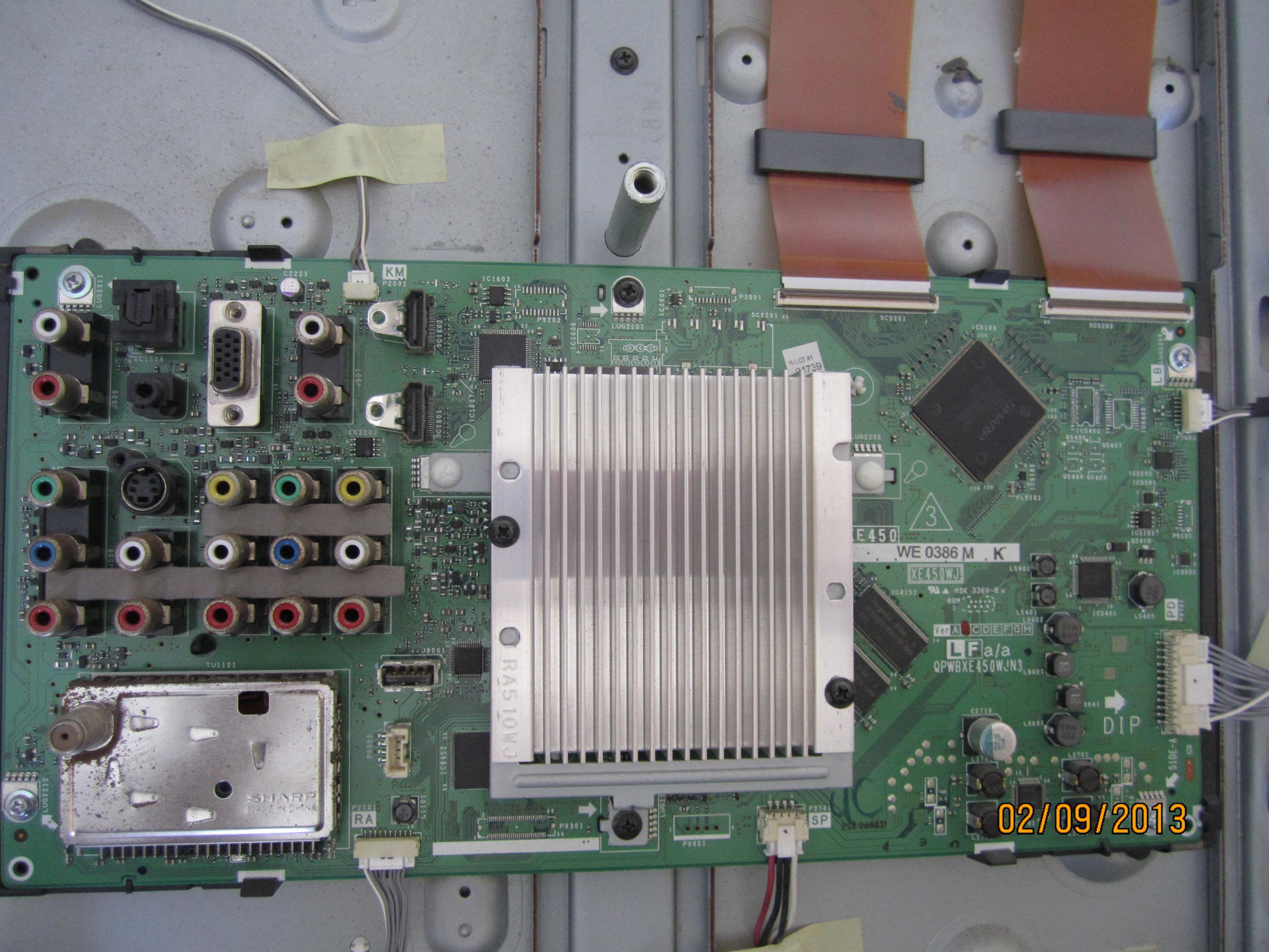

              Main board photos for LC 37D44U

                If you're certain it's 2 & 5, it does appear to be a panel 5V failure, so I'll have a look at what might cause that.
                  OK, can you test the voltage on both ends of L9601 (round dark grey object marked "220"), with red probe on one end, black on the chassis, TV powered on blinking 2-5?

                    I may have lucked into something!!! I reset it again and it appears to be working. I'll be back to you in about 10 mins....sorry

                      Before I recieved your message on testing L9601, I disassembled the unit down to where I could open and close/reseat the ribbon wires going to the LCD screen. (I had replaced two bulbs so I had the unit completely apart before. I thought perhaps the screen wasn't getting the signal) Anyway, I started the unit up, did a rest with the volume and channel buttons, plugged it into the cable, and it is working!! Thanks for your help! Hopefully this thread can help others in a similar situation......Cheers and God Save the Queen!!!
