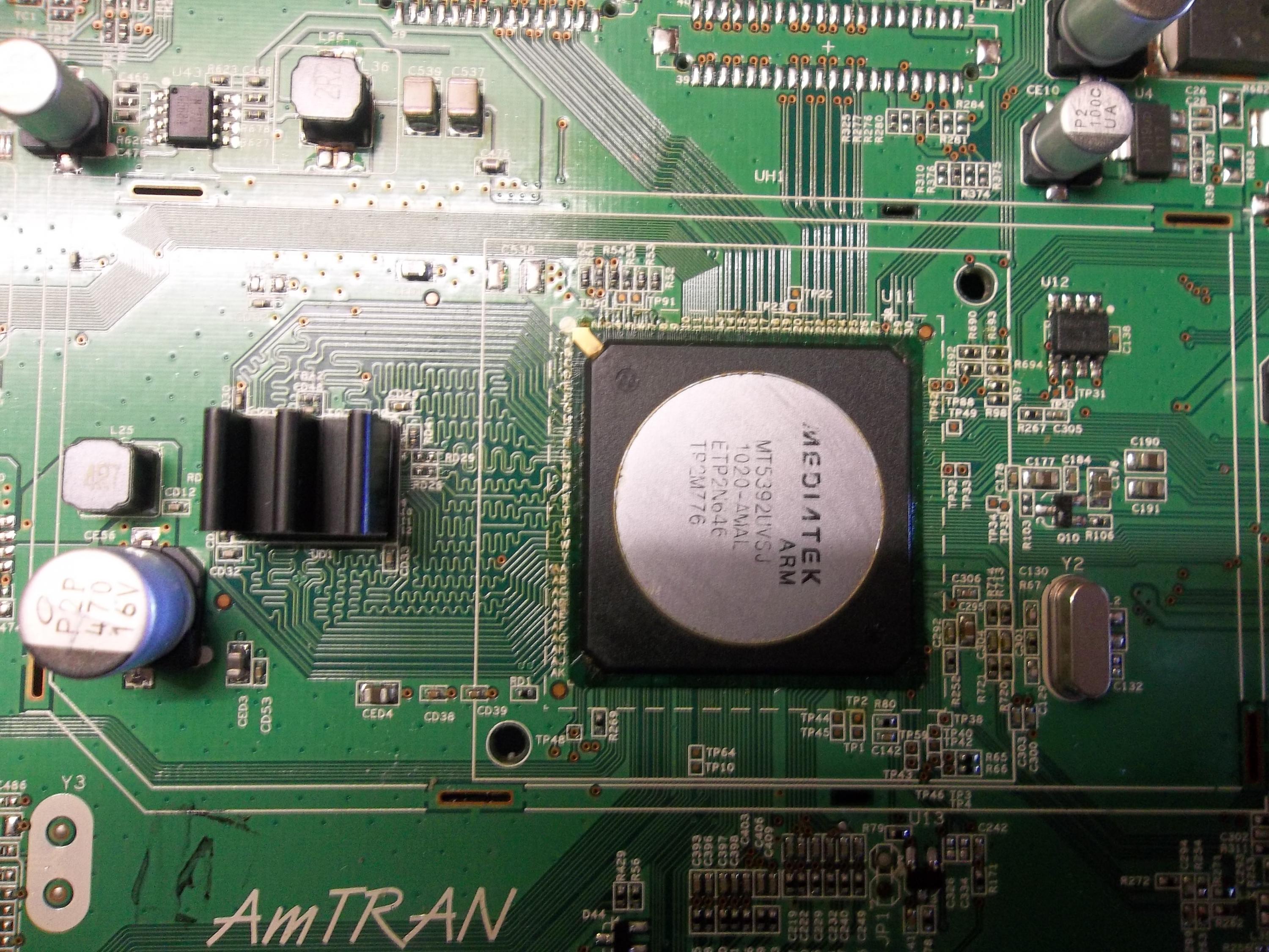

    This TV has problems with the input signals (the tv shows the "no signal" message when tuned to each of the inputs except composite video.). For some reason it's not processing it right. For example, none of the input interfaces work or work appropriately. None of the HDMI work. The AV analog, dont work neither. The composite video (Y pb/cb pr/cr) interface does display video normally, although it doesn't produce audio. Have not test the other input ports.
    I assume it has to do with the primary video processor chip on the motherboard, which in fact is a bga package.
    I tried my luck doing a light reflow, before doing a complete reflow, of the chip at about 200c to see if it'd help but it didn't make a change.
    Other than checking the fuses and looking for any visual damage I have not tried anything else.
    It's this board here (3642-0872-0150):
    https://www.shopjimmy.com/vizio-3642...for-e420vl.htm
    Here is a picture of what's under the heat sink.

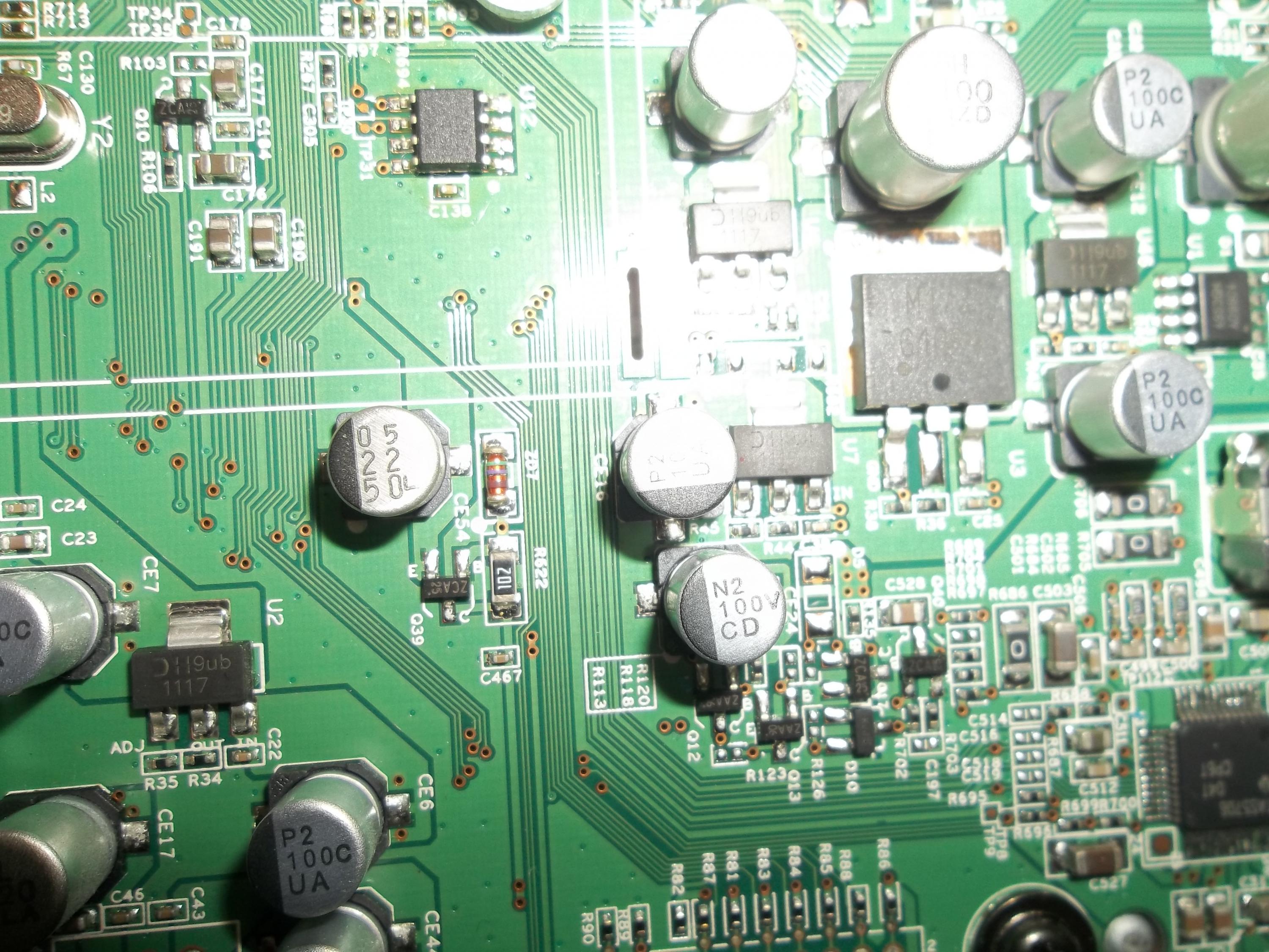

      Hi @tom66,
      I spent quite sometime today learning how to check voltage regulators from this post here:
      https://www.badcaps.net/forum/showth...391#post274391
      This is what I found.
      I checked 7 different voltage regulators I found on the board, of which 4 were 1117 adjustables. Of these, two (U2 & U7) are not providing too favorable output voltages (3.28, 3.30 respectively, where they should be 3.55, 3.85).
      The reference voltage between adj/gnd and out pin is 1.22v on some and 1.23v on others.
      In conclusion based on my understanding these two regulators need replacing, if there is something I'm missing please let me know.

                Re: Vizio E420VL input problems
                Let's see a clear closeup picture of U2 and U7 and their surrounding components.
                  Here, as I posted above is the best way.
                  Up by the top right corner of the heat shield.
                              Measure and report the resistance of R34 and R35.
                                U2
                                R34 is 98.5, R35 is 148.2
                                U7
                                R44 is 109.7, R45 is 183.4.
                                Right, I'll take a look at that spreadsheet.
                                • Beowulf
                                  • Dec 2012
                                  • 175
                                  So,
                                  Based on that spreadsheet, I should be getting 3.131v on pin 2 (Vout) of U2, and I'm actually getting 3.28, would this be considered bad, what is the tolerance? 2%?
                                  On the other hand,
                                  U7 results are now favorable based on the calculations from that spreadsheet.
                                  Calculated Vout is 3.340, where I'm actually getting 3.30.
                                    3.3V is a typical output voltage, and 3.28V is close enough.
                                      That U2 readings of the resistance can be affected by the circuit resistance that are being seen by the output pin. I would think it is more likely to have 3.3V out, which is the typical output voltage.
