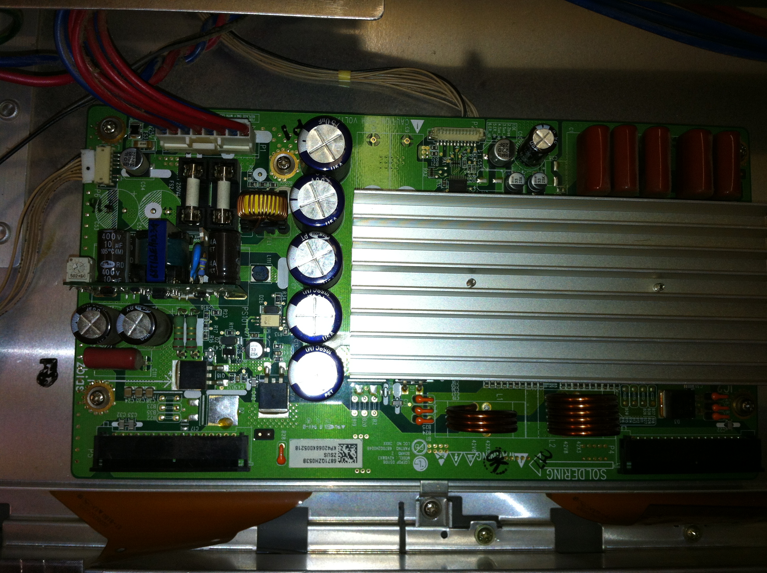

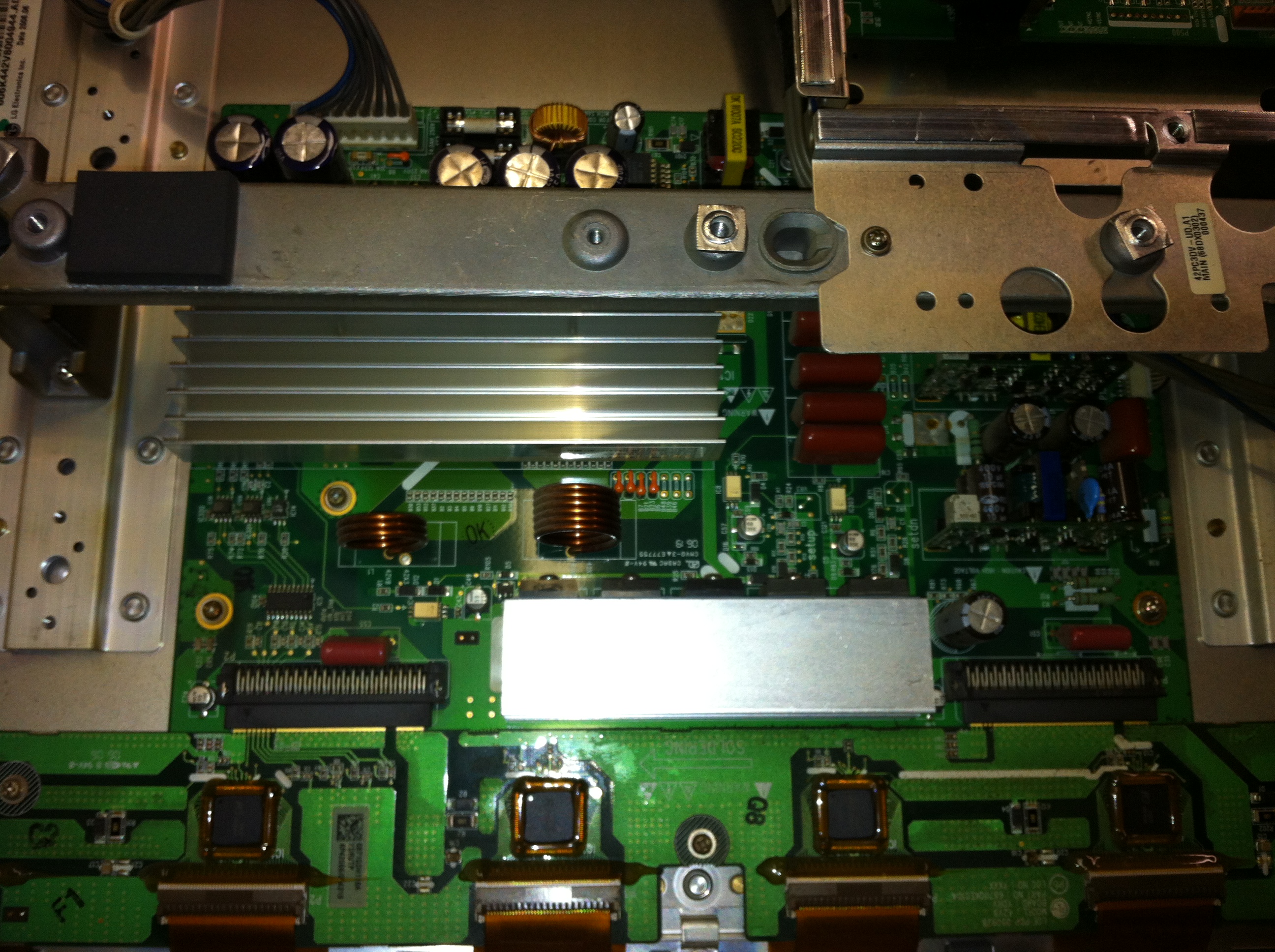

                  OK, can I have a picture of each of the sustain boards?
                  Also, what is the model of the plasma panel itself? It will be written on the ratings sticker (Vs: xxx Va: xxx etc) like PDP42G2#####. I can look up chassis wiring and particular tests for LG plasma panels now.

                    Re: lg 42pc3dv sound, no picture
                    model number of the panel. pdp42v80201 hope these pictures are helpful. they seem kind of dark, if so, i will work up some more light
                      OK, so on both ends of those white fuses you should see Vs or Va voltage. Do you?
