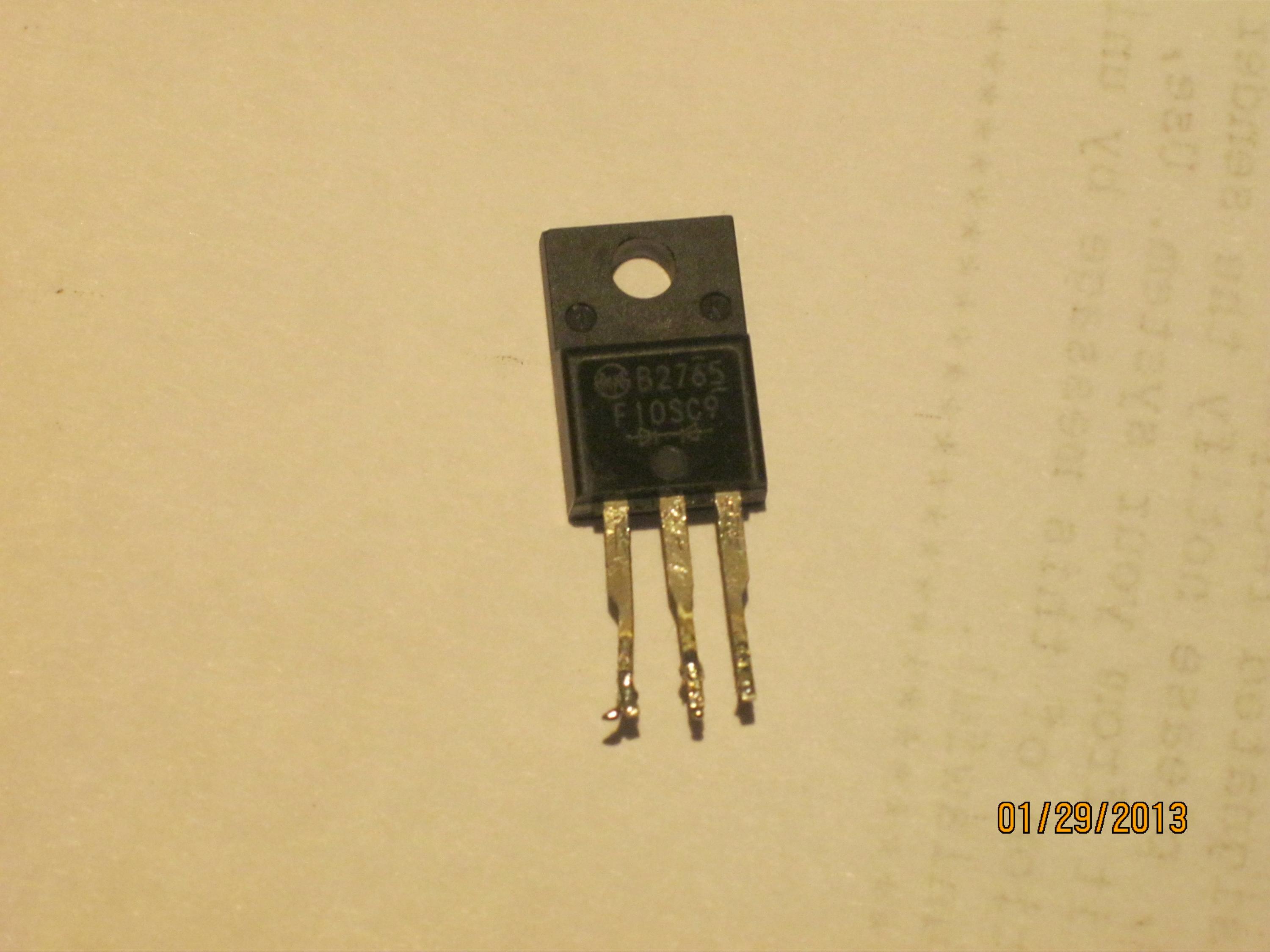

    Need help with part cant get anywhere with Digikey search box.
    Original part numbers are : top num B2765 bottom num:F10sc9
    I have crossed with D10SC9M.Rated at 90v 10A Schottky Rectifier.
    Have posted pic of part and data sheet for the D10Sc9M I am a newbie but willing to learn.

    I guess it wont let me upload the data sheet from another site.
      Re: Optek ELT4218T
      This
      http://www.digikey.com/product-detai...T-90-ND/926230
      or this
      http://www.digikey.com/product-detai...D761-ND/972249

        Re: Optek ELT4218T
        Thanks again Tom as usual you are the one to come through.Dont know how you got it on digikey i tried numerous times .
          Re: Optek ELT4218T
          Searched for "90V 10A", selected Diode Array (because it's twopair diodes.)

            Re: Optek ELT4218T
            I see thanks .
