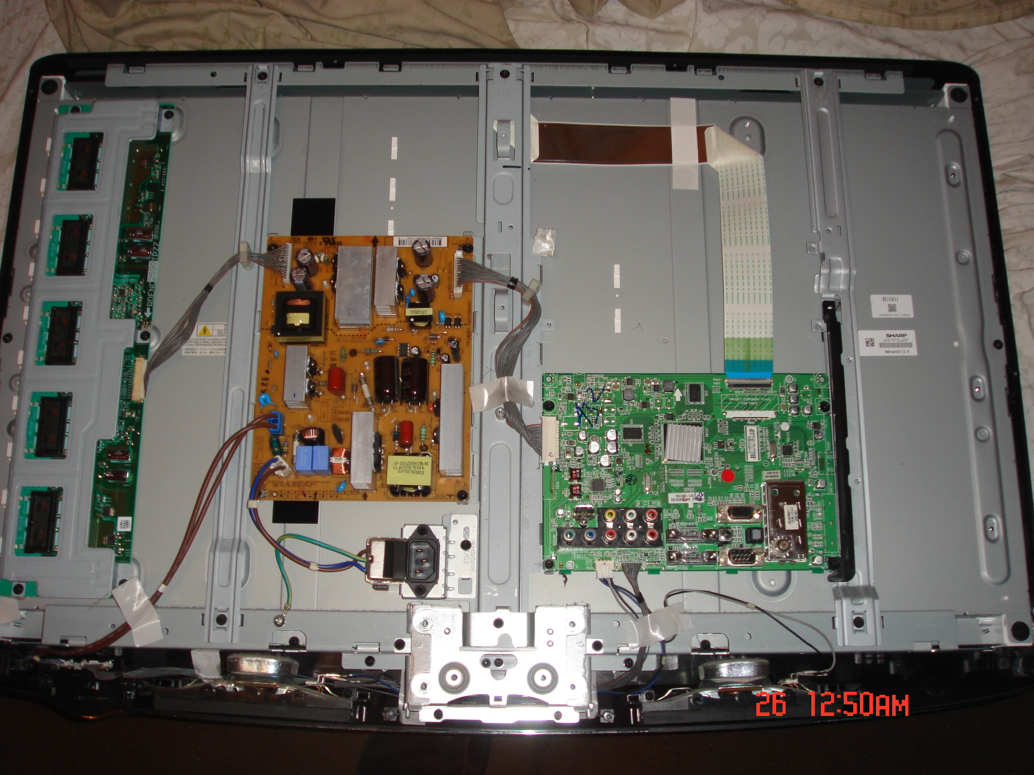

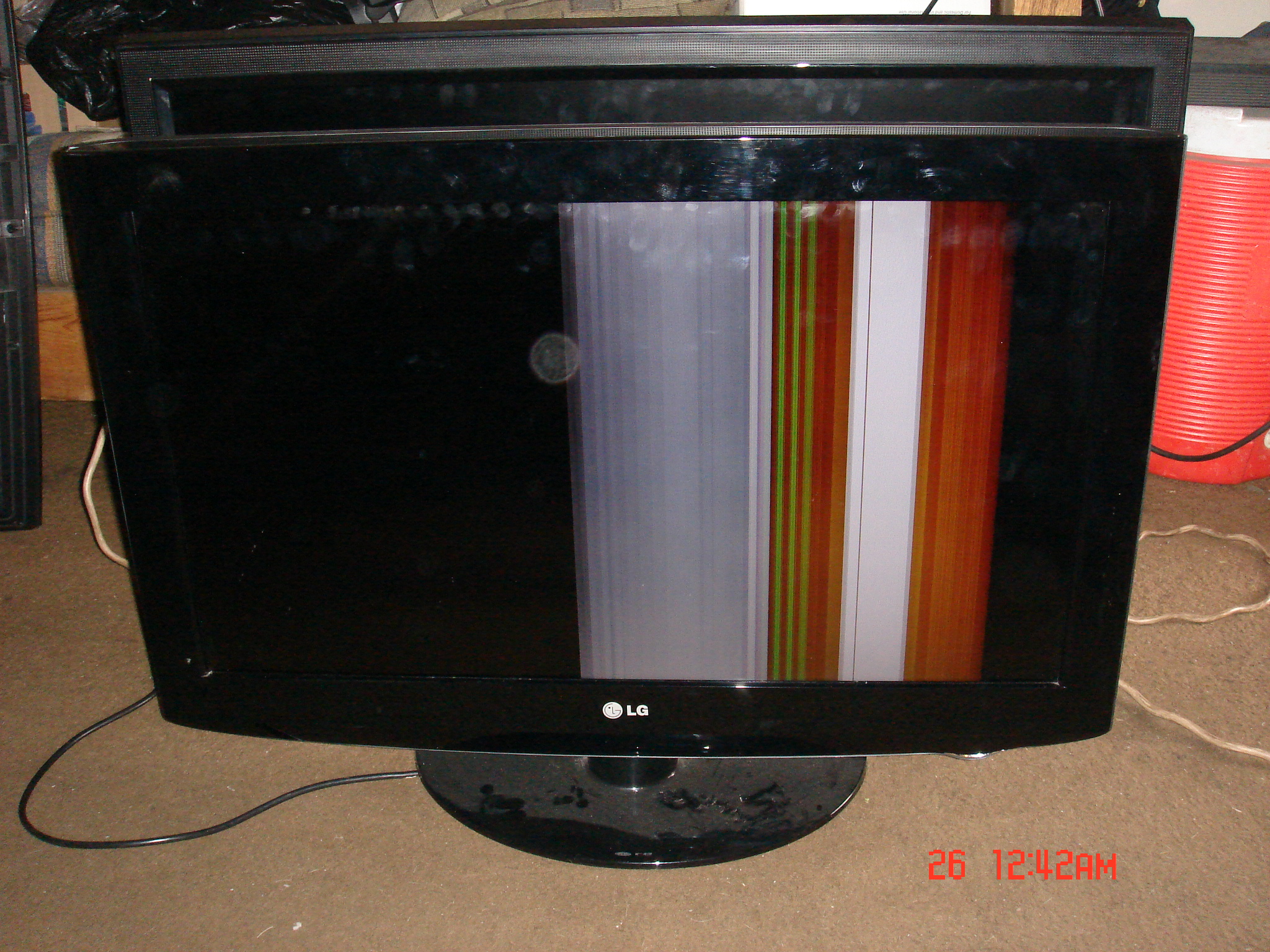

    LG 32LH20 vertical colored bars on the screen
    Hi guys, IDK but I think the screen is bad. These bars kind of slowly shift across the screen from left to right...
    I reseated the cable from the mainboard up to the screen and its good on both ends
    Re: LG 32LH20 vertical colored bars on the screen
    *cough*
    https://www.badcaps.net/forum/showth...light=lg+sharp
    Bad panel, but fixable; see MisterD's fix.
    • high-tech
      • Sep 2010
      • 197
      Thanks, i'll give it a try...
