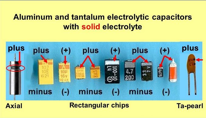

                                          Capacitors
                                          Pin out for various capacitors
