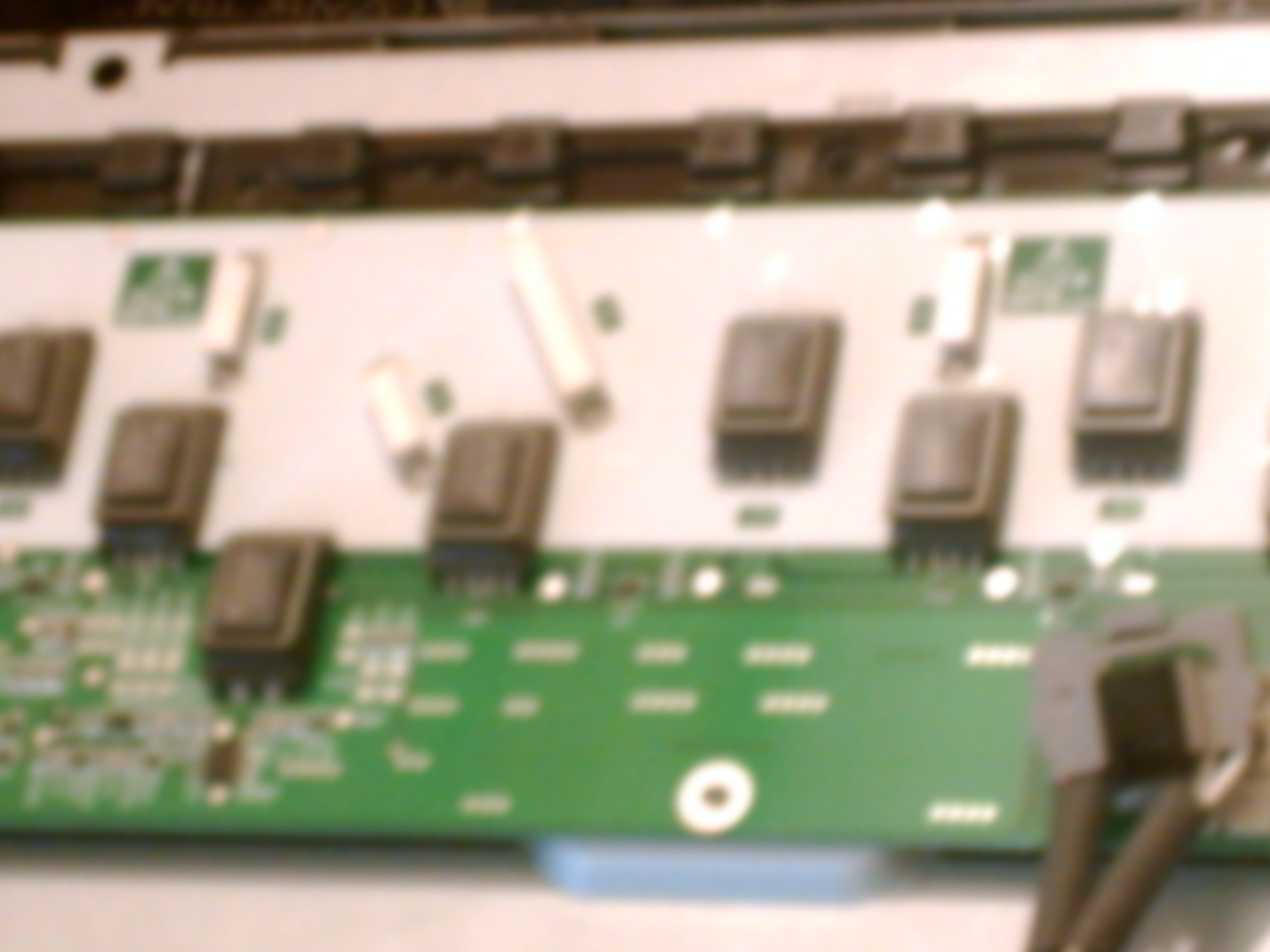

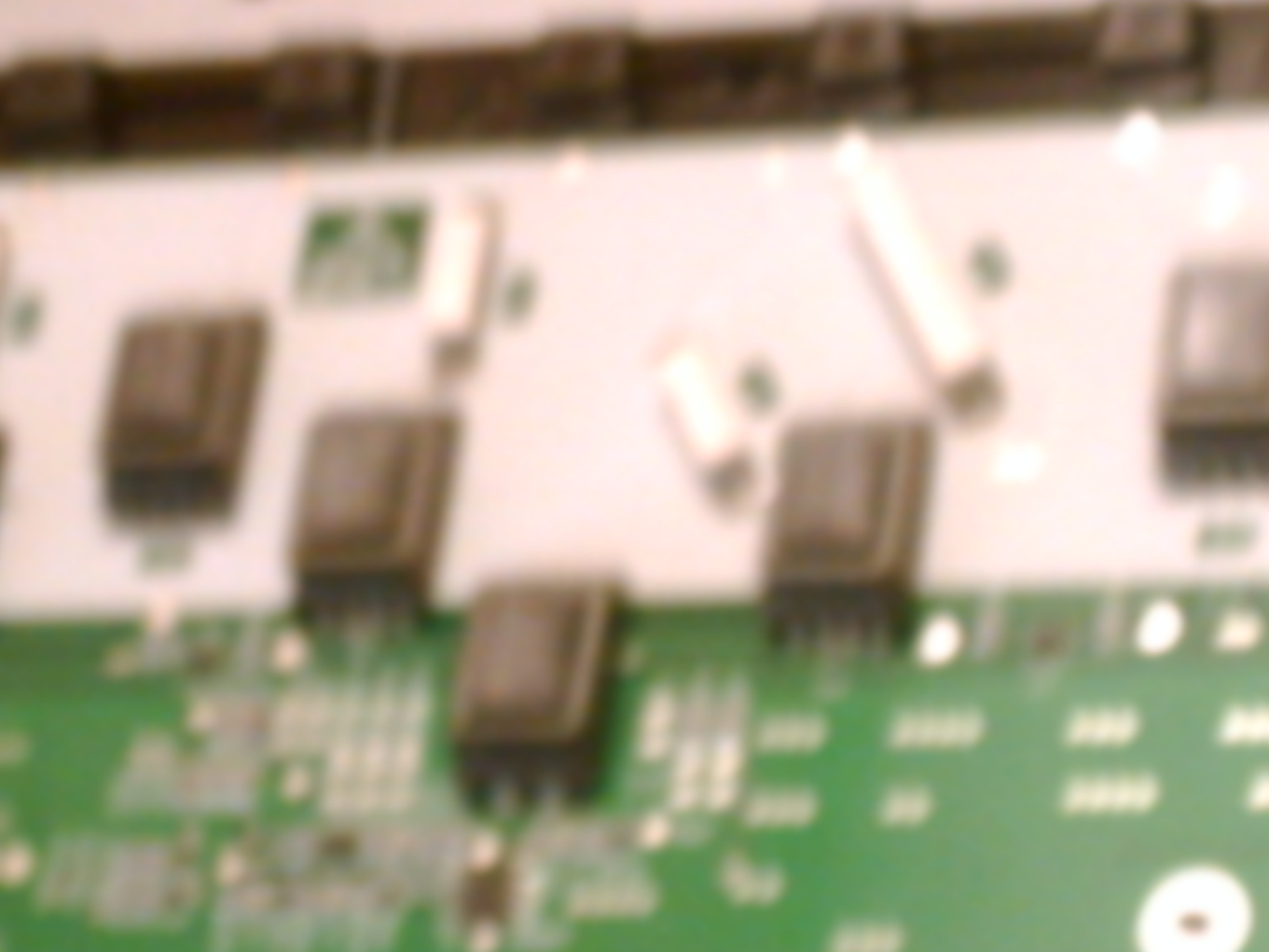

                    yes balancer long thinner board on the left, has 21 small transformers, the one with the different numbers reads zero, the rest read 2.6 ohms, it has 4 prongs on one side and two prongs on the other, am just measuring the side with two prongs, thanks for your time.

                      Re: sony kdl46s4100
                      The two pin is the primary side which the lamp current will flow through which will create the AC voltage at the secondary side which is rectified by the Diode to put out the DC which feeds the FB pins on CN125. You should look at those two pin to see how much DC voltage you get when you first turn on the TV and when the backlights cut out. If you gorund out the FB pin with 100 Ohms resistor, that will eliminate the Lamp Isense shutdown and the lamps should stay on.

                        10 of them are labeled 1055r-a834j, 10 are 1054n-a834j, the the one in the picture on the green part of the board is 1045c-a834j thats the one with 0 ohm reading, the rest are 2.6, thanks.

                          I will look at my board tonight to see what the readings are.
                          By the way, on the power supply-inverter board, there are two trimpots for Isense trip poin adjustment that was adjusted at the factory for that particular lamps asembly. The service manual dose not provide the adjustment procedures on how to set the properly set point. So if you replace the board, the set point may be too sensitve and causes fault trigger.

                                          Re: sony kdl46s4100
                                          OK, this power supply board has pullup resistor built-in on the BL_ON control pin, which is connected to the main board, the main board will pull this line LOW to keep the backlights off, so when you remove CN303, the backlights will come on, this is how you find out if the inverter is working or not by pulling the CN303 as long as the power supply suppling the B+ to the inverter circuits is OK. So if the backlight stay on without going offf when you remove CN303, it means that your inverter/balancer/lamps are OK, the problem is then in the main board. You can see the BL_ON signal is fed to Q703 ON PAGE 47 of the service manual.
                                          That is why on my post 28 I indicated that we need to check the BL_ON pin.
