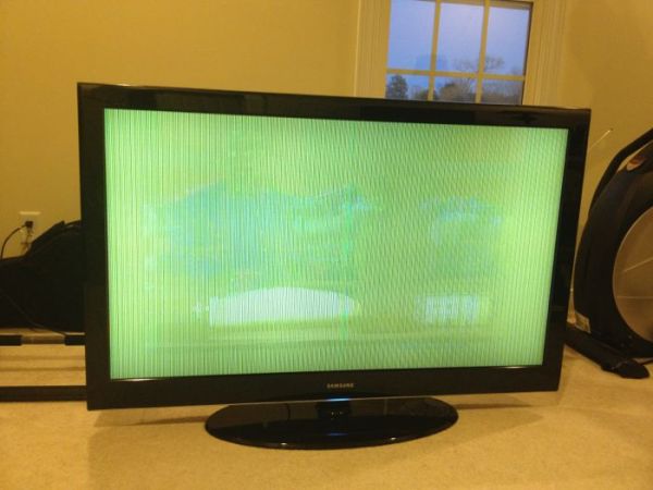

    Heres a samsung ln52a550 that I might buy with this problem.
    The owner states "It takes 15 minutes to warmup and then it works perfectly"
    Heres a photo of what it looks like when firsted turned on. After it warmups the picture looks perfect.
    I know its pretty rare but could it be a bad caps issue? I remember there were some samsungs where bad caps actually caused the screen to go weird? If not, i'm guessing most likely bad tcon?

    Samsung have a lot of problems with main boards, but it could be a t-con problem too... it's very difficult to call.

      Re: Samsung LN52A550, bad screen? startup problem
      If the sound is unsupportable, then it's the mainboard.
        Not always...
        For example, the user could have turned "TV Speaker" off, which I believe also mutes the headphones.
        Or, it could be on a source without direct sound (i.e. VGA.)
        Or, the wrong source could be selected.
        Assuming it is the main board when there is no sound has bitten me in the past.
