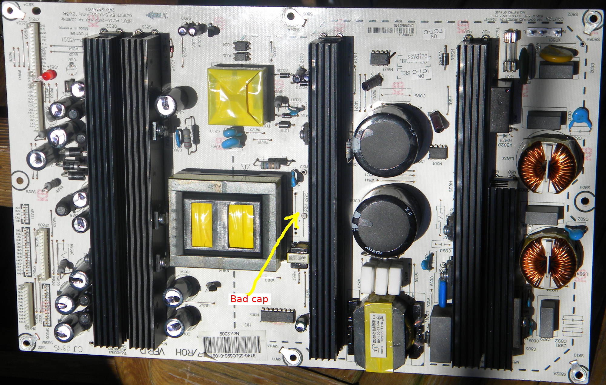

              Re: Possible purchase - Proscan 55 LCD 55lc55s240v69
              Alright, I got it and guess what??? C857 is obviously burnt
              Good call Tom!!!

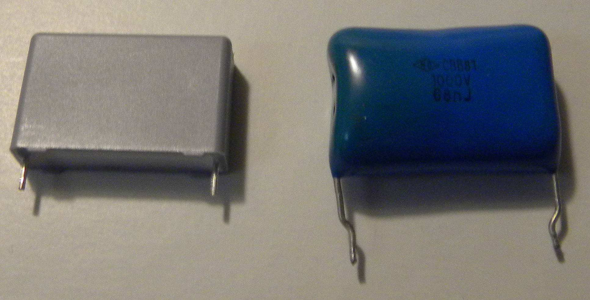

                Hey guys, did I get the wrong cap??? See attached image.
                I bought this one since it was recommended from another thread about the same tv and same problem. You can see the damage on the old one.
                Here's the link to the cap I ordered
                http://www.digikey.com/product-detai...1922-ND/502702
                Hopefully it's compatible! Just worried since it's different construction.
                Thanks!
                ** Edit: Well, it is the exact same one that a couple successfully used, so I'm gonna install and report back!
                  It is just a different shape, probably more expensive construction than that one, should work OK.

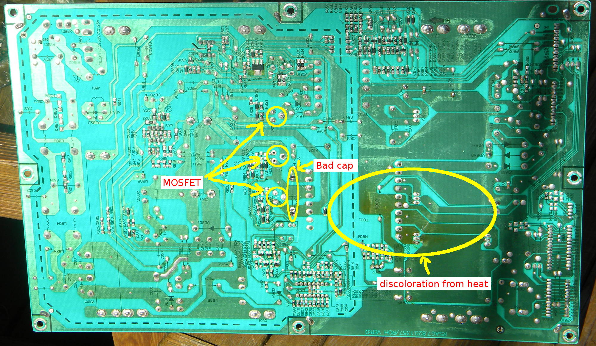

                    Well, the cap alone did not fix it... I did also order three mosfets and three schottky diodes just in case, since I heard the cap could take out the mosfet and they are in very close proximity.
                    The screwed up part is, I got the part number off of the one mosfet that I could easily see. There are three on this heat sink. I assumed they were identical
                    There are actually two different types:
                    FQPF3N80C (1)
                    [I ordered 3 at digi-key ]
                    STK1625F (2)
                    [ I thought one had a short but retested a bit later and now no short, must have been charged??? ]
                    I doubt the ones I have are interchangeable with the stk1625f. I cannot find it on digi-key but found this.
                    I attached images that show the bad cap area and also a heat discolored area. Gotta step out briefly but will be right back.
                    Thanks!

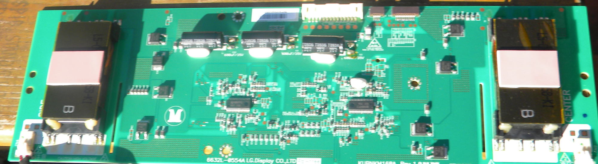

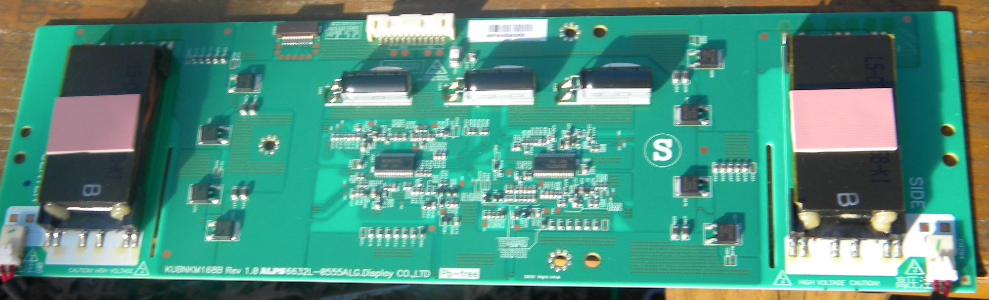

                            • martyparish
                              • Dec 2012
                              • 313
                              Cool, here are both inverters. Both fuses check are ok. (the one labeled inverter_left1.jpg is the actual on on the left when look at the back)
                              Thanks again
                                Some inverters have a feedback ERROR signal which will turn off the TV.
                                However I am more suspicious of the PSU myself.

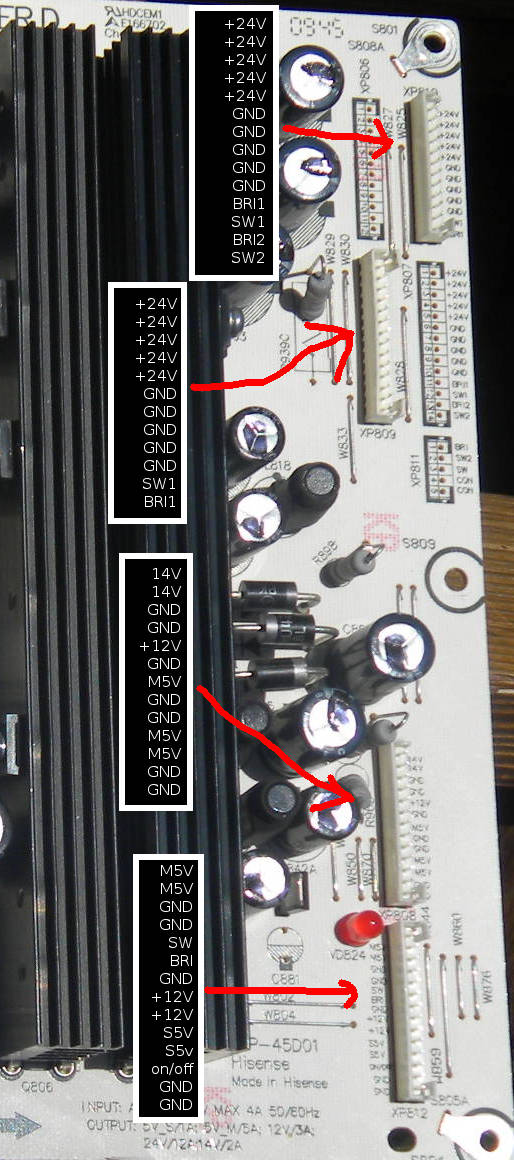

                                      Can you guys help me out with the PSU "force on" procedure please?
                                      I attached an image of all connector labels. I need to know which ones to jumper to test this thing.
                                      I assumed it should be "S5V" to "on/off". Can you guys confirm or add any advice?
                                      ** when jumping "S5V" to "on/off" I get constant relay clicks.
                                      Thanks!
                                        S5V should go to PSON, using 100~470 ohm resistor. ON/OFF is probably for backlight.
