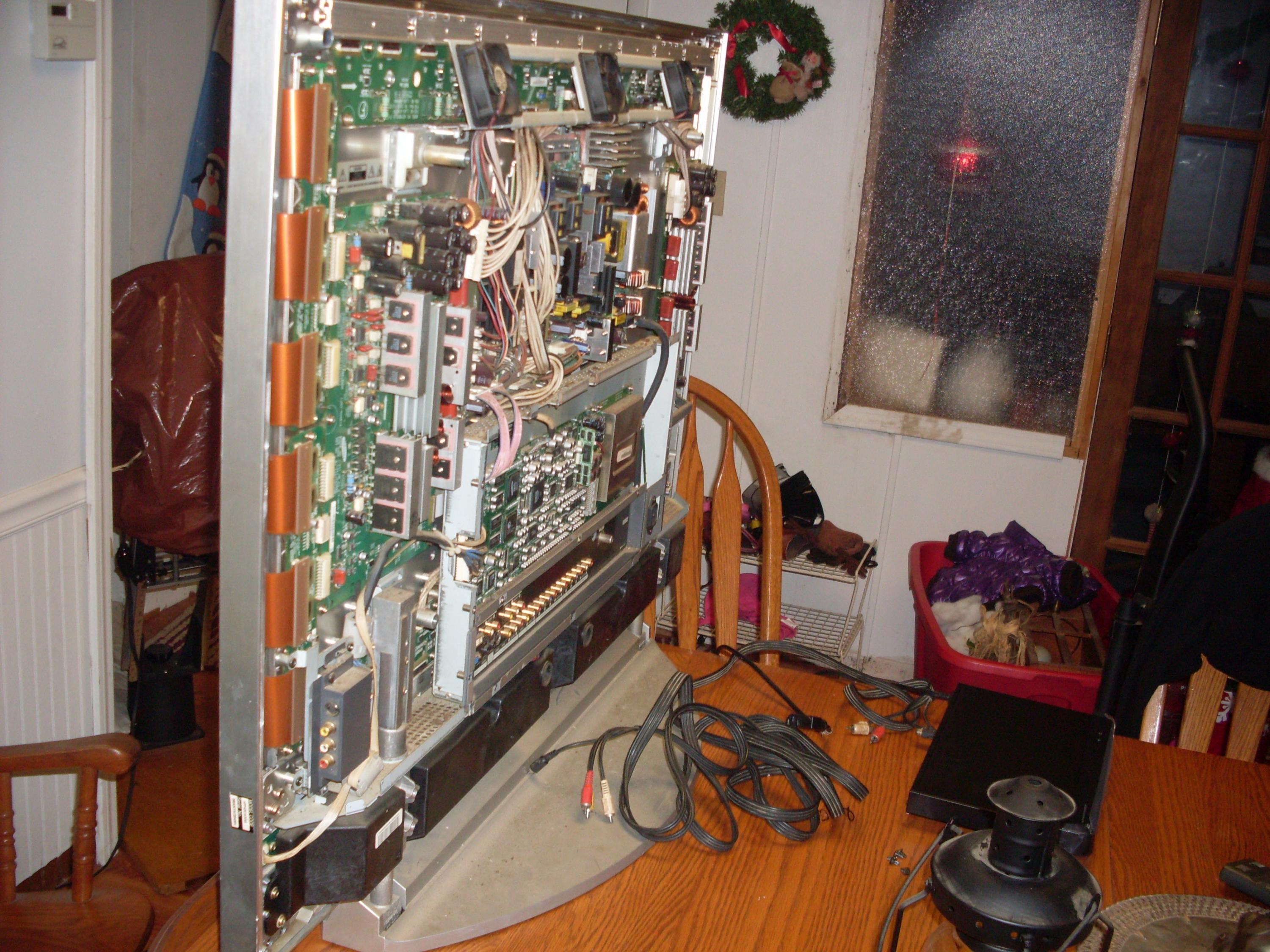

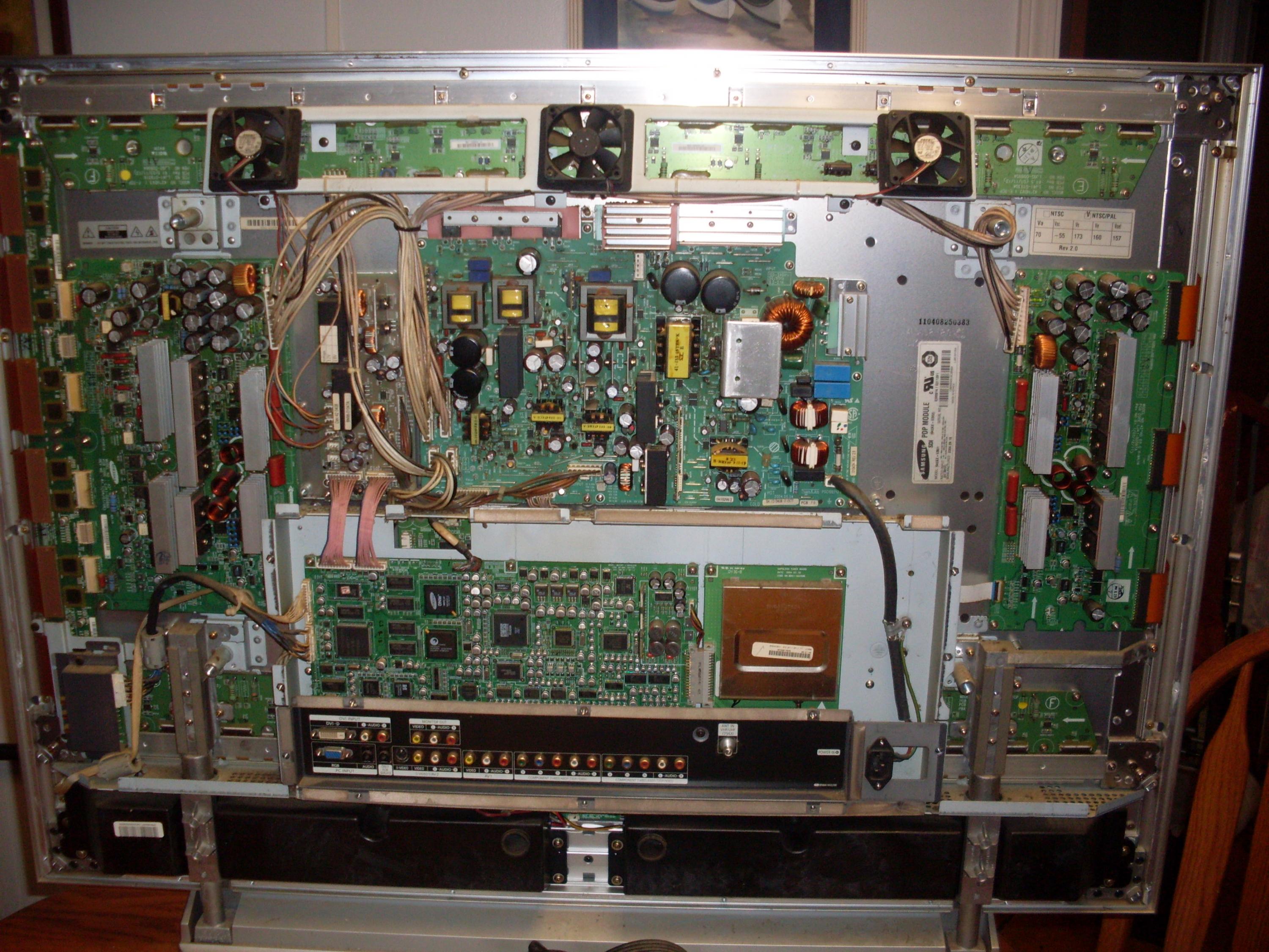

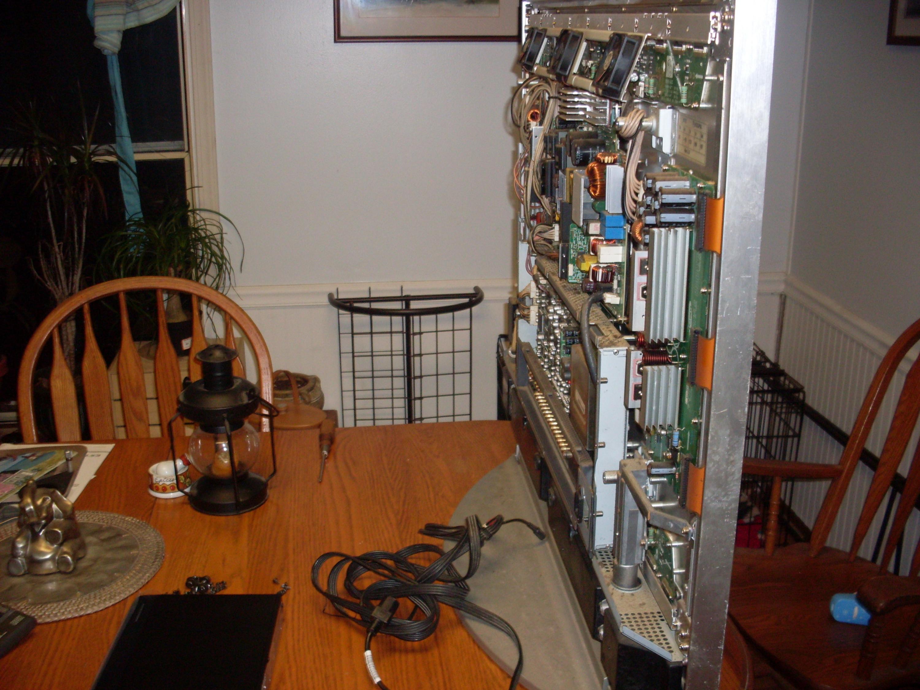

    Hi Im new to this forum, I was searching all over and this site kept popping up, but I couldnt not find anything pertaining directly to my exact model and problem. Ok, so this t.v. was given to us for free, and I used to fix some electronics that were trash, but havent done it in years. When I popped the back off of this thing, I barely recognized anything, and realized I was way out of my league alone on this. When I plug it in, the blue led light blinks 4 times, the melody plays, and blinks for the 5th time and stays glowing forever. Just as the led light blinks and stays on the 5th time, the screen starts to brighten but then dies instantly, but the led stays on. The buttons on the bottom work, but do nothing on the screen. I unplugged the Y board, and I am able to turn it on, with no picture. Same with the X board, and neither of them. So I can turn it on with one, the other, or both Y and X boards unplugged from the main board. Never get any picture though. I do not have a remote, and seeing as this is a nice TV, I am willing to invest a couple hundred into it if I can get it going again, without a repairman and their hidden fee crap. Any idea's? Also let me know if i should take any other pictures, anything I can do, I will. Thank you.

    i followed instructions in another thread, by taking notes while testing the y and x boards separately. when i leave x plugged in, and unplug the y board, then plug it in, it clicks, the led blinks 5 times, then doesnt glow at all. i press the power button, the melody plays (sounds more like its shutting off), then the led light just stays on. the left side heat sinks on the x board get warm after a few minutes. i can do this a few times back and forth, it seems like the tv is powering on and off, but either way, the fans arent going. when i plug the y board in, and unplug the x, its far less interesting. it clicks, blinks 3 times, then the led stays on. also earlier in the day i tried simply changing the fuses, but they were all still good anyway. please any help would be very appreciated.

      I'm pretty sure that on Samsung's older plasmas when they are in standby the LED glows blue, when they are powered on, the LED switches off. Don't ask me why.
      You have a failed Y-Main or buffer board. It's a pretty common failure.

          S42AX-XB01 sounds like a plasma panel module, not the TV itself. A model number for a North American plasma TV like yours would be either HPT-xxxx or PNxx[A-Z]xxx. Can you show me a picture of the back label? I can then look up the user manual which will tell us what the LED should do.

              Hp - p4261
              type no. Mz42s4
                Re: Samsung s42ax-xb01
                "when the screen starts to light up, it also looks kind of...blotchy maybe?"
                This isn't damage to the plasma panel, but it indicates the X-Main is definitely the fault.
                It will look a little like a lava lamp that hasn't quite warmed up if the X-Main fails, some parts of the picture will not light up properly, and the picture will be slow to respond to motion.

                    Well after you said you had any image (doesn't matter bad or good) it ruled out the Y-Main and your symptoms describe an X-Main fault.
                    Without an oscilloscope you can't conclusively declare the X-Main as being bad. It all depends on what you're willing to sink into it. There's a fuse on it. A good start would be to replace that. If the TV either refuses to power up or that fuse blows again we can check the X-Main. There are several transistors on it which can fail short circuit.
                    I've done two Samsung plasmas so far, and am working on the third right now. Two X-Main faults, and one Y-Main so far.
