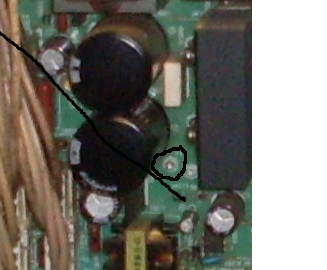

        Re: Samsung s42ax-xb01
        pay no attention to the diagonal down right line i drew by mistake, the little circle is the tiny node that says Vs next to it, and it looks like its been tested before, maybe a little burnt?
          That should be fine. Looks like a test point to me.
            when i put black on a screw slot, and red on the node, i get between 173-175. but when i only put the red one on, the reading are tiny tiny tiny, like less than .1 volts. also the tv is sitting there on, i dont think it would be powered on with less than a tenth of a volt running through it right?
              Black on chassis, red on test point. 173V is good.
                yes it was black on the screw, red on test point that i circled in pic. when i tried leaving the cord attached to psu, and putting the probes in the end of the cord that should be attached to y board, i got 0.000.
                  The black should be on the back of the plasma screen, like in one of the screw holes. Are you seeing 173V, or "close to zero" (<0.1V)?
                    173-174.5, when the y board isnt plugged in. let me go test something ill be back in a few.
                      So that's good, the plasma panel voltage sticker will tell you exactly what it should be (near NTSC/PAL and Samsung SDI sticker)
                      But since it collapses with one board plugged in the problem is with that particular board.
