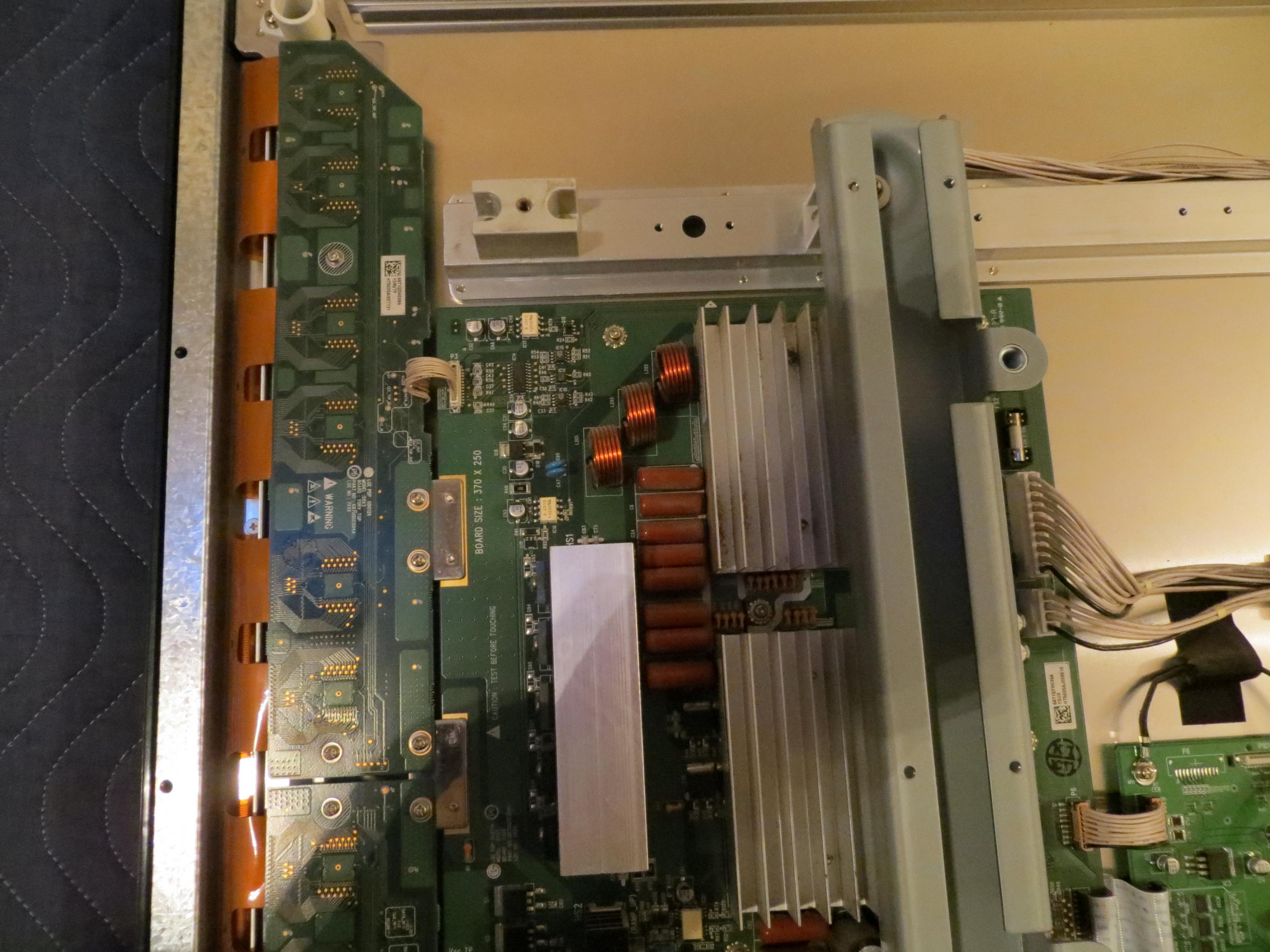

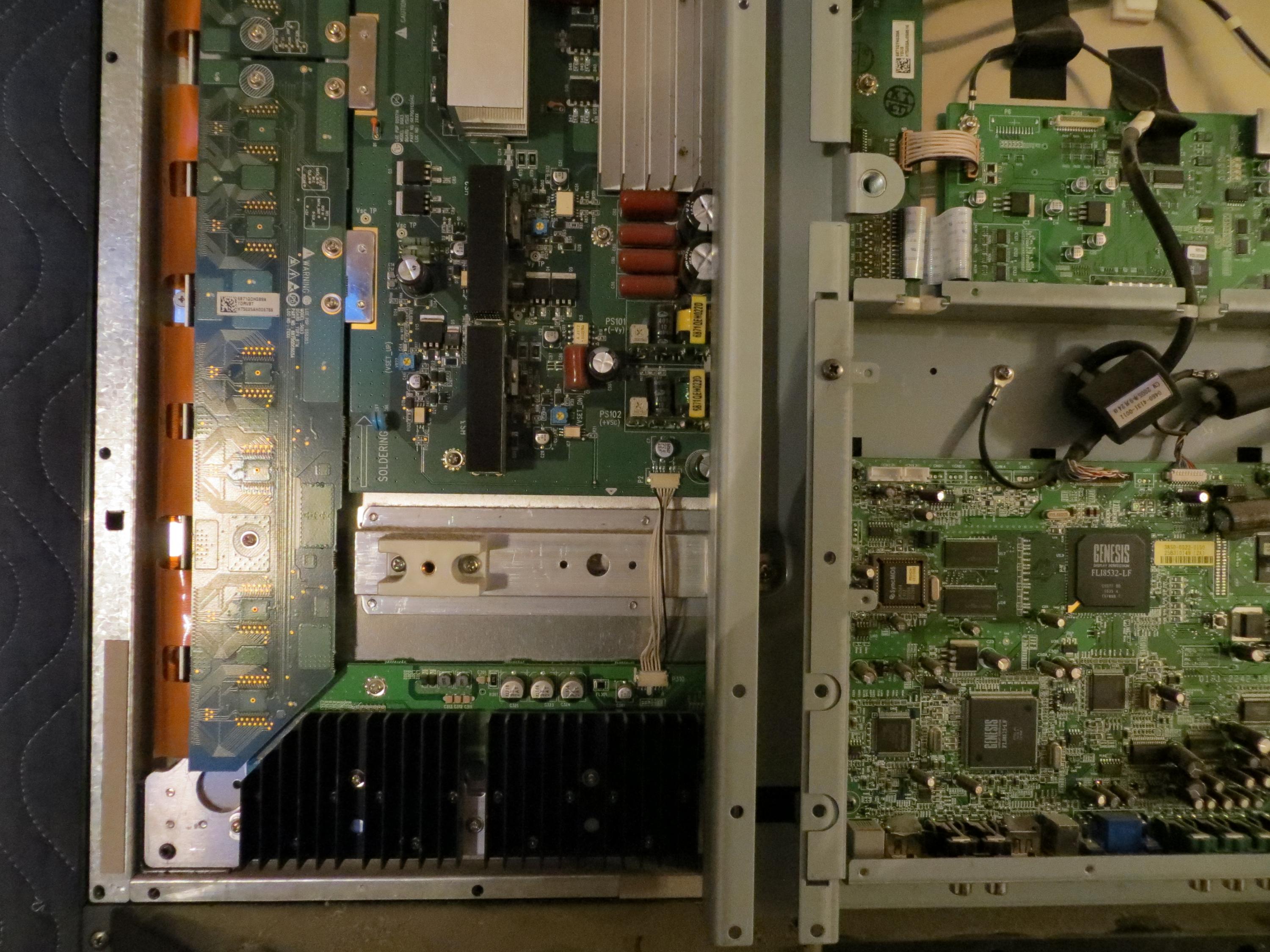

            Pictures and I'll highlight test points.
            • Cooter
              • Jan 2013
              • 18
              Re: Vizio P50HDM no display or sound

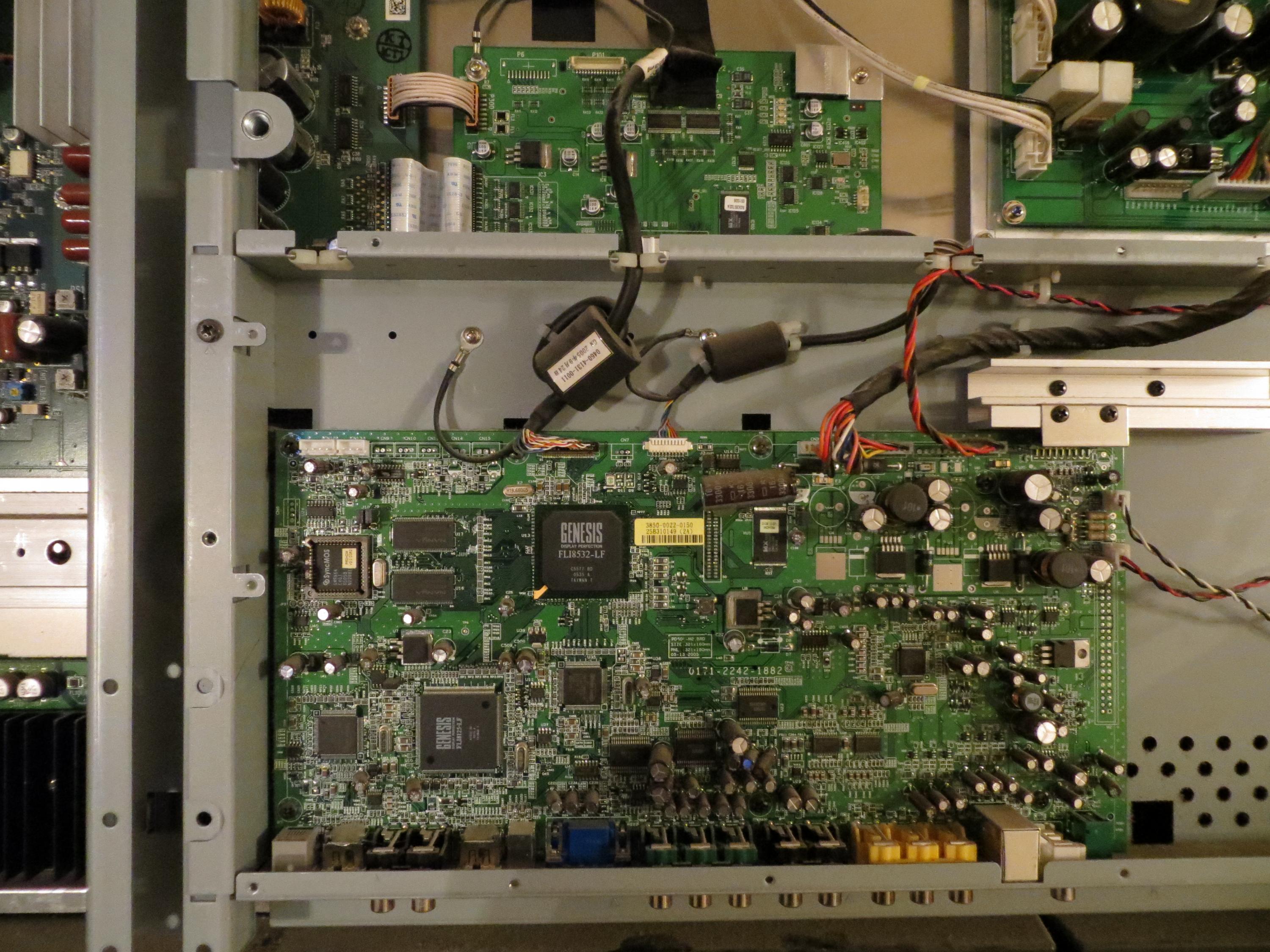

              Here's an overall shot as well as some closer shots.
                So, basically, left hand board (from your first pic) is the Y-Sustain, and the right hand board is the Z-Sustain.

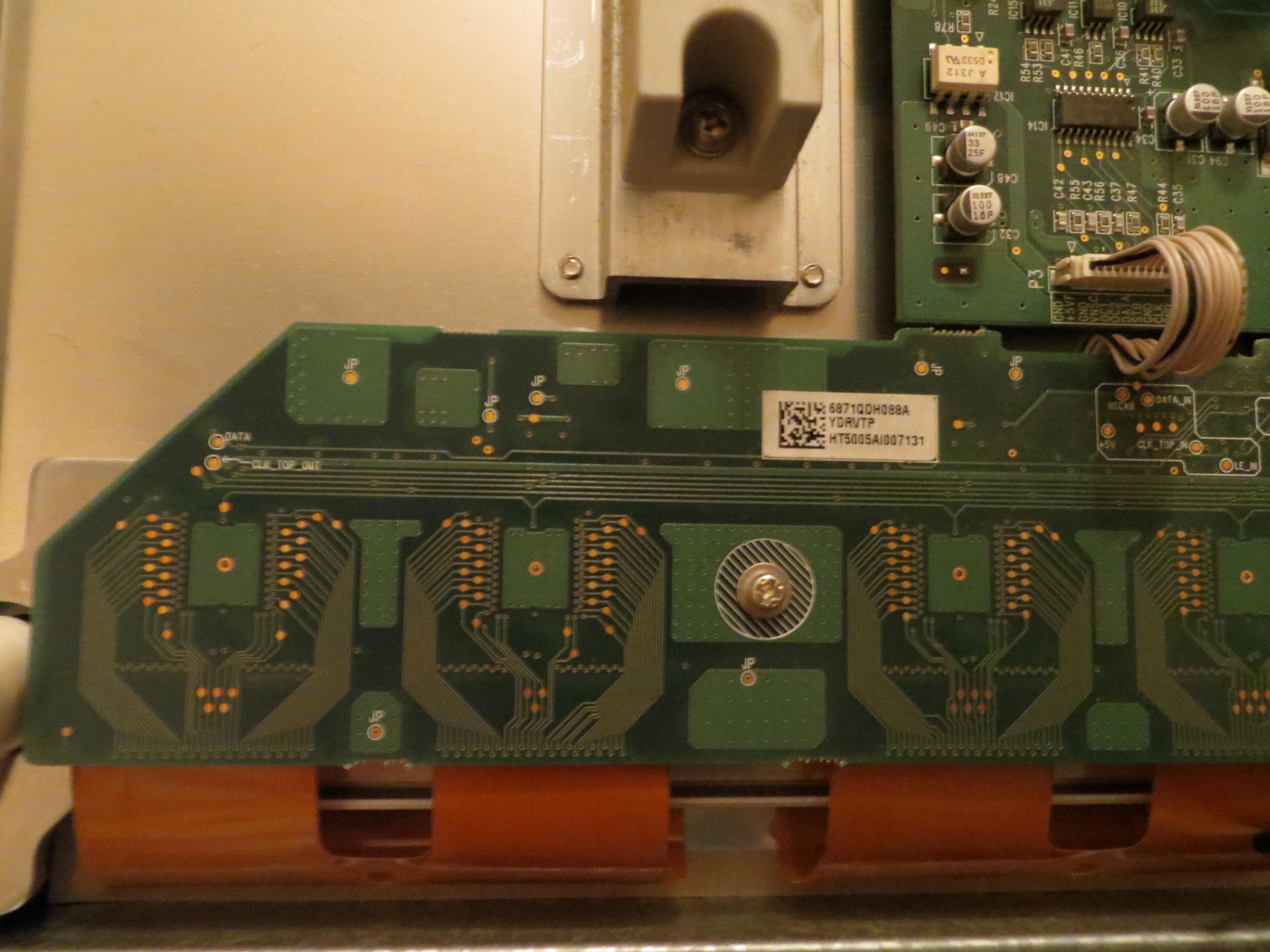

                                      OK, grab your scope when you can and make sure you either have a scope rated for at least 400V inputs with a switchable probe, or a fixed 10X probe. I use a fixed probe so I can't switch it to 1X accidentally and blow up my Rigol scope which is 300V rated. Sustain waveform peaks at around 350V for an LG (Vs + Vset.)
                                      Can you get pics around the Y-sustain to Y-buffer connectors, and Z-sustain outputs. On the Y-sustain we're looking for a point marked Vscw or WAVEFORM.

                                        Pics attached of ysus and zsus - hope they show what you're looking for.
