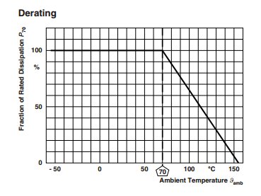

      Re: Resistor "calculator"
      ^ Good stuff. I always wondered about the power ratings of those SMD resistors.
        It's incorrect, though.
        I've used 1/4W 0805 and 1/2W 1206 on my boards.
        I've also encountered 3W 2512 devices -- as metal hybrid current shunts.
          I think it depends more on what temperatures the resistors can tolerate, without changing value or burning out quickly. Always good to over-engineer somewhat though ( if your not a money saving freak )!
          Muh-soggy-knee
            "An engineer can do for a dollar what any fool can do for two." - Arthur M. Wellington
            I always over-rate my resistors when making my designs. Typically I apply a fudge factor of between 30% and 100%, depending on the customer's requirements and the required cost of the board. (Also, I like to make my circuits more understandable at a glance, so I'll strive to make current shunt resistors bigger, even if that isn't necessary, etc.)
            However it is incorrect to say that they can only handle 1/4W (or whatever) at room temperature.
            The vast majority are rated up to 70°C or 85°C at full power dissipation.
            I have no problem with finding innovative and clever ways of saving money in making electronics, though often it goes too far and we see unreliable electronics.
            If an engineer can design something that is half the price but only last 15 years instead of 20 years, I have no problem with that.
            If an engineer can design something that is $5 less but only lasts 3 years instead of 15 years, then I have a problem.
