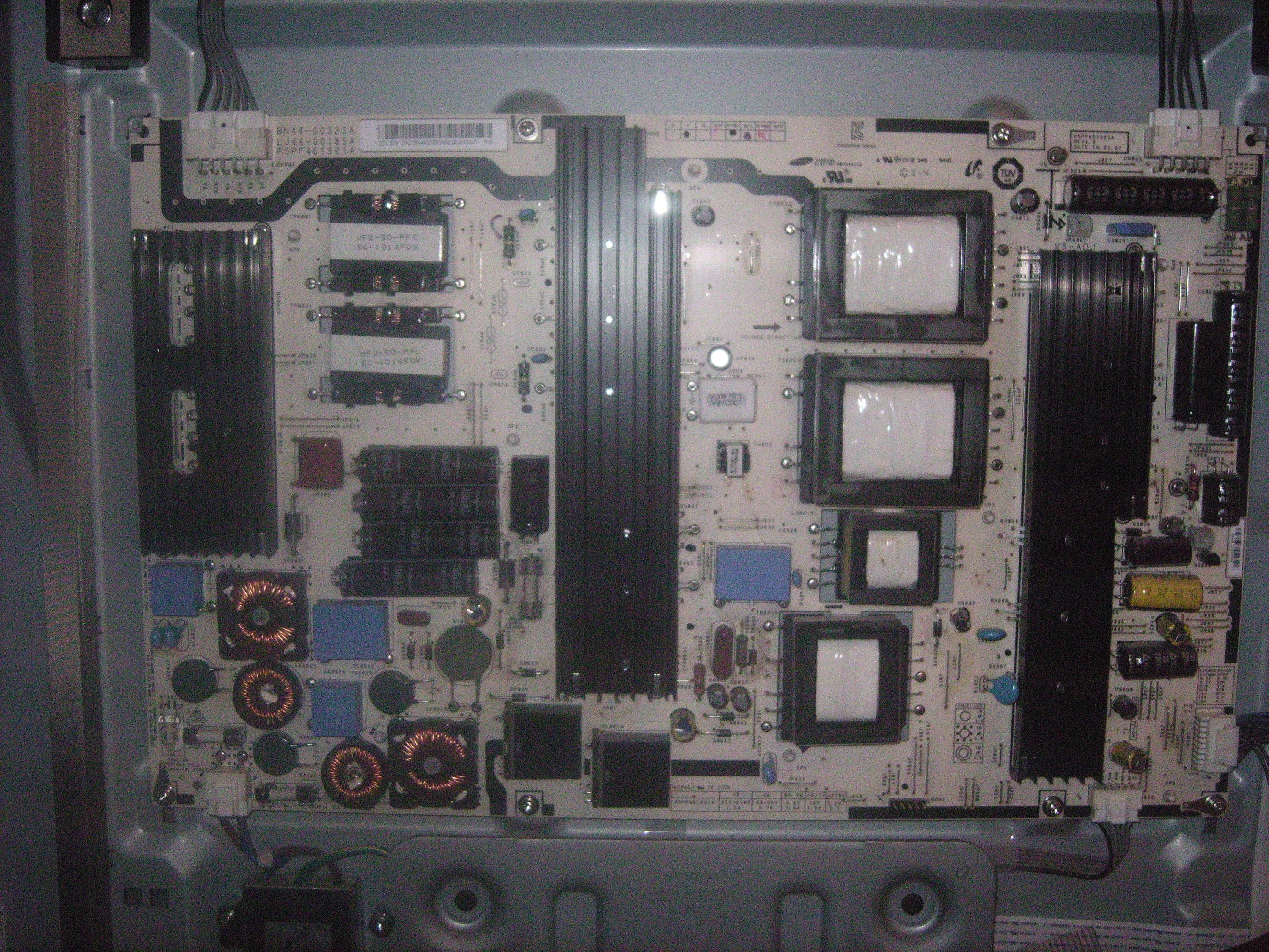

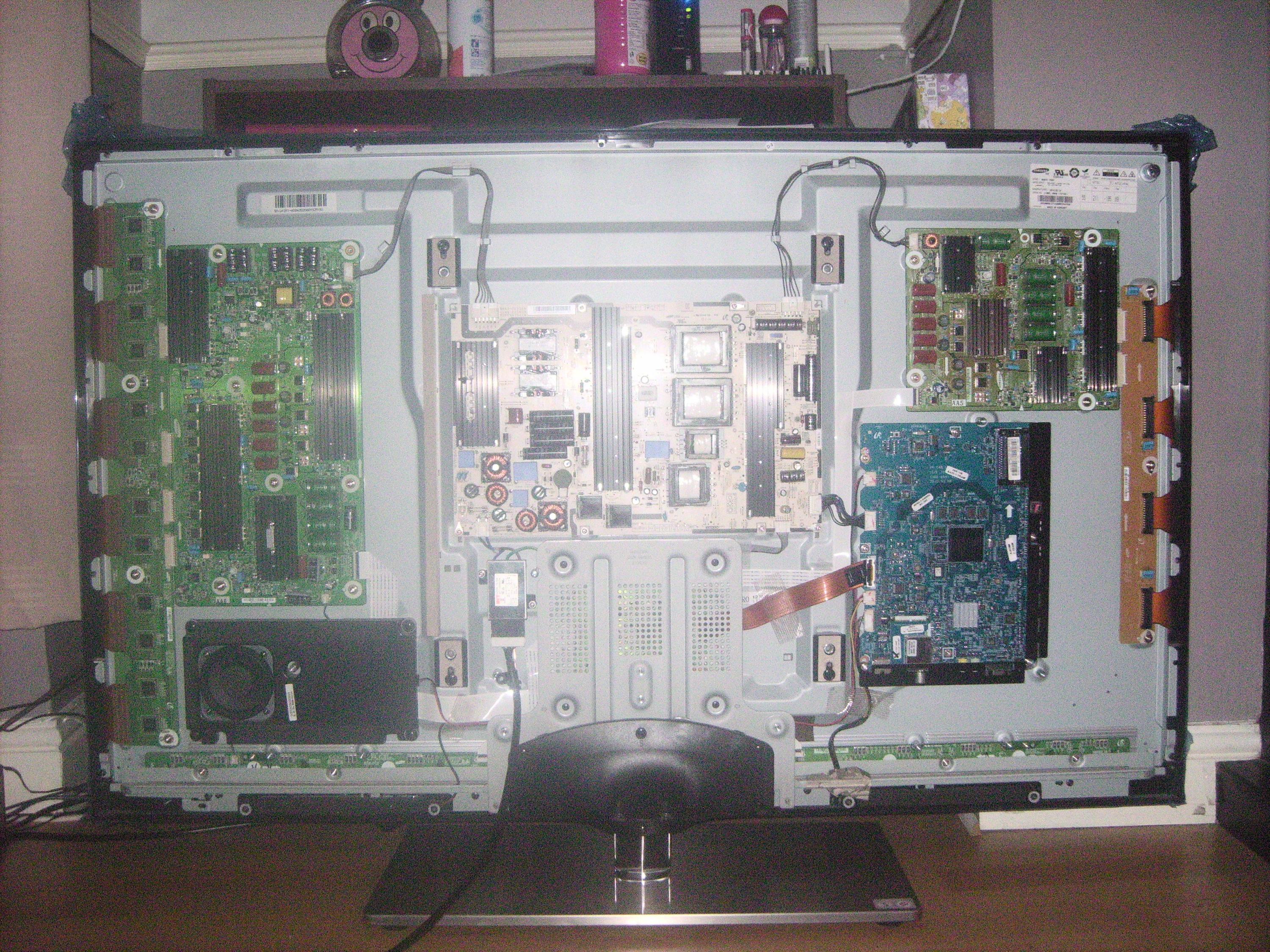

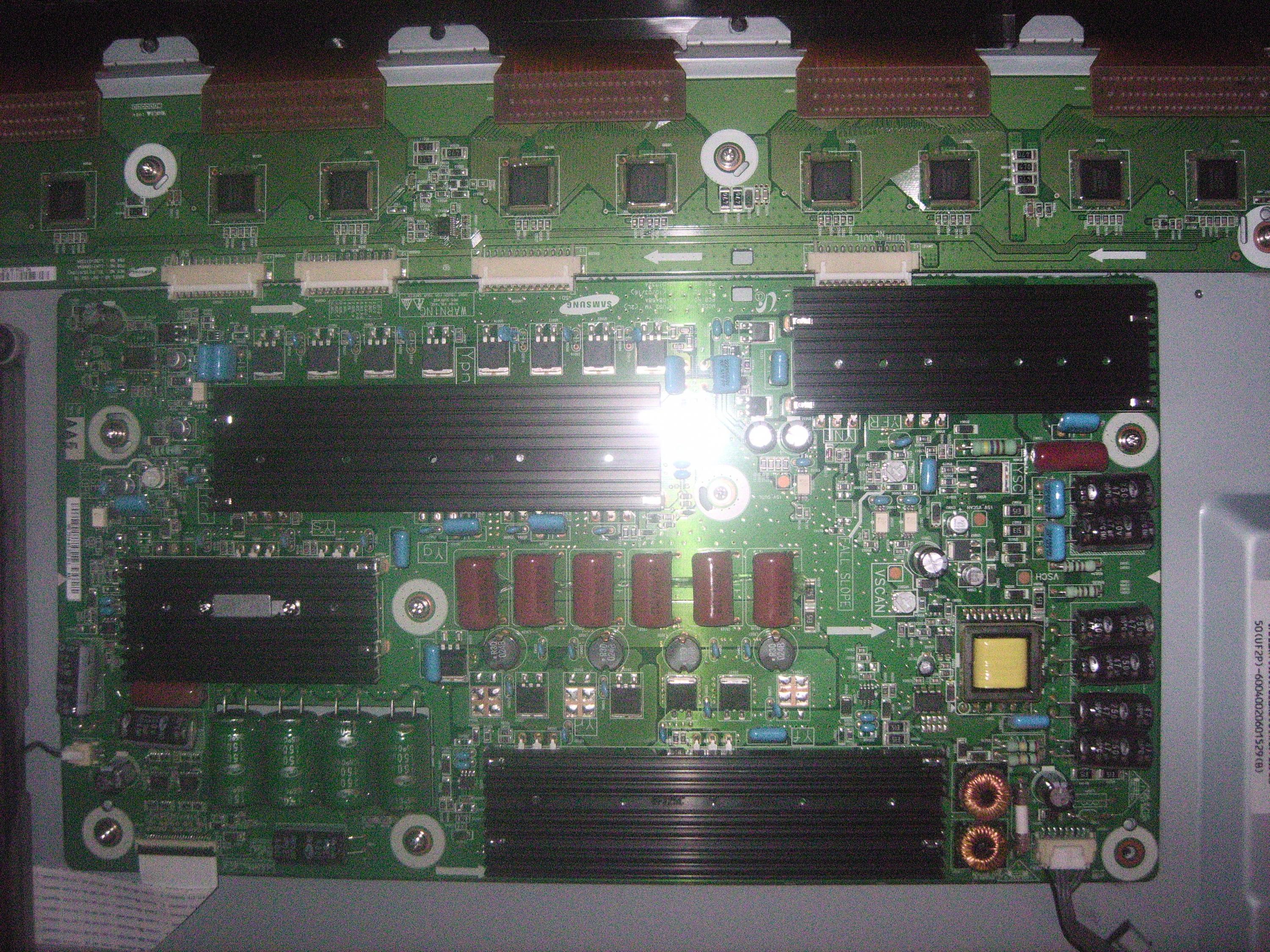

                    Hey guys I'm back with an update.
                    TV finally got dropped not long ago so took some pictures, the images are all OK but I can get a different camera and take more tomorrow see if they are any better. Should be fine they're all in focus, just let me know please and thanks again appreciate the support.

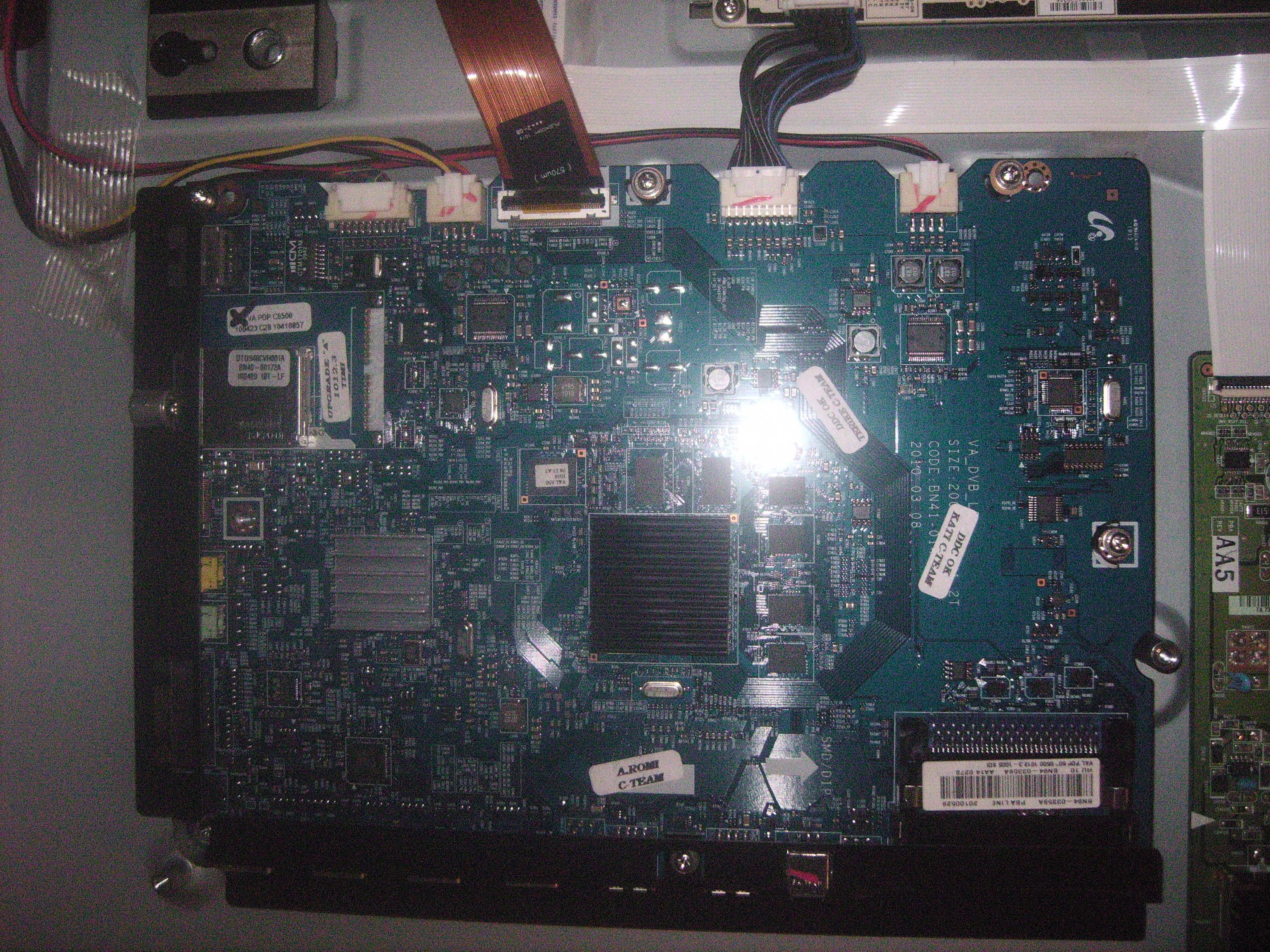

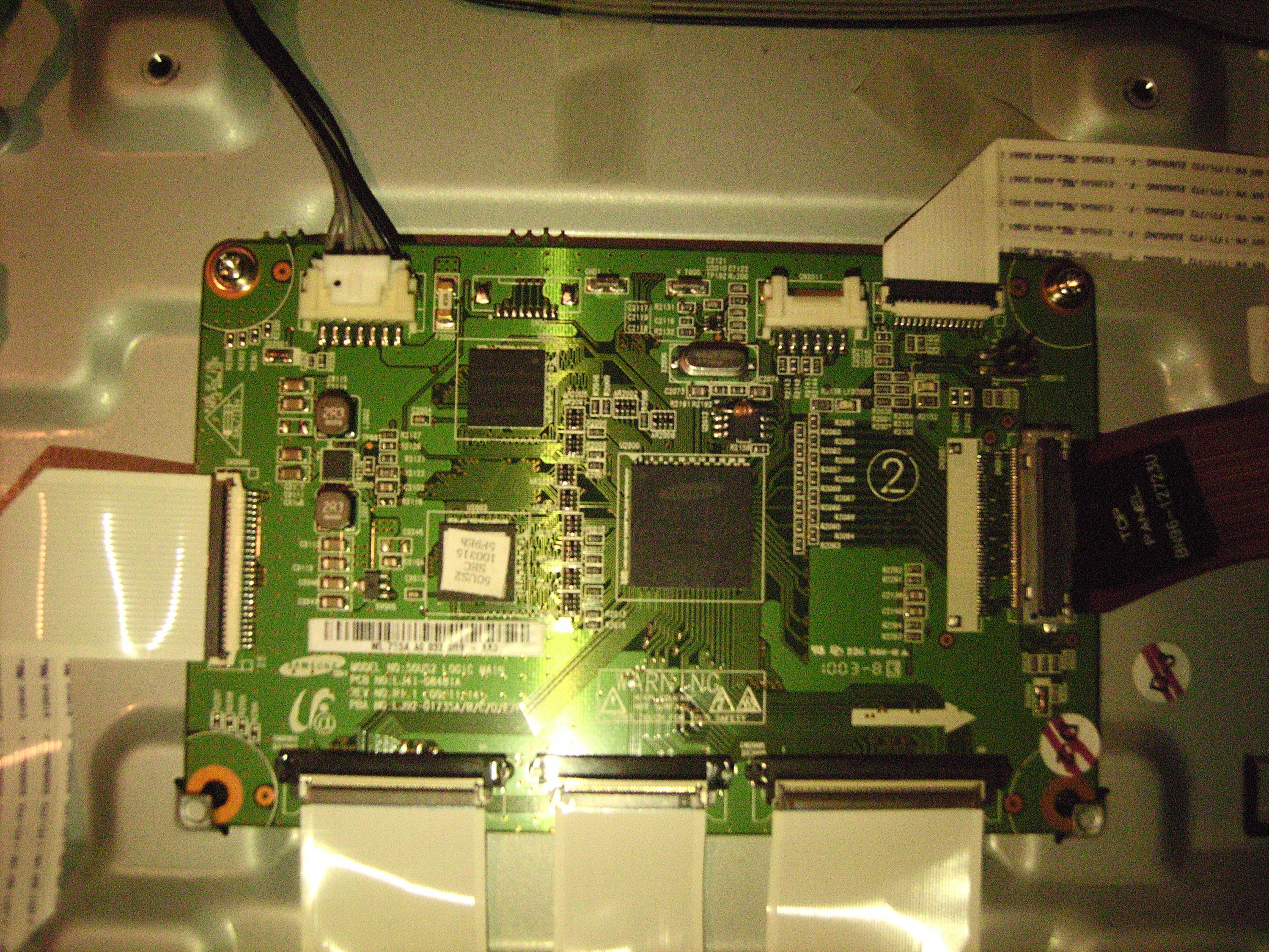

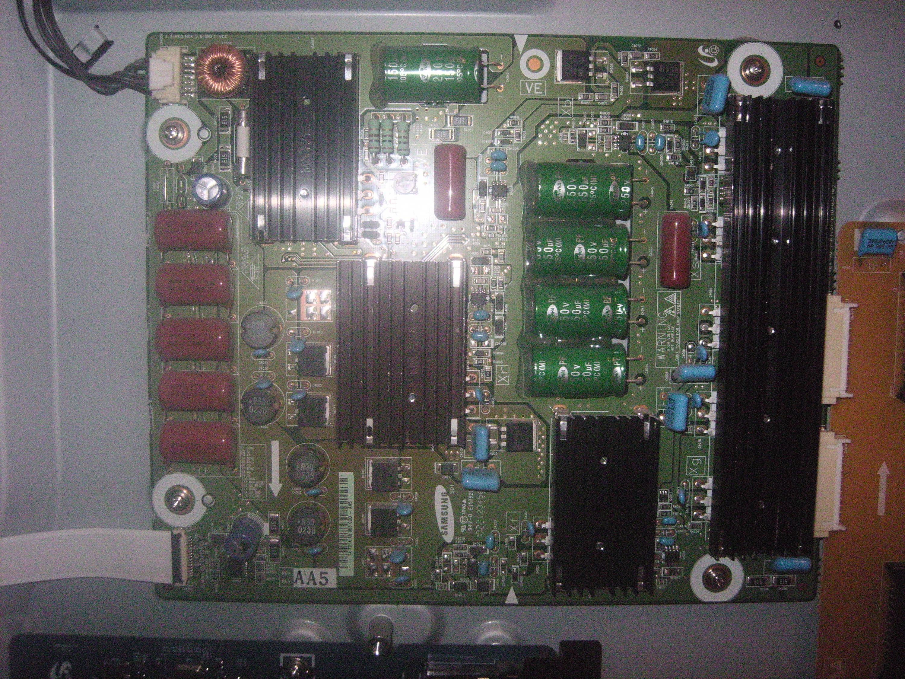

                      Re: Samsung PS50C6500 no video but sound

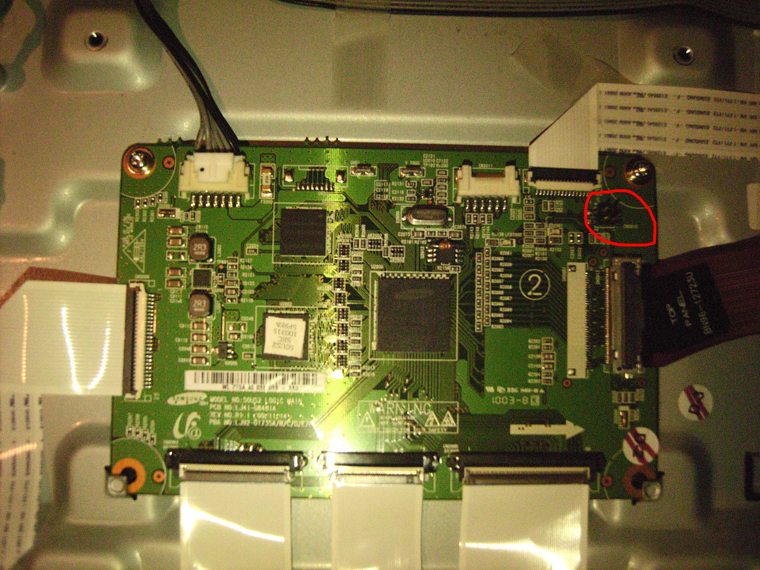

                      Can we get a picture of the control board? This is the board that the Y-Main, X-Main and main board connect to, it's a little green one.
                      • vicousvern
                        • Jan 2013
                        • 22
                        Apologies but I can't find a small green board, theres 2 long thin green boards along the left and bottom of the TV's edges. I've added a better overall picture of teh TV, if you can point it out I'll take the picture please.
                        I think it may be under the metal plate beneath the upper white board, not sure can't see, let me know what you think and I'll take it apart more if needed.
                          I have a feeling it is the one under that metal plate, can you remove that without taking off the stand?
                          • vicousvern
                            • Jan 2013
                            • 22
                            I couldn't get to it at all so had to remove the stand, but its OK the couch assisted me with this, its funny because it only just fits on.
                            Like I said before if you need better pictures I'll be able to get more tomorrow, these seem ok but they could be better.
                              OK, get a piece of wire or a hard-disk drive jumper and place it across pins 3 and 4 here. The white numbers are adjacent to the pins.
                              Disconnect the brown cable between main board and control board. Leave everything else connected.
                              Power up the TV and see if you get test pattern(s) on the display.
                              • vicousvern
                                • Jan 2013
                                • 22

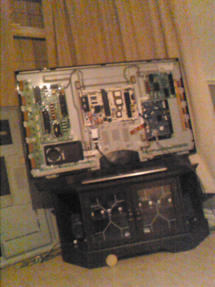

                                I managed to do as you asked, it did various colours and scrolling patterns, I took a video and put it on Youtube for you.
                                Test Pattern
                                Excuse the left corner, I had to prop the TV with my foot was the only way to try it asap.
                                  This confirms the fault is with the main PCB/main board.
                                  I would get that kit of boards for £70... you could sell the ones you didn't use for more than that individually on eBay if you are patient.
                                  • vicousvern
                                    • Jan 2013
                                    • 22
                                    Cool, think they will be OK? Comparing the images from the one I uploaded and the one on that site it looks identical in regards to the main PCB. The other boards are completely different, so would probably just pass them on as you said.
                                      The main PCB is the one with the HDMI etc on it.
                                      Not the board you just tested.
                                      You have ruled out by doing that test:
                                      - Power supply
                                      - X-Main
                                      - Y-Main
                                      - Y-Buffers
                                      - Control board (the one you put the jumper on)
                                      - X-Distribution Buffers
                                      - Plasma panel
                                      The main (video) board is most likely at fault. So you need to source a compatible replacement for it. Look for the part number -- will be indicated next to "PBA NO" -- we want the "PBA NO" not the "PCB NO".
