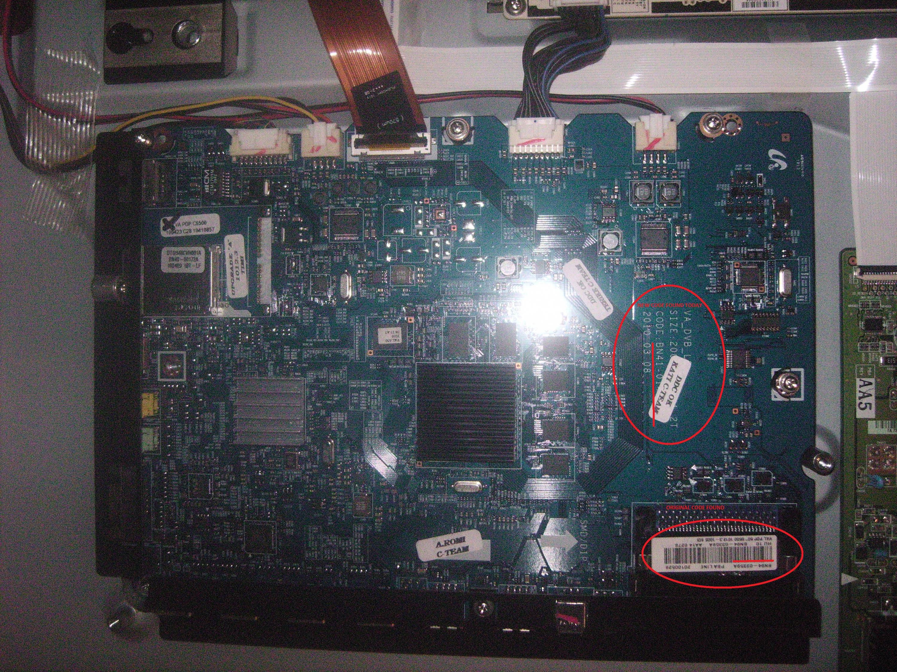

                                  Just looked at the broken part in my TV and I found a sticker on the actual board covering the code. The original code "BN94-03359A" was on the top of one of the input ports, the new code on the actual board itself says "BN41-01448A". Which as it turns out is the same as the part I just ordered from flattvparts: Samsung PS50C6500TK - Main AV - BN41-01448A - BN94-03359C.
                                  Since the codes for the main board are identical I'm guessing it has a better chance to be the right part. As the other code was just on the expansion slot input which I never used anyway.
                                  Can't believe someone put a sticker over the code, I didn't even know what I was looking for in the first place probably why I overlooked it.

                                      BN41 is the "PCB" code.
                                      BN94 is the "PBA" code.
                                      The "PCB" code is for the blank board which may come in any number of "PBA" configurations. For example one more or less HDMI, which you could probably live with, but in some cases configured for different plasma driver/control board, which would mean it would not work.
                                      You should always order by PBA.
                                      Now sometimes the suffix is important, other times it is not. For example that suffix could indicate a bug fix to the software has been applied, or different in store/factory settings. Both of those would be fixable.

                                        Thanks for clearing that up. Like I mentioned in my first post, I'm completely new when it comes to TV repair, so apologies for being a bit slow with these things.
                                        At any rate I'm still optimistic about the part I ordered, even if it doesn't work the kind people at flattvparts will allow me to return it, in which case I'll just order the part from Samsung. Should find out in a couple of days and will update straight away, I presume I connect it up and if it works, great, if not return it? Can't see there being anything left to do other than order the part elsewhere.

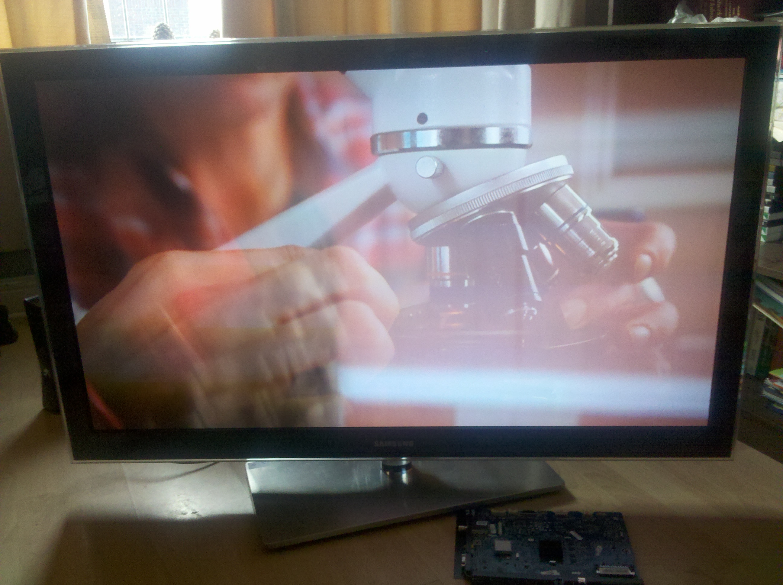

                                          Guess my optimism paid off, it works!!!
                                          That part from flattvparts arrived really quick, popped it in and it works like a charm, what's even better my TV now has HD channels, which it didn't have any before.
                                          Would like to say a massive thank you to Tom66 and Vinceroger69 for both your help and advice I am immensely grateful.
                                          I wish you both all the best and I will recommend this site and your help for anyone in the future and I'll of course come here first myself, so happy.
